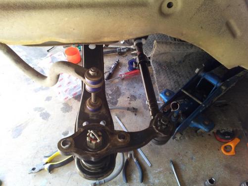

B.L.Z.BUB Posted October 6, 2012 Author Report Posted October 6, 2012 (edited) Couldnt help a mate move as the missus has really bad morning sickness so I decided to tinker. Managed to press the ball joint and LCA bushes without the correct tools :y: Tried to install the RCA's but they make the LCA hit the hub/rotor, don't know if I can rectify that. Already had to flatten the end of the LCA by about 5mm just to get the rotor to turn. I'm guessing this is why everyone runs XT130 LCA's? Edited October 6, 2012 by B.L.Z.BUB Quote
B.L.Z.BUB Posted October 6, 2012 Author Report Posted October 6, 2012 (edited) So I went back out even though the sun is a killer, jacked the front LCA up to see what the geometry was like. The LCA doesnt seem to be too bad. Though I really messed up with welding the sleeves on. Had to max them to the lowest setting and they are too high, but mind you half the car was still propped up by an axle stand. May need to grind the welds off and lower them. EDIT : So the AE86 arms have a different balljoint location causing the LCA's to foul. Edited October 6, 2012 by B.L.Z.BUB Quote
SLW42 Posted October 6, 2012 Report Posted October 6, 2012 Do the 86 arms sit the ball joint further towards the inside of the car? How much is the LCA hitting the hub/rotor by, Can you trim abit of the LCA back to make it work? Also height related did you sit the car back on the ground after winding the coilovers down? Quote
B.L.Z.BUB Posted October 6, 2012 Author Report Posted October 6, 2012 I had to hammer the end of the lca to make the rotors fit. With the rcas its worse. Didn't lower the car just jacked one corner up Quote
Seventy Posted October 7, 2012 Report Posted October 7, 2012 I had the same problem with RCAs on my RA65, ended up clearing the disk but then the tierod end didnt clear the 14s, so if you were to go 14s eventually they still might not work, just letting ya know Quote
B.L.Z.BUB Posted October 7, 2012 Author Report Posted October 7, 2012 Wheels clearance isnt an issue. Quote
B.L.Z.BUB Posted October 10, 2012 Author Report Posted October 10, 2012 Got my (basically) new calipers today. Cheaper than a local rebuild from Cardone. If you can wait for postage I'd highly recommend them. Kinda sucks that these were the last piece I needed for the front (so I thought), now I've gotta source XT130 steering arms. Hopefully Kellys has one in the yard. Off to the garage to pull my 86 arms out :y: don't ask, they are already sold. Quote
