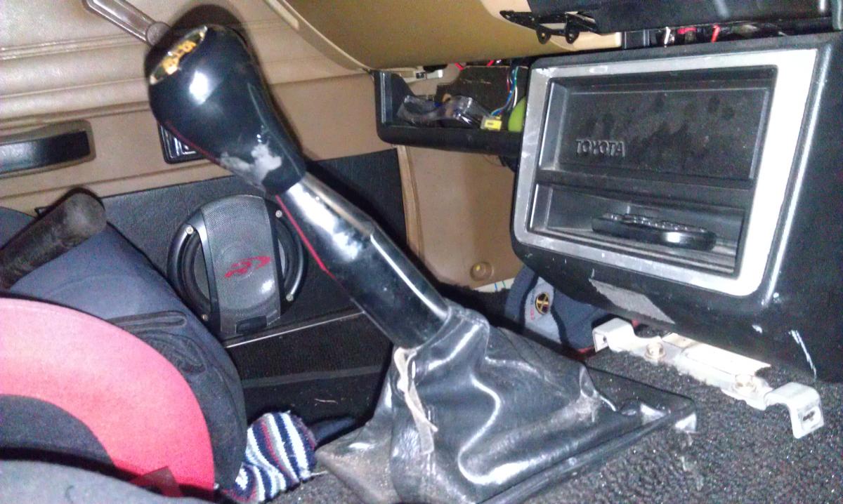

Willis Posted June 27, 2012 Report Posted June 27, 2012 Seriously though, the shifter looks cool. Quote
Grand Master of Awesome Posted June 27, 2012 Report Posted June 27, 2012 I have one of those, pretty good, reduces throw heaps and isn't super noisy like other ones. Quote

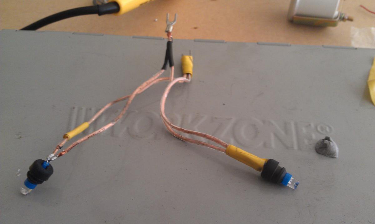

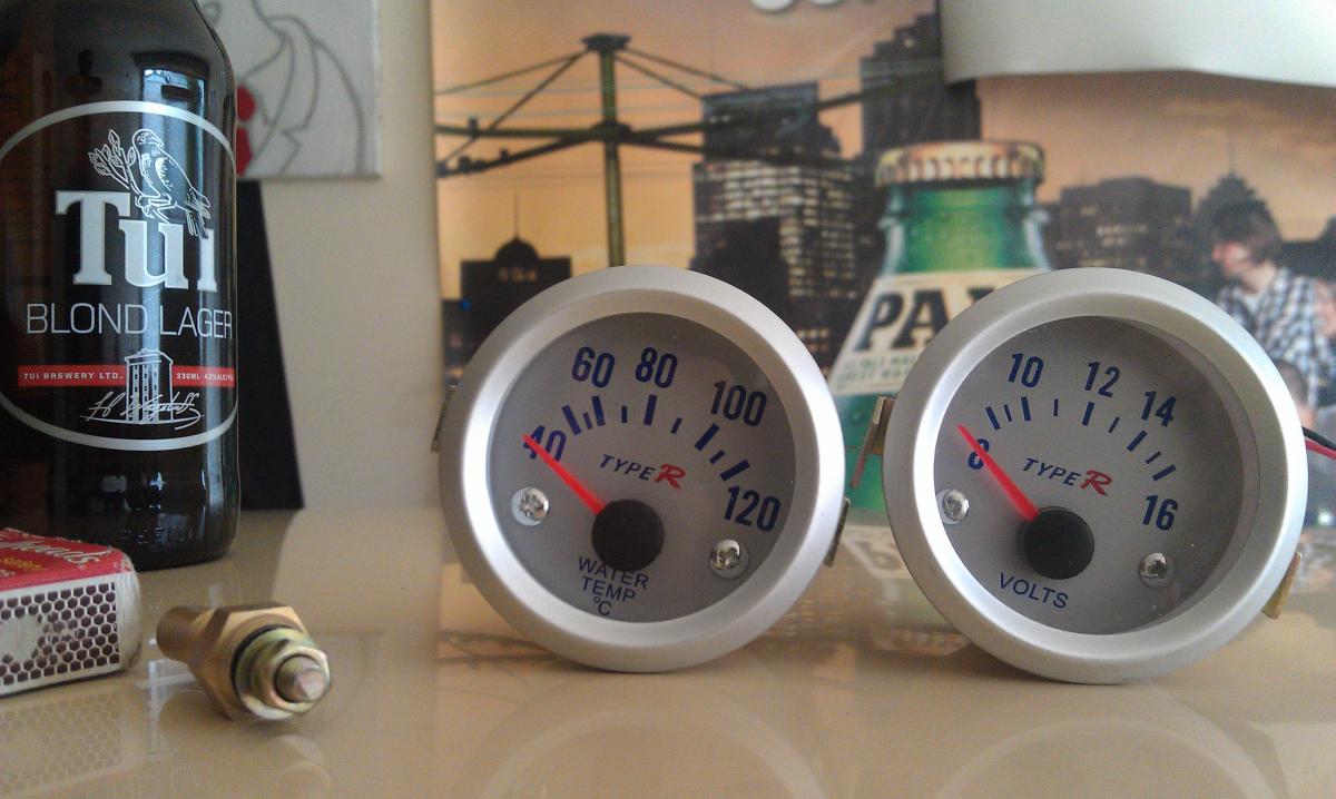

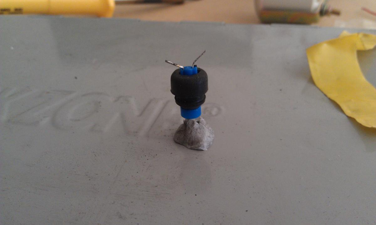

B.L.Z.BUB Posted July 7, 2012 Author Report Posted July 7, 2012 So I threw in some new gauges, cheap crap only one worked and even then I'm not sure if its right, serves me right for being a tight ass. Might buy some good digital ones. Wired up some blue LEDs to light them. My souldering stand. Ghetto wiring, at least its not twisted wires. Put the short shifter in. Got it all bolted up and it had heaps of play in it. So had to make a shim to tighten it up. Not sure if it was just mine or if everyone has had the same issue. Seemed like the aluminium spacer was about 1mm too thick. Again, can't complain for the price I suppose. Still have a huge pile of bits to go in, but too broke to buy the little things like tie rod ends and ball joints. And supposedly I'll need a lock spacer and steering arms and shit. *sigh* Someone buy my crap. Quote
B.L.Z.BUB Posted July 13, 2012 Author Report Posted July 13, 2012 Got refunded for those shit gauges. Got a new temp gauge with the refund from a person in Brisbane. If I press a button on it it changes colours. So pimp, its like a dance party. Questions: What else do I need for my front strut change over. What I have: XT130 struts with HSD coil over kit welded on Monroe GT short strokes Corona hubs/rotors/bearings 60 series brakes and rebuild kit Pajero master cylinder I am getting ye old tax return and I'm thinking : T3 after market AE86 steering arms AJPS lock spacer Ranko on here is doing this kit: Front chassis parts kit (2* lower balljoint, 2* rackends, 2* outer tie rod ends) Brake Pads (unsure on what) I want to get camber tops and they fit into the budget but am I missing something I should get instead? And as a streeter daily are they even necessary? I want to be practical as in : tyre wear, I don't drift, I don't care how "hektik stanced" my car looks. I suppose the lock spacer and steering arms are a bit 'drift wank' but my turning circle is poooooooooo If front camber isnt really necessary I'd rather spend the cash elsewhere like a rear sway bar or bushes. Opinions? Quote
