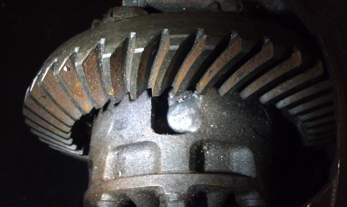

B.L.Z.BUB Posted May 29, 2012 Author Report Posted May 29, 2012 Horrible, horrible, noises coming from the diff, gonna pull the center out tonight and put the open one in. Never done it before, hope its as easy as google is making out. Quote
It's_AUDM_Yo Posted May 29, 2012 Report Posted May 29, 2012 Horrible, horrible, noises coming from the diff, gonna pull the center out tonight and put the open one in. Never done it before, hope its as easy as google is making out. Google is a smart guy hes taught me many things. Quote
B.L.Z.BUB Posted May 29, 2012 Author Report Posted May 29, 2012 (edited) had a look at spare center. It's locked too. FML. Pulled a handful of weld and shards of metal out of the housing. Hopefully it works until I find an open center. Edited May 29, 2012 by B.L.Z.BUB Quote
SLW42 Posted May 29, 2012 Report Posted May 29, 2012 Make sure you use the same crown wheel off your centre when you swap them over too, cause the gears are cut to be matched!! It's easy to swap centre's takes about an hour max Quote
B.L.Z.BUB Posted May 29, 2012 Author Report Posted May 29, 2012 (edited) Crown wheel? It's in. 2.5 hours with a lot of standing around. Quite happy with that for my first go. Edited May 29, 2012 by B.L.Z.BUB Quote
B.L.Z.BUB Posted May 29, 2012 Author Report Posted May 29, 2012 (edited) So this is what I pulled out of the diff housing. the inside of the centre is fcuked. Gear teeth and weld everywhere. The new locked centre is in and feels so much better, still want an open but it will do for now. Pics of the welds: When I bought it the guy said the centre got replaced but I'm thinking he left the shit one in and the spare was the good one. Also Edited May 29, 2012 by B.L.Z.BUB Quote
