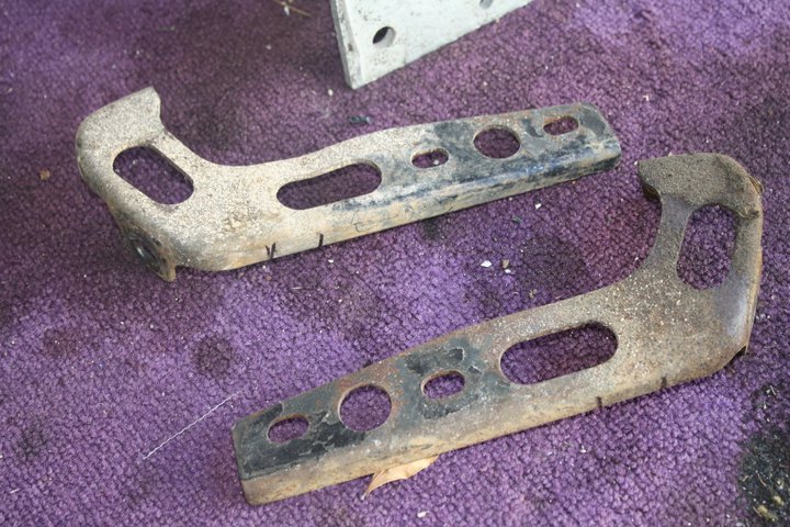

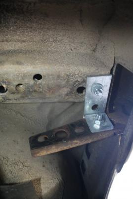

Willis Posted April 5, 2012 Report Posted April 5, 2012 So what's the dealio with doing the xE3x (or whatever they are) chrome bumpers? Just the same as the KE70 ones? Shorten the brackets etc? Pretty keen on doing it now... Quote

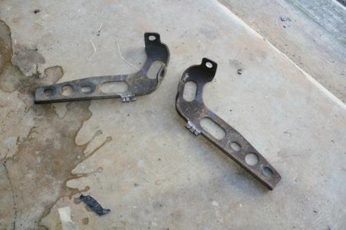

B.L.Z.BUB Posted April 5, 2012 Author Report Posted April 5, 2012 The rear ones are bolt in with a bracket available from any hardware store and a little bit cut out of the mount. The front ke30 mounts just need to be heated and twisted. And the 70 rad panel needs a little massage and the horns relocated. Have pics of the rear but not the front. Quote
