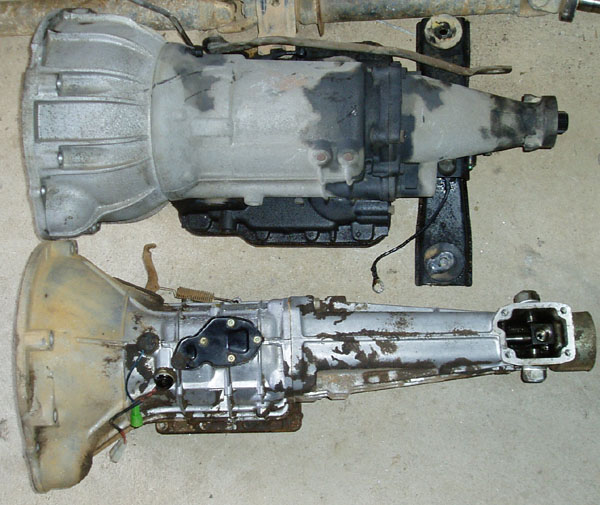

Des Posted December 5, 2011 Report Posted December 5, 2011 (edited) Will a trimatic fit into a ke11 to replace the toyoglide ? Linkages and tail shaft isn't an issues but tunnel clearance is. Edited December 5, 2011 by AE70 Quote

oh what a nissan feeling! Posted December 6, 2011 Report Posted December 6, 2011 I changed my ke25 from toyoglide to trimatic, tailshaft is different length, crossmember is different too. Pretty much a waste of time i found, the final drive is still the same, you just have one more boring gear to get there.... Quote

SLO-030 Posted December 8, 2011 Report Posted December 8, 2011 I think you will struggle fitting the Traumatic into the KE11 tunnel. Not sure what they're like size wise when compared to a Toyoglide, but they're HYOOOGE compared to a K40 or 50 Quote
