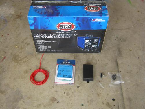

zeph_KE70 Posted December 8, 2011 Author Report Posted December 8, 2011 Her ass. Electric fan soon to be installed :yes: I've been busy with exams and precious sleep, so by next week i should upload (hopefully) every second day. Cheers. Quote
zeph_KE70 Posted December 10, 2011 Author Report Posted December 10, 2011 Early christmas presents for the 70. :laff: Quote
