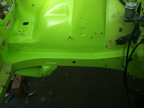

kickn5k Posted November 25, 2011 Author Report Posted November 25, 2011 (edited) It's an angry sounding little bugger! Top work Stu! :y: Thanks Luke, she`s straight off the turbo in the vid. hanging to get it signed off so i can start the rola. can't wait to see the corolla in the flesh :fuzz: :lol: So that Evan can see the 11 in the flesh!! :yes: So specs now are: Engine: Nissan dr30 skyline FJ20ET G/box: dr30 5spd Suspension: Front: ADM r31 nissan skyline front struts converted to coilovers by peders Rear: Same as previous Brakes: 200b master cyl 180b "small can" booster remote mount resis Front: r31 rotors and calipers Rear: r31 rotors and caliper. Radiator: Custom "Race Radiators" aluminium rad with notched tanks for ooler plumbing. Fixing aftermath from leaky master cylinder. from this to this exedy hd peders r31 coilies relocated washer bottle. Thats all i can upload this post, i`ll post some more later. Stu. Edited November 26, 2011 by kickn5k Quote
kickn5k Posted November 26, 2011 Author Report Posted November 26, 2011 (edited) Back again!! With the FJ20 in a 1600, the long inlet manifold hits the brake fluid bottles. I tried smaller height bottles still not enough. So i made this up as the tilton/willwood type stuff was super expensive. 2 x protech bottles = $40 2 x speedflow fittings, coppers washer = $65 2 x remote mount cups = $20 some brake fluid proof hose = $10 Well less than half the price of 2 tilton bottles alone then i`d still need fittings etc. I don`t have a photo handy of the radiator but i have these. Couldn`t recomend "race radiators" enough do a wonderfull job and very reasonable price!! Cooler plumbing notches Top veiw cooler sitting in running heater lines I`ll load some more from the phone on to the laptop later and get them on here tonight. :dance: stu. Edited November 26, 2011 by kickn5k 1 Quote
