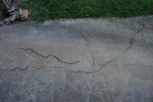

rian Posted January 4, 2012 Author Report Posted January 4, 2012 (edited) Time for an update RC, here's how the car has been sitting for the past few weeks. It hasn't gone anywhere since I got it. Okay so I started doing some work to get the brakes working again: I started to take the hardline to the diff out, but my spanners were stripping the fittings, so I just cut the line and use a 6pt socket to get them off. Here you can see where the line had burst and sprayed fluid on the under side of the car: Then I got the line out, I decided to replace the line that goes to the rear left drum as well as it was very corroded. Here's the hole in the line: And here are the new lines that I got... mmm shiny :happy: Working on the car today was approximately 9.5 million times more annoying that I was anticipating. The clamps that secure the brake + fuel lines the the chassis were in the most annoying locations and everything was so greasy and smelly, I have the biggest headache from being upside down and smelling brake fluid for hours. Wah wah wah... Oh and here's a pic of my(sort of) clean gearbox: Hopefully I'll have the car back at my parents house soon where I can start doing some work on it, one of my friends is a welder/boiler-maker-guy and I might try and convince him to do some seem welding. :wink: Edited January 4, 2012 by rian Quote

rian Posted January 5, 2012 Author Report Posted January 5, 2012 (edited) Okay so bending the hardline and installing it was the shittest thing I've ever had to do with cars, the bends in the new line seem to match the bends in the old line until you try and install it and realise your bends are wayyy off! Jacob I got most of the brackets in but the one up beside the gearbox was impossible, I took the bracket and stamped on it until it was out of shape therefor creating an excuse to not use it :lolcry: But it's all done now, bled the brakes etc. took it for a test drive and it pulls up well, though the steering is a bit wonky and there is a horrible rattle in the front somewhere. Ill give everything another check over tomorrow to make sure it's all safe and then I'm taking it home on Monday. Time for some pictures: The new brake lines that I bent up, they looked correct until I tried to install them: The brown car, now called Mustard Butt, finally made it out of the garage: And here's some pics of Mr Blue KE and Mustard Butt together, keto love <3 Figured out how the stereo works too so now I can listen to music on the trip home! Edited January 5, 2012 by rian Quote

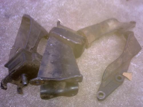

drkbrth Posted January 5, 2012 Report Posted January 5, 2012 On 1/5/2012 at 9:57 AM, fumeck said: what are those long mounts? ...you mean the break lines? 1 Quote
fumeck Posted January 5, 2012 Report Posted January 5, 2012 (edited) no the long mounts next to the engine mounts. Edited January 5, 2012 by fumeck Quote
rian Posted January 5, 2012 Author Report Posted January 5, 2012 (edited) On 1/5/2012 at 10:09 AM, fumeck said: no the long mounts next to the engine mounts. They would be T50 to 4A gearbox stays/brackets/mounts, they help secure the gearbox to the engine. Though I here lot of people don't use them so they can't be that important. Edit: wrong person Edited January 5, 2012 by rian Quote
