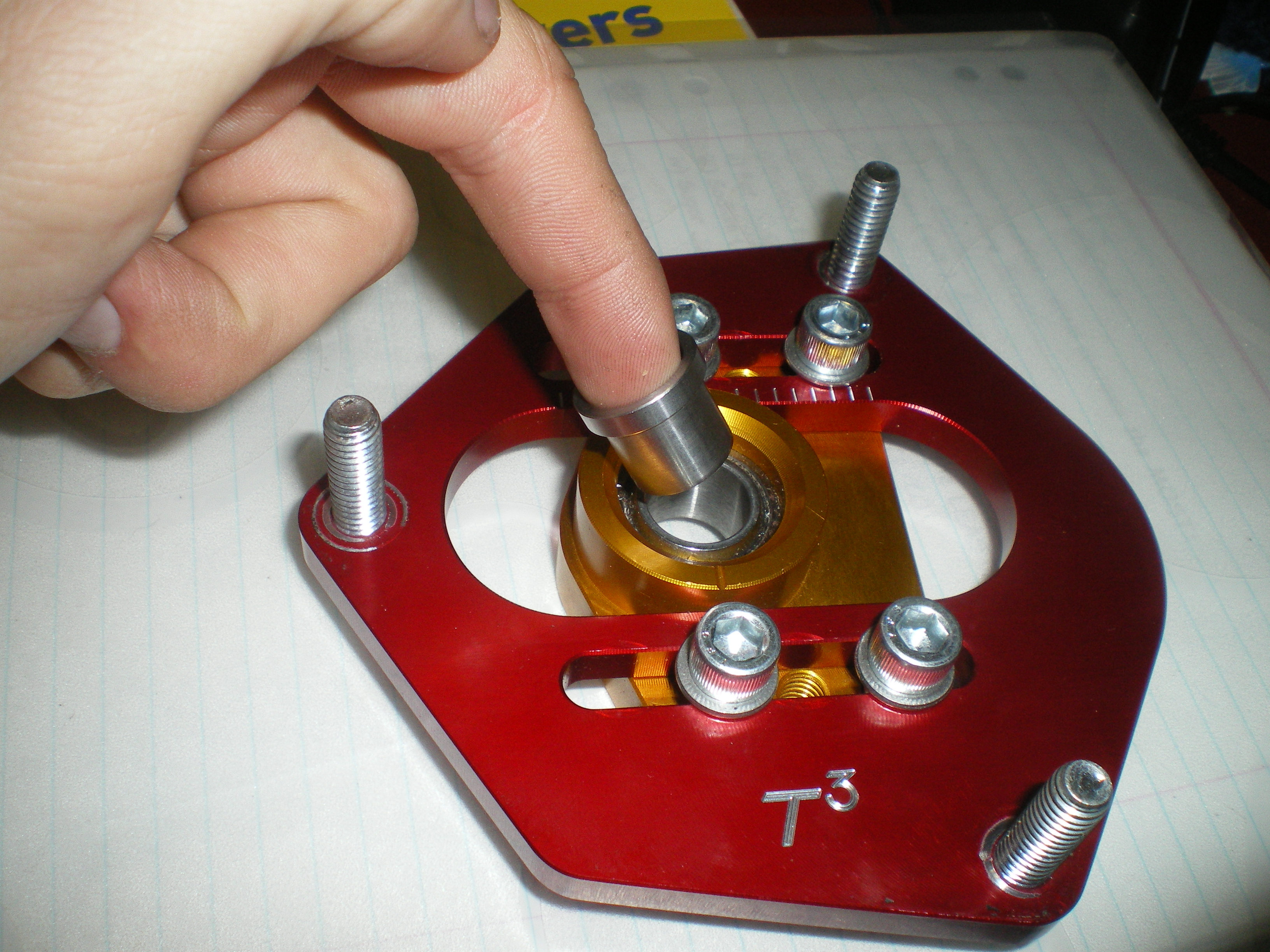

rian Posted December 14, 2011 Author Report Posted December 14, 2011 (edited) Thanks Zeph! So lately I've noticed a squeaking/twisting sounds coming form my suspension in the blue KE70 when I turned. I assumed that the spring seat was somehow binding to the camber plate. But when I popped the bonnet and got someone to turn the steering wheel with the wheels still on the ground it appeared that the upper spring seat was spinning with the spring. Though it definitely made a funny sound when the wheels were turning. I decided to pull it all out and check what was going on, and what I found was that my T3 camber plate bearings were not spinning. WTF?! I only just put them in and they've already stopped working! I think I might contact T3 and see what the go is. I was also wondering if it made any difference if the little spacer thing went in the bottom or top of the bearing, I've been using it in the top. Refer to pictures below: Spacer thing in the top: Spacer thing in the bottom: Edited December 14, 2011 by rianwest Quote
rian Posted December 14, 2011 Author Report Posted December 14, 2011 (edited) I just put it all back together, the noise randomly stopped. Though the camber plate bearing still does not spin, instead the shock shaft spins inside the shock. I've never really paid attention as to what part normally spins: the bearing in the camber plate or the shock shaft inside the shock. So I'm not sure whether this is a good result or not, but as long as it doesn't wear the shock out any quicker than normal I couldn't really care :happy: Edited December 14, 2011 by rianwest Quote
B.L.Z.BUB Posted December 14, 2011 Report Posted December 14, 2011 Did you pack the bearings? Or are they sealed? Weird issue :hmm: Quote
rian Posted December 14, 2011 Author Report Posted December 14, 2011 Sealed I think. I'm going to contact T3 and see if this happens often. Quote
Grand Master of Awesome Posted December 15, 2011 Report Posted December 15, 2011 Spaces goes at the bottom, you need the t3 top hat system to go with it. There was a big thread on ae86dc about t3 camberplates not too long ago if you do a search. If you get Rota's ill be disappointed, need 13's or 14's only. 15's look stupid on KE70's. Quote

rian Posted December 15, 2011 Author Report Posted December 15, 2011 On 12/15/2011 at 4:44 AM, destroyer said: Spaces goes at the bottom, you need the t3 top hat system to go with it. There was a big thread on ae86dc about t3 camberplates not too long ago if you do a search. If you get Rota's ill be disappointed, need 13's or 14's only. 15's look stupid on KE70's. Spacer goes in the top according to T3, I have the T3 upper spring seats also. 15s look fine on KE70s, besides this is a track car not a fully hectic JDM wannabe car. On 12/15/2011 at 4:49 AM, ke70dave said: looks are a personal choice, but good luck finding any decent tyres in 14"! ^What I was thinking. Quote
