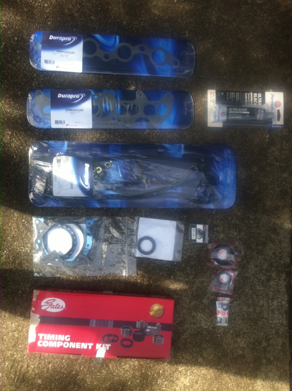

I also ordered new front main seal, rear main seal, cam seals, cam cover seals, spark plug cover seal, dizzy o-ring, timing belt kit and intake and exhaust gaskets. No more leaks hopefully! The engine was so gross and oil when I got it.

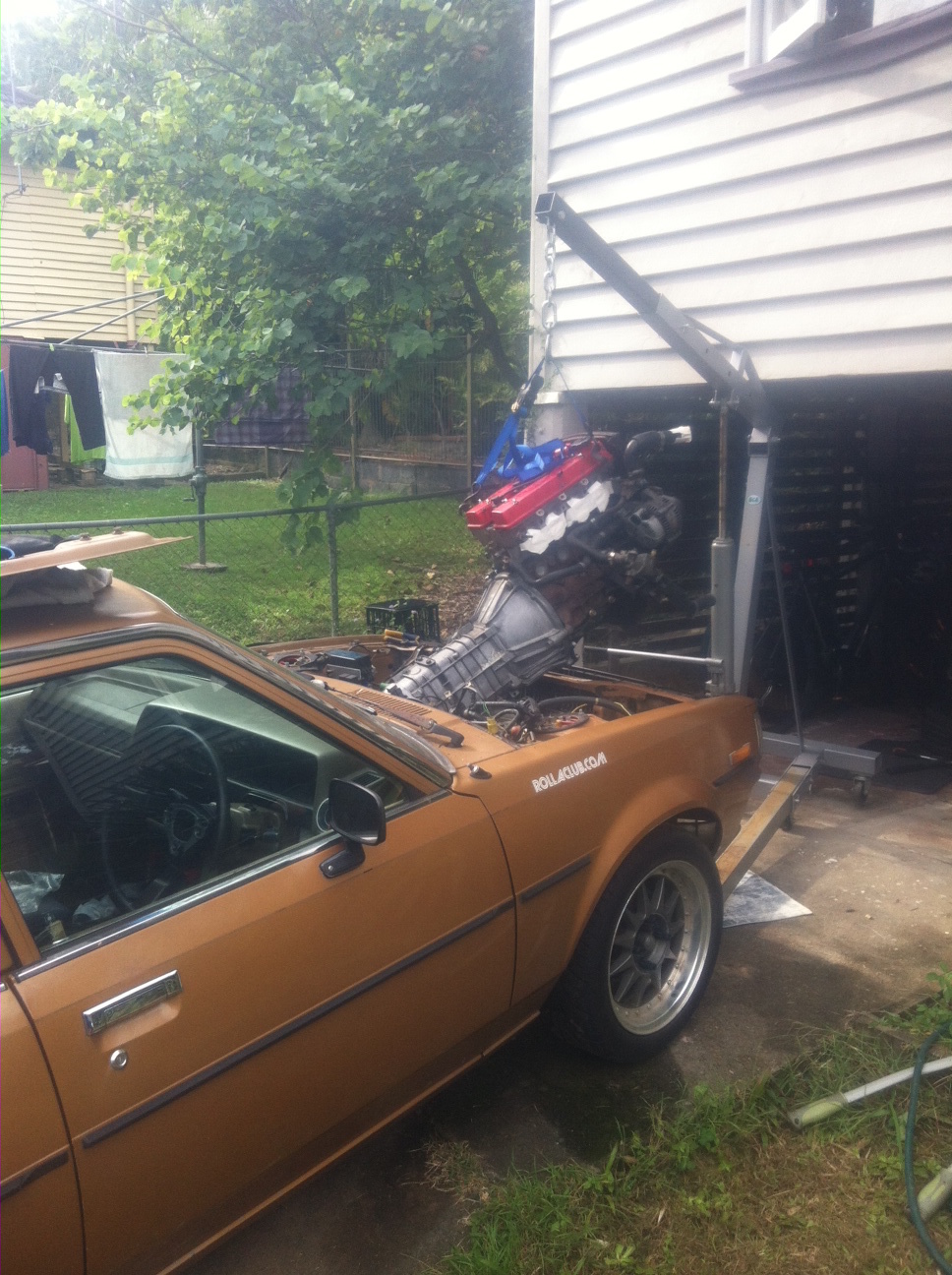

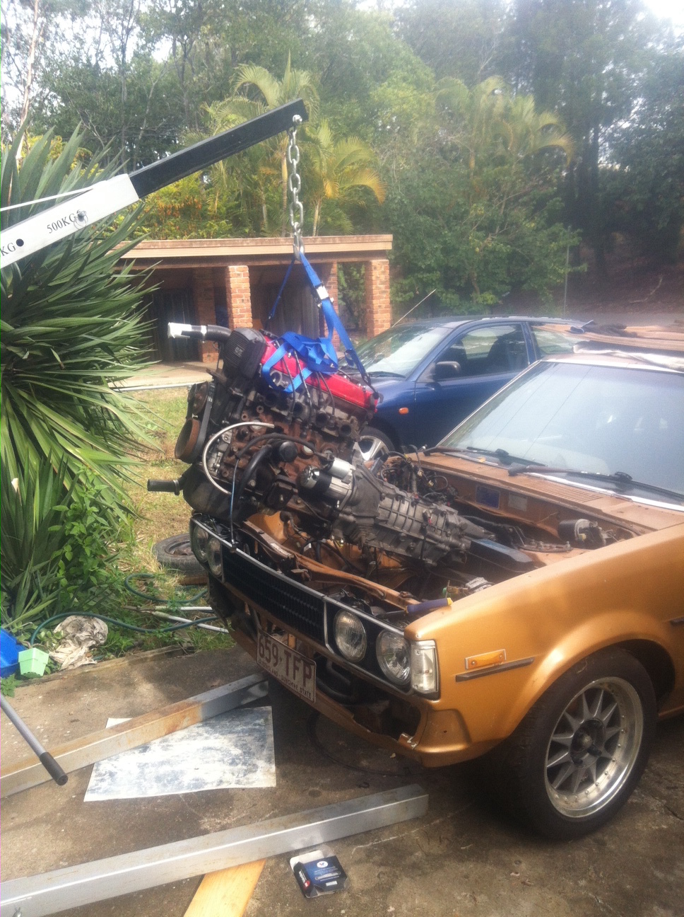

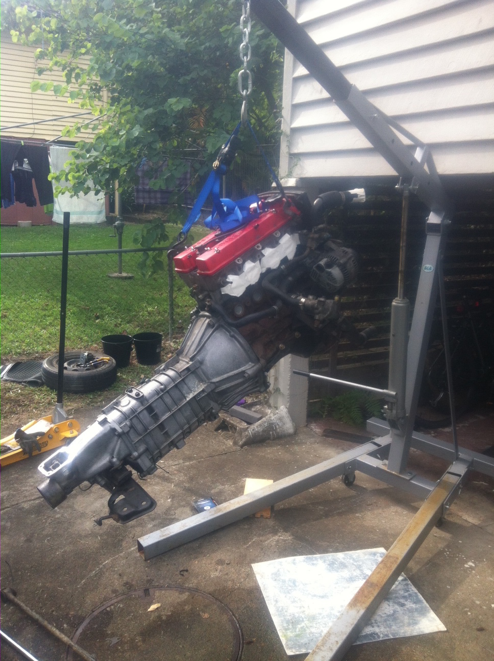

I pulled the old engine while I waited for parts to get the new engine ready:
Then the new seals arrived:

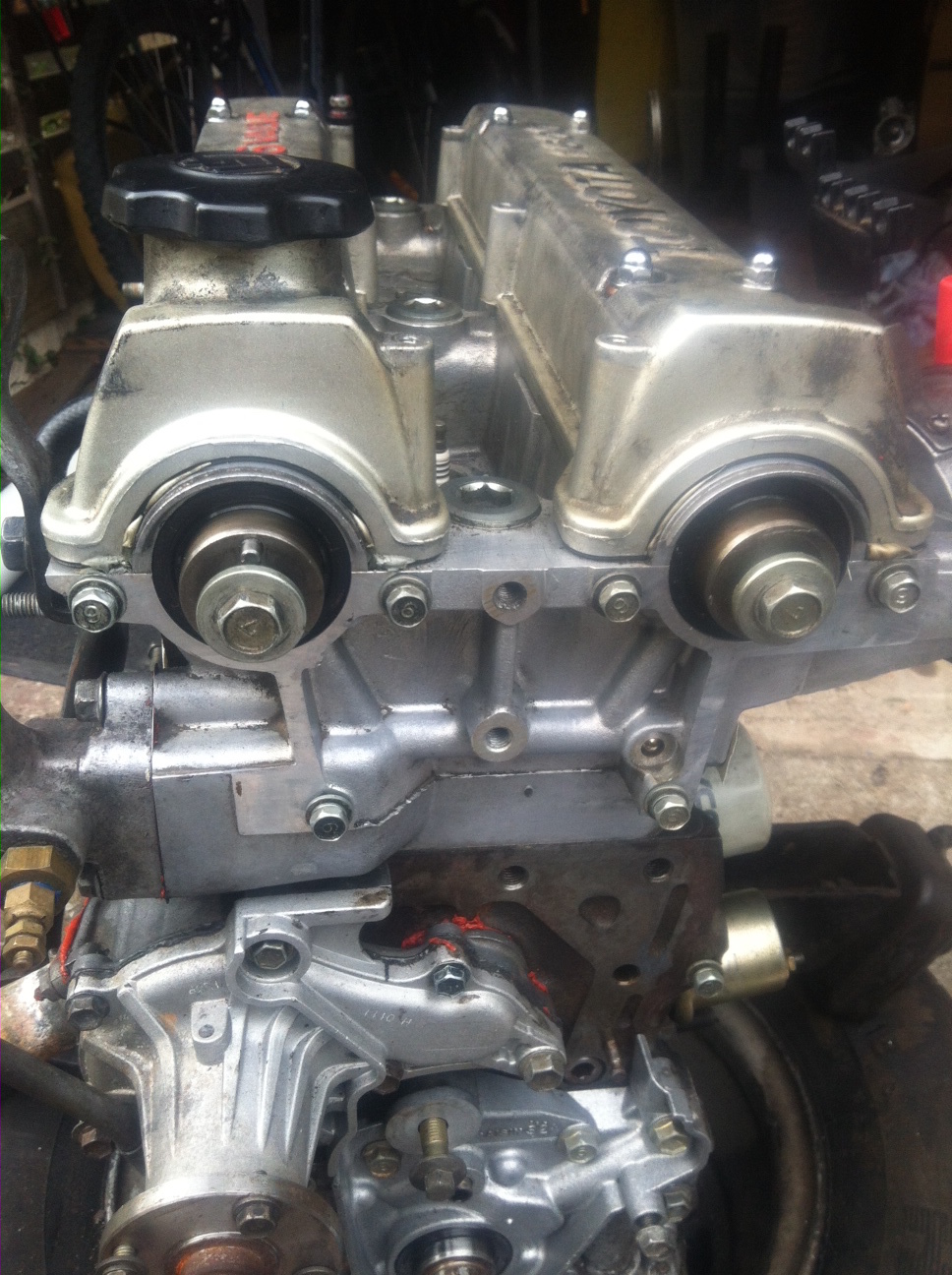

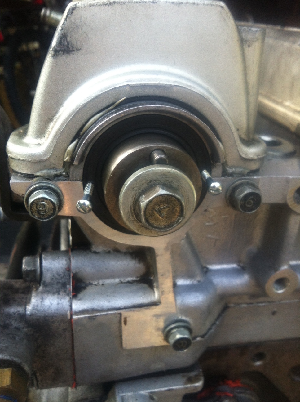

Cam seals out:

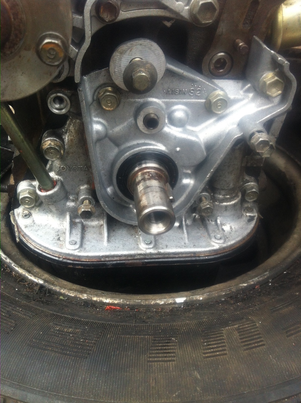

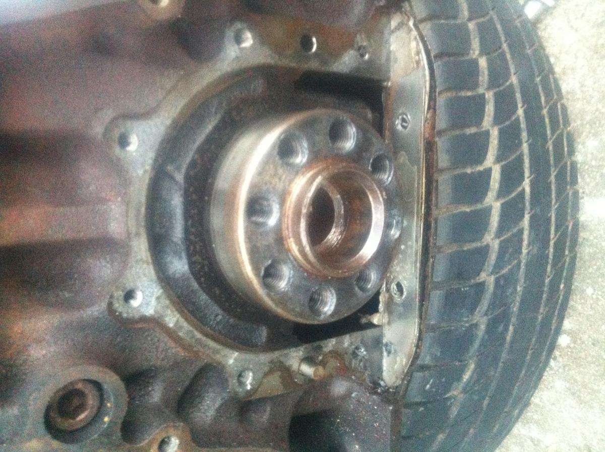

Front main seal out. I may have put a tiny scratch in the crank :osama: but I hit it with some wet 2000 grit and it came up pretty smooth, hopefully it doesn't chew the new seal:
New cam seals in:
New crank seal in:

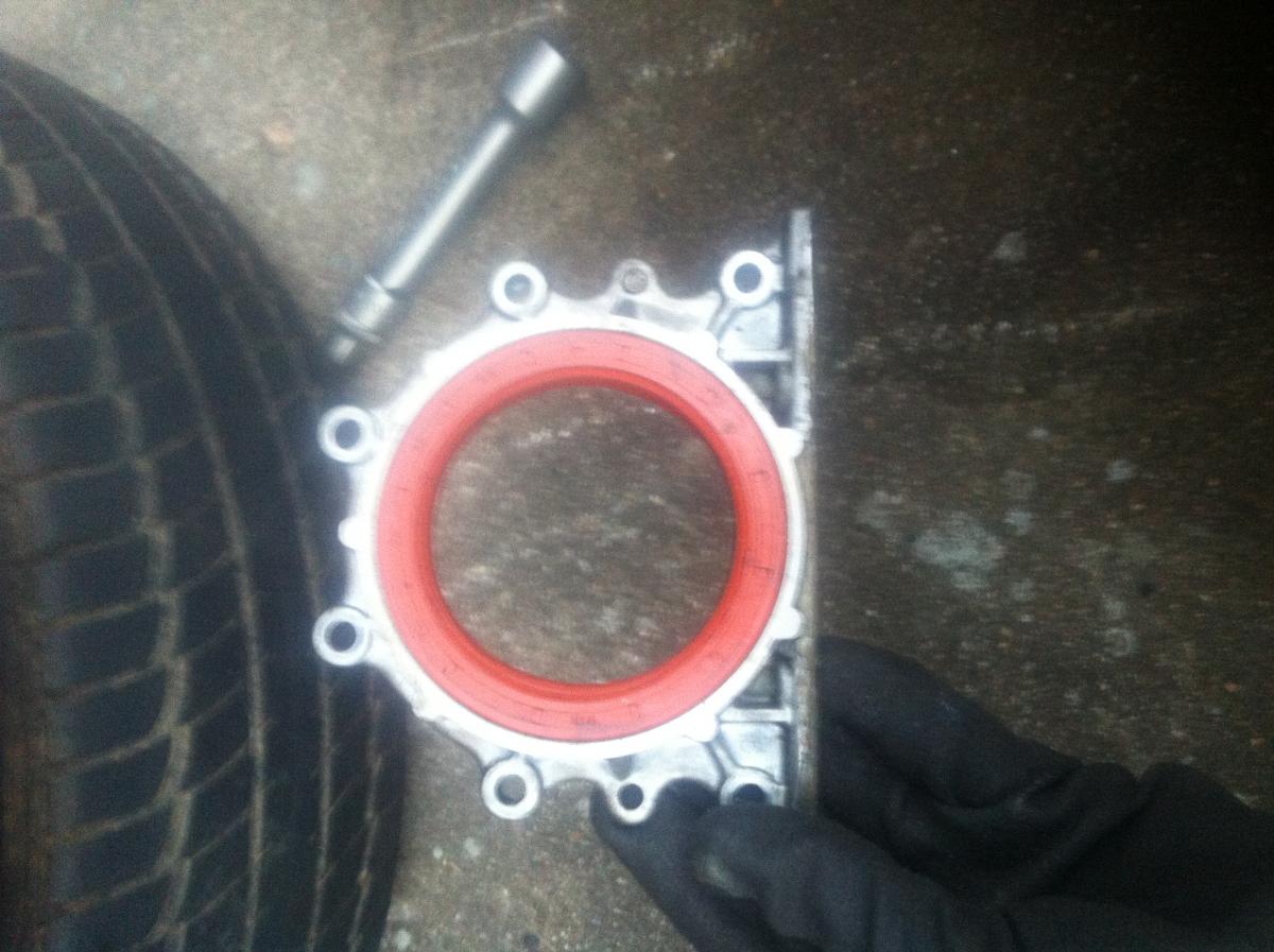

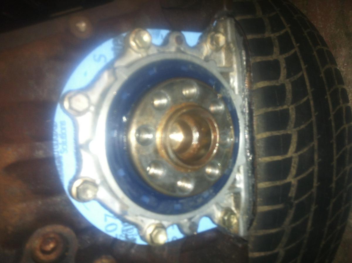

Got some time to replace the rain main seal as well. The seal came with the carrier gasket so I replaced that as well with a bit of Ultra Black in there for good measure.
Carrier out:
Cleaned up the mounting surface:
New seal and gasket in:

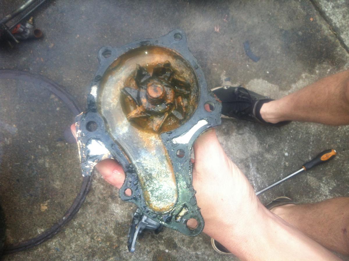

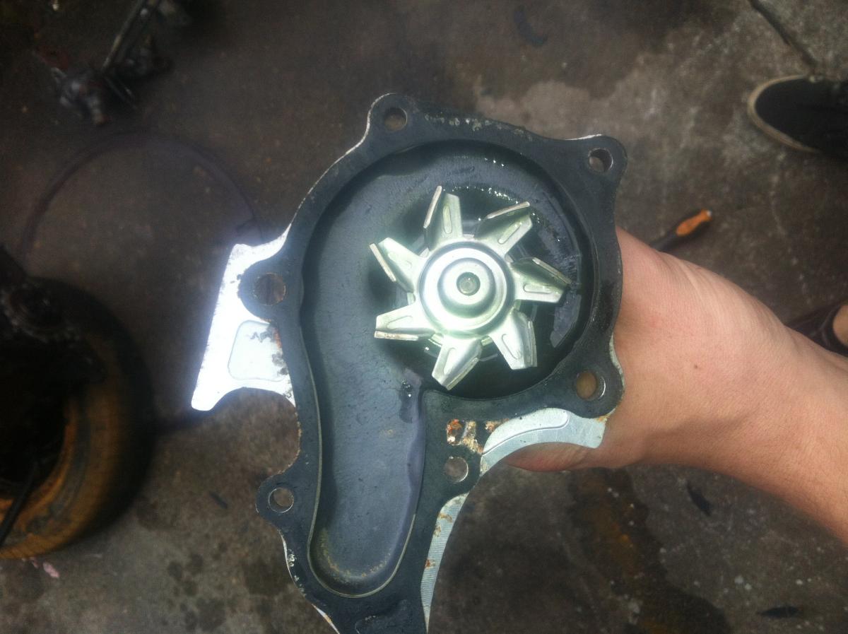

New pump:

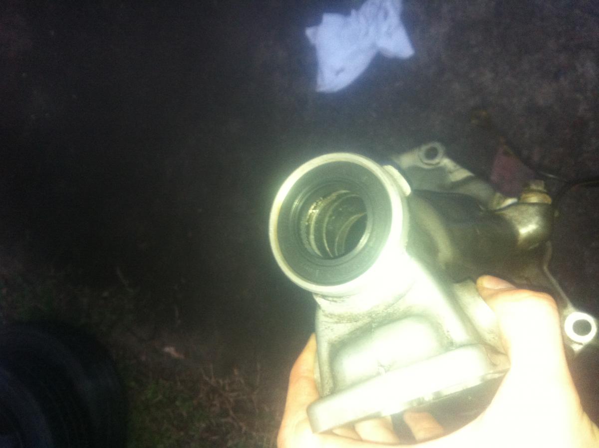

Pulled the input thingy off:
Pulled the old seal out and cleaned up the seat:
New seal in with a bit of grease on the inner lip:

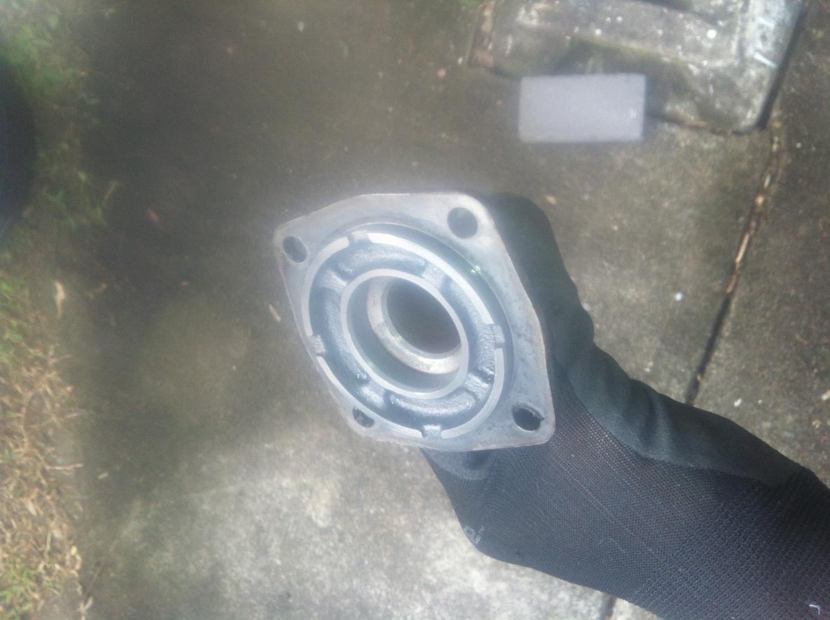

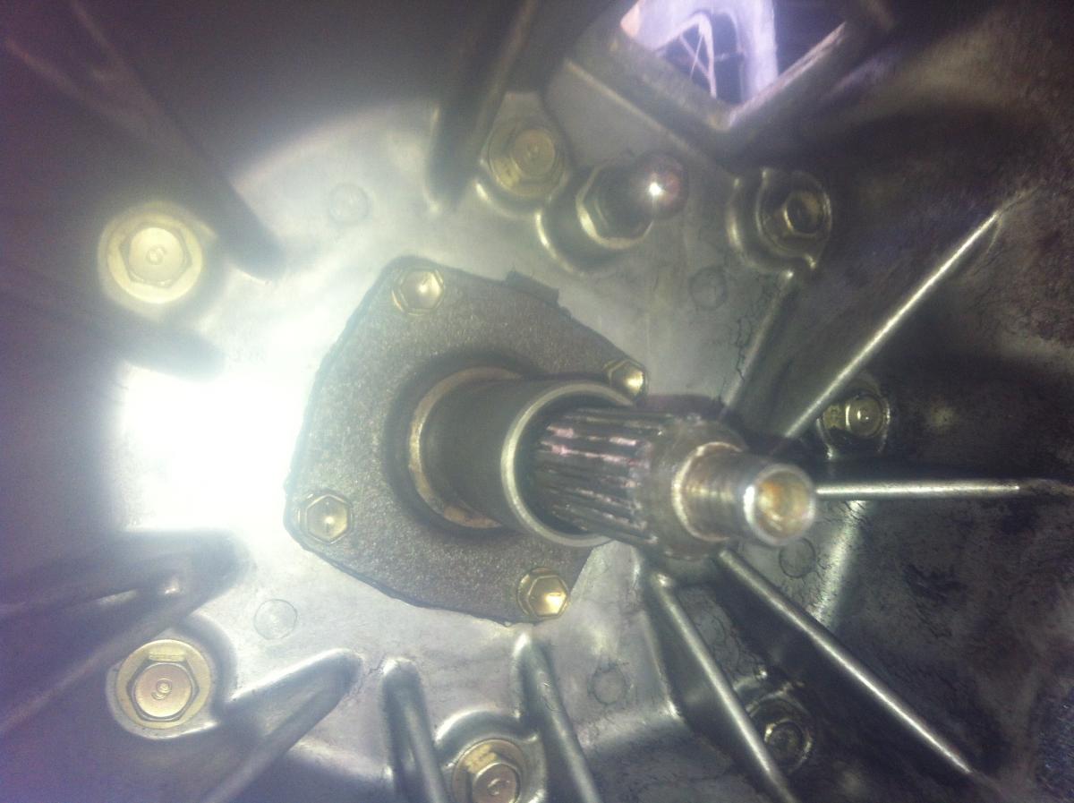

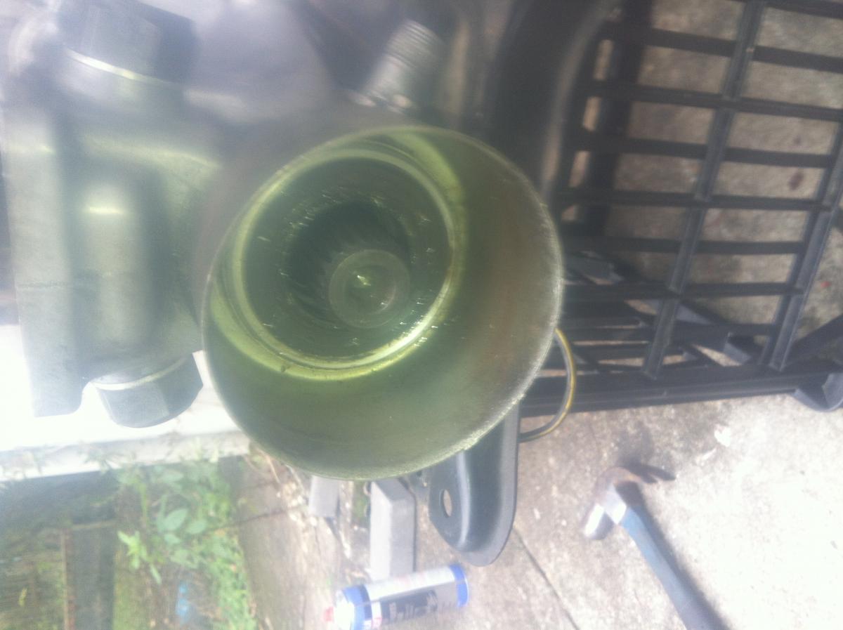

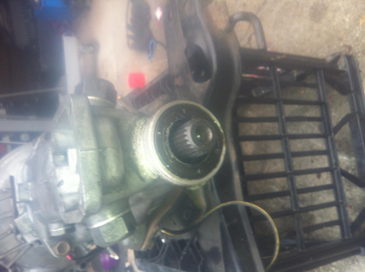

Now for the output seal. What a pain in the butt.
I removed the output shroud thingy and it looked fairly straight forward to remove the seal:
I initially though "oh yeah I'll just pry it out".
Didn't work.

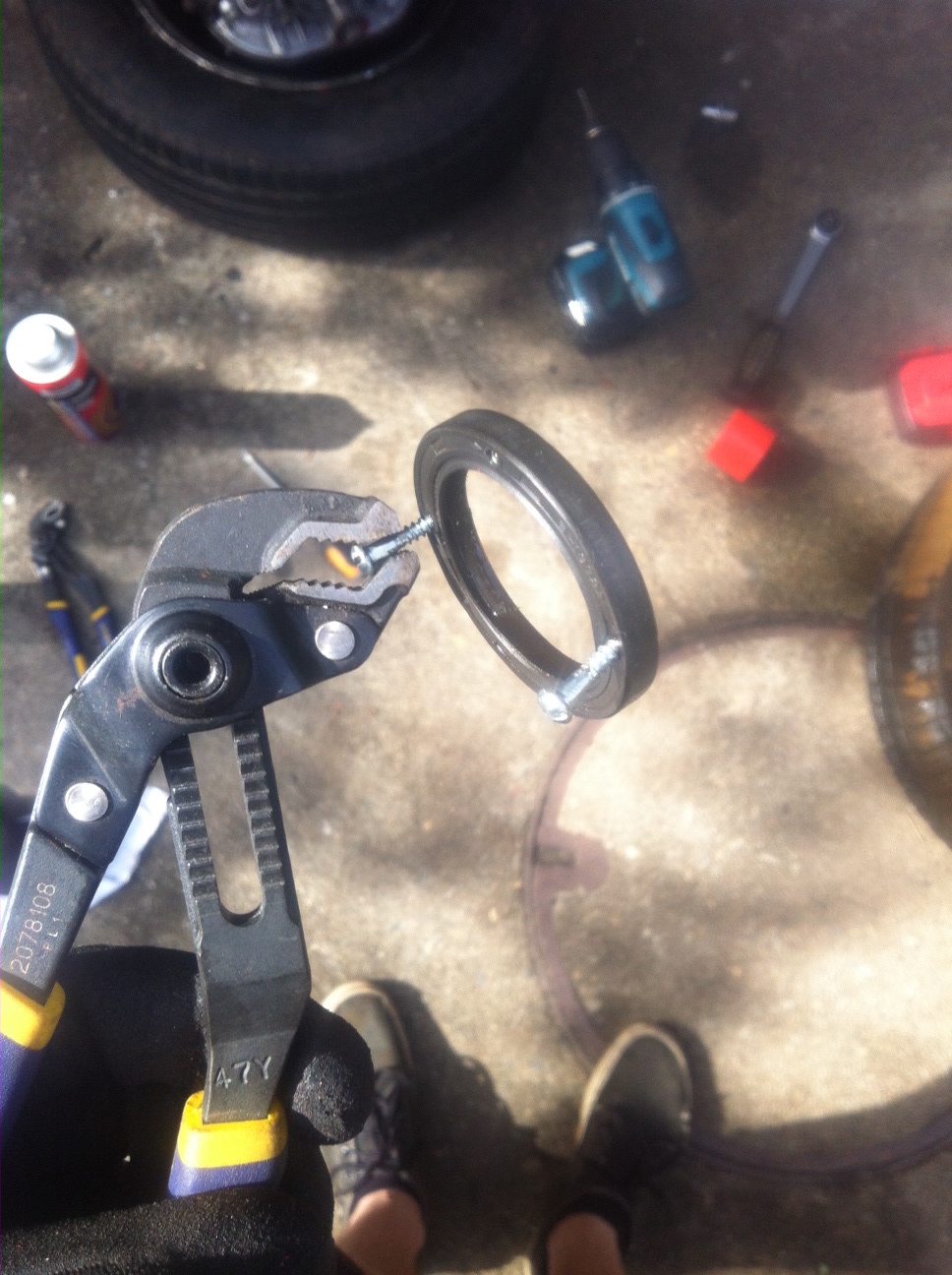

Then I tried to drill it, drive in some screws and pull it out with pliers.
Didn't work.
Then I thought "ʞ©$ɟ it, I'll just pull the extension housing off"

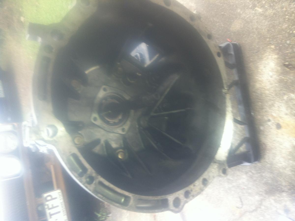

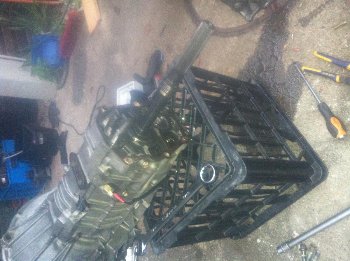

Pulled the extension housing off, old cruddy oil everywhere:
Then I tried to pry it out again now that I could actually get some leverage.
Didn't work.

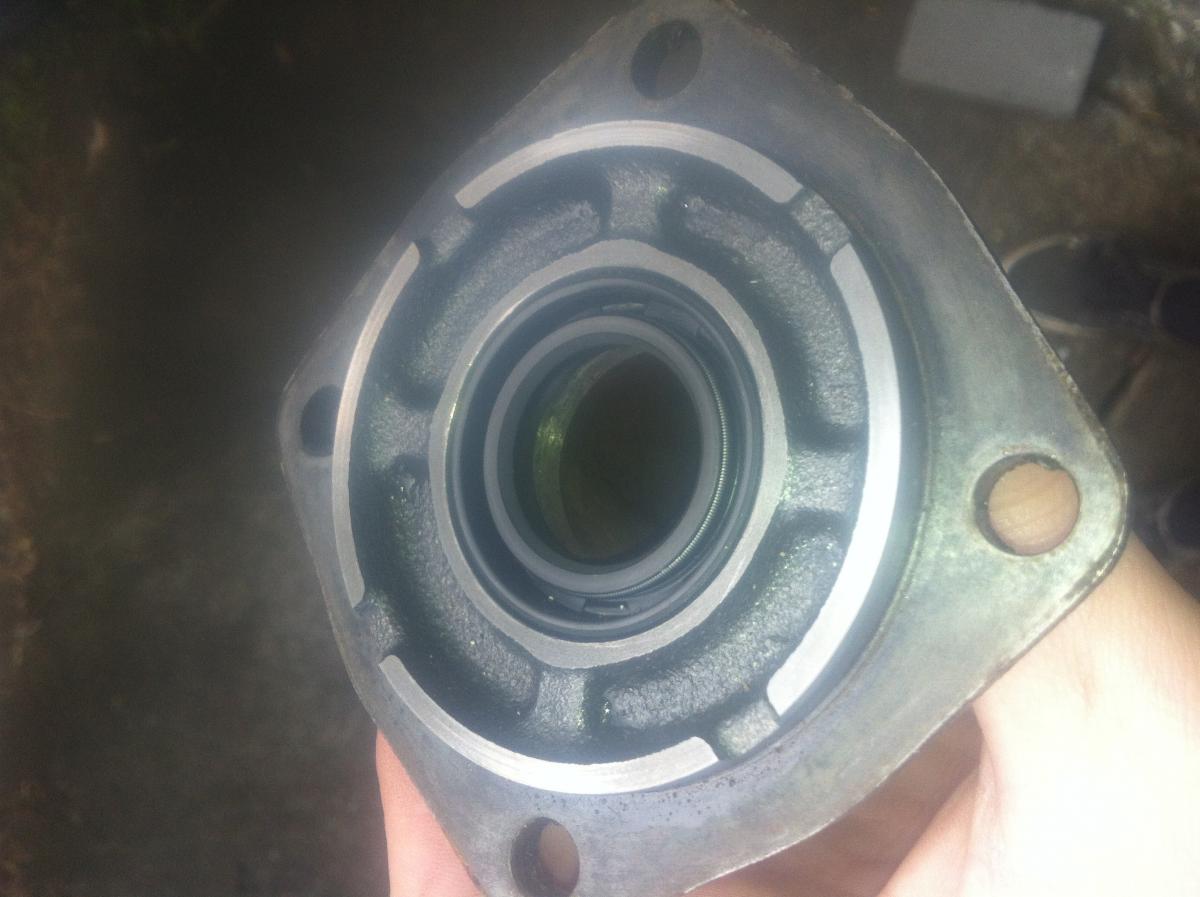

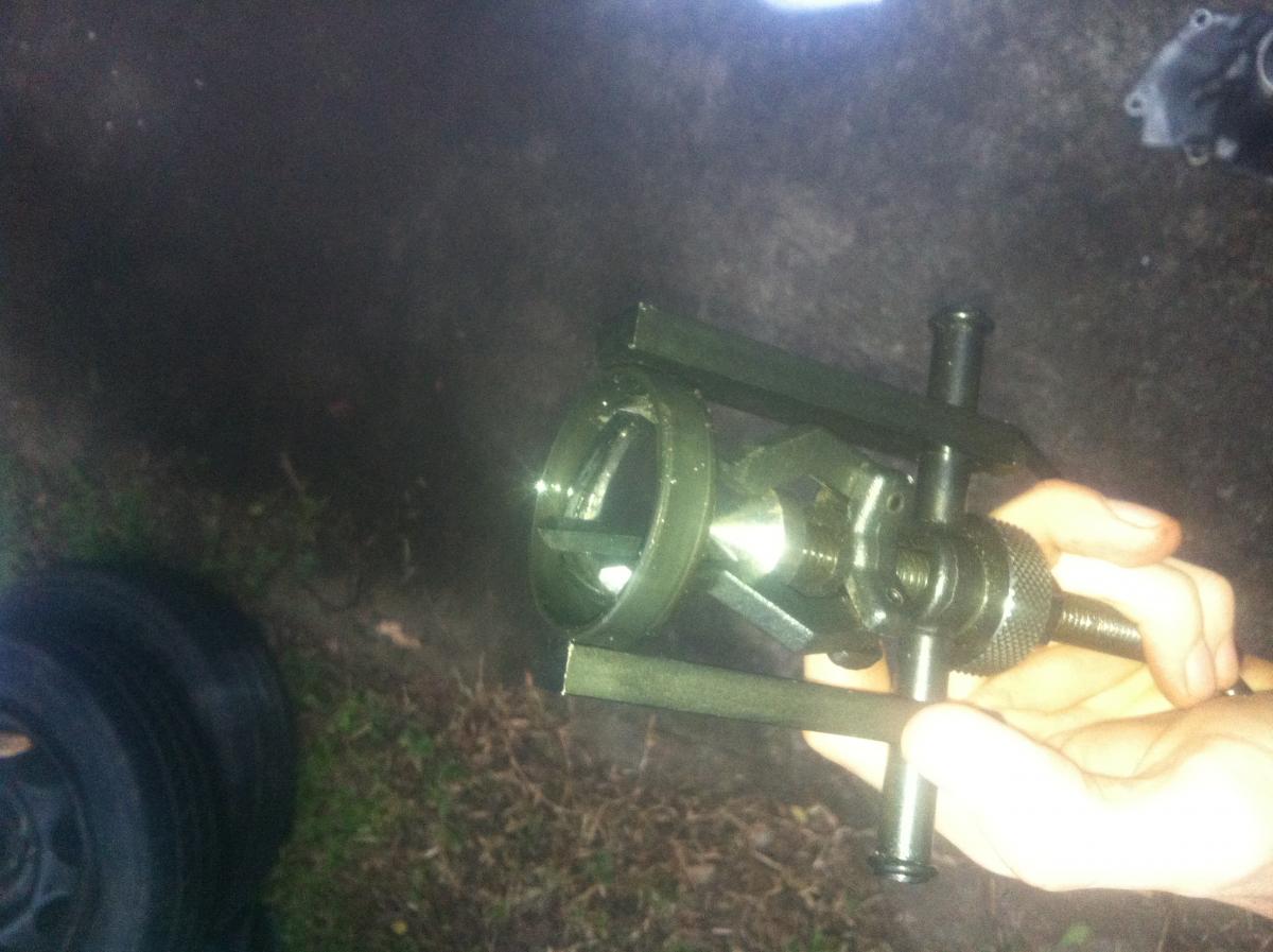

I ended up needing to use my spigot bearing puller to get it out, and even then it was pretty tight:
Cleaned up the seat and chucked the new seal in:

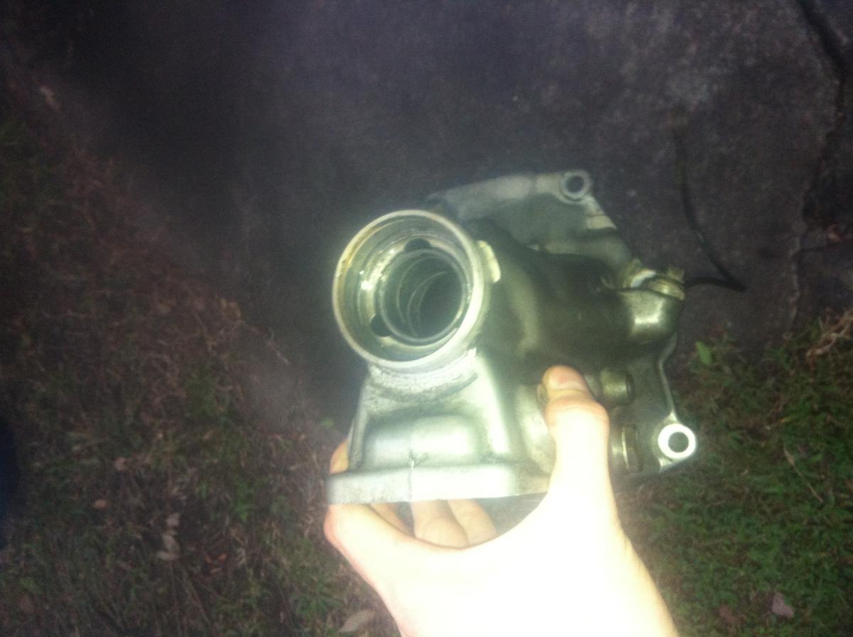

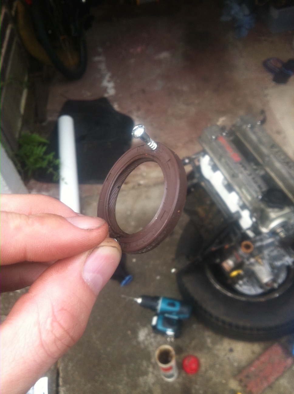

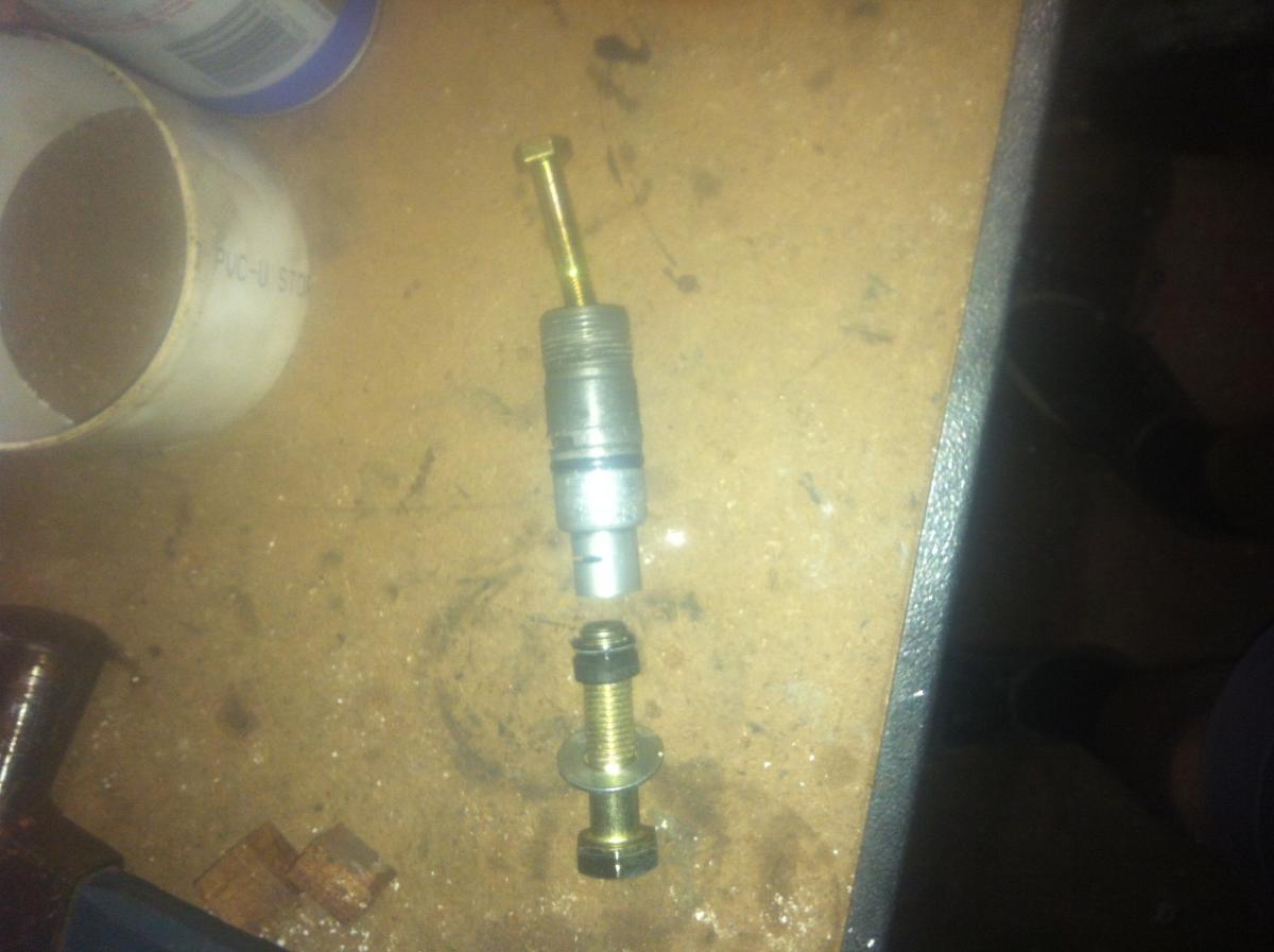

Then onto the speedo pinion seal.
The pinion gear housing was fairly tight and took a bit of force to get out, I didn't replace the O-ring because I forgot to get one and it was dark by this time. Got the housing out:

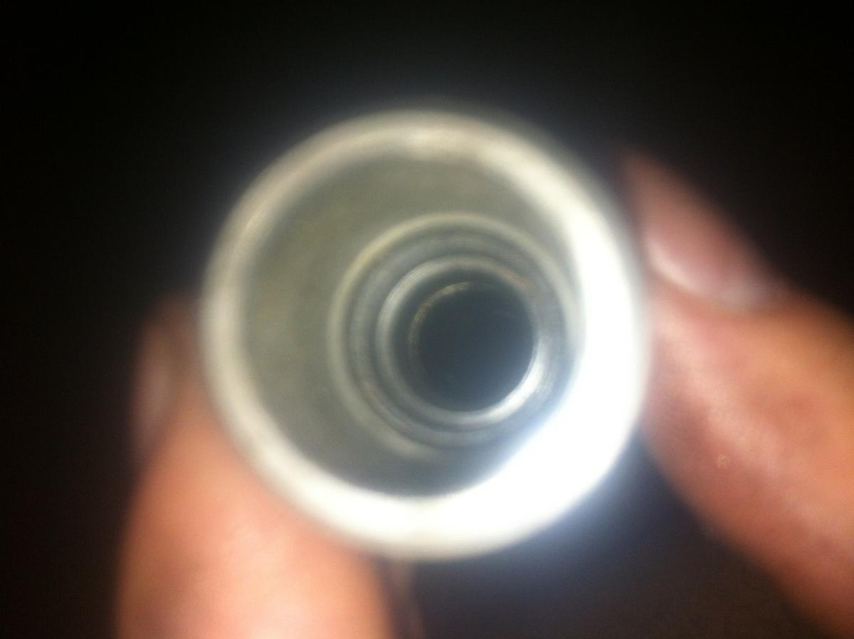

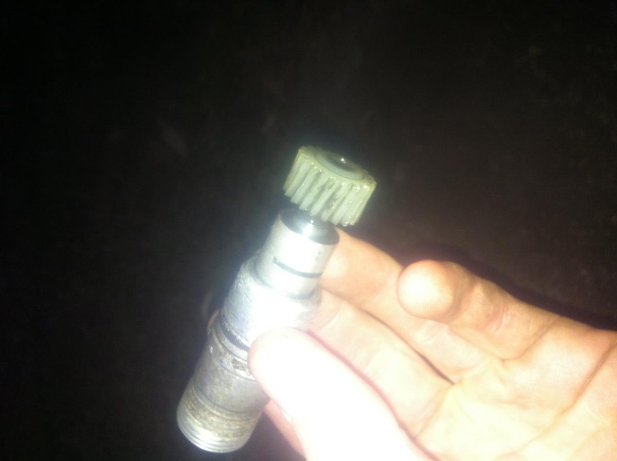

Pulled the pinion gear out and found the seal inside, wondered "how the ʞ©$ɟ am I going to get this out?":
But lucky I had an M12 bolt that threaded into the seal tightly, then I secured the speedo pinion housing in the vice and used a smaller bolt and a hammer to tap it out from the other side. Worked a treat:
Pressed the new seal in with a deep socket and chucked the pinion gear housing back in the extension housing, then I wrestled the extension housing back onto the gearbox (ʞ©$ɟing shifter forks were so fiddly, especially when your workbench is a milk crate) and sealed it up with more Ultra Black. If I get anymore gearbox leaks i'm going to be pissed.
