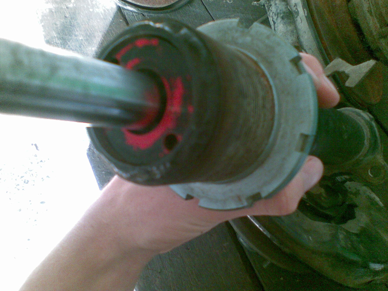

rian Posted November 21, 2011 Author Report Posted November 21, 2011 I would normally use multigrips or a vice or whatever but the gland nut sits down inside the strut tube by a few millimeters and there is no way to get a grip on it other than using that tool or one of those universal disc changing tools for an angle grinder. Which is probably what I will use as they are cheap, but really flimsy. I'll get pics soon, threads are better with pics! Quote

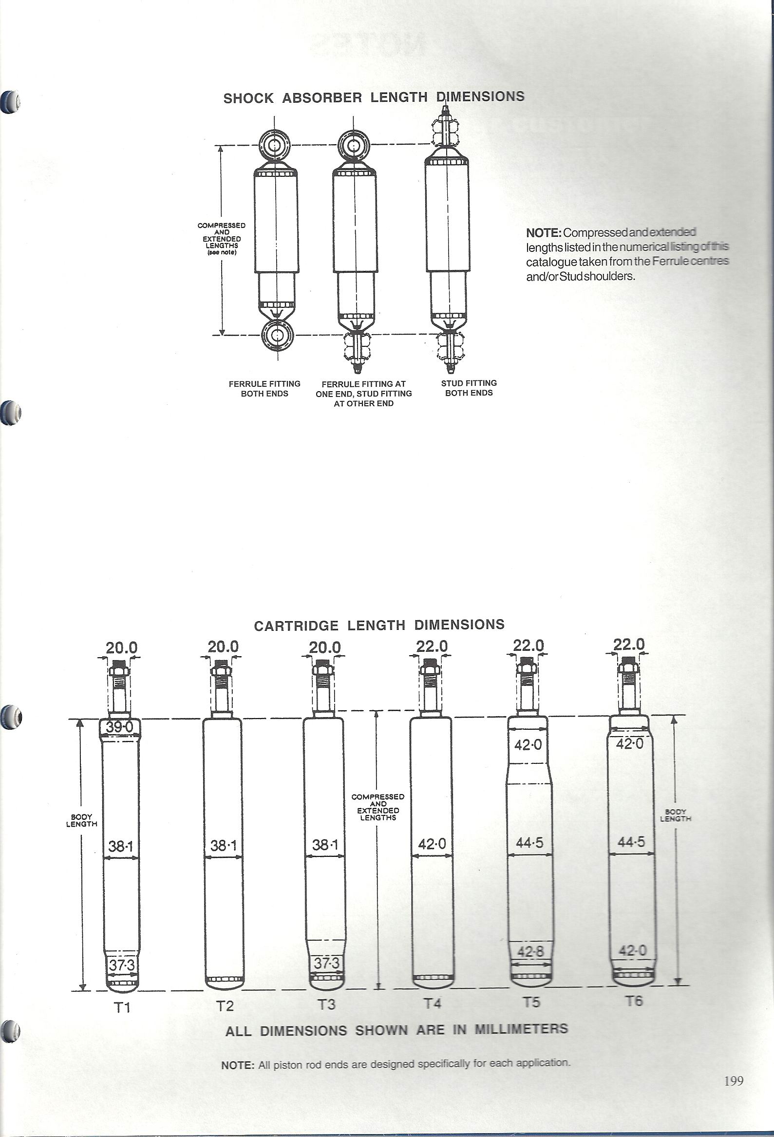

towe001 Posted November 21, 2011 Report Posted November 21, 2011 On 11/21/2011 at 11:20 AM, rianwest said: My god its a medieval weapon of war. Another idea is a monkey wrench on the gland nut and the bottom of the strut in a vice or vise verse. Quote Then I will take some measurements and see what insert I can use in the strut. The inserts are T6 cartridges (44.5mm diameter). If you jump onto the Monroe site you should be able to download copy of their catalogue and be able to do a bit of cross-referencing. Quote

rian Posted November 21, 2011 Author Report Posted November 21, 2011 (edited) I've used a chisel and hammer before to get my old shitty gland nuts off, but I had new ones to replace them so it was okay. On 11/21/2011 at 1:34 PM, towe001 said: My god its a medieval weapon of war. Lol. I'm going to get a angle grinder tool this afternoon so I can get the gland nut out. It's the only way to do it because the nut sits inside the tube a little bit and I can't grab it with anything. And thanks for the link Rob, but what do you mean by T6? This is the tool: Edited November 21, 2011 by rianwest Quote
towe001 Posted November 22, 2011 Report Posted November 22, 2011 The T6 is the design style of the cartridge. From memory the ke70 struts i have had the glad nuts like what your saying, i used a pair of needle nose pliers, a long screwdriver and a vise. Placed the bottom of the strut in the vise, the needle end of the pliers i jammed into the holes on the nut, had the long screwdriver acting as a lever between the pliers and the shaft and wrapped my hand around the shaft and pliers handle. Took a bit but i got them removed. And if its what i'm starting to think they could be, have a container on hand cause they'll be oil filled and not have a cartridge insert. Quote

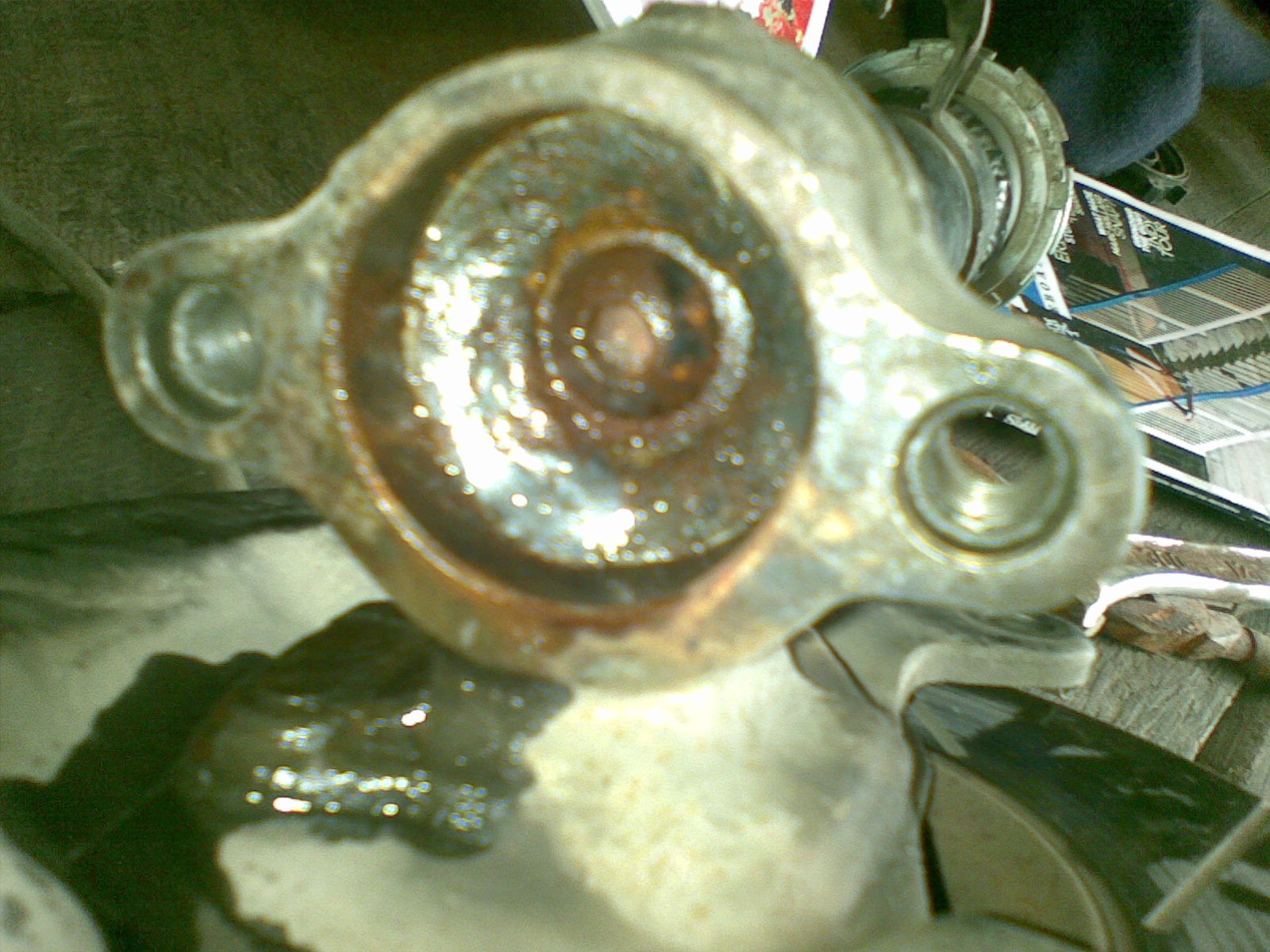

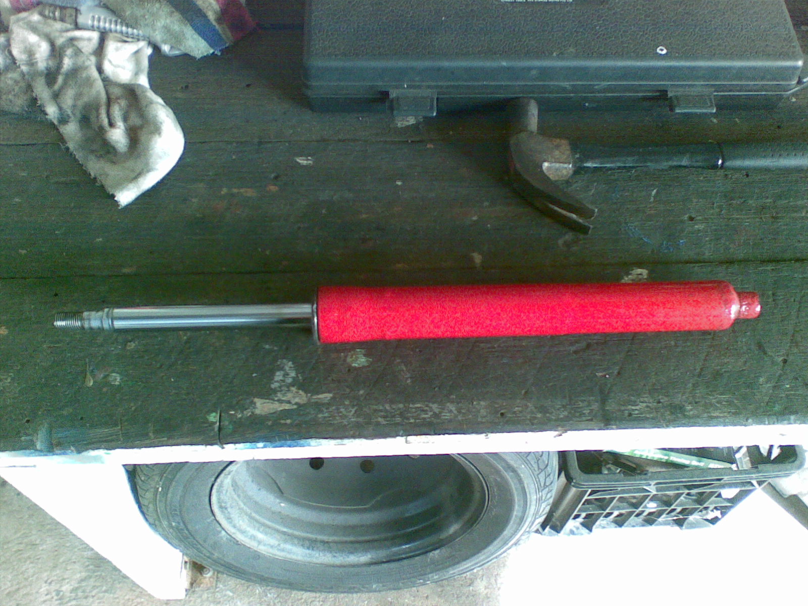

rian Posted November 22, 2011 Author Report Posted November 22, 2011 Turns out that the gland nut looking thing on to of the insert was not a gland nut. This is what I thought was the gland nut: But then I flipped the coilover upside down to find this: It's a shitty picture but that's an in-hex bolt in the bottom of the strut. When I undid the bolt on the bottom of the strut I could get the insert out, so there's nothing holding it in at the top. The inserts are Koni reds p/n: 86 2602. Which when I searched the part number turned out to be out of an Audi or something. The inserts are about 520mm extended and 330mm compressed, a pretty good size. Tomorrow I'll put the coilovers into the blue car with the new 4.9kg/mm Eibach springs to see how it works out. Quote
