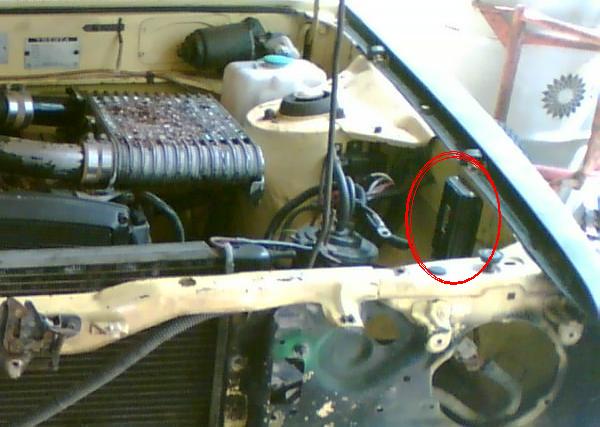

ancullen Posted October 19, 2006 Author Report Posted October 19, 2006 Apparently one of the problems with my engine has been the ignitor hasn't been working. B&W Ignitor - This is the three coil type, I only need a two coil one, and regardless of that, I need one that works. I don't know if this is the only cause of my problems, but at least it's one thing that's going to be sorted. Got to wait until the new one arrives from down south, and the company that sells them to my tuner won't do overnight bags for some reason. WTF? Quote

ancullen Posted October 26, 2006 Author Report Posted October 26, 2006 After getting the new ignitor in, it appears one of the coils is stuffed. Dave (my tuner) was going to try and get another one in the car tonight (damn he's dedicated and works back late!), and I'm going to give him a call tomorrow morning to find out if my issues have been resolved and whether or not I'll be able to race on Sunday. I'm desperately hoping I'll be able to, but have a very strong feeling that I won't, as I haven't had much luck with this car. If the Corolla's not ready, I'll take the Starlet and leave the Corolla with Dave so he can sort all the issues out. Then over the Christmas break (this Sunday's the last race meet for the year) I'll do the RX-7/Peugeot brake conversion. Quote
