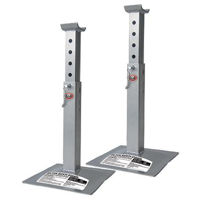

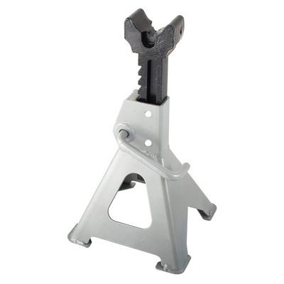

towe001 Posted October 5, 2011 Report Posted October 5, 2011 Like Andy said "Just do it" Just make sure you give the car a good rocking before crawling under for a sleep :P Now for the buts, The idea of uneven ground can be a good but on just how stable the car will be when its lifted high enough for you to fit under the car to have a comfortable sleep, oops, swing a spanner etc. And another but Car stands (jack stands) comes in at least two versions No. 1 I have four of these, their ok but they only have that base of a stand welded at the bottom. I've had a pair flexing that gave me the impression of the welds breaking. They do the job but its it No. 2 My father-inlaw has a similar pair. A lot more stable. But they don't have a solid flat surface like the first type so they'll need something to sit on if the ground is soft. The last but. Regardless of using a pair or four stands raise the car up in stages to keep some form of balance. Quote
TOMsGPTurbo Posted October 5, 2011 Author Report Posted October 5, 2011 (edited) lol sleep... I just take my time :happy: Good advice about raising it up in stages, didn't really think about it, not sure how uneven ground is a good thing tho?? :blinks: My new axle stands seem to be a mix of both, the tops are like yours, but the bottoms are like your father-in-laws. Edited October 6, 2011 by TOMsGPTurbo Quote
towe001 Posted October 5, 2011 Report Posted October 5, 2011 On 10/5/2011 at 1:39 PM, TOMsGPTurbo said: lol sleep... I just take my time :happy: There's been more then once i've woken up to find that i'm still under the car :lol: Quote Good advice about raising it up in stages, didn't really think about it, not sure how uneven ground is a good thing tho?? :blinks: On 10/5/2011 at 12:57 PM, towe001 said: The idea of uneven ground can be a good but on just how stable the car will be How the heck did i manage that :blinks: What i meant was that its possible on uneven ground but it'll depend on how uneven, or level, the ground is to just how stable the car will be up on the stands. If you don't mind having to leave the wheels on and big objects in the road, ramps are another option for excellent stability. Ramps under the front wheels and stands under the back axle. Or vice verse. The only thing is you don't have the high lift the stands can give. Those stands of yours are the better ones. If your going to use them on dirt or something not concrete/cement etc then drop into a hardware shop for some 12mm (minimum) thick plywood thats cut to a bigger size then the stands. Quote
