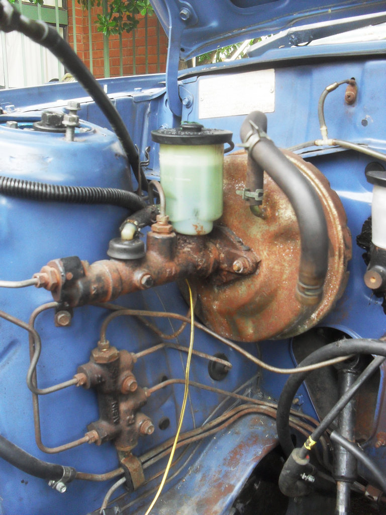

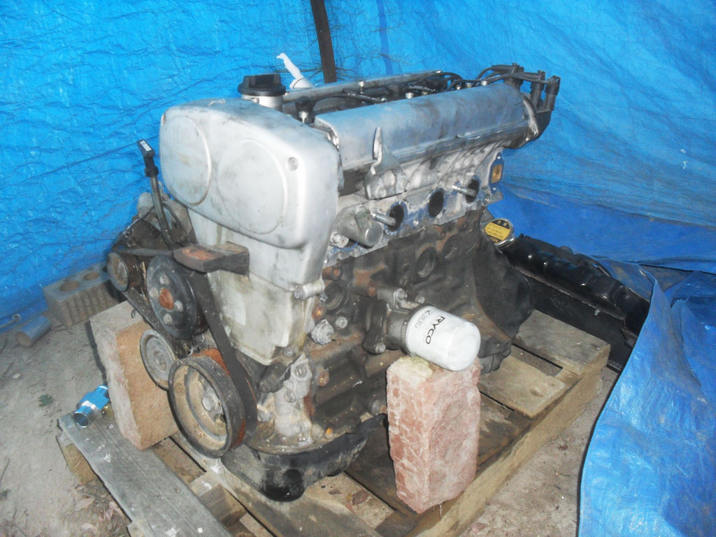

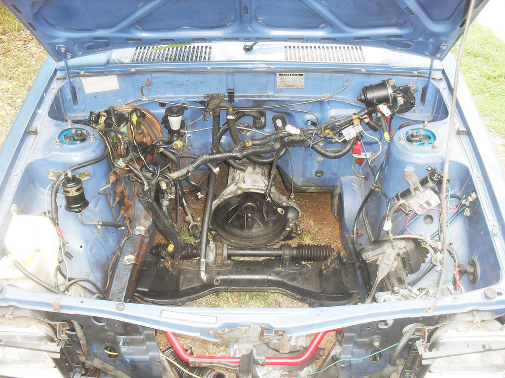

So whilst I was removing the 16-valve 4A-GE, I decided that the brake booster needed a BIN to sit in. The 2nd Blue Car (previous one) had a good booster on it, so it will go on the firewall once the engine is prepped for installation - as well as some degreaser!

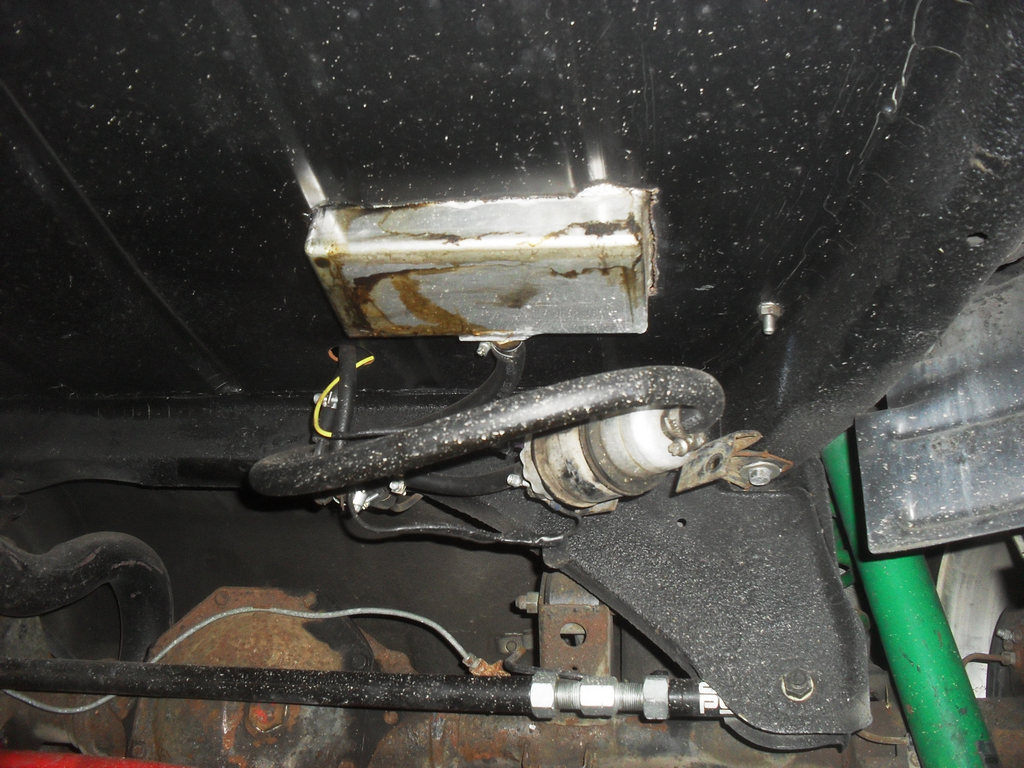

Fuel pump and wiring under the boot :bash:

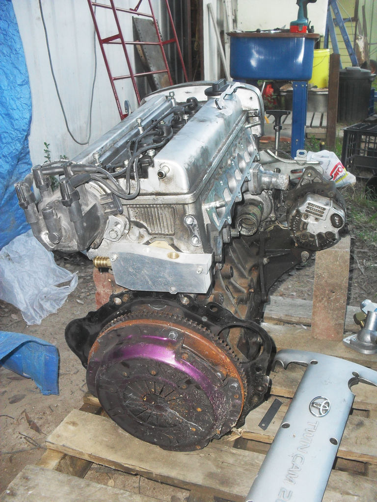

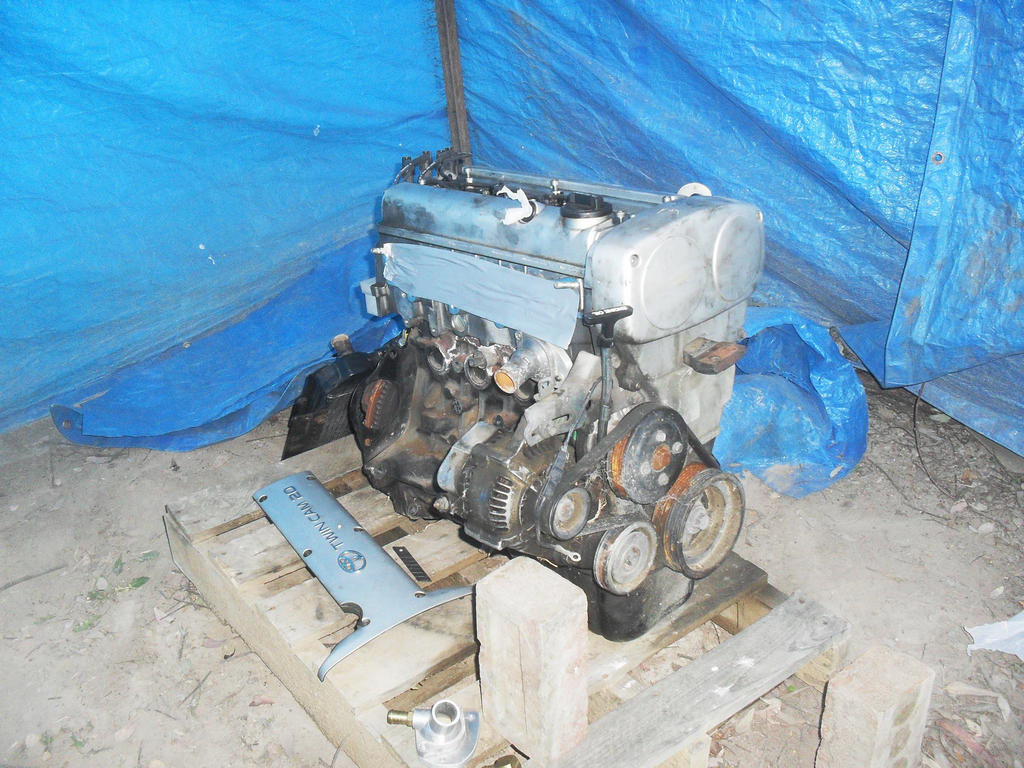

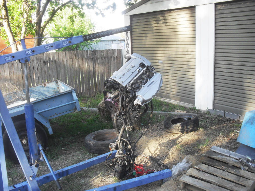

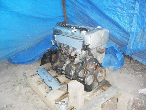

With my short amount of spare time and energy the 20V has been freed of the FWD loom, degreased, cleared of creepy crawlies and has had some of the ancillaries and cooling system fiddled with.
As you can see, there are some non-standard water fittings attached to the block, courtesy of Sam_Q Engineering. Thus doing so achieves an internal re-routing of the cooling system to suit north-south orientation, rather than an unsightly external re-routing of the system.
For those who aren't sure what I'm on about; the 20V was designed as a front-wheel drive ONLY engine, which saw Toyota change the distributor location, but more importantly - for my application - the location of the inlets/outlets of the cooling system, to suit the east-west orientation of the engine. When doing so, it became difficult for rear-wheel drive 4A-GE enthusiasts (Starlets, Corollas, AE86s, etc.) to "bolt in" to their cars, as they were relocated to the back of the head... ultimately getting in the way of the firewall when the engine is turned 90 degrees.
