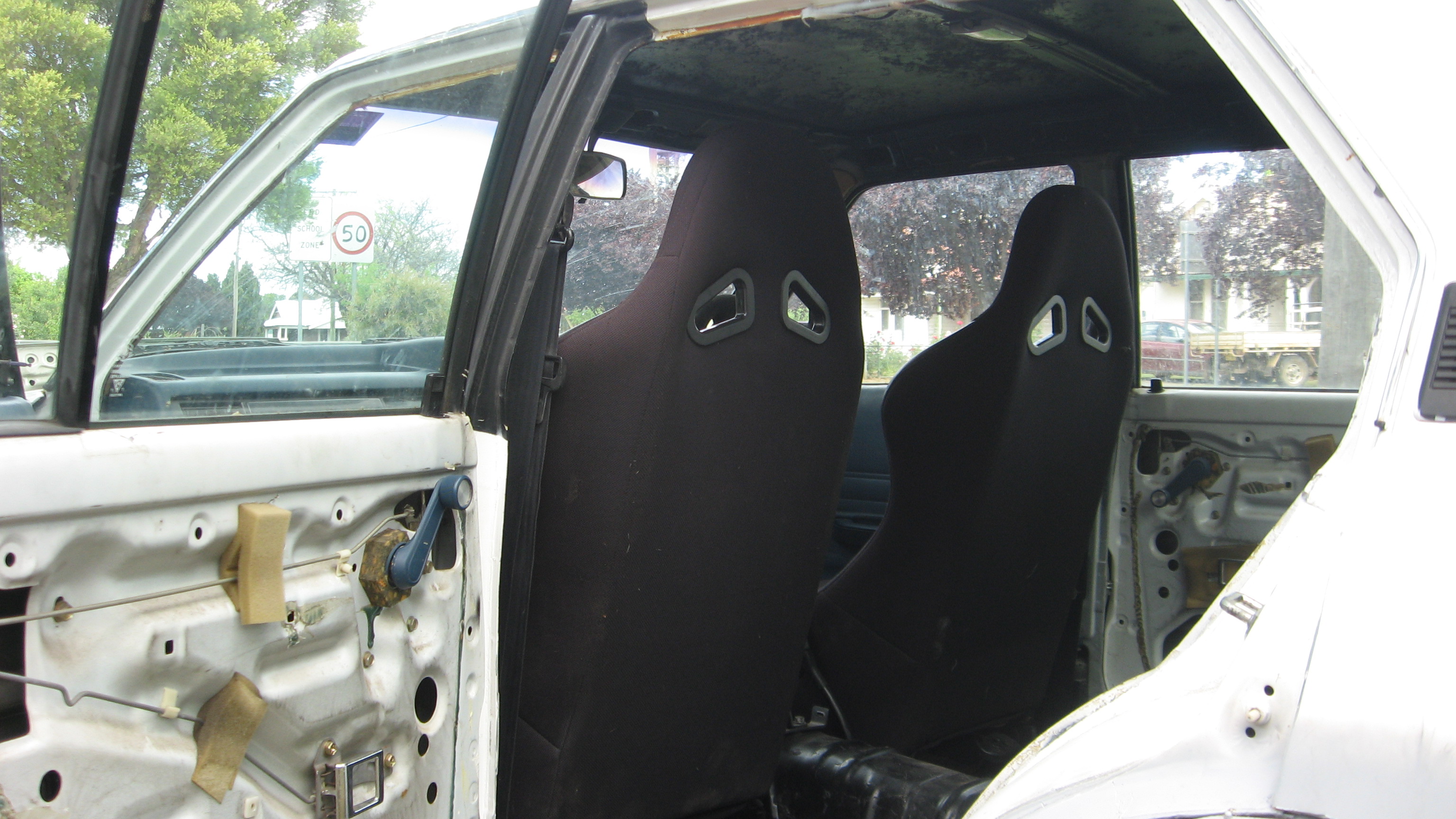

dbr11k Posted October 27, 2011 Author Report Posted October 27, 2011 haha its just not funny. period... at the moment the car has not a drip of fluid in it.. waitin till tafe on monday so i can run the sucky thing through the lines and put fresh DOT3 in her.. not really happy with the coilovers.. they are as low as i can get them and not really that low :n: pics.. cause everyone loves pics.. passenger rail done and seat in coils cusco camber tops and cusco brace shitty ride height my 5 month pup chillen on the roof lol gotta cut out a repair section for that sill :glare: Quote
