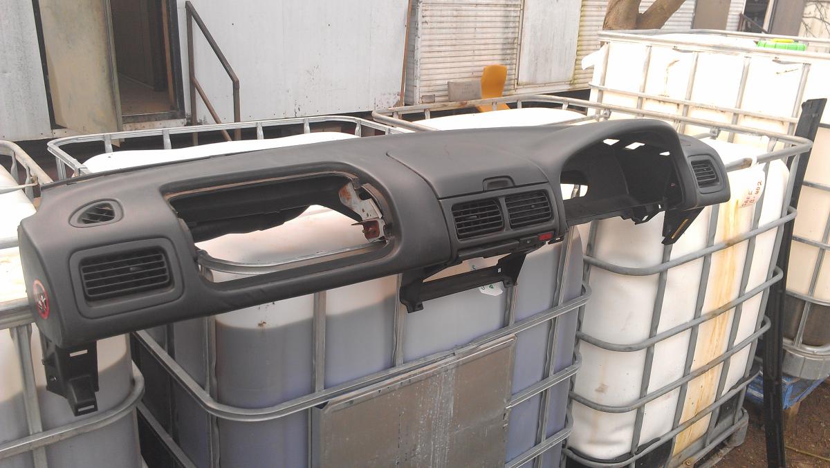

dbr11k Posted June 26, 2012 Author Report Posted June 26, 2012 Haha that's it, I just wanna be able to drive it already.. did a fair bit more wiring today, relay for the starter is done, toggle switch for ignition, push button start, i have to find the new battery terminals that are amongst the shit I have somewhere .. Also waiting on this wrx dash Measured the corolla at 130cm and the guy said the wrx dash was 134cm so it shouldn't be too hard to fit.. I'm losing all the factory wiring or as much that is practical, losing the ignition barrel etc.. I welded up the mounts properly for the quad head lights and will start the wiring for them tomorrow. purchased all the proper sized fittings for the fuel hoses including bulkhead fittings, just need to get some money for the hoses and the new cell, which was about $600 more Quote
dbr11k Posted June 28, 2012 Author Report Posted June 28, 2012 Wrx dash board showed up today, I was that hard at work that I got the missus to drop it off for me and started Chopin it up straight away lol It's 140cm across and a corolla is 130cm, so I'm going to cut and shut the passenger side, hopefully the dash pinnacle piece lines up in front of the steering wheel, I'm going to use the little flip up part on top as a space to put gauges, I'm going to prop it up and fiberglass it so it stands up, then get a cheap pinnacle and mould it into the hole to fit oil temp, oil pressure and water temp. I cut a square out underneath that nav I'm going to make a switch panel which will hold a battery isolator, ignition switch and push button start, using the factory hazard switch. Using the right air vent to hold a boost gauge.. Quote
