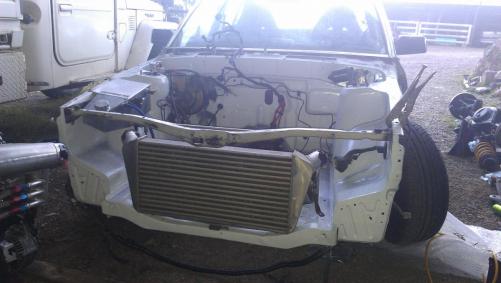

Put my engine bay back together today, and started making up a radiator support for it, I was planning on making a completely custom one but I thought I will just base it off the original one, I welded on some plates each end of it after grinding the bits of I don't need.... And that about as far as I got lol... Going to drill the holes for it tomorrow and weld nuts onto it so that I can remove it when ever need be, and smooth it off etc.. I will have to box it so that its a bit stronger, after all its going to be holding a fair bit of weight
ordered some cusco engine mounts and I have to wait for them to show up so I can drop the motor in and then start mounting the radiator, oil cooler and intercooler.
Then after that I've got to get some power sorted and fuel line's, then start the big girl :D
Also put the wiring loom, coils and ecu under the dash, thank god they were all marked out otherwise I would have been in for a fun time!

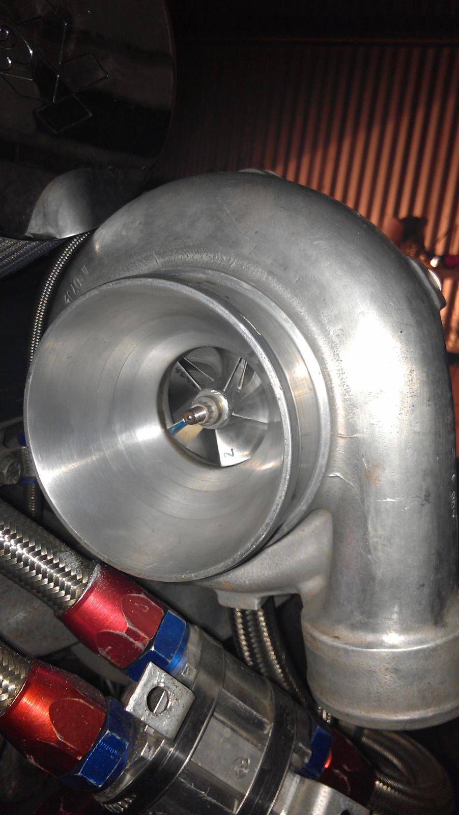

If you look closely you can still see texta on the impeller wheel.
Just playing around, I'm not going to know how it mounts until I have the motor in..
