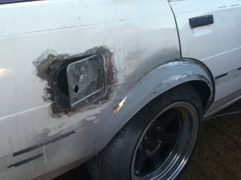

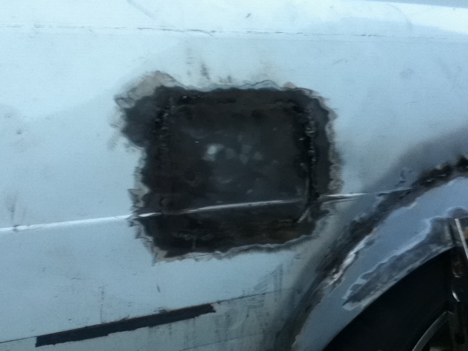

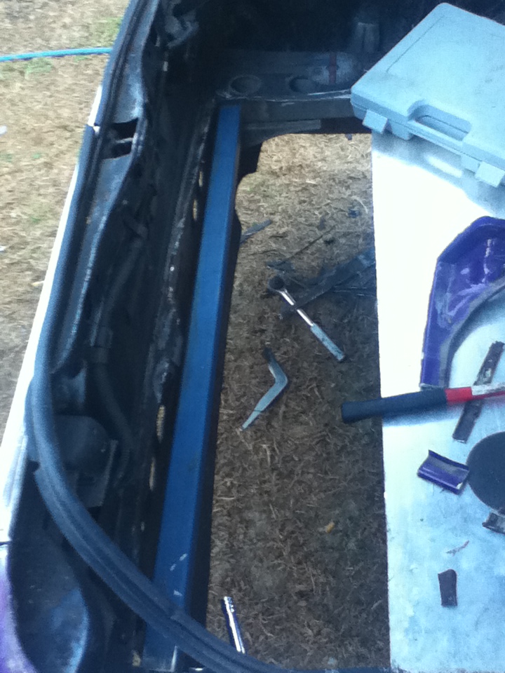

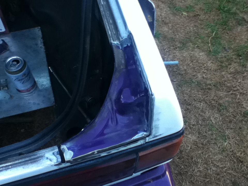

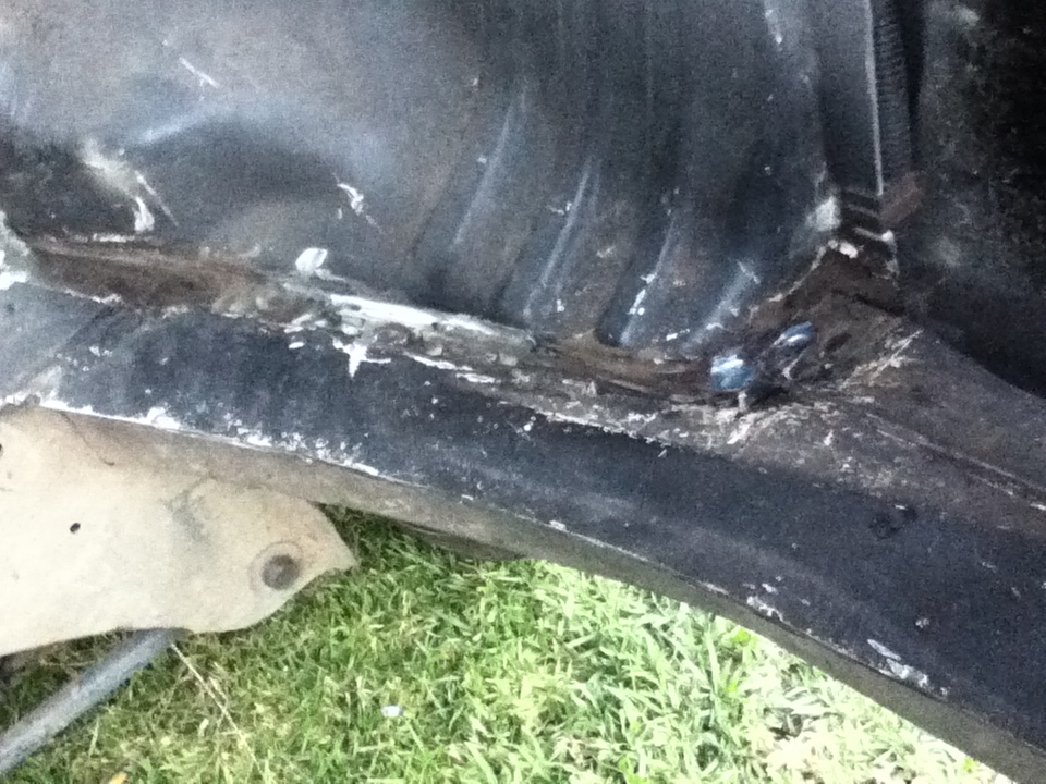

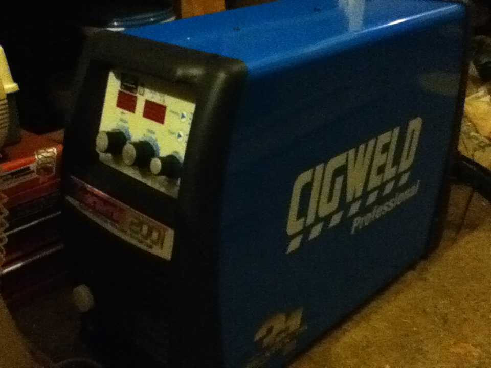

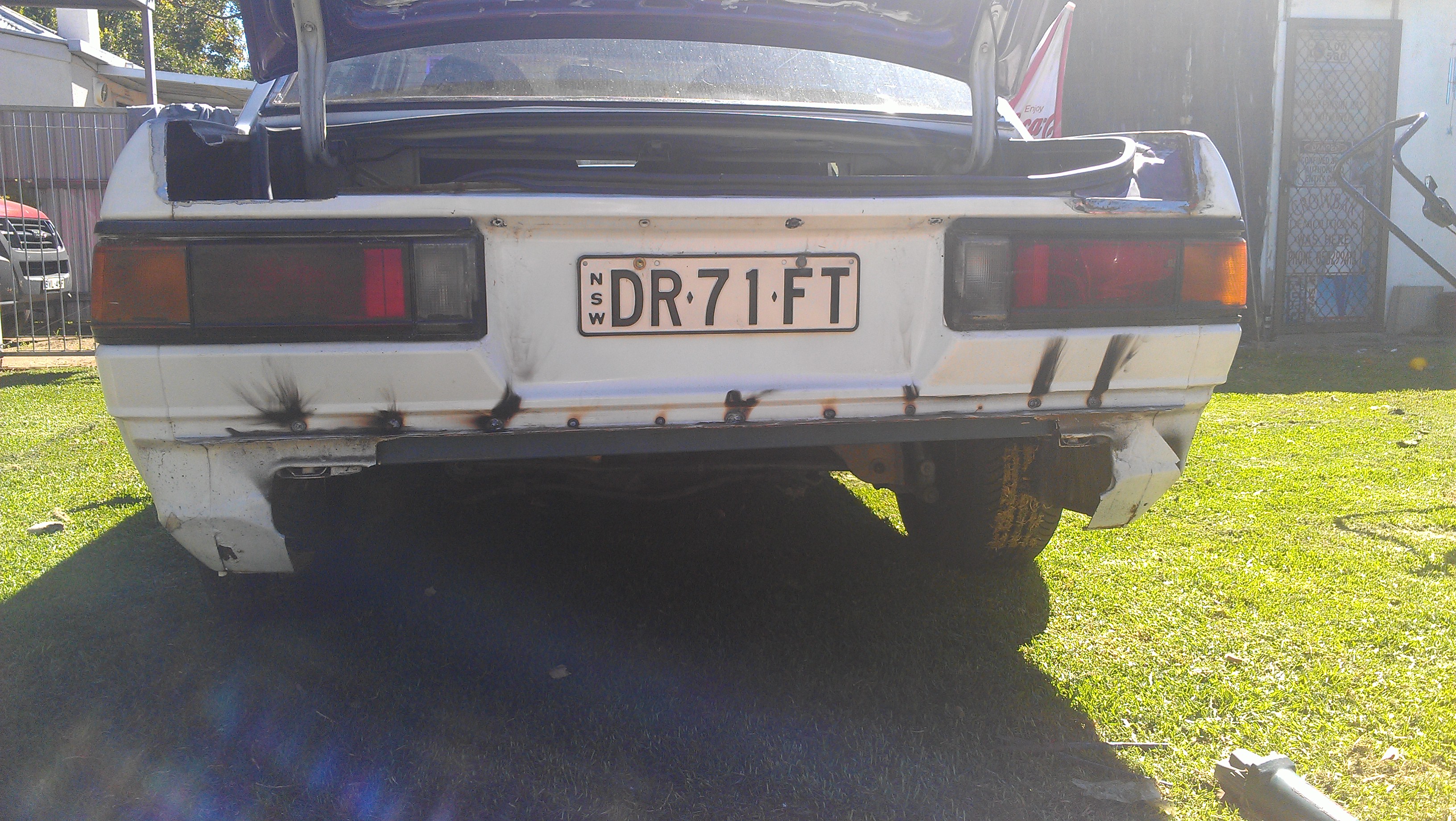

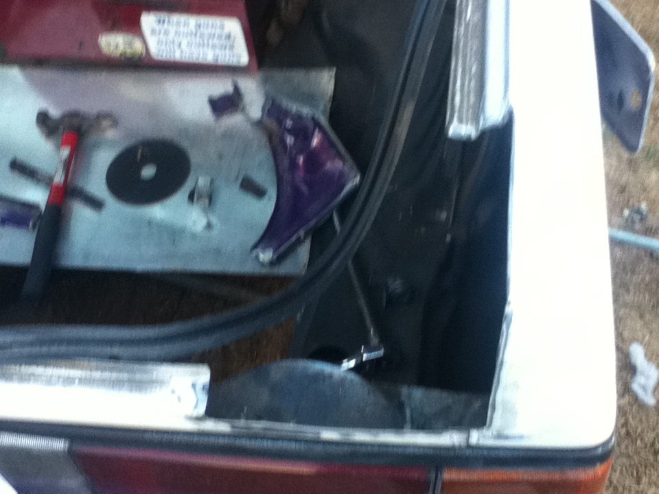

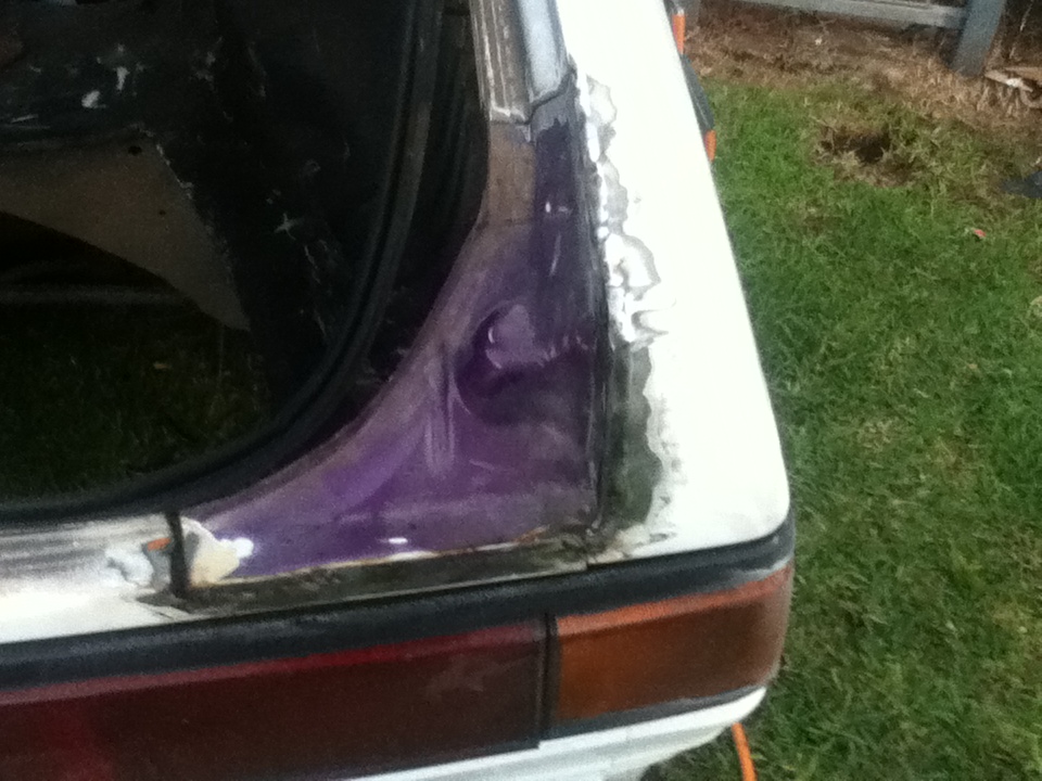

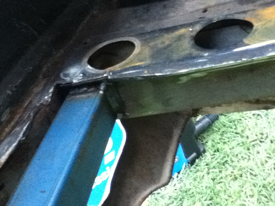

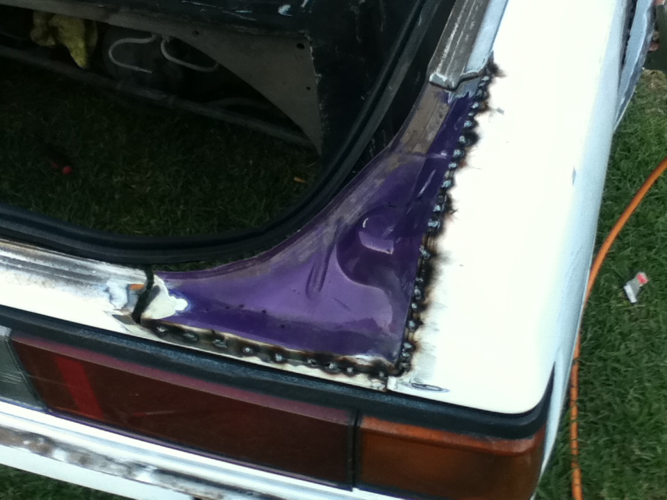

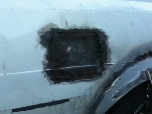

dbr11k Posted March 25, 2012 Author Report Posted March 25, 2012 prepping for when the welder finally shows up, deicided i would fork out the money and buy a decent one, so i got a TIG welder :cool: welding the fuel filler flap up as i have taken the fuel tank out and bought a 20 litre fuel cell, so i'm welding in a flat floor, obviously the cell needs something to bolt onto so i cut up some rhs to length to go under the flat floor.. and i thought i may as well brace the chassis rails a bit while i'm at it :P started cutting the rust repair sections out for the boot corners Quote

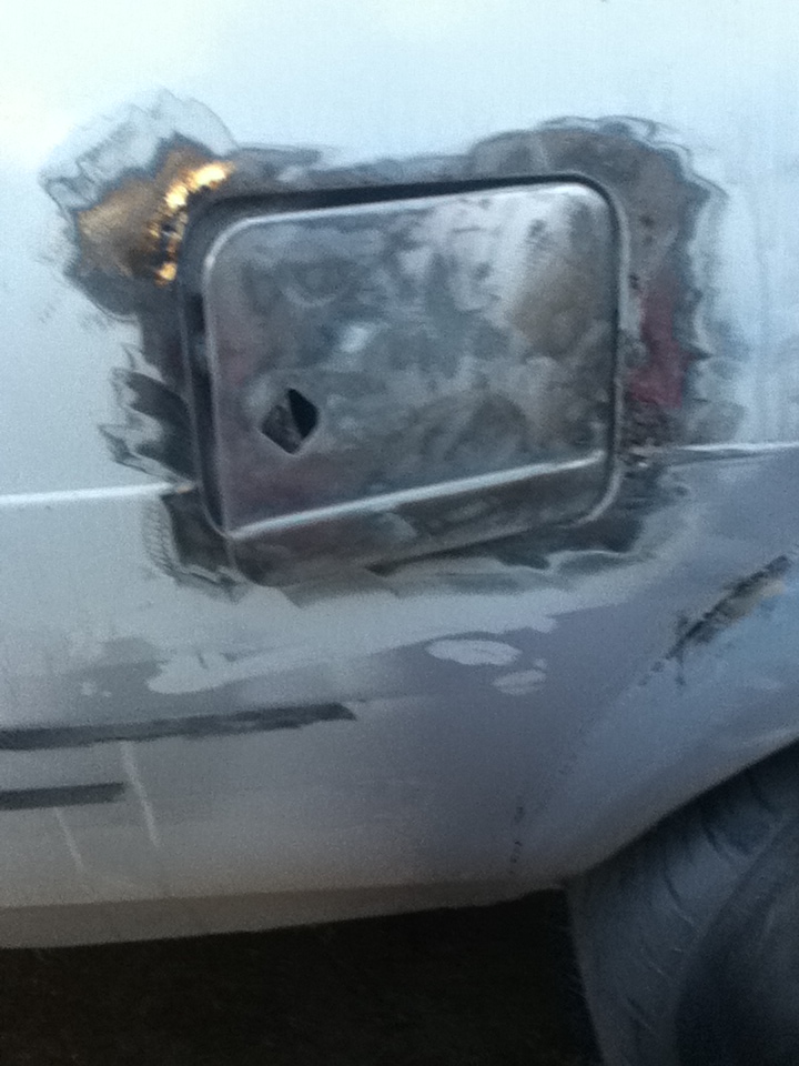

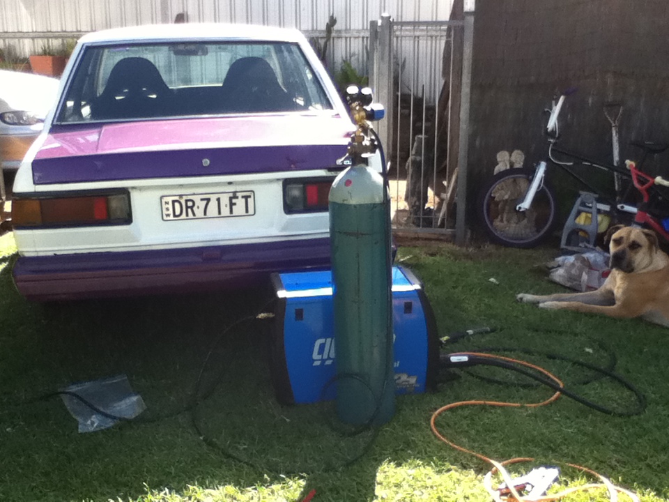

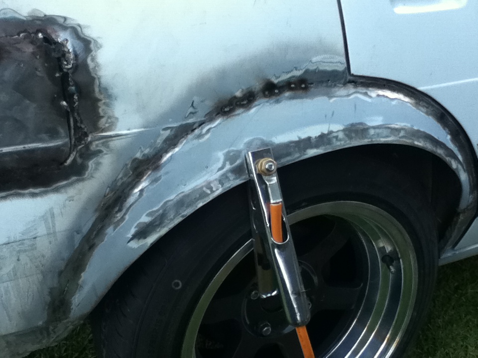

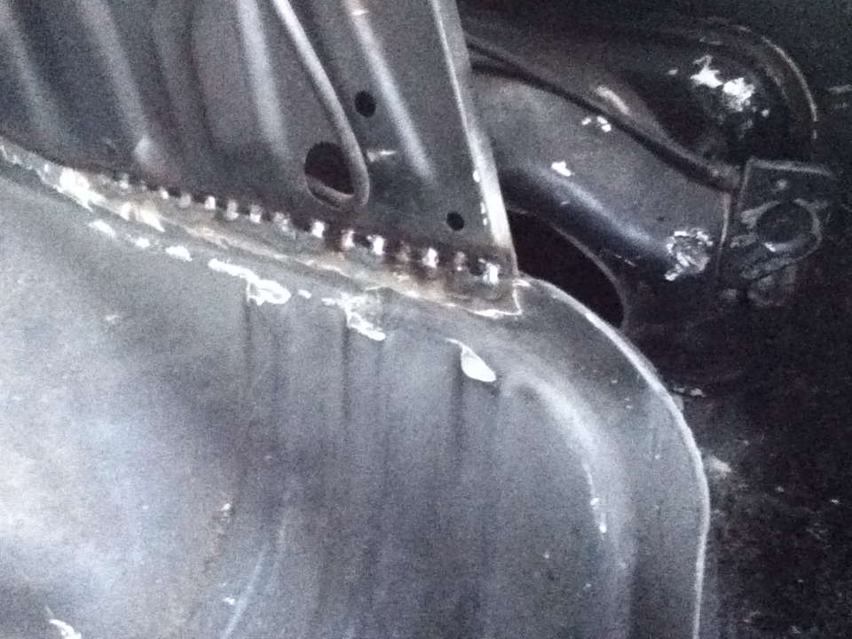

dbr11k Posted March 29, 2012 Author Report Posted March 29, 2012 (edited) got my self a reel and some gas today and got stuck into a bit. put to much heat into the fuel flap and warped the panel but ill get it straight again :wink: going to stitch weld any seams that i feel like doing, and also weld the seams between the boot floor and the wheel tubs, just to make the whole body and chassis more rigid. got 3 12 hour shifts so wont be doing to much too soon :n: Edited March 29, 2012 by dbr11k Quote

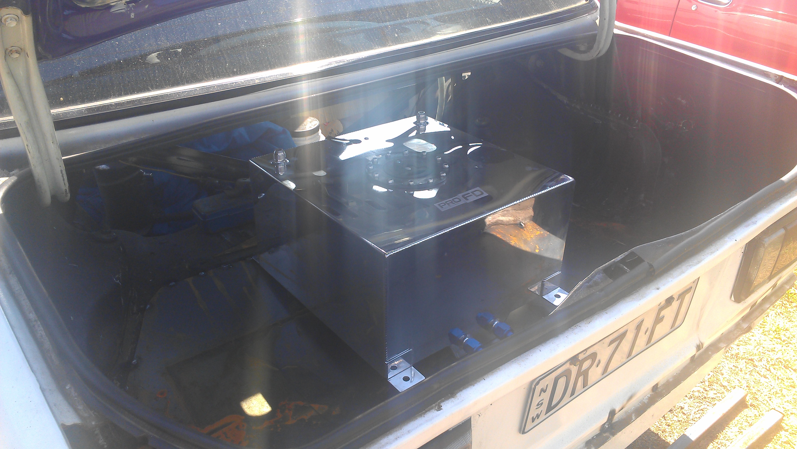

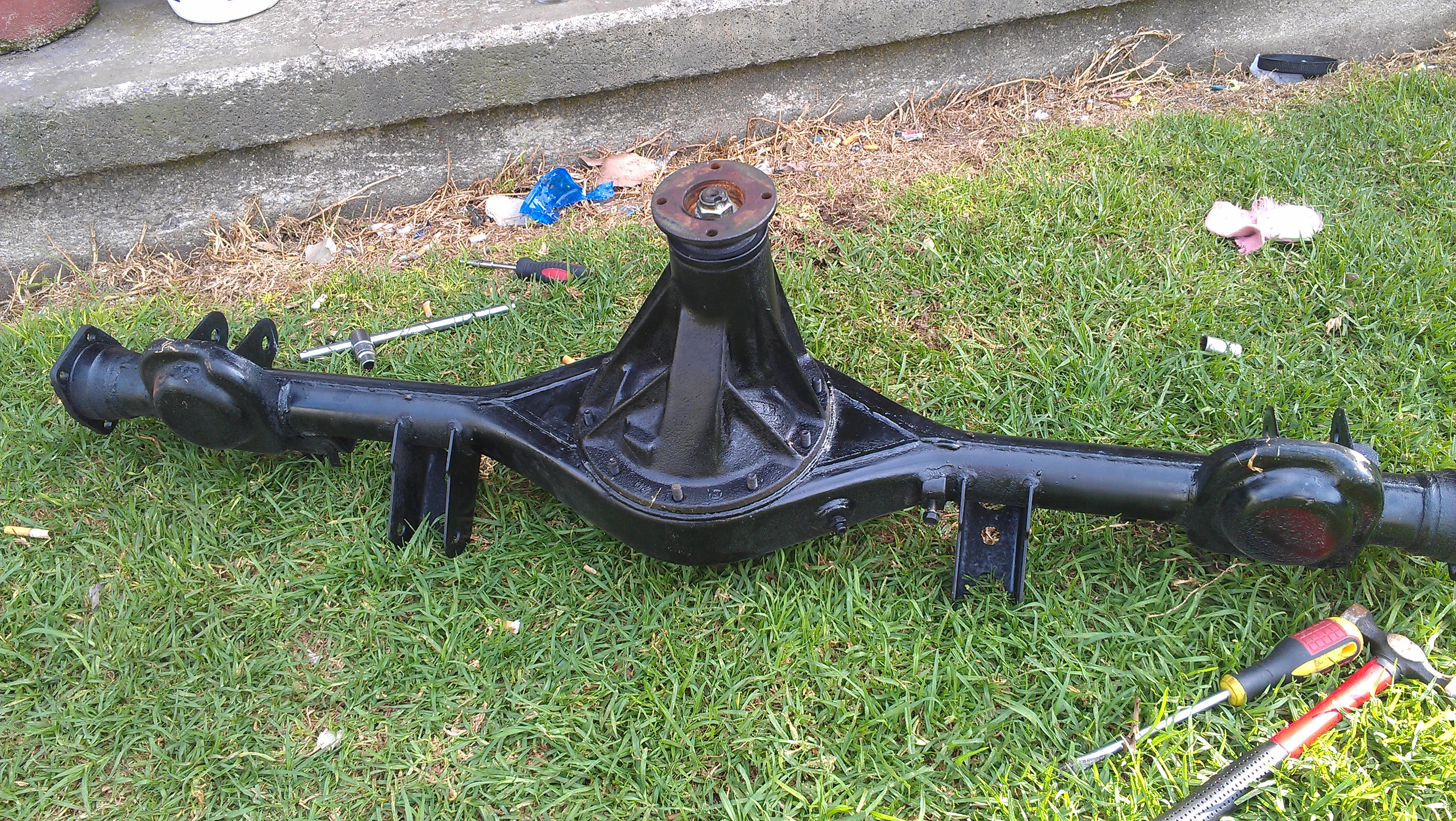

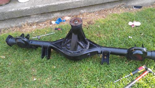

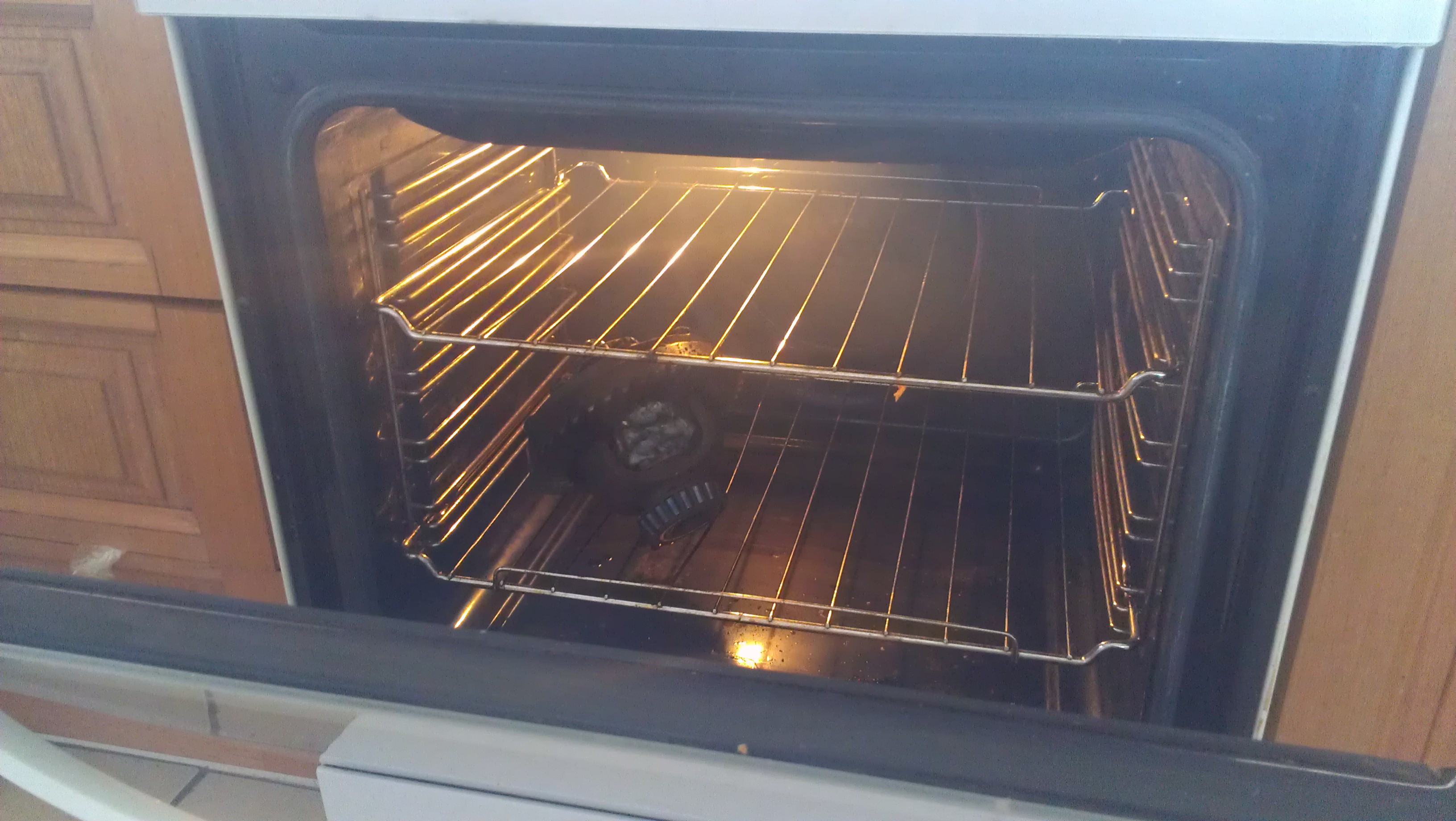

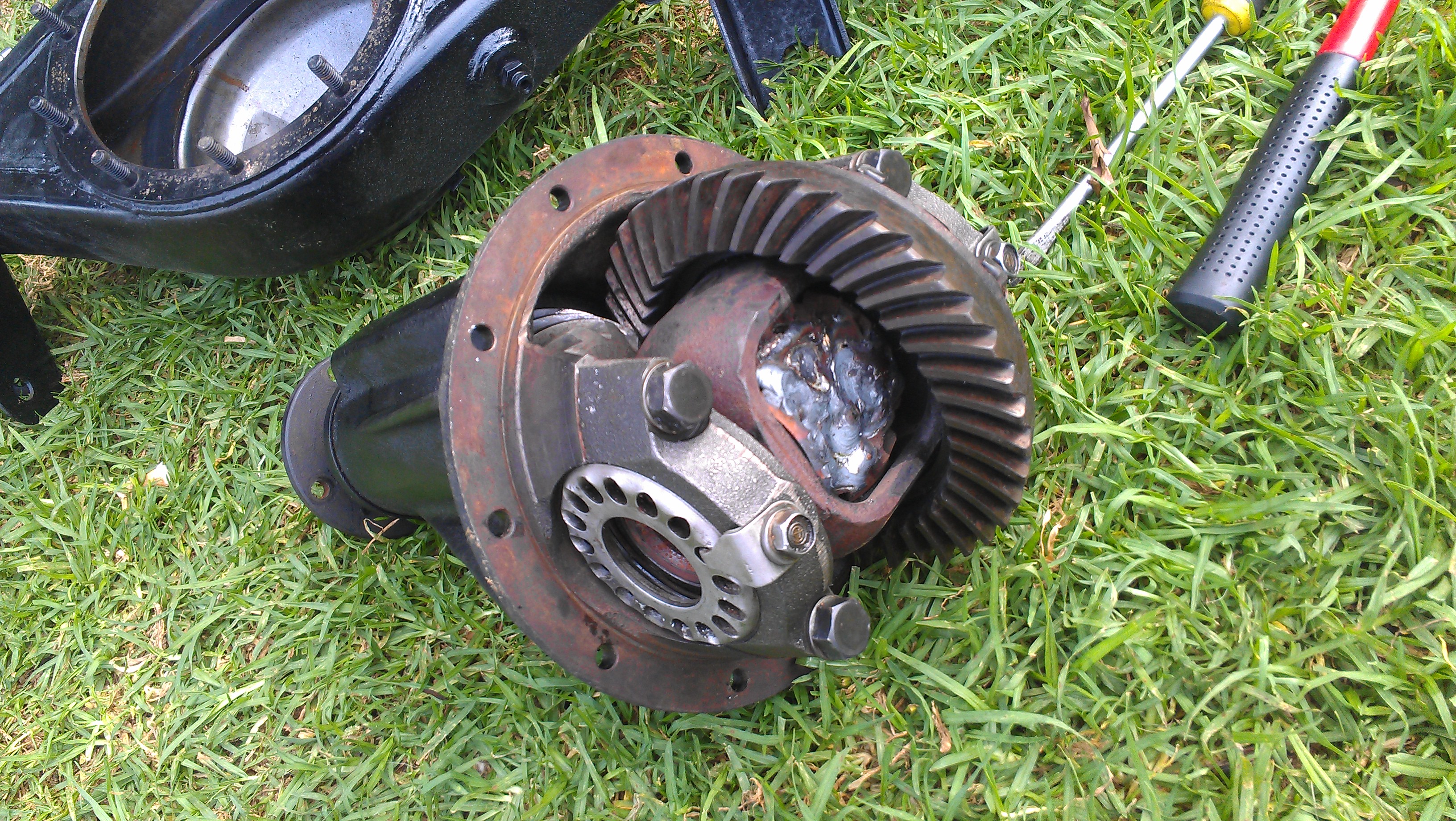

dbr11k Posted April 7, 2012 Author Report Posted April 7, 2012 new fuel cell, need the fittings and a new fuel pump. custom MIG centre, tempered in the oven at 280 degrees for 2 days lol. gotta get that exhaust lifted up, going to dump it at the diff. Quote
rian Posted April 8, 2012 Report Posted April 8, 2012 Cooking that diff for the 20 valve's next meal? lol Quote
dbr11k Posted April 8, 2012 Author Report Posted April 8, 2012 haha thats the one, i need a shortened tail shaft for the t series diff anyways so i am pulling out the standard s series or what ever it is and doing that centre too, see how long it lasts and than put the new one in. i also went on a shoppin spree and ordered a new radiator, 4-links, adjustable tc rods and a whiteline sway bar for the rear. Quote

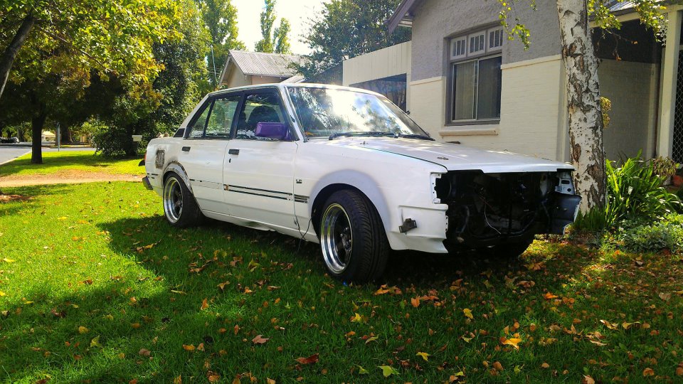

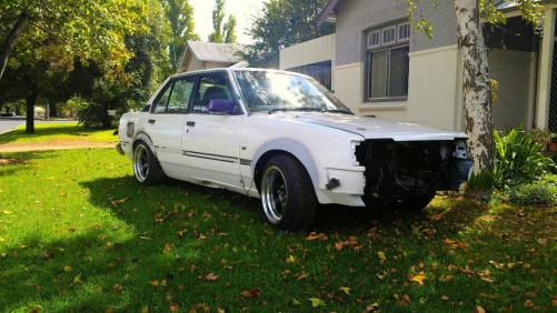

dbr11k Posted April 14, 2012 Author Report Posted April 14, 2012 (edited) whiteline 20mm rear adjustable swaybar, heim jointed 4 link kit, heim adjustable panhard bar, heim adjustable caster rods, short steering knuckles and beefy tie rods all ordered from the states, will wait till they show up and for my wallet to recover and than ill buy the other half of the suspension.. moving the car when i get time off work and than finishing my fuel system and makin an exhaust up for her.. also waiting on my fuel pump and filter, the last bosch 044 shit it's self. :n: quick happy snap taken with the htc velocity.. Edited April 14, 2012 by dbr11k Quote
dbr11k Posted April 21, 2012 Author Report Posted April 21, 2012 So finally got some panels, my fuel pump and filter rocked up, New radiator is here, quad lights are in even though they need some adjusting they look pretty good.. cars sitting in its new home so once I've got a few days off I'm going to attack it with the grinder and welder again, thinking about making a custom radiator support which will be removable, have to make custom mounts for the radiator because its a m 52mm and won't sit on the mount. will get some happy snaps soon when I get a chance, its 4 in the morning and I don't finish work for another 4 hours :( Quote

ke70redevil Posted April 22, 2012 Report Posted April 22, 2012 Looks like its going to be sick when its finished if you don't mind me asking, how much is a welder like that and where can you buy them from? cheers Quote
