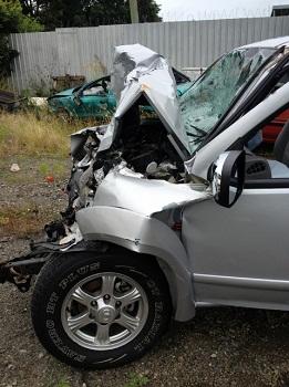

towe001 Posted March 23, 2012 Report Posted March 23, 2012 It can due to a calcium buildup on a plate in one of the cells that stops that cell from holding a charge. You can get "battery zappers". Like a battery charger, it just hits the battery with a higher then normal voltage (or is it amps, i can never remember) that'll burn off the buildup and hopefully return the battery back to normal. Came across this just before. Wasn't able to get much info apart from the ute was doing over a 100 and head on into a truck. Makes you think Quote

Jono.C Posted March 24, 2012 Report Posted March 24, 2012 For 100kmh.. That's not bad! Dash looks in pretty much the same spot and the motor and box doesn't look to have gone through the firewall.. But still.. Fark Quote

towe001 Posted March 24, 2012 Report Posted March 24, 2012 For 100kmh.. That's not bad! Dash looks in pretty much the same spot and the motor and box doesn't look to have gone through the firewall.. But still.. Fark Yep your not wrong. Figured out what the vehicle is ?? Just watched Love the Beast. Worth the watch. Your not wrong. One movie/doco that you'll want to watch again. Quote
