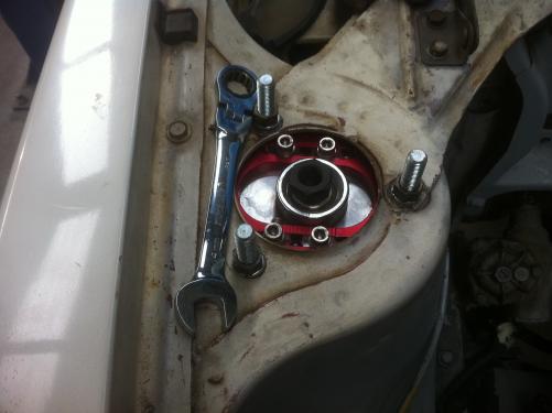

Luke241285 Posted September 8, 2011 Report Posted September 8, 2011 those camber tops look like the same ones we used in our 4agze/ke10 conversion, we found because the studs are so close together we could move the camber top about 2mm before it hit the back of the stud, so we had that one stud recessed into the aluminium plate hats of to you, i know how much work goes into shit like this.... Quote
drift freak Posted September 8, 2011 Author Report Posted September 8, 2011 Cheers luke241285 was wondering how to get around that. I'll be takin em this weekend and doing that for sure. Yeah it's a full on conversion but hopefully I'll be the first to get it done. :) Quote
