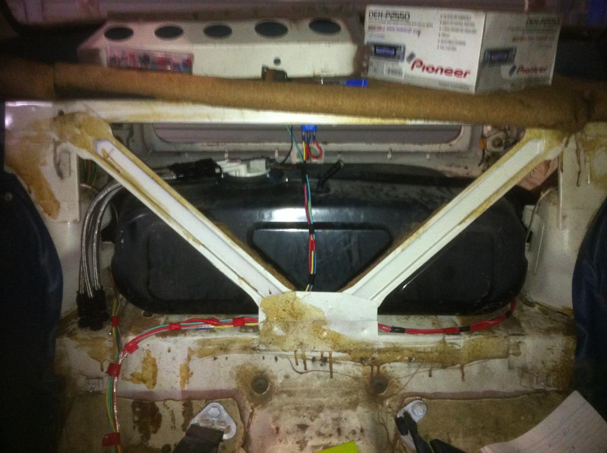

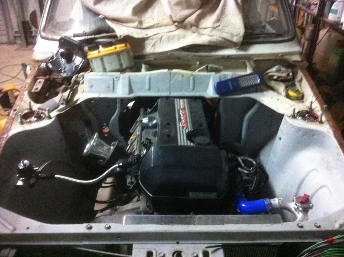

drift freak Posted August 8, 2012 Author Report Posted August 8, 2012 Well my fuel system is now complete :) as described earlier I'm using Aeroflow gear. I have run the 3/8" pressure line & 5/16" return line under the car and up into the engine bay where it terminates back to braided line using -6AN fittings. I opted for an Aeroflow inline 50 micron re-usable filter to simplify things. The original fuel line diameter is 4.9mm and the 3/8" is 7.2mm so a reasonable upgrade in flow diameter. Now I need to flush my tank and wire in the battery tomorrow arvo and she should fire into life. I haven't wired the dash in yet but the software that comes with the ECU will allow me to monitor everything in real time anyway. Fingers crossed all the checks prove to be good and I might have a video for all you peeps by the weekend. Will get some better photos of the under carraige fuel line layout tomorrow in the light and of the engine bay too :) Quote
