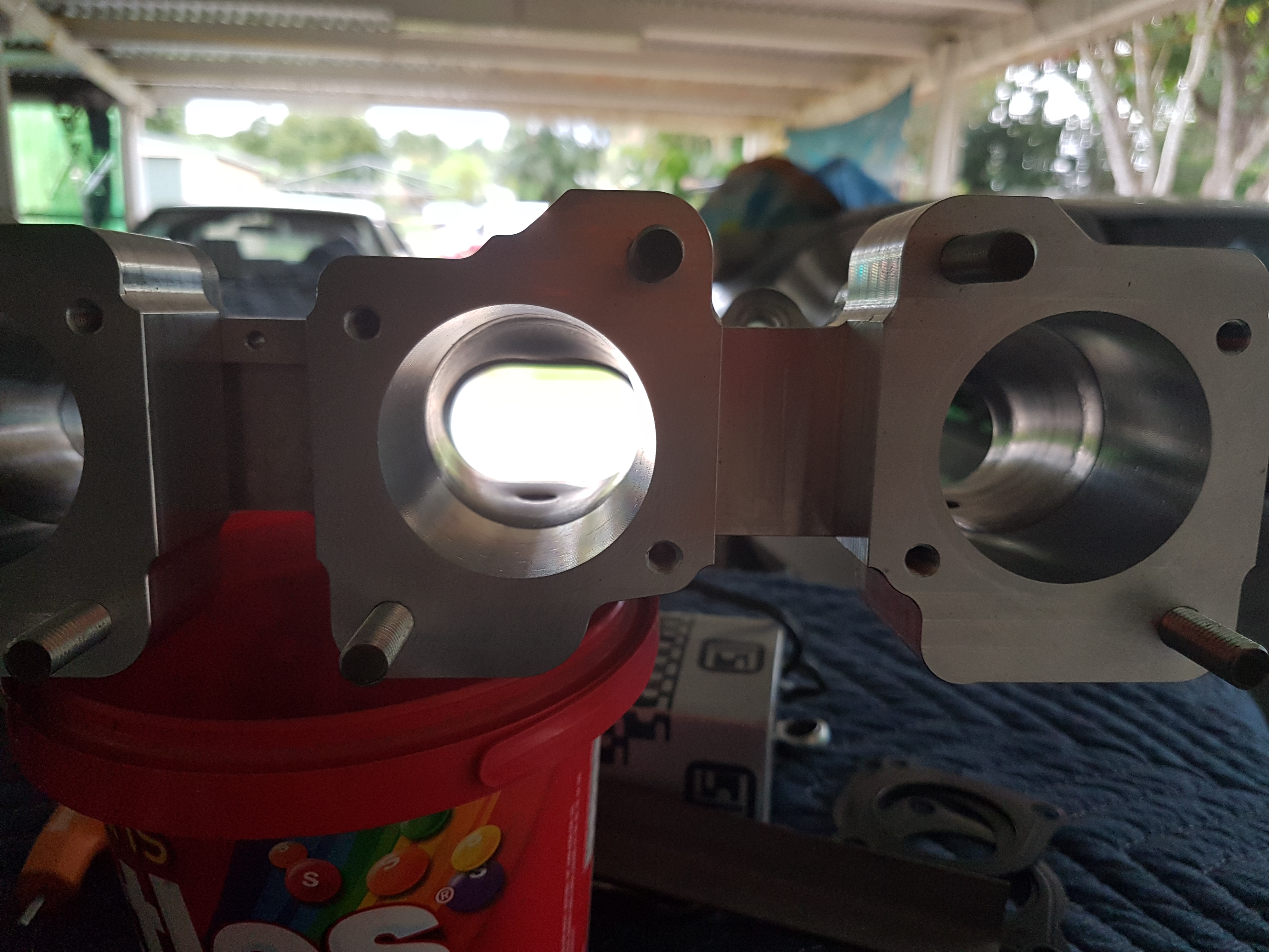

LittleRedSpirit Posted March 10, 2018 Author Report Posted March 10, 2018 Did a test fit and clearance is fine. Should even be able to use a fuel rail underneath in upstream position with minimal re routing of stuff. Got the throttles off the adpators, then aligned the adpaters perfectly on the manifold and scribed with a very sharp implement I made on the inside of the ports, to the size of the adaptor ports. I used a file and some coarse sandpaper only so far, and I'm very happy with how opening up the top flange lets me improve the shape of the runner a lot more. Quote
LittleRedSpirit Posted March 11, 2018 Author Report Posted March 11, 2018 Got it all matched and polished up. I even buffed the outside of it. Very happy with it. Quote

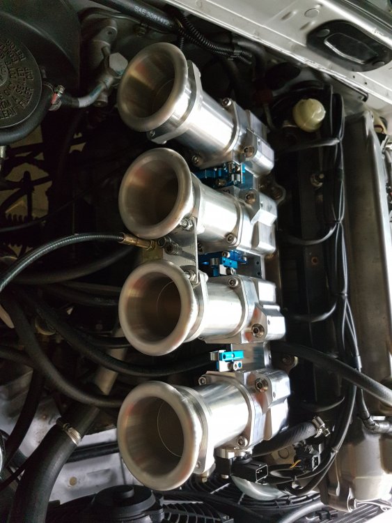

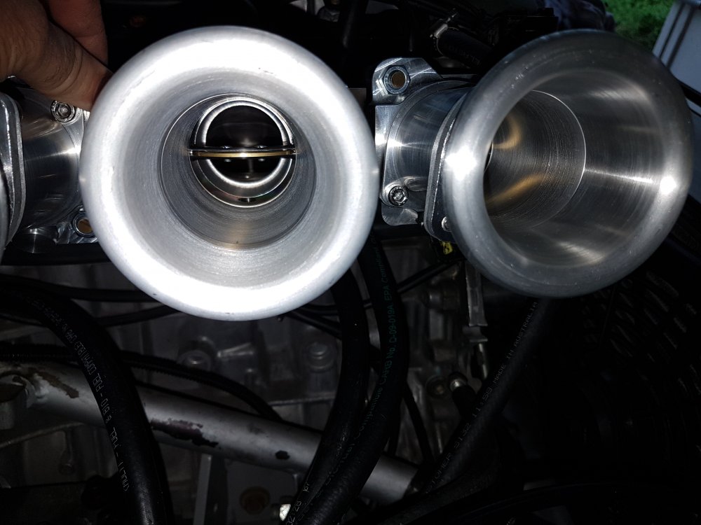

LittleRedSpirit Posted March 12, 2018 Author Report Posted March 12, 2018 Got some trumpet bases from Taiwan to suit the itbs, the guy who makes them was in Taipei so he sent them from there. Ill be able to trim the trumpets I have to suit them and get a big bell mouth and maximal inlet length. He forgot to put some extra O rings in so I had to go buy some at the bearing shop. I re sealed the nipples for idle control and for brake boost. I now have the inlet all bolted together, installed, and all it needs is the tps wired up and the cable mounted. I have an unwired plug for the tps to use, so should be oem-ish. I'll make something for the cable tomorrow. Might need a shorter one in the long term. I'm stoked with it. I also made some injector bung retainers from 2mm aluminium bar, and they work good. I polished em up and all as I didn't want to bring the job quality down. Quote
LittleRedSpirit Posted March 13, 2018 Author Report Posted March 13, 2018 Rigged up a cable for it. Seems that the throttle actuaror is the right diameter. hits full throttle just as it should. Just before the pedal ends its movement. No further mods required except maybe remake it slightly neater one day. Todays dilemma has been losing the new tps connector before ever installing it. Just ordered a new one I give up. Quote
