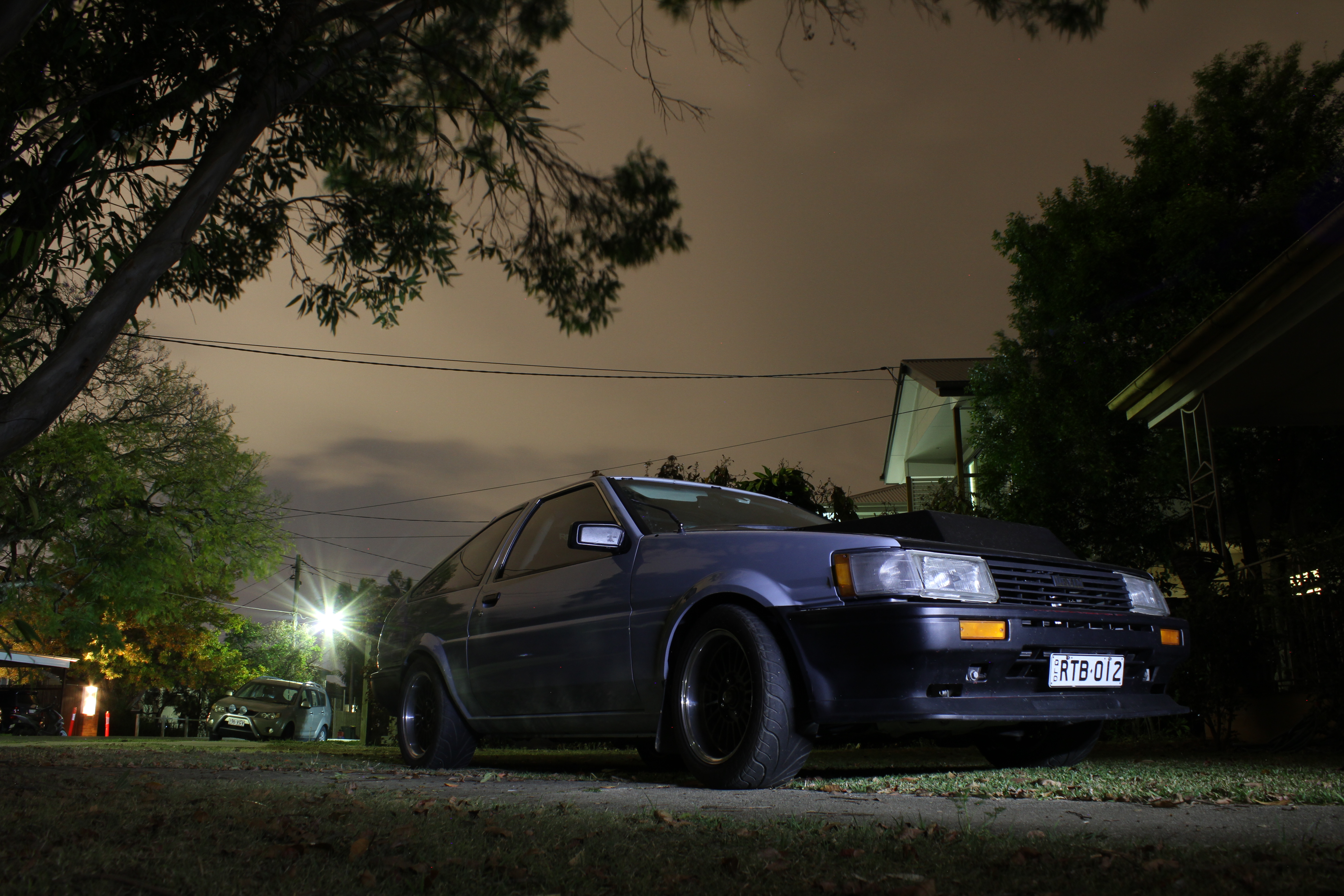

Some photos to get the fans all caught up.
