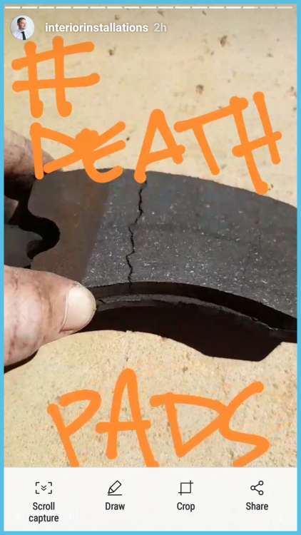

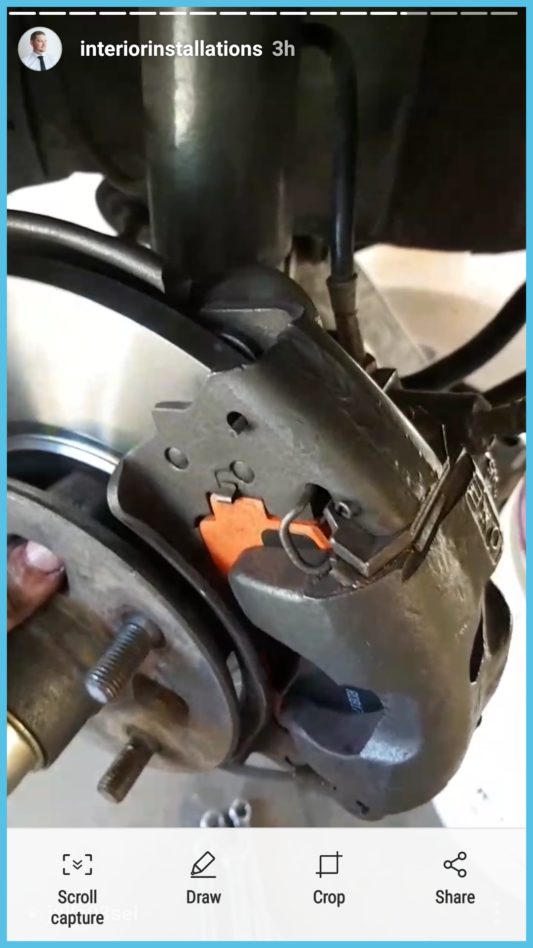

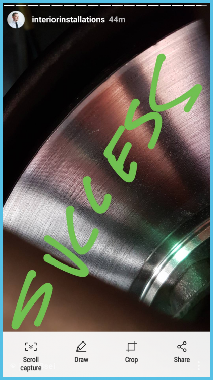

LittleRedSpirit Posted September 14, 2017 Author Report Posted September 14, 2017 So when I built this car I never put fresh brakes on it. The rotors were thick enough, and the pads meaty enough, but it looked like it had been pad slapped. I just let it wear the rust off and it worked well enough for a year or two now on the road. Recently the pedal has felt like its had a lot of rotor runout. A bit twitchy at speed. Ive had some rotors and pads on the shelf for ages so I decided today was the day. Im glad I did, this pad was cracked clear through the friction material in more than one place. Pedal is now butter. Quote
ke70dave Posted September 14, 2017 Report Posted September 14, 2017 wowzer, who would have thought. Never seen one break before. Nice catch. Quote
