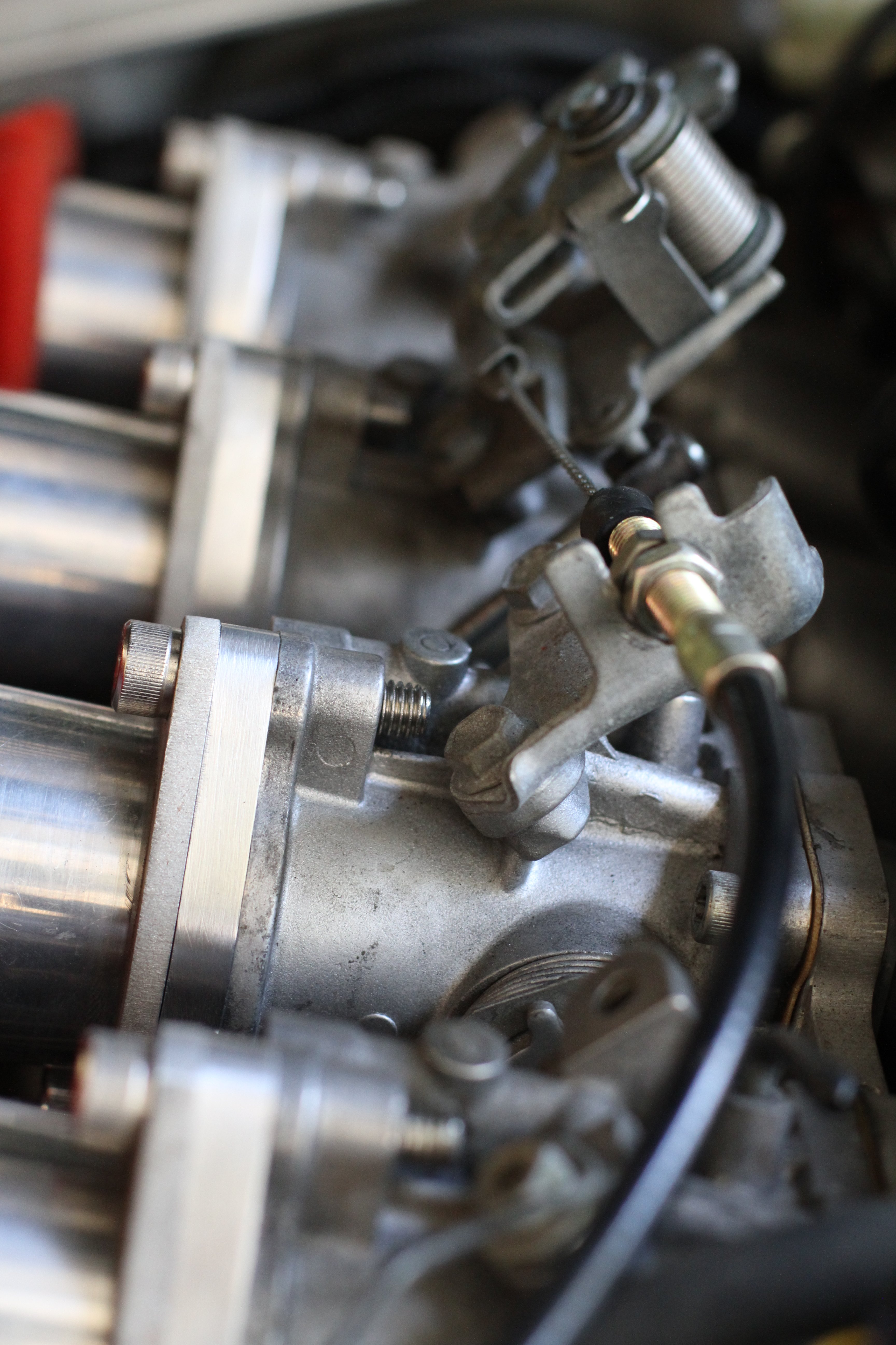

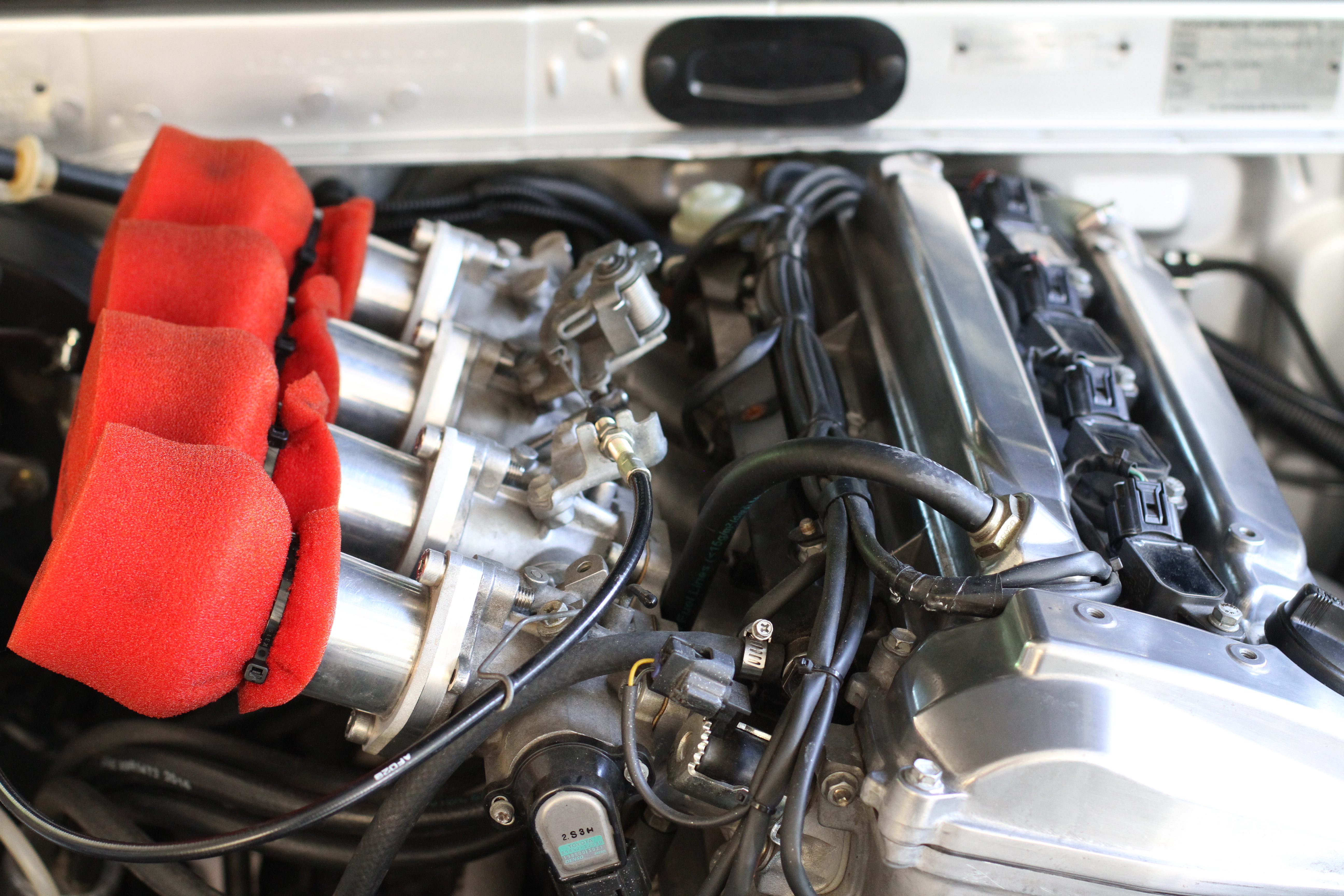

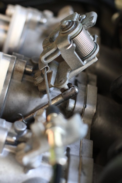

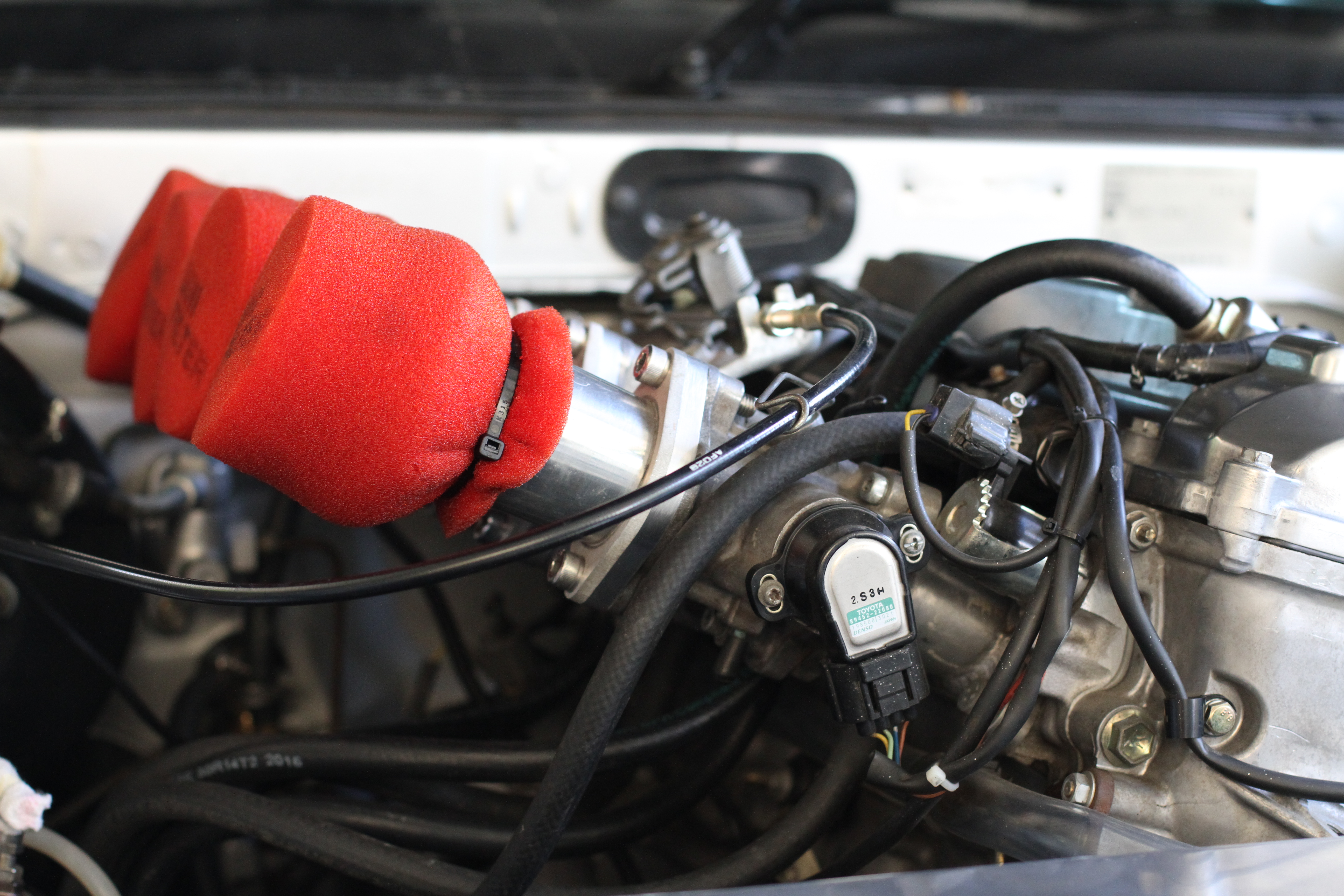

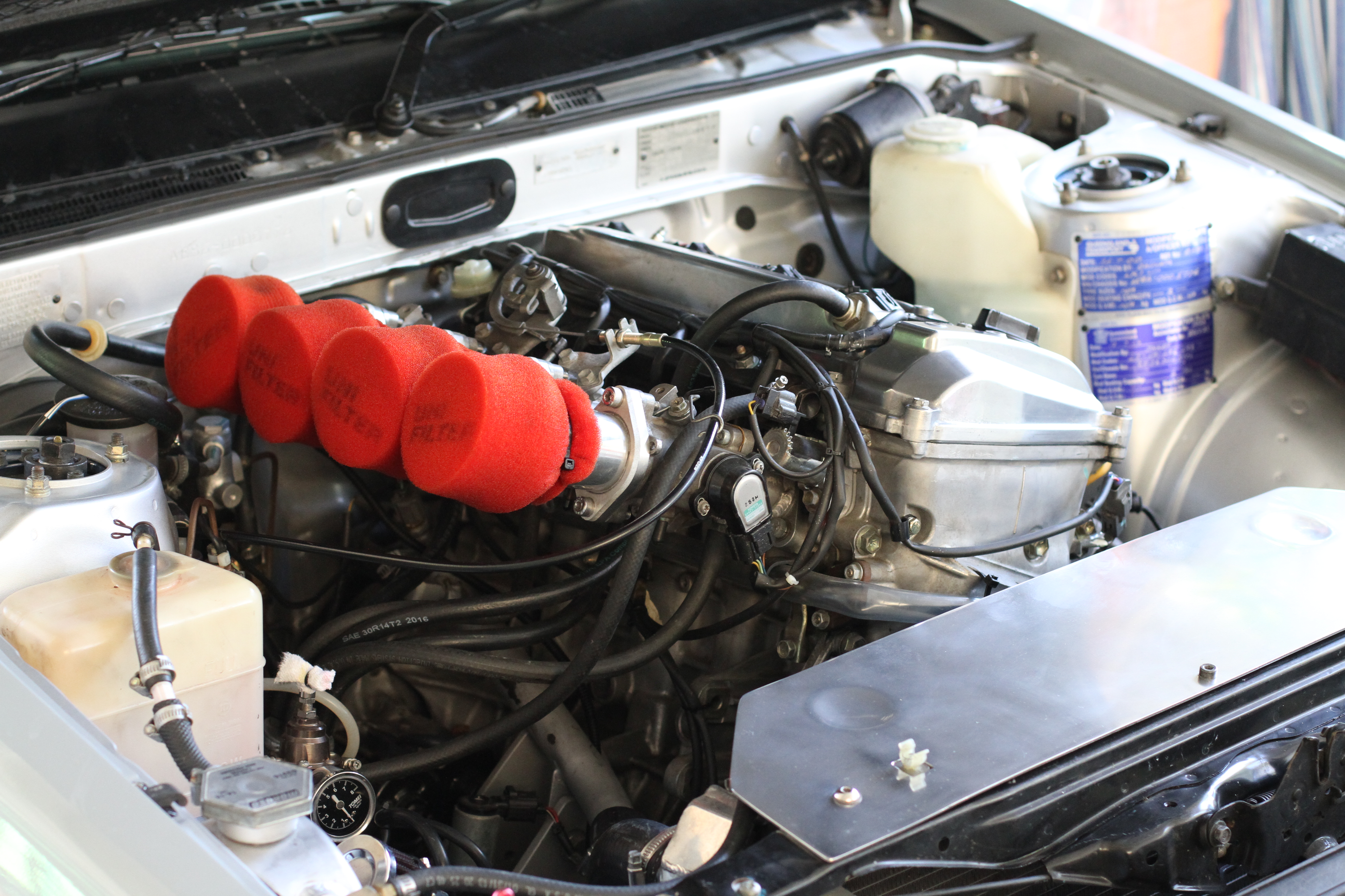

LittleRedSpirit Posted September 1, 2017 Author Report Posted September 1, 2017 Just got back from the dyno. Was not able to increase peak hp, but did a few other productive things. We did some testing to reveal the itbs are at their limit of flow. When you increase inlet length by 2 inches like I did, you should see some more torque across the lower revs. This did not occur, which is generally a good indicator that the air is already as fast as it can go as it passes the throttle butterfly. Therefore the only way to make more peak power is to go to a bigger butterfly throttle. Rob thinks around 50mm butterflies. The limit of the silvertop itbs if you bore them is around +2mm so about 45mm butterfly. This isnt going to cut it really. Instead of finding power we did the vvti setup and found the most appropriate setup for each and found whatever was available under the curve. We did 50, 75 and 100 percent tp tuning, and interpolated the rest, which yielded some nice drive ability and response. We trimmed a lot of fuel out of the maps, and reduced the overall consumption I would say fairly dramatically, full throttle was close to ok but a touch rich, but 75 and 50 percent were way rich and it allowed me to slash fuel out of unimportant zones of the map that you dont really drive in but that you often blip the motor through when you change gears. I have already noticed less unburned fuel rumbling out of the exhaust on the change. So looking forwards, I need to stop fussing with inlet lengths and to look at increasing flow through the inlet manifold. I need to stop worrying about cams till I work out how to input more air into the motor. That would be a wasted exercise unless that happens. In the longer term I may buy a used 2azfe to fit in the place of this low mile near new motor, and then I can pull this motor down, get my pistons fitted and get an inlet made that will open up the airflow. Then I could consider cams, bigger valves and some porting, and maybe some 4-1 headers to see what that does because science. Quote
ke70dave Posted September 1, 2017 Report Posted September 1, 2017 How on earth do you have time for all this with a new born? Mine is due in 4 weeks, so maybe there is hope of e30 projects:D Great info in your posts as always. What detrimental affects are expected if you make the throttle bodies bigger? the internet gurus will tell us that you will "lose low end torque". Your engine is swimming in torque already, do you think there will be much effect? Quote
LittleRedSpirit Posted September 1, 2017 Author Report Posted September 1, 2017 It would have some effect on airspeed at low tps undeniably, but airspeed and inlet length can be balanced to pick that up. With the stroke of the engine it pulls hard enough from 1000 rpm with nice driveability. Maybe that figure shifts to 1300 rpm, and the peak goes from where it is now to slightly higher? I can live with that. It currently plateaus around the 110kw mark for the last 600 rpm. In theory if it kept going from there, it would improve peak and not hurt the low rpm performance too much, its always going to suck a lot of air being a 2369cc engine. I still dont know about cams, because I dont want to spin it faster than 6500 rpm, and it would probably need rods and pistons done to save weight to achieve it day in day out. It may be happy to peak at 6500 rpm anyhow, and I'd only really need lift and minimal duration increases if that were the reality of it. Maybe a nice well balanced setup would be 50mm ITBS, port tidy up more than porting as such, and some lighter valvetrain equipment, maybe oversized 1mm in and out, on standard camshafts. I think with a 4-1 header I can put the peak to the top of the rpm band and shift the VE a bit higher if we can get the air through the inlet and out the exhaust. Quote
