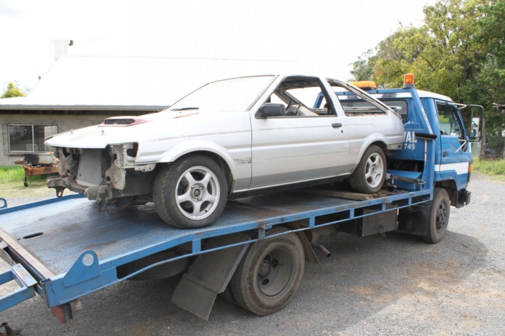

LittleRedSpirit Posted April 27, 2017 Author Report Posted April 27, 2017 A trip back to the day I picked up the car, sight unseen from Boonah. 8/9/2010. Ive never shared these before. Quote
LittleRedSpirit Posted April 27, 2017 Author Report Posted April 27, 2017 Do you like the tractor fuel system it had? The way it stuck outside the rear of the car, and the way it came out of the heater hole? What a weapon. Quote
LittleRedSpirit Posted April 27, 2017 Author Report Posted April 27, 2017 Or maybe how the lift pump had 2 big hoses teed in and how they fed one pump, and how it fed the pump before the filter. If you study the photos it must have been built by someone either stupid or suicidal. Quote
