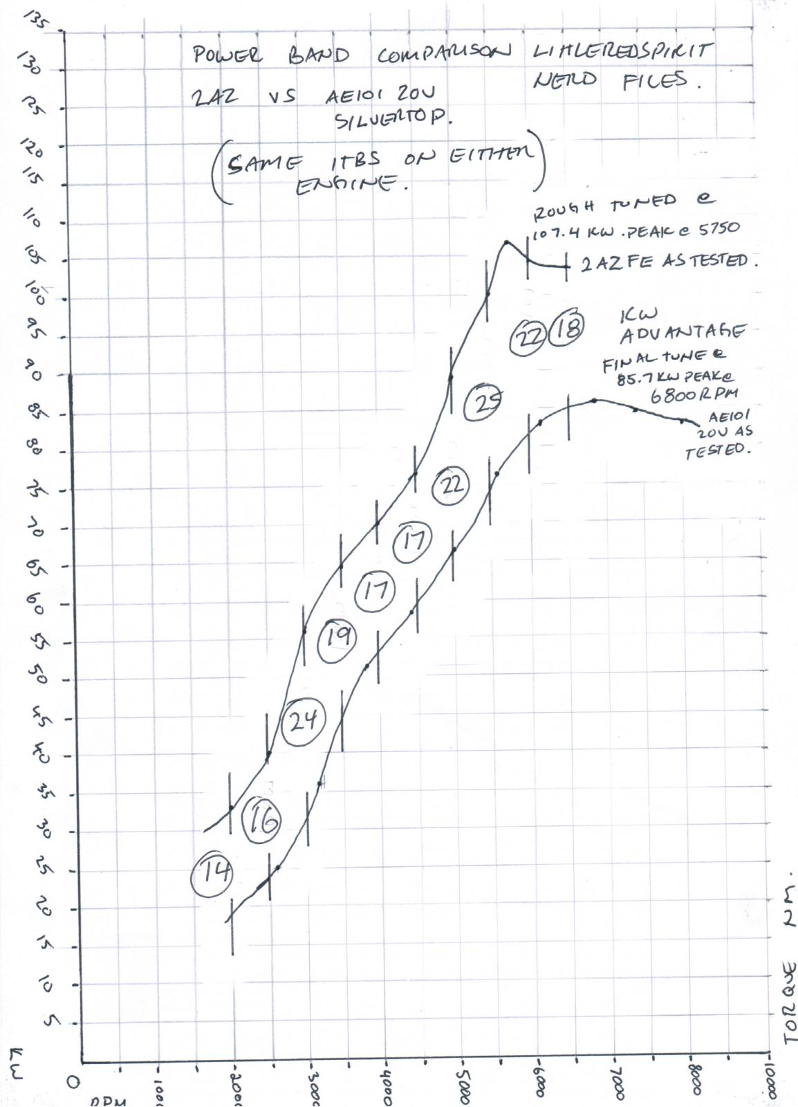

LittleRedSpirit Posted March 20, 2017 Author Report Posted March 20, 2017 Bored on lunch break = graph Quote
