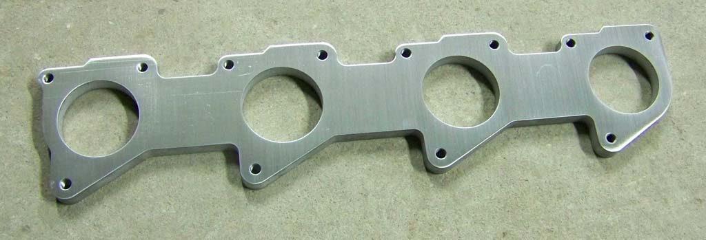

Sam_Q Posted September 18, 2011 Report Posted September 18, 2011 well I didn't think I would be posting an update for this thread but why not. Flange is going to get cut tomorrow or tuesday, likely to be picked up on wednesday and I still have the tapping head in my mill so I can quickly tap the mounting holes out. The throttles will likely be dropped off later in the week for which I will modify the tabs to suit. The flange design looks the part and I look forward to seeing how it works it. Quote
LittleRedSpirit Posted September 20, 2011 Author Report Posted September 20, 2011 Sams awesome contribution to the inlet manifold. Quote
