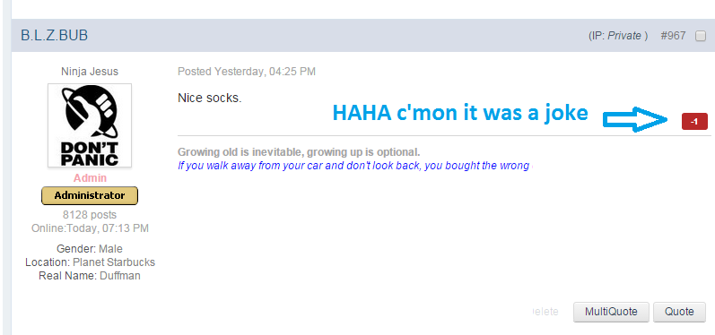

LittleRedSpirit Posted August 27, 2015 Author Report Posted August 27, 2015 All you can say is something about the socks? WTF? Quote
B.L.Z.BUB Posted August 27, 2015 Report Posted August 27, 2015 Haha. Sounds amazing. Do a skid. Must feel so good. I know it did when I did the gze swap. Quote
