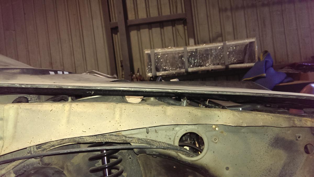

LittleRedSpirit Posted August 11, 2014 Author Report Posted August 11, 2014 (edited) It doesnt stick through much at all now Edited August 11, 2014 by LittleRedSpirit Quote

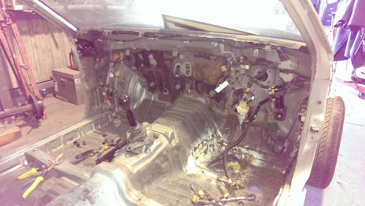

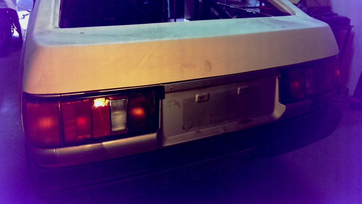

LittleRedSpirit Posted August 12, 2014 Author Report Posted August 12, 2014 Booster pained. All trim washed. I have blue, tan brown and red black. Its going all black and grey. I also installed the heater box and made sure all the connections were going to be possible, which I think they are. I had to rotate my heater out pipe but thats it really. I also went to the wreckers and got the door switches, the rubber boots for them, the handbrake boot and tray, and a few smalls. I installed the handbrake tray and lever with a splitter cable I found. I also installed the wiper motor and assembly in the bulkhead, and found a spanner I lost ages ago inside there. When I return to the shed I have to organise the trim and see what I ned to source and replace. I noticed I have no console, no rear hatch trim panel or taillight trim panel for inside the lights. I have almost all other things though. Quote

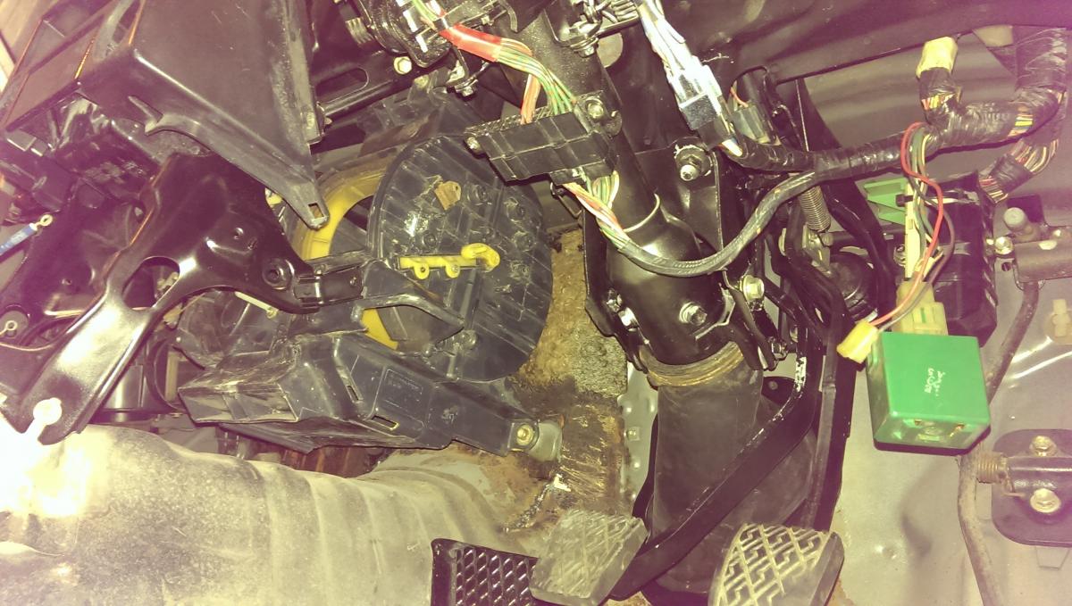

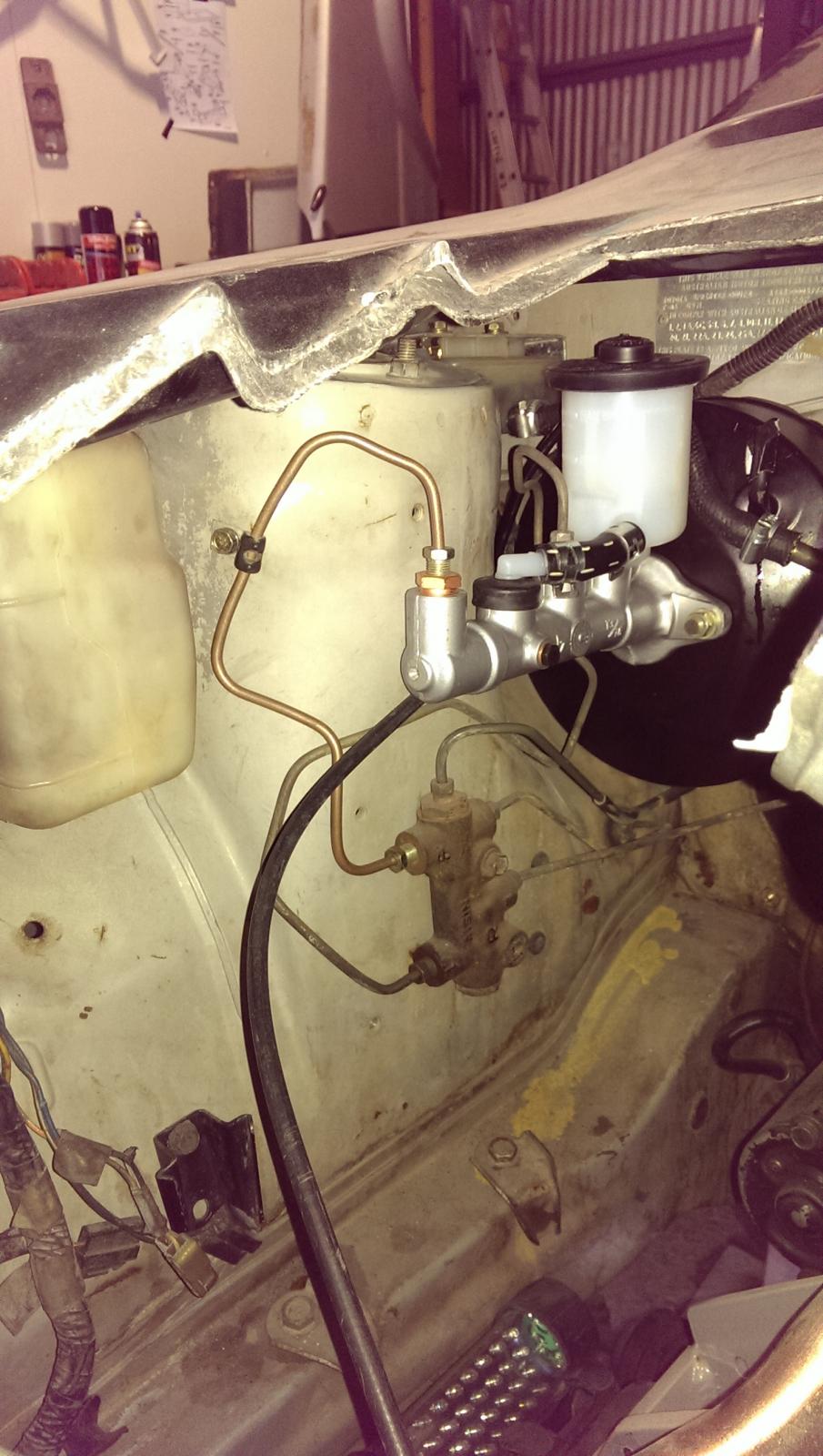

LittleRedSpirit Posted August 13, 2014 Author Report Posted August 13, 2014 Today I fitted so may things back into the shell. Heater box. Blower motor. Demister vents. Pedals. Steering column. Dash brackets. Door switches and their boots. Seat belts clutch master. Brake booster and master. Front Goodridge braided brake lines. Washer bottle. Heater hoses and tap Vents in pillars. I started going through the trim I have and sorting colours and looking at whats damaged. I need quite a few pieces I think. I need to organise some handbrake cables for the diff, and rebuild the rear brakes and I can bleed the brakes. I have bled the clutch, gives me plenty of throw. Works great. Ill know more when its running about the finer points of disengagement. Had to make a stylish little bit of bundy tube to connect the JDM style MC, which has the front circuit pointing upwards instead of forwards. Easy done. Quote

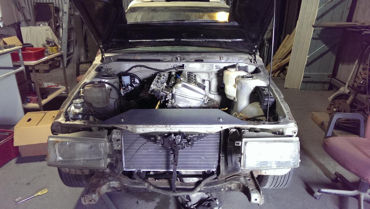

LittleRedSpirit Posted August 15, 2014 Author Report Posted August 15, 2014 I need about 30 parts to put it all together. A bunch of trim that isnt super important to find. I guess now I need Medicine man to pop by again and have a look at wiring the motor up. Then back to Ricks and get the headers fixed up. I need some handbrake cables. Tailshaft. I might even get it running without the tailshaft to test. See how it goes. I need to buy the ecu I guess now. Quote
