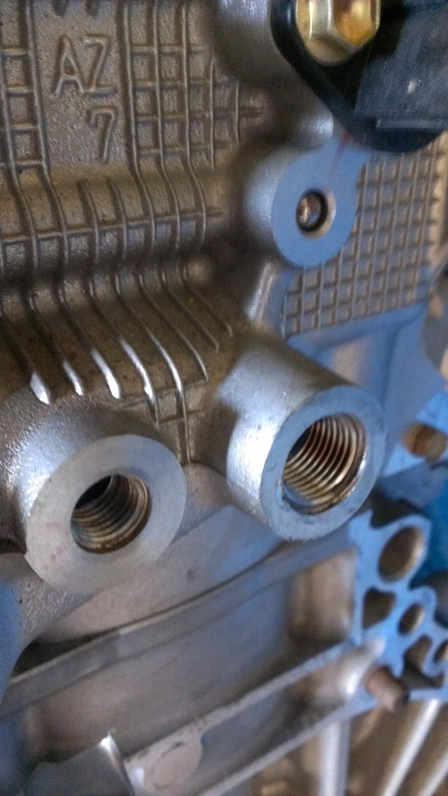

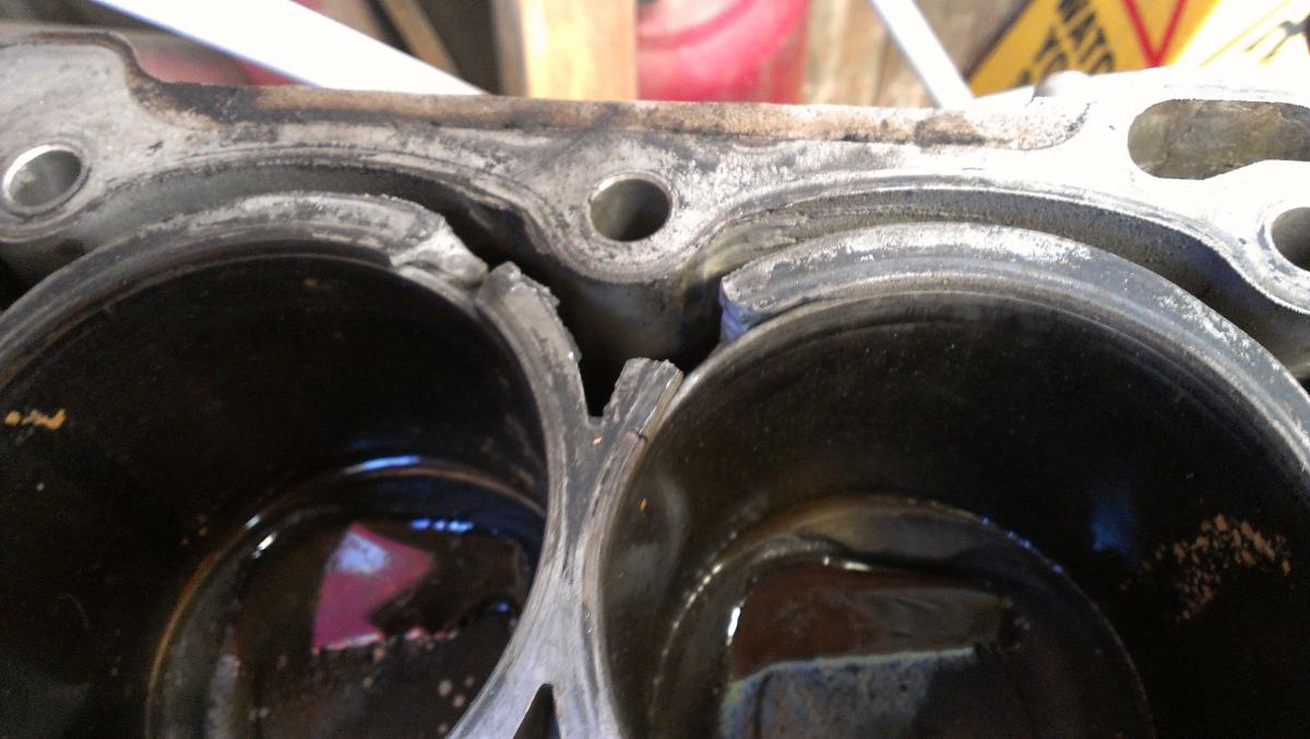

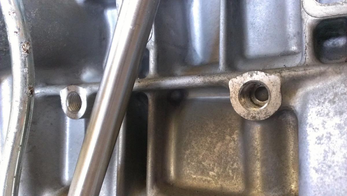

LittleRedSpirit Posted December 15, 2012 Author Report Posted December 15, 2012 (edited) Heli coil in the back of the motor has just been fitted. Also had Danny the heli coil guru tap the threads in the block for the mounts. Not heli coiled at this stage, but with this equipment he was able to tap the entire depth of the hole. When I visited my mechanic mid week he showed me a 2azfe that had been completely cooked in a rental car after the driver got a stick in the radiator. The bore blew out between cylinder 2 and 3, all the valves ruined, coils all died, manifolds warped. Pretty much a massive ʞ©$ɟ up, but it was interesting to examine how the thing failed. Edited December 15, 2012 by LittleRedSpirit Quote

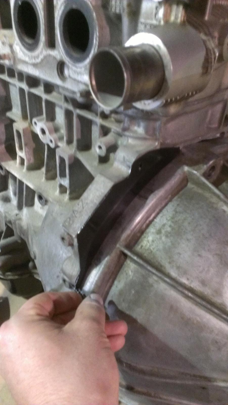

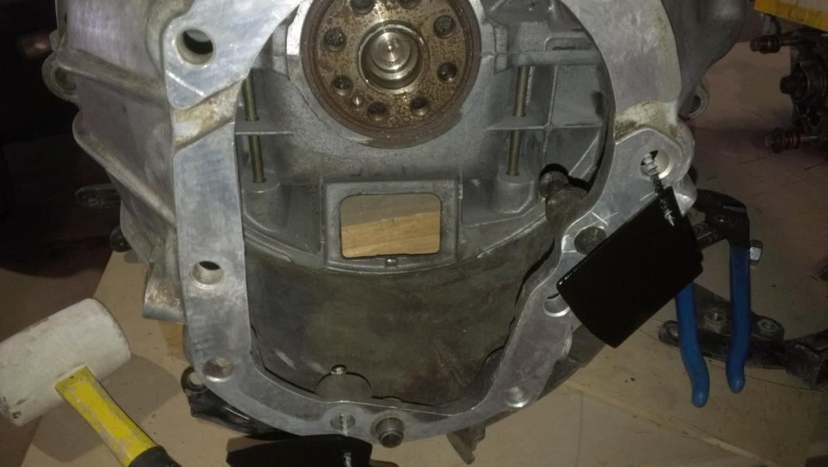

LittleRedSpirit Posted December 15, 2012 Author Report Posted December 15, 2012 (edited) I did more work on the bell-housing union today. I examined every hole for its suitability and I ended up making a 5 bolt and 2 stud union thats perfectly strong. I was able to tap into the meaty rim of the bell-housing for the most part. I have a photo with all the holes numbered around the bell-housing and some notes about doing it if anyone wants to see them. Edited December 15, 2012 by LittleRedSpirit Quote

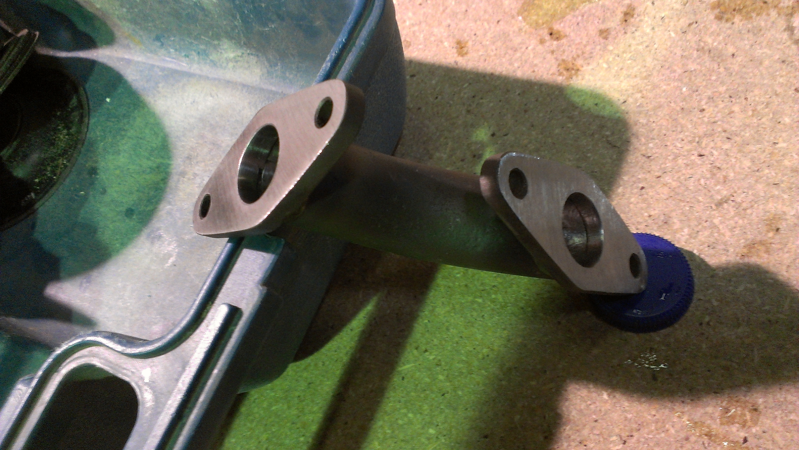

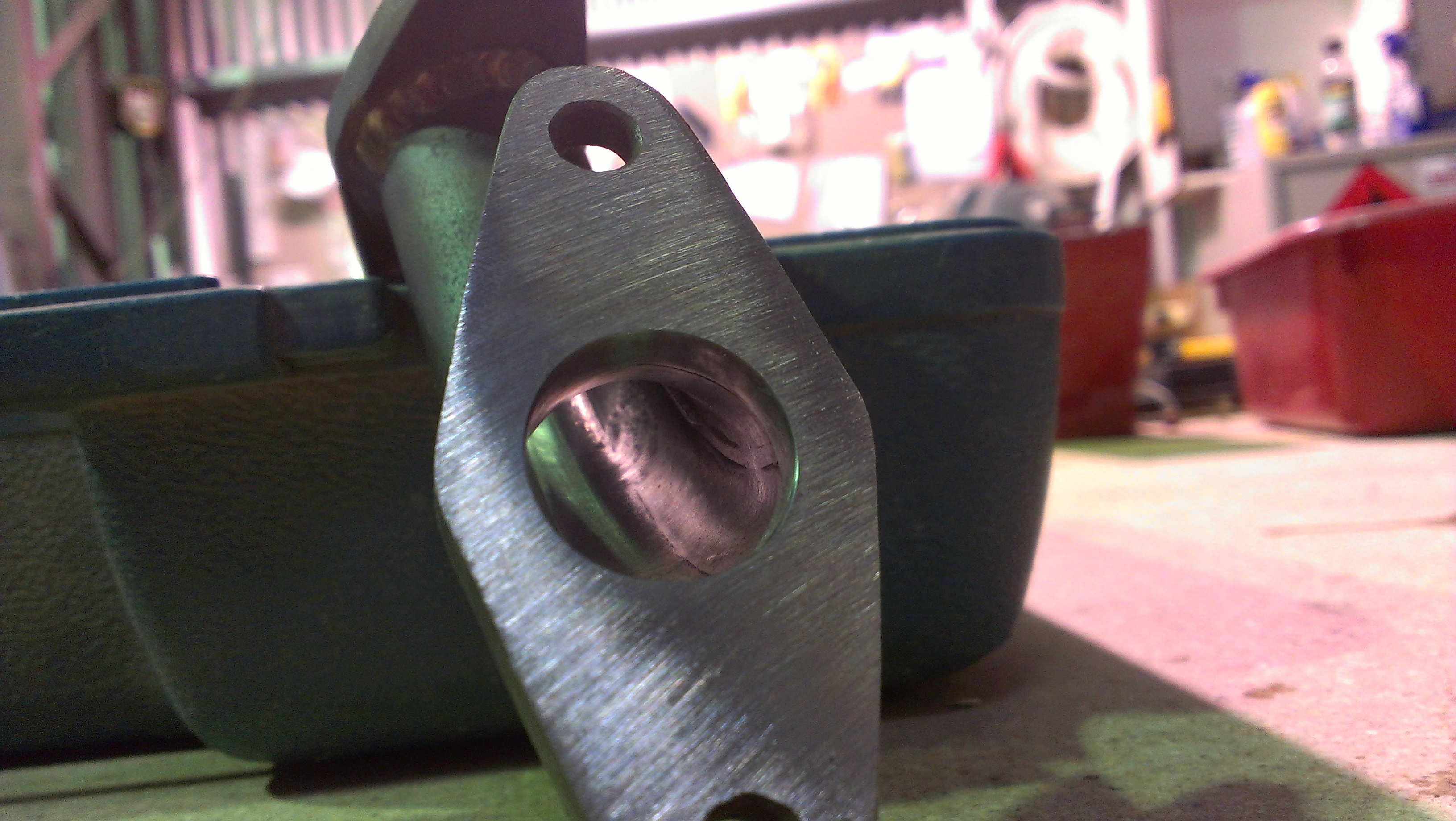

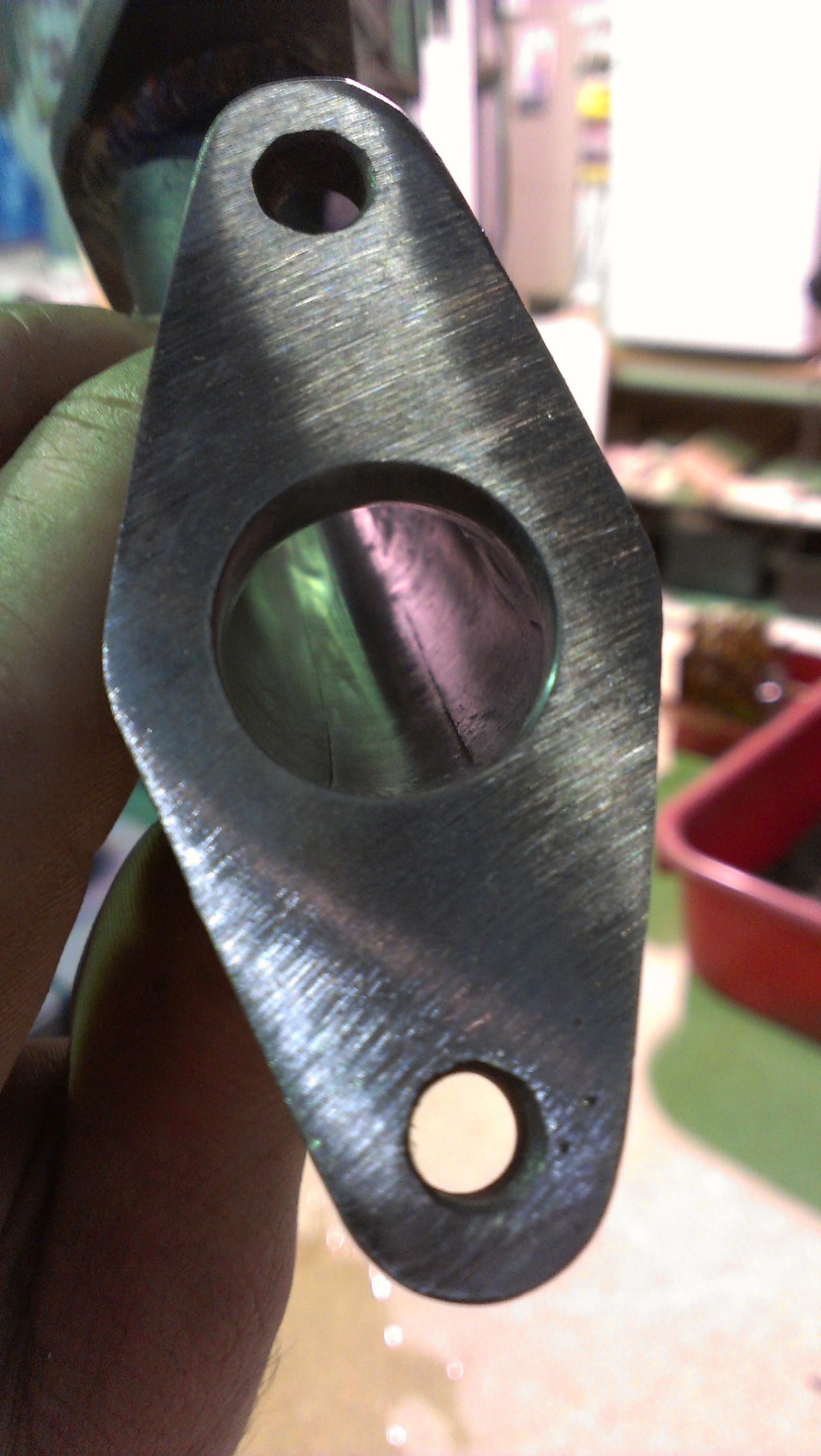

LittleRedSpirit Posted December 31, 2012 Author Report Posted December 31, 2012 (edited) Went and did a few more small things. Drilled a couple of holes in some of the larger steel plate areas of the mounts, just to shed some precious grams. I also got finer emery cloth and made a jig to polish inside the inlet manifold and the inside of the oil pipe. Its like a mirror in there now. Should be nice and smooth to flow air and oil respectively. Now that I have a disc and linisher sander combo machine i was able to face the flanges on the oil pipe too, came up a treat. Edited August 7, 2017 by LittleRedSpirit image replacement Quote
oh what a nissan feeling! Posted December 31, 2012 Report Posted December 31, 2012 be real careful about that pickup surface, its not something i would use a sander machine on. love your work all the same thinga are going well. Quote
