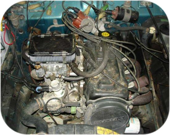

cinky Posted August 13, 2011 Report Posted August 13, 2011 just wondering is it legal to have flat type filters mounted on top of the carbi. or is it labeled the same as pod filters and illegal to have them open to air, and must be enclosed thanks in advance Quote
Spencer[RL] Posted August 13, 2011 Report Posted August 13, 2011 show us a pick of what u mean flat top filters? Like this? Quote
cinky Posted August 13, 2011 Author Report Posted August 13, 2011 yeah exactly like that. wanting to install them on the effie running twin SB carbs Quote
Spencer[RL] Posted August 13, 2011 Report Posted August 13, 2011 (edited) If its not cone shaped like the typical cone style a cop wouldn't have a clue what it is.. :laff: .. But saying that I would belive that it will need to be enclosed . Edited August 13, 2011 by Spencer Quote
