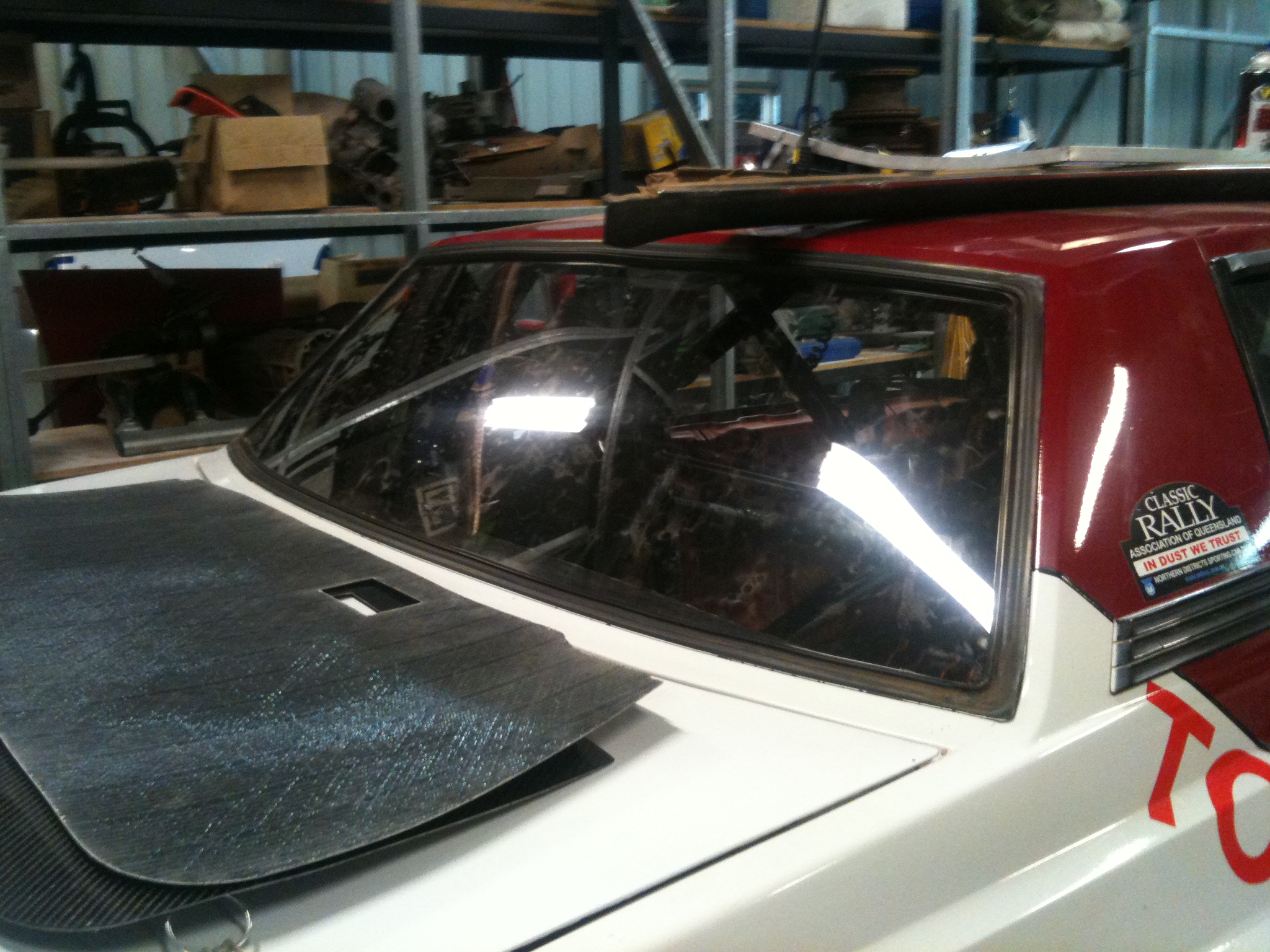

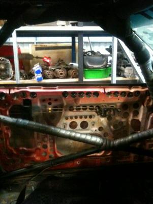

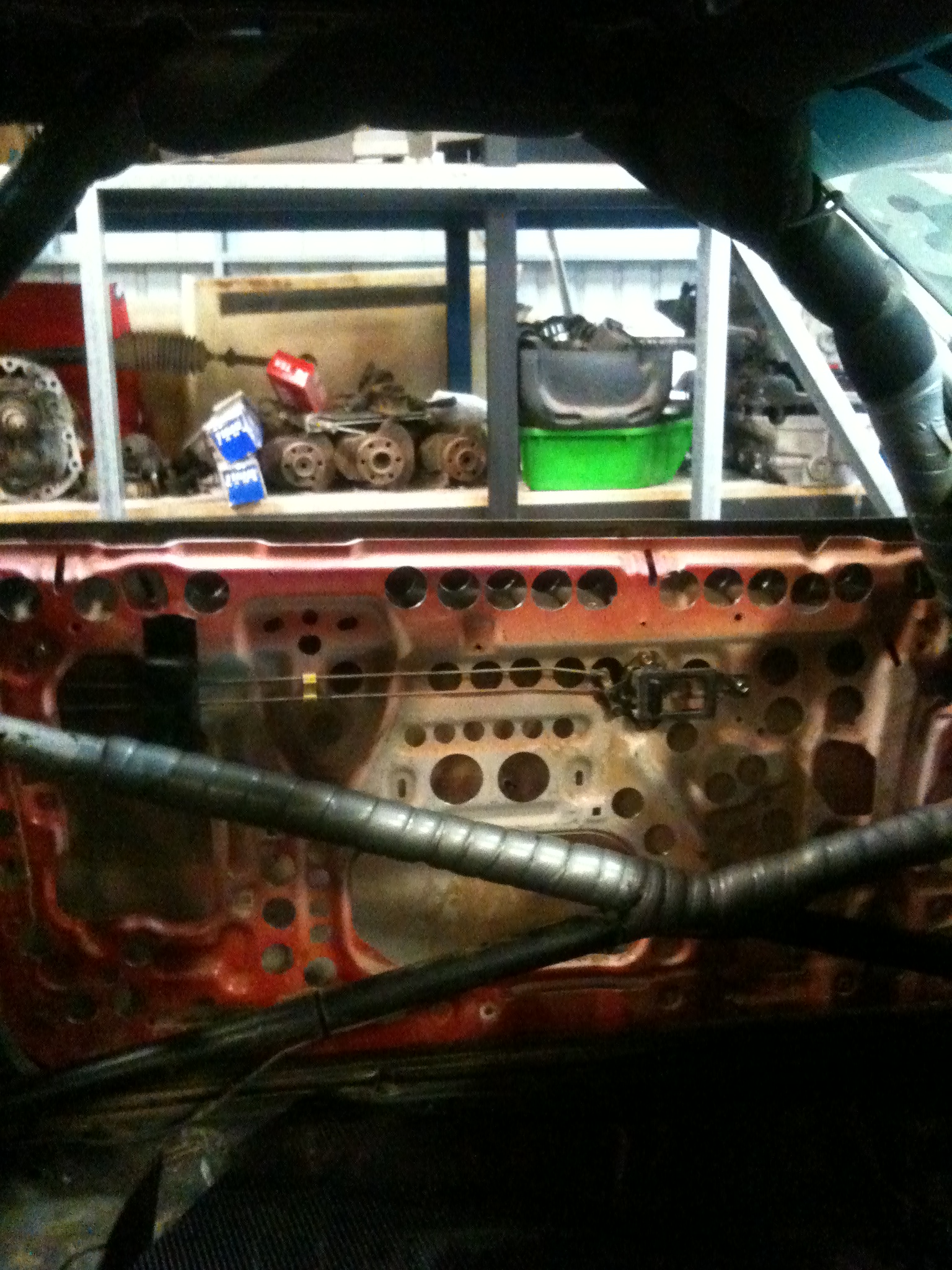

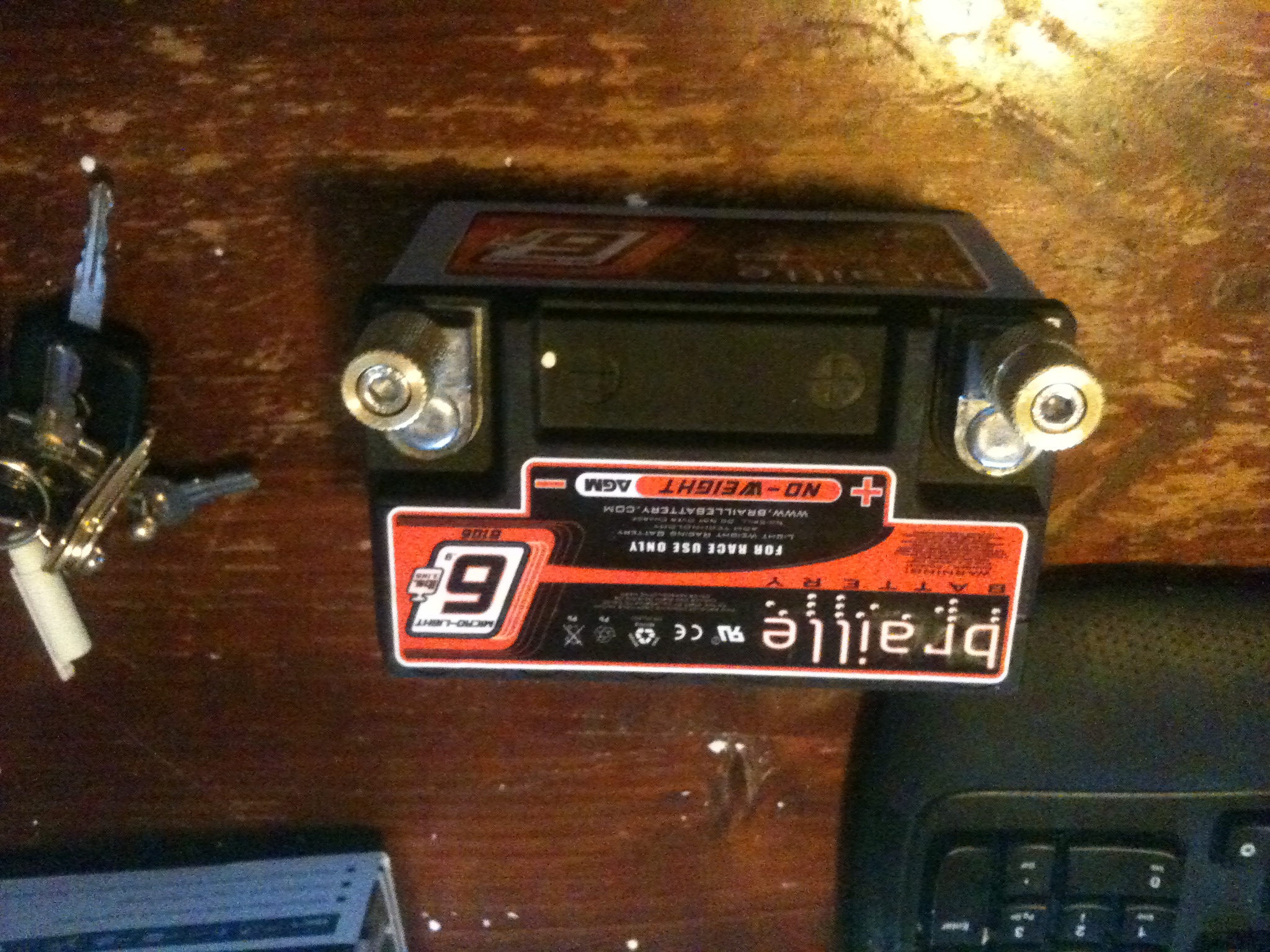

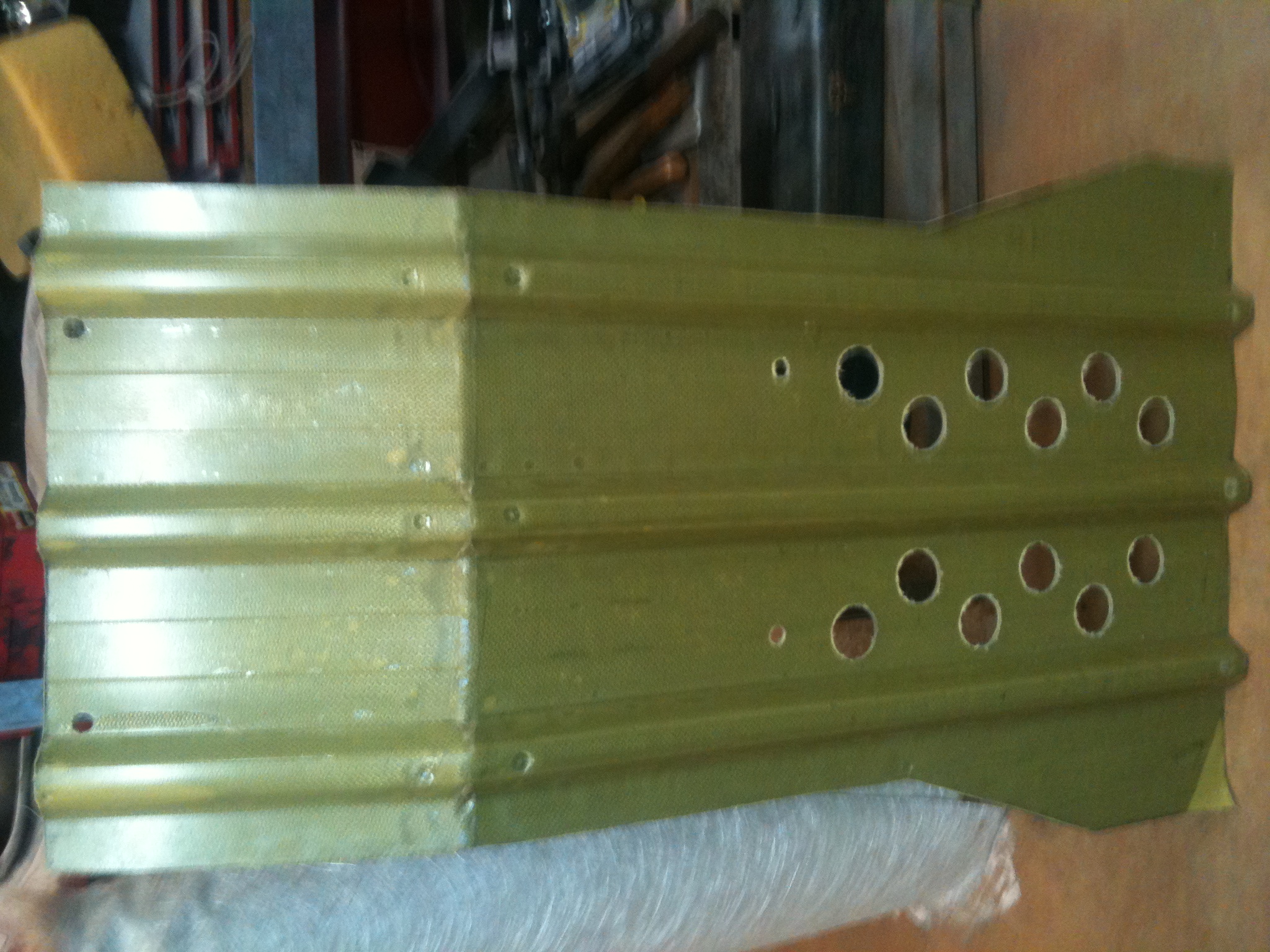

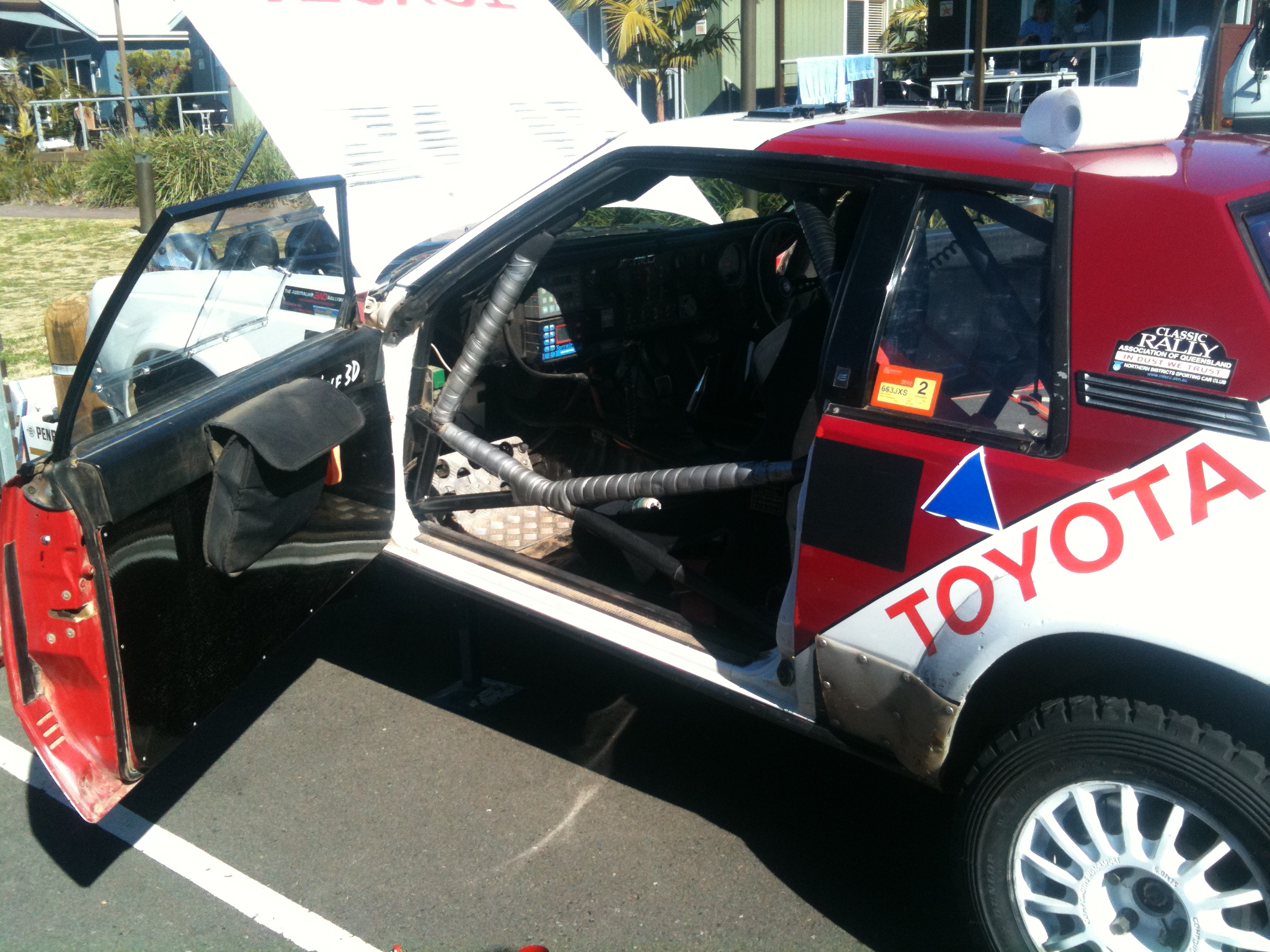

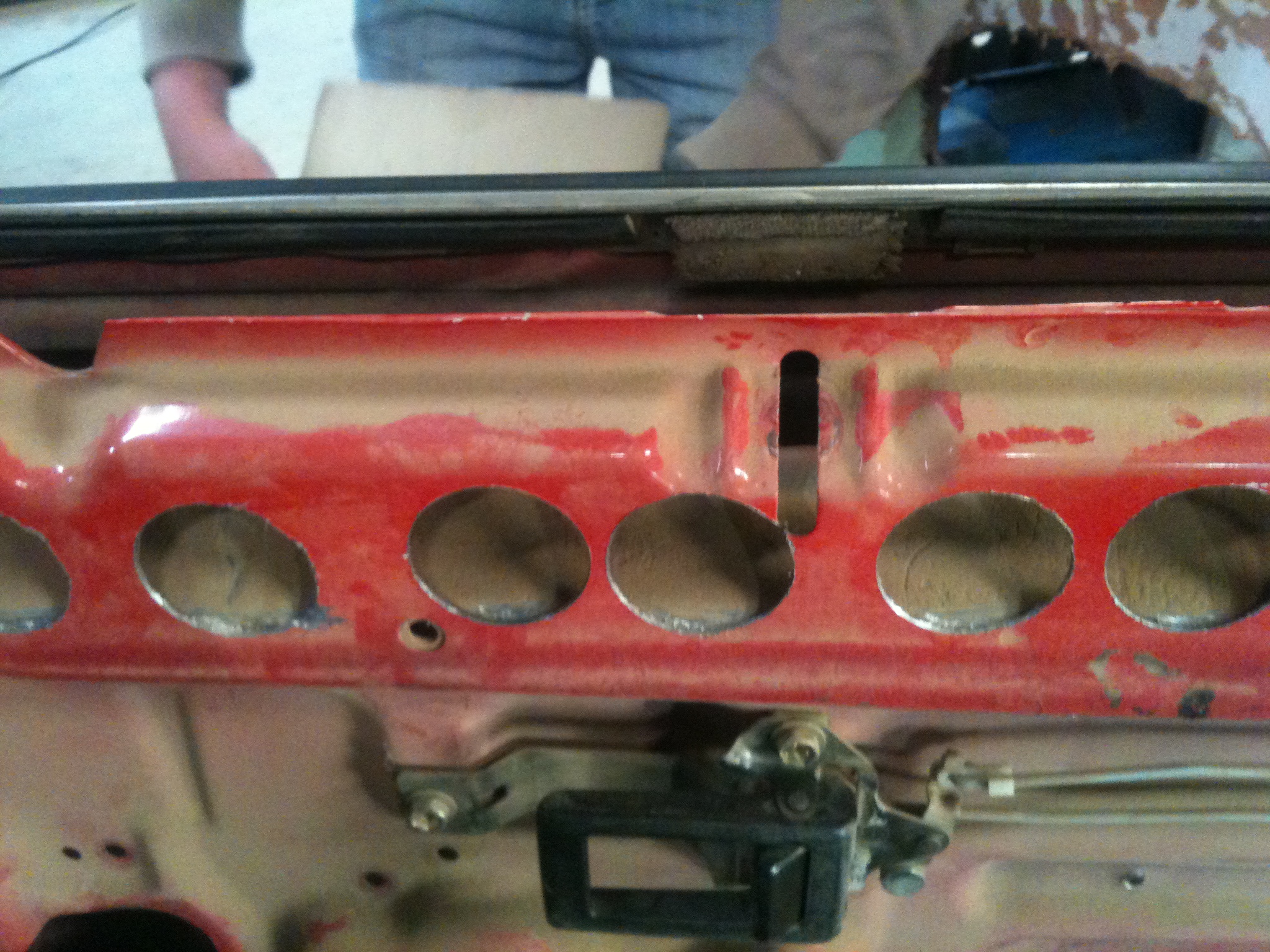

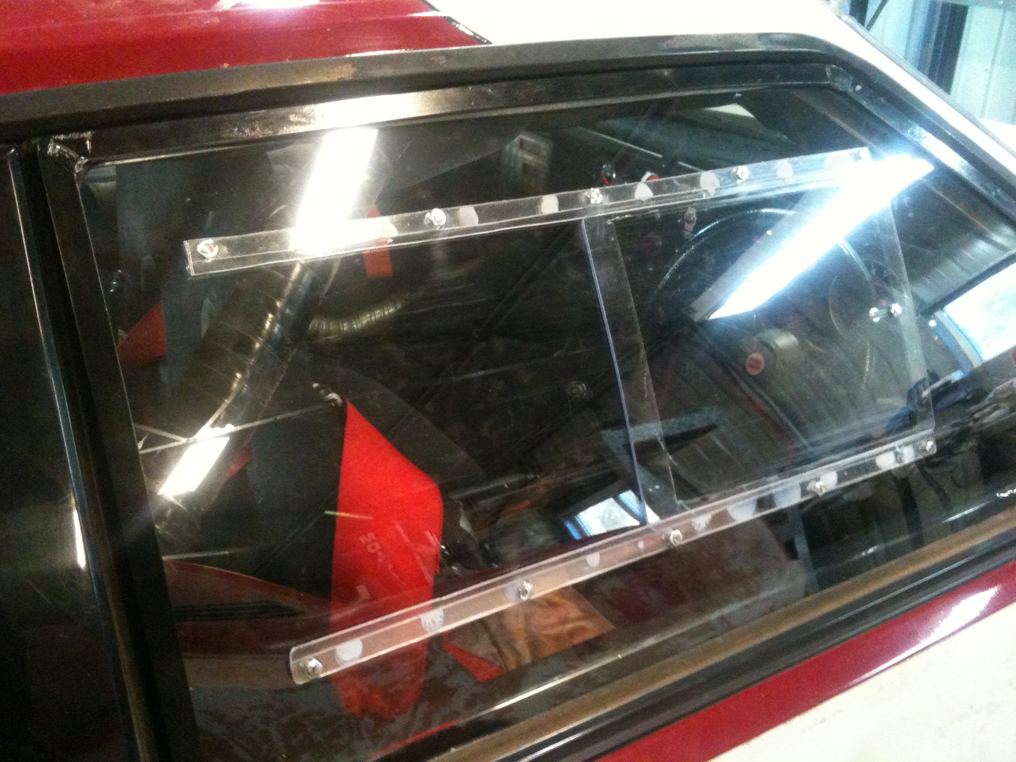

TRD ke70 Posted August 2, 2011 Report Posted August 2, 2011 IMO an weight out of the car is a good thing, whether it be sprung or unsprung. the less weight you have to drag around a race track the better. I have just gone through a weight reduction on a rally car, and removed about 50kg's, this was achieved by changing the sump guard to a lighter one, replacing the glass with lexan, and good use of a holesaw. The driver really noticed the difference in the way he could carry more speed through the corner. What we do, is to try and reduce as much of the unsprung weight as possible, IE tyres and wheels, but you get to the point where you just can't reduce it anymore. Every little bit of weight you can remove from the car helps, you might not feel 1 or 2kg's, but add that up over 3 or 4 items and you'll start to notice the difference. If you look closely at the car, there so much you can remove, from intrusion bars in the doors, to unused brackets and it's only going to cost you time with a grinder and hole saw. Other stuff will start to cost money, but the benefits are there. A change in battery saved us 7kg's!! My advice would be, look at the over all picture not just one thing!! Hope this helps!! Quote
