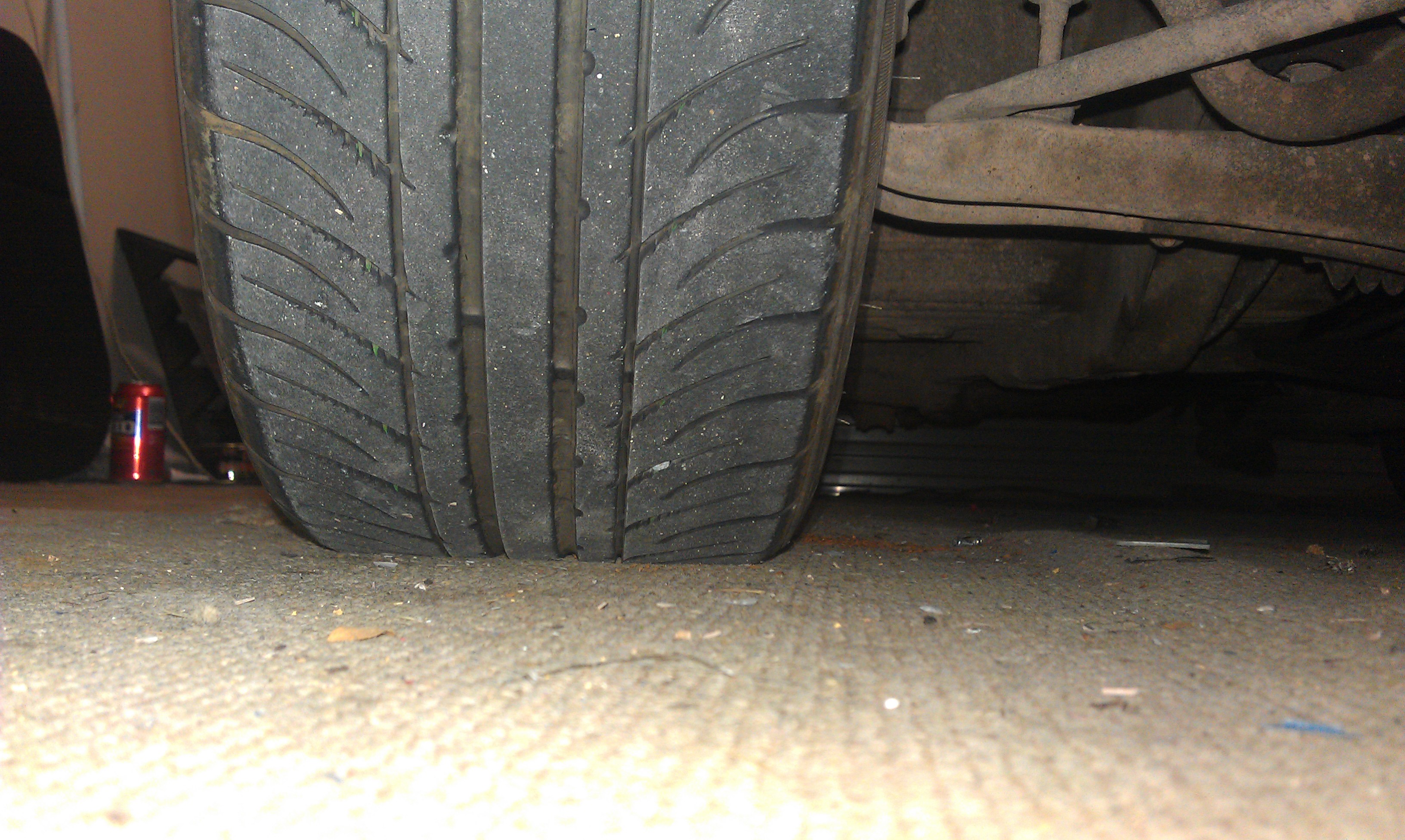

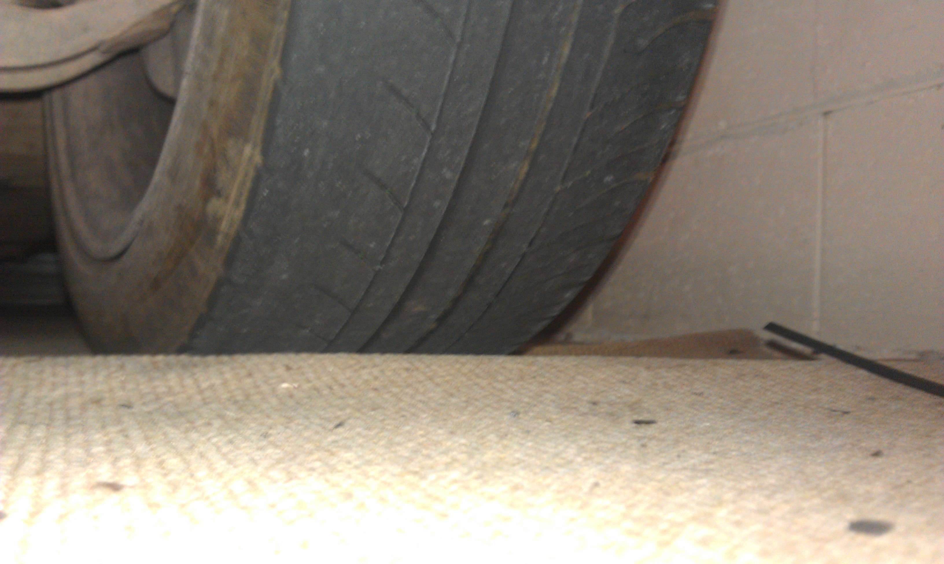

B.L.Z.BUB Posted July 20, 2011 Report Posted July 20, 2011 (edited) Hey guys, I've just noticed my front left is wearing on the inside. All other wheels are wearing relatively evenly. Just wondering if it could be wheel alignment although id assume both fronts would be wearing. I had it done not too long ago. If not any ideas? Could that wheel be getting more brake pressure maybe meaning that tyre takes more load. Do I just go round way more right hand corners? Having a google most are saying wheel alignment or bushes? I got new tierods before wheel alignment. As always any advice appreciated. Cheers, Reed EDIT this is how drastic the difference in wear is. FR FL Edited July 20, 2011 by blzbub666 Quote
oh what a nissan feeling! Posted July 20, 2011 Report Posted July 20, 2011 wheel alignment. If you had it done recently don't go back there. Quote
Chillin Posted July 20, 2011 Report Posted July 20, 2011 I had the same problem, With camber this issue will never go away, Also if you have lowered your car the geometry of the front end will have moved out. toe out is what you have and can be fixed with a wheel aliment from any tyre shop. $50 and it reduce the problem to a bearable rate of wear Quote
B.L.Z.BUB Posted July 20, 2011 Author Report Posted July 20, 2011 (edited) Bastards. Only got done when I got the teks. That's Why I didn't think it could be that. *shakes fist. Ok at least its not something serious. Oh well Bob Jane Caloundra you just got black listed Anyone got a 195 50 15 about 3/4 wear sitting around. Edited July 20, 2011 by blzbub666 Quote
ke70dave Posted July 20, 2011 Report Posted July 20, 2011 i have a similar thing going on the nissan. but not as bad as yours...that is some nasty wear going on there. when i got all my suspension done i got a wheel align, got it done to factory settings except a bit of extra camber on the front (factory is -1 front, i got -1.5, thought i would give it a go) I've noticed the front left inside Tyre is wearing a bit more than the others too. I noticed on my wheel alignment report, that they put a bit less (i think less...) castor on the left front in order to take into account the curvature of the road.....i wouldn't have though this will cause any issues though.... i would just take it somewhere and get it re done, go to one of those electronic wheel alignment places, then they can give you a print out of before and after, so you can compare. Quote
parrot Posted July 20, 2011 Report Posted July 20, 2011 If you have clipped a kerb or similar since the alignment, it may have shifted. And as above, if you have played with negative camber, you have to expect it. I would be checking my balljoints and tierod ends, and the bushes in the lower arm and castor rods also. Another possibility is a bent stub axle. Whilst the wheel alignment is high on the list, you do need to consider those other factors too. How it sits when immobile is not necessarily what is happening when the front end is under load. Quote
altezzaclub Posted July 21, 2011 Report Posted July 21, 2011 As you add more negative camber you need more toe-in, and you may have to move outside the factory specs. This is classic for IS200s, there is stacks about it on the Altezzaclub forum, and finding a good wheel alignment techician is vital. I try and always use someone who works on race or rally cars, and I avoid the bigname franchises. Also, I stand and watch them do it! Quote

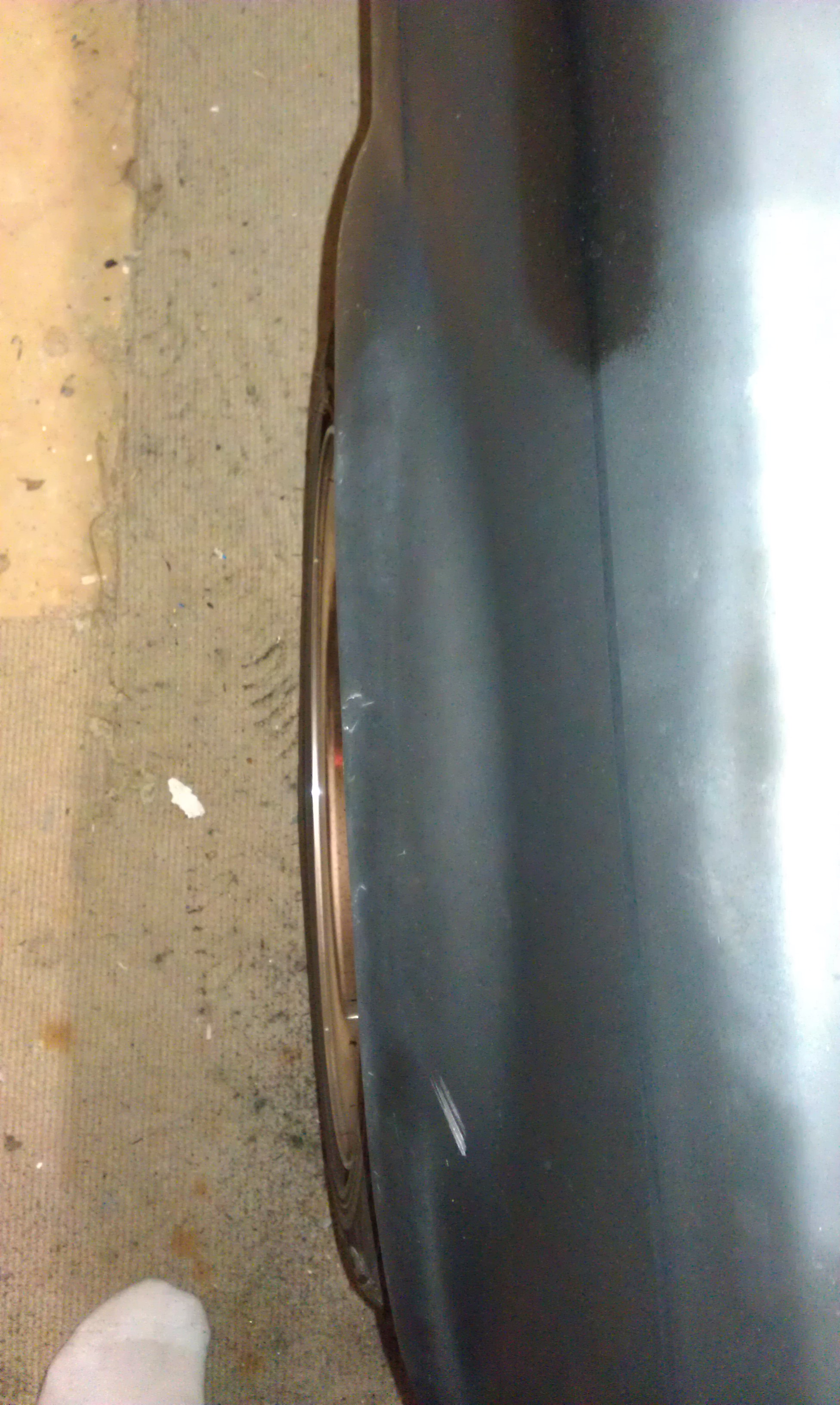

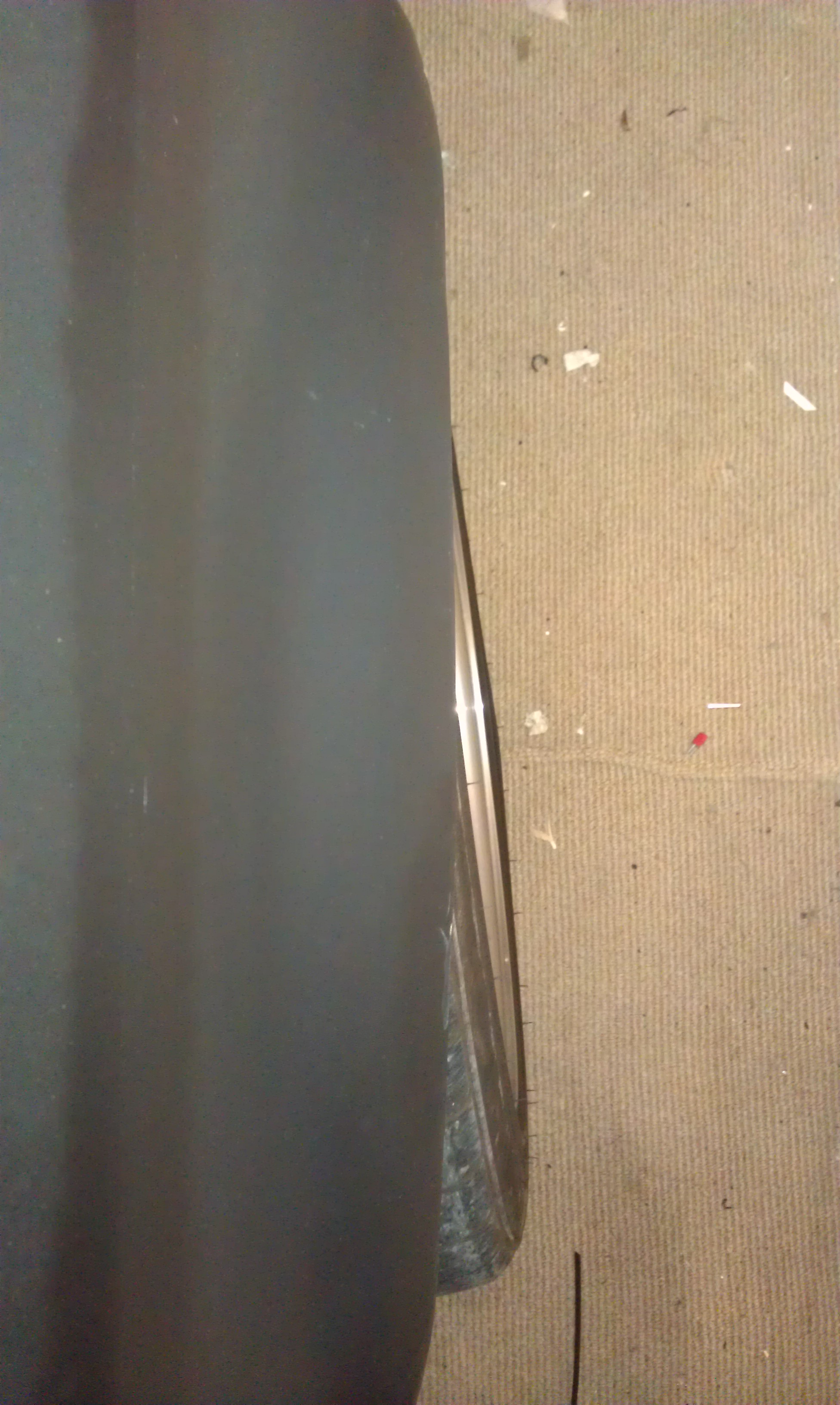

B.L.Z.BUB Posted July 21, 2011 Author Report Posted July 21, 2011 They are out by heaps. This is the best way I can show you. Should I sue? :blinks: Got the FR as straight as I could. This was the FL. So yeah I think I have found the issue. I mean really WTF? I might go have a chat with them. Wish I had the docket still. And no, I haven't hit anything. Should I ask for a bit of toe in? Quote

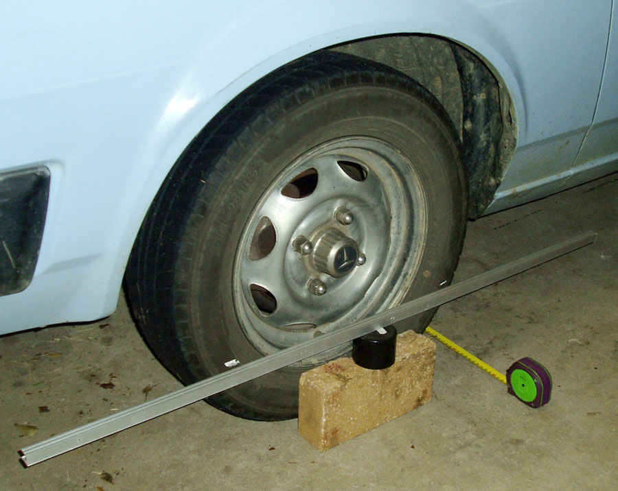

altezzaclub Posted July 21, 2011 Report Posted July 21, 2011 (edited) We grabbed two straight pieces of alloy (window channel is great) about a metre long. I marked the tyres using a level, but you could just get 4 lots of bricks or timber about 200mm high, such that a tape goes right under the car in front and behind the tyres. (exhaust gets in the way) Then we held the alloy on the marks and measured in front and behind, and adjusted it to a couple of mm toein. When I had a wheel alignment a few weeks later is was fine. http://www.rollaclub.com/board/topic/42407-the-girls-ke70/page__st__30 Edited July 21, 2011 by altezzaclub Quote
