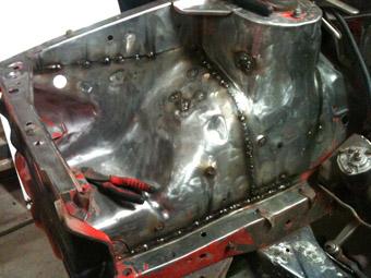

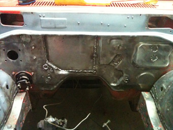

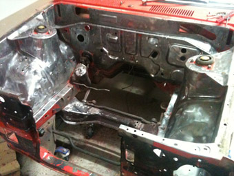

been busy with time consuming spot welding the bay, its now fully seam welded, holes filled except 4 more that i have to decide on yet and firewall semi-recesed/smoothed, some finshing touches with the welder and then ti gind them down, will post pic wen done and in primer.

heres my progress to now, got a few more welds to do then start grinding them down.
Nice work man, going to a fair bit of effort for the old girl.
Not sure whats to be gained by the minor firewall mod? but anyways carry on!
Edit: Was just thinking, if you are going to this length, you may want to remove the seal along the back of the bonnet, and weld up its holes and the seam under it. Nearly forgot about mine, cos its not quite in the engine bay.

I'm only painting the bay and where the holes are is where I'm stoping the paint so i wont weld them as i still might run that strip and where the top of the fire wall jions the the lower half isnt sean welded.
the firewall mod was originally done by another member who told me that by doing it you can get the motor back just that little bit more and have clearence for the heater hoses as on the sr they come out the back of the motor and theres a little more room to play with.
its also what will make mine different to some of the others and shows the effort I'm willing to go to.
I welded up the heater hose holes in the firewall and re-drilled them on the other side of the motor, hidden under the inlet manifold.
The heater pipes are quite easy to re-route under the dash to the new location.
This removes the need to run heater pipes behind the engine taking up valueable space.
Looks like you've already welded up the heater holes anyways, same idea?

yeh il wait til the motor goes in before paint to figure out the heater hoses but definatelly will be relocated, i do want the space behind so i can get the motor back as far as i can for better weight distribution.

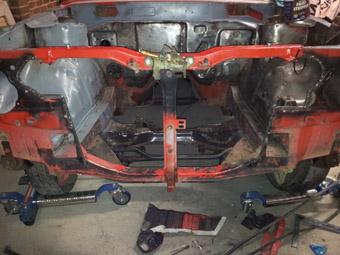

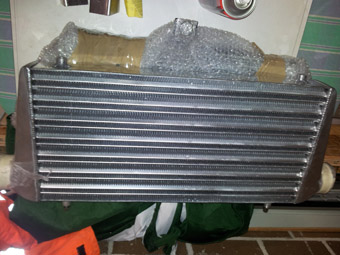

i have bought my intercooler and mounted it by modifing the radiator support pannel by cutting it away and then rebracing it with 6.5mm solid round bar around where i have cut each side, brackets have also been made but need to be welded once i figure out how I'm gonna mount the radiator.

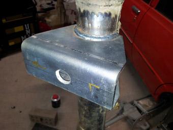

I also have bought my diff mounts can't remember if i meantioned it before, these have been final welded on (today) and have there side bracing done, i just have to smooth out the welds and grind away the old ones and the diff is off to powder coat, i have pulled the axles and centre out of my other diff that i was using the innards for the modified housing, it has 4.11 diff gears in it, :yes: once the drums are stripped from the axles they will be sent off to be shortened.
