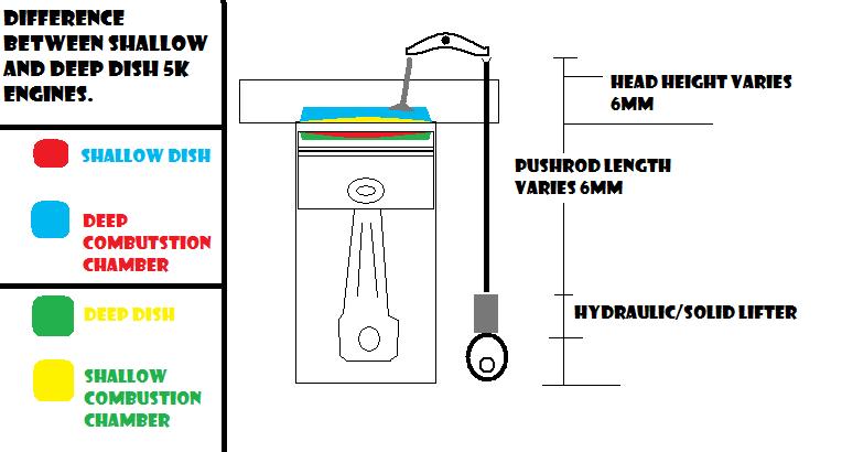

Jono.C Posted June 28, 2011 Author Report Posted June 28, 2011 Okay. So another question, Just thinking then that the holden/ datsun combo is for a solid lifter conversion on a 5k with a 5k head But what about for a 4k head on a 5k block? Because, Isn't a 5k block the same height as a 4k one? and with a 4k head couldn't you just run the 4kc cam pushrods lifters and head with valve gear and be done with it? Quote
Taz_Rx Posted June 29, 2011 Report Posted June 29, 2011 Mine is 5k bottom end / 3kbp head :wink: Quote
tojo2 Posted June 29, 2011 Report Posted June 29, 2011 (edited) Isn't a 5k block the same height as a 4k one? and with a 4k head couldn't you just run the 4kc cam pushrods lifters and head with valve gear and be done with it? Yes same height block but 5Ks have larger diameter lifters so can't use 4K lifters Edited June 29, 2011 by tojo2 Quote
GJM85 Posted June 29, 2011 Report Posted June 29, 2011 Okay. So another question, Just thinking then that the holden/ datsun combo is for a solid lifter conversion on a 5k with a 5k head But what about for a 4k head on a 5k block? Because, Isn't a 5k block the same height as a 4k one? and with a 4k head couldn't you just run the 4kc cam pushrods lifters and head with valve gear and be done with it? Yes the block height is the same. No you cannot use 4k lifters in a 4k block because the lifter bore is a different size. The holden lifter and datsun pushrod combination is a tried and tested combination for what your trying to achieve. Do you have a shallow or deep dish piston 5k engine? The deep dish (D-shaped) 5k has a shallow combustion chamber in the head. That head is 6mm shorter in height than the shallow dish (O-shaped) engine. If you have the shallow dish engine using a 4k head won't lower compression as the heads are almost identical. Here's a diagram I drew sometime ago, if you can understand what i've tried to display. Quote
Jono.C Posted June 29, 2011 Author Report Posted June 29, 2011 I've got the D dish 5k and Intending on using a flat top 4kc head Quote
GJM85 Posted June 29, 2011 Report Posted June 29, 2011 I've got the D dish 5k and Intending on using a flat top 4kc head Ok then your sweet. I wracked my brain for weeks trying to understand the in and outs of this conversion. Use the 202 lifters, a12 pushrods, 4k head and adjustable rocker gear. Get your cam reground to suite solid lifters and you'll be sweet. Quote
