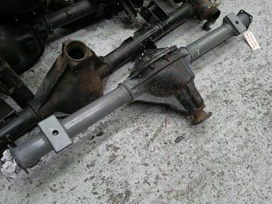

radrollaz Posted July 28, 2012 Author Report Posted July 28, 2012 (edited) Hi, been doing alot to the rolla recently like finishing all the mounts off and getting Marty round to do my custom radiator support. Ill most probably have to go custom radiator but i will look around and see if i can fit something stock out of who knows what as its just a standard 2.0L motor and i have heaps of room for it. I'm keeping the idea of the AE71 rack and pinion aside for now as i have to bolt on the factory extractors and see if it will fit with factory Ke30 steeering box set up, just in case a good mate with a huge OKA Aussie Built machine came past and dropped a rack off to me so i can cut it up. Went and pickup up my stock ke diff and got a sneek peak of my cut down diff awaiting axles which was good. Started on the tunnel last night so thats going to be interesting, first time for me so see how we go, luckaly i have good mates who can fab up the harder stuff for me. More pics next time ! Edited July 28, 2012 by radrollaz Quote
radrollaz Posted August 11, 2012 Author Report Posted August 11, 2012 (edited) Hi, thought id update you guys with more pics. Tunnel is welded up and nearly done and i got my diff back cut down and ready to be trial fitted. Looking forward to mounting up my custom tramp rods and sorting the rest of the drive line over the next few weeks. Also got to finally try my 16 inch Falcon chasers on the rear and they fit good, just need to get the widened now. Edited August 11, 2012 by radrollaz Quote
