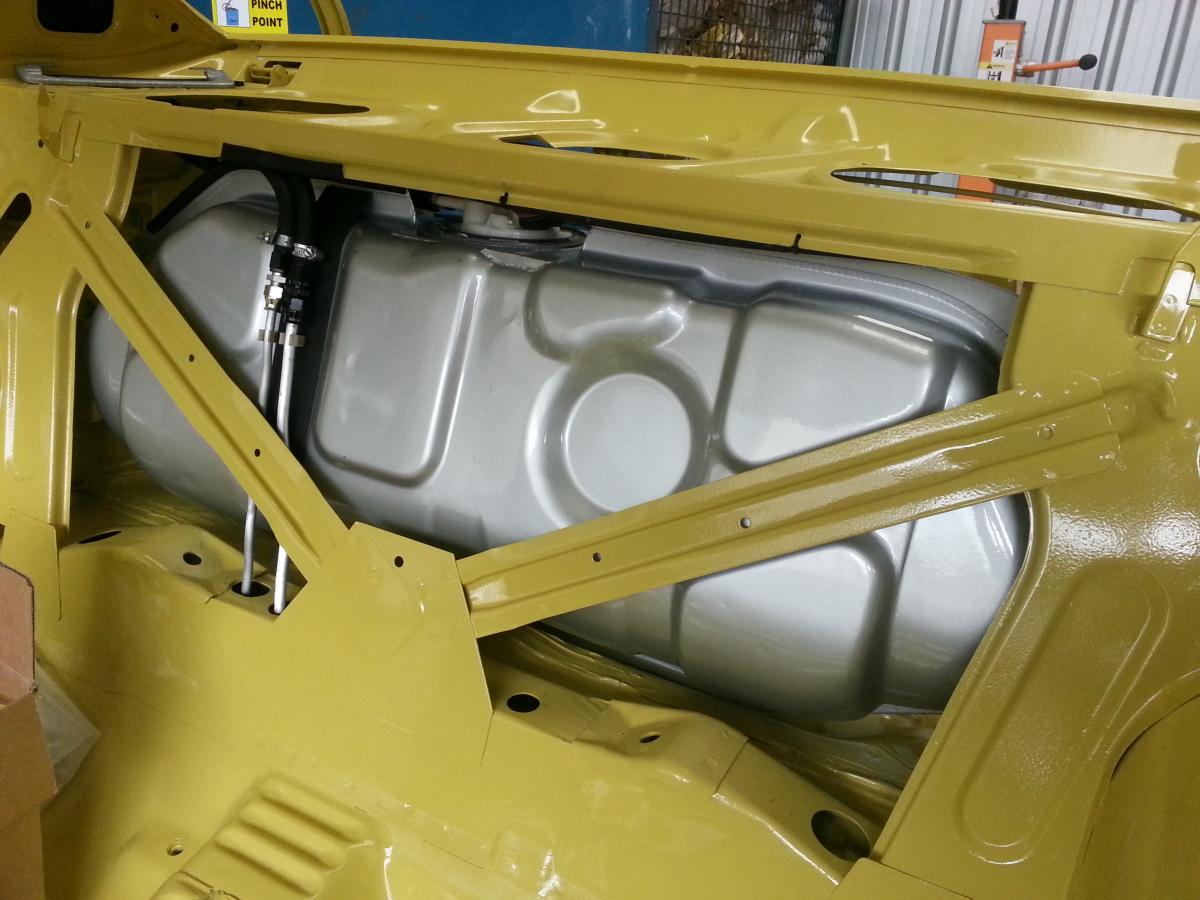

Jordain Posted February 3, 2013 Report Posted February 3, 2013 You should've shortened the fuel pump setup like me and Luke did so you didn't have to cut the tank up so much. Good work and progress though Mick! Can't wait to go for a cruise in it :P Quote

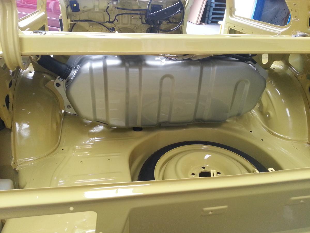

radrollaz Posted February 3, 2013 Author Report Posted February 3, 2013 On 2/3/2013 at 6:30 AM, Jordain said: You should've shortened the fuel pump setup like me and Luke did so you didn't have to cut the tank up so much. Good work and progress though Mick! Can't wait to go for a cruise in it :P Its actually been lenghtend by 3 inches so it would work as the ke30 fuel tank is deeper. The flat bit on the bottom of the tank allows the pickup to sit flat on the bottom and insure it will always be imersed in fuel even when running low on fuel. I fitted a walbro pump also incase i ever chase more power down the track. Quote

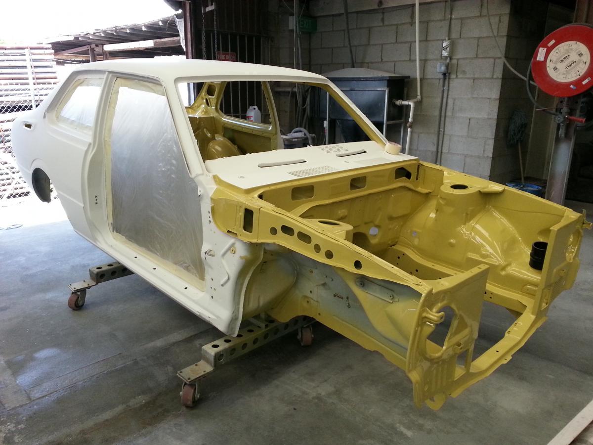

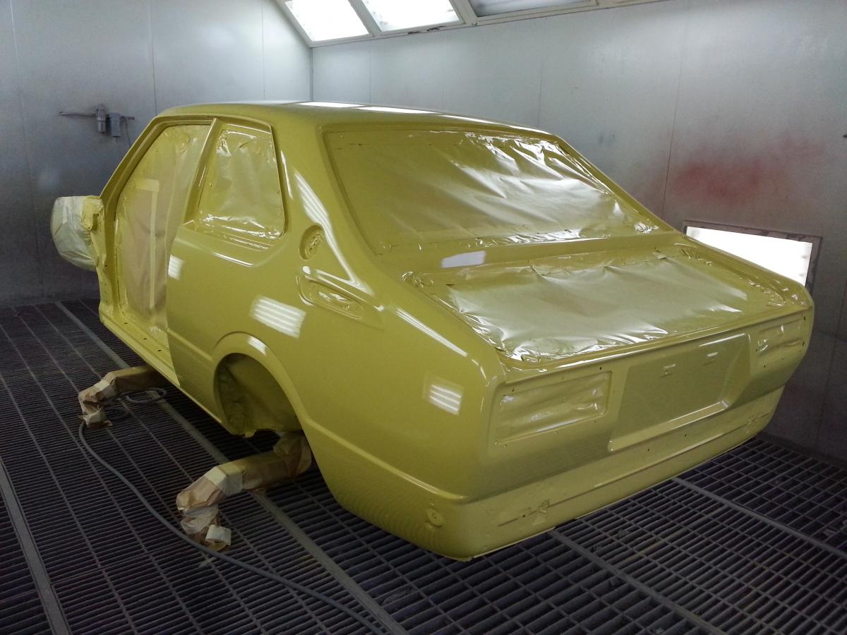

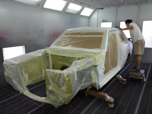

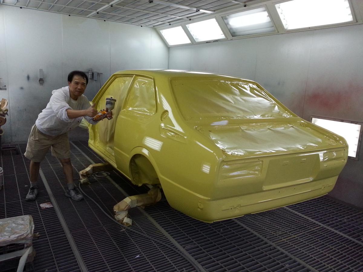

radrollaz Posted February 8, 2013 Author Report Posted February 8, 2013 Finally she's painted, big thanks to my mate the crazy chinaman for the paintwork. Quote
KE04AG Posted February 9, 2013 Report Posted February 9, 2013 Hell yeah!!! Looks awesome Mick!! Is it done in clear over base or 2K solid? And now the fun begins, piecing it back together. Hope to see it done soon mate!! Quote
radrollaz Posted February 9, 2013 Author Report Posted February 9, 2013 Thanks jason, its 2k solid. Quote

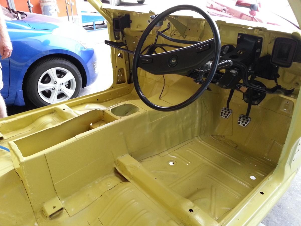

Taz_Rx Posted February 14, 2013 Report Posted February 14, 2013 What's the go with the built up centre console/trans tunnel bit? Quote

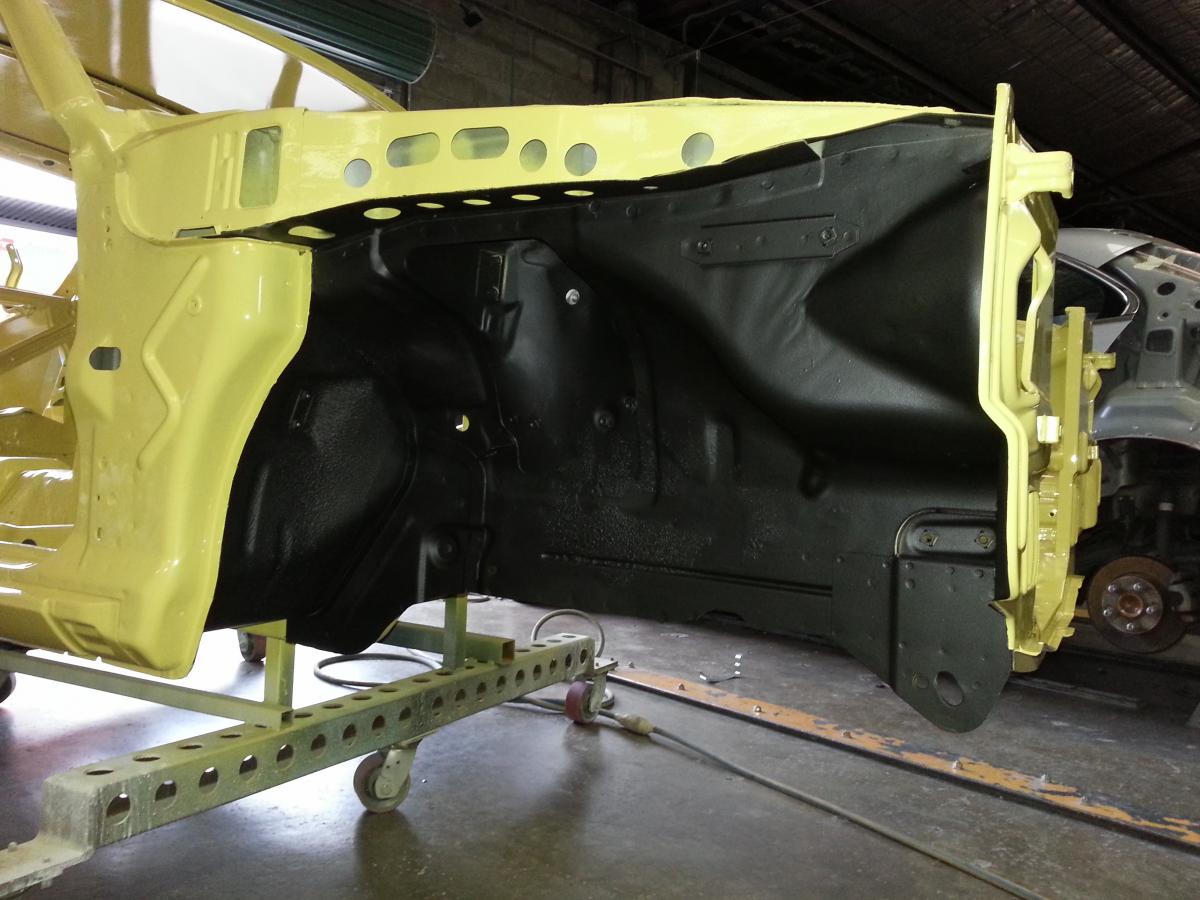

radrollaz Posted February 14, 2013 Author Report Posted February 14, 2013 On 2/14/2013 at 12:47 AM, phil86 said: Wow looking great!!! So much attention to detail! and you made it all look so easy! Questions: Did you use a KE cross member or S2K or Neither? lol and second part is with the caltrack bars do are they just stablisier type bars? whats the benefit? Do they mount to an existing part of the car or did you fab something up? thanks mate, i used the ke 30 cross member modified and reinforced with custom mounts. the caltrack bars are to help stop the leaf springs from twisting under load giving better traction. they mount off a custom mounting bar that you can see in the pics underneath. Quote
radrollaz Posted February 14, 2013 Author Report Posted February 14, 2013 (edited) On 2/14/2013 at 6:24 AM, Taz_Rx said: What's the go with the built up centre console/trans tunnel bit? the built up tunnel is just there to fit the s2k console I'm using with s2k hand brake and cup holder which i wanted to use. its standard underneath that if you look closely in a few pics you can see what i mean. Edited February 14, 2013 by radrollaz Quote
