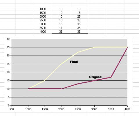

Millaz88 Posted May 29, 2011 Author Report Posted May 29, 2011 Just got a 5kc elec dizzy banged it in and OMG runs so much better and accelerates now unread of choking haha great upgrade Quote
altezzaclub Posted May 29, 2011 Report Posted May 29, 2011 Millarz can you grab a timing light and a rev counter and read off the advance every 500rpm. That will be something to compare to the electronic dizzy I fitted 6months back and had to wind the advance curve up on. You should be able to generate a curve like this. Maybe the stock 5K electronic is the way to go, or at least get the springs out of. Quote
