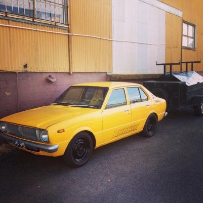

Just thought i'd throw up some pics of my old rolla.(from about 4years ago)
There was a bit of a thread back in the day on the build i noticed alot of the pics don't work anymore so ive dug around and found some of my old pics.
She started her life as an auto 3speed 4k and i "altered it a little"

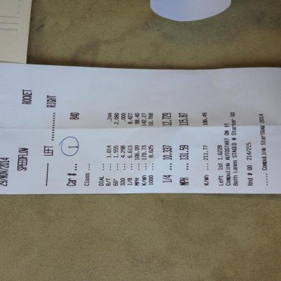

Best 1/4 time was 11.99@119mph
It now has a new home with a really nice guy in townsville
Vehicle:
1978 Ke55
Color:
Ford Glow Yellow
Bumpers, Handles and Grill painted in silver dollar tinter
ICE:
YOUR RIGHT FOOT

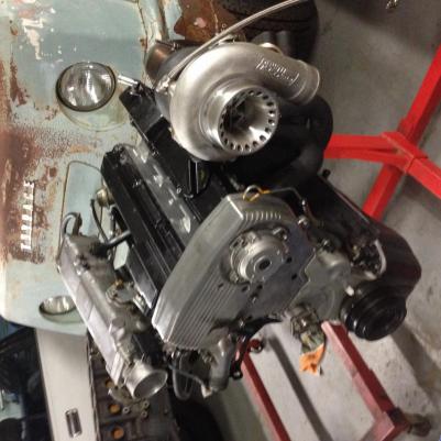

Engine:
JHH port and polished street force head
2mm oversized Exhaust vavles
CA16 inlet camshaft
Tomei Adjustable camshafts
Modified standard inlet manifold
CP 20thou over Forged pistons
Modified factory rods
Modified factory crank
Modified oil galleries in block
Upgraded oil pump
Arp Headstud kit
Arp mainstud kit
Arp rodbolts
Bolt ons:
Custom S/S exhaust manifold heatwrapped
Garrett GT2876R turbocharger
FMIC
Custom IC pipeing
Custom TBE
Microtech MTX8
individual coils
3bar mapsensor
550cc injectors
30hp Nitrous kit
Bosch 044 fuel pump
Surge tank
Modifed fuel lines
Upgraded R32 radiator
Oil cooler kit with filter relocation

Without the Nitrous and 250kms after run in
Youtube Footage
Sorry no 11sec vid!
12.7@110mph
12.23@115mph
