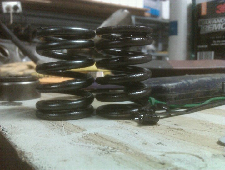

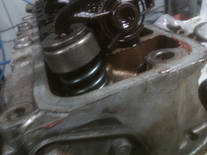

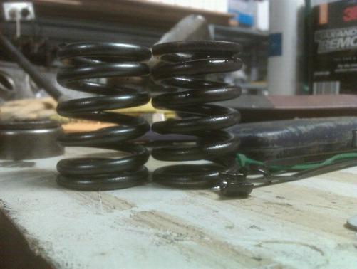

Evan G Posted September 11, 2011 Report Posted September 11, 2011 a little thread digging. i went down to my local crow cams with my 5k head. we tried using a double valve spring but the inner spring was rubbing on the stem seal? are you using a 3k head (o ring stem seal head) Philbey? i got a valve spring from a vl with a 202 or 303 (not sure) they fit fine in my 4k head 4k vs 202/303 fitted to head oh btw. crows P/N for valve springs with a helper spring? (it looks like a coil of flat metal) is 5038-8 and got the same rate as the doubles Quote
philbey Posted September 12, 2011 Report Posted September 12, 2011 They were a tight fit but not rubbing. I also noticed the inners rubbed slightly on the outers, spoke to the Crow guys and they said it's not a concern. Remember that the springs increase in diameter as they're compressed, so when a free length spring slightly rubs the retainer/outer spring, it may well be clear once you've fitted it. I've been running mine for over 12 months without problems. Quote
Evan G Posted September 12, 2011 Report Posted September 12, 2011 i went to my crow cam joint today and got a 4220 double and tested fitted it to my 4k head. fits no problem now a little FYI or for the faq page crow 5038 single valve spring with a helper strip has a max lift of .500" crow 4220 double valve springs has a max lift of .520" and fit no problem, both cost $95 (if they like you) Quote
