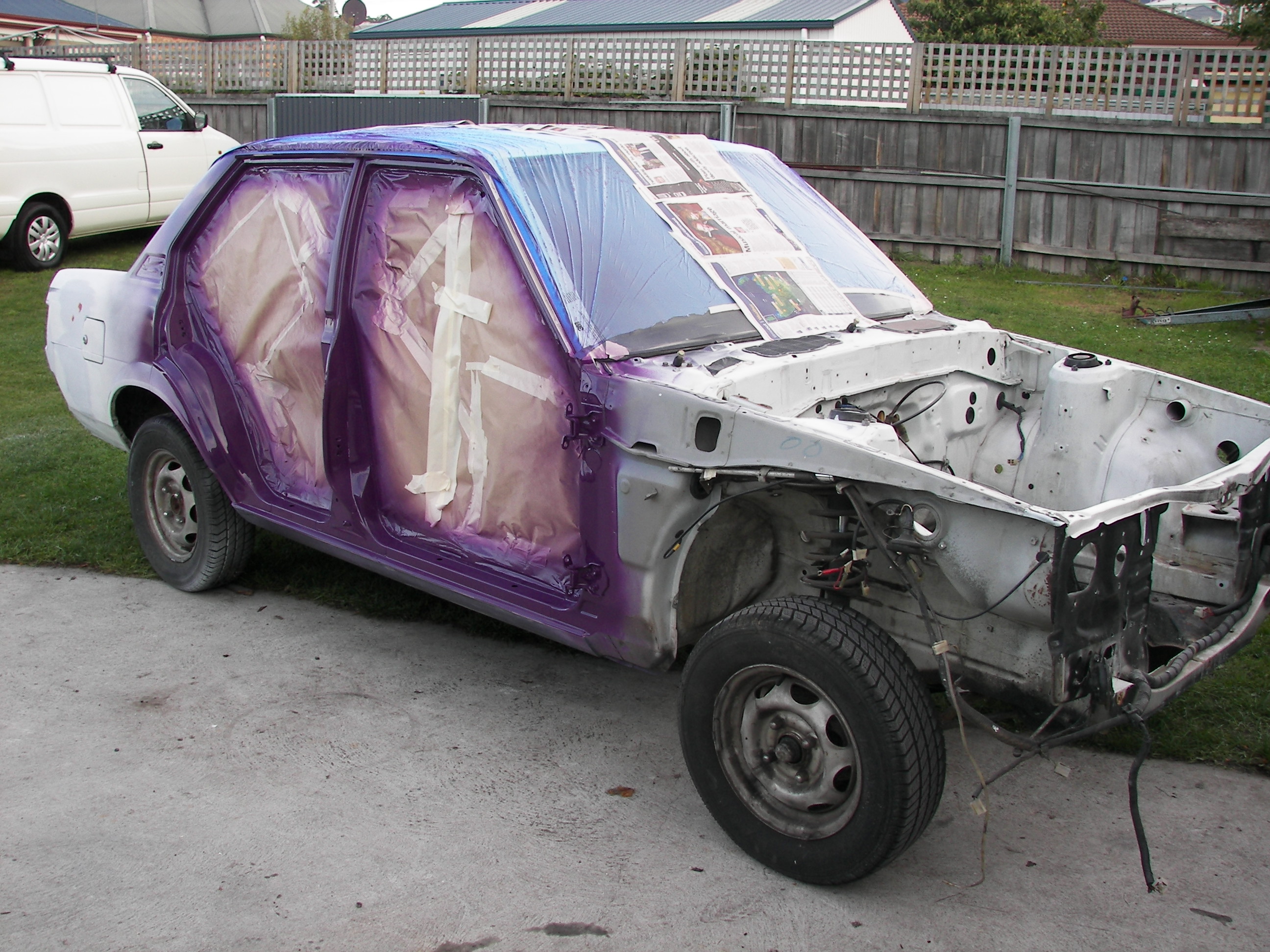

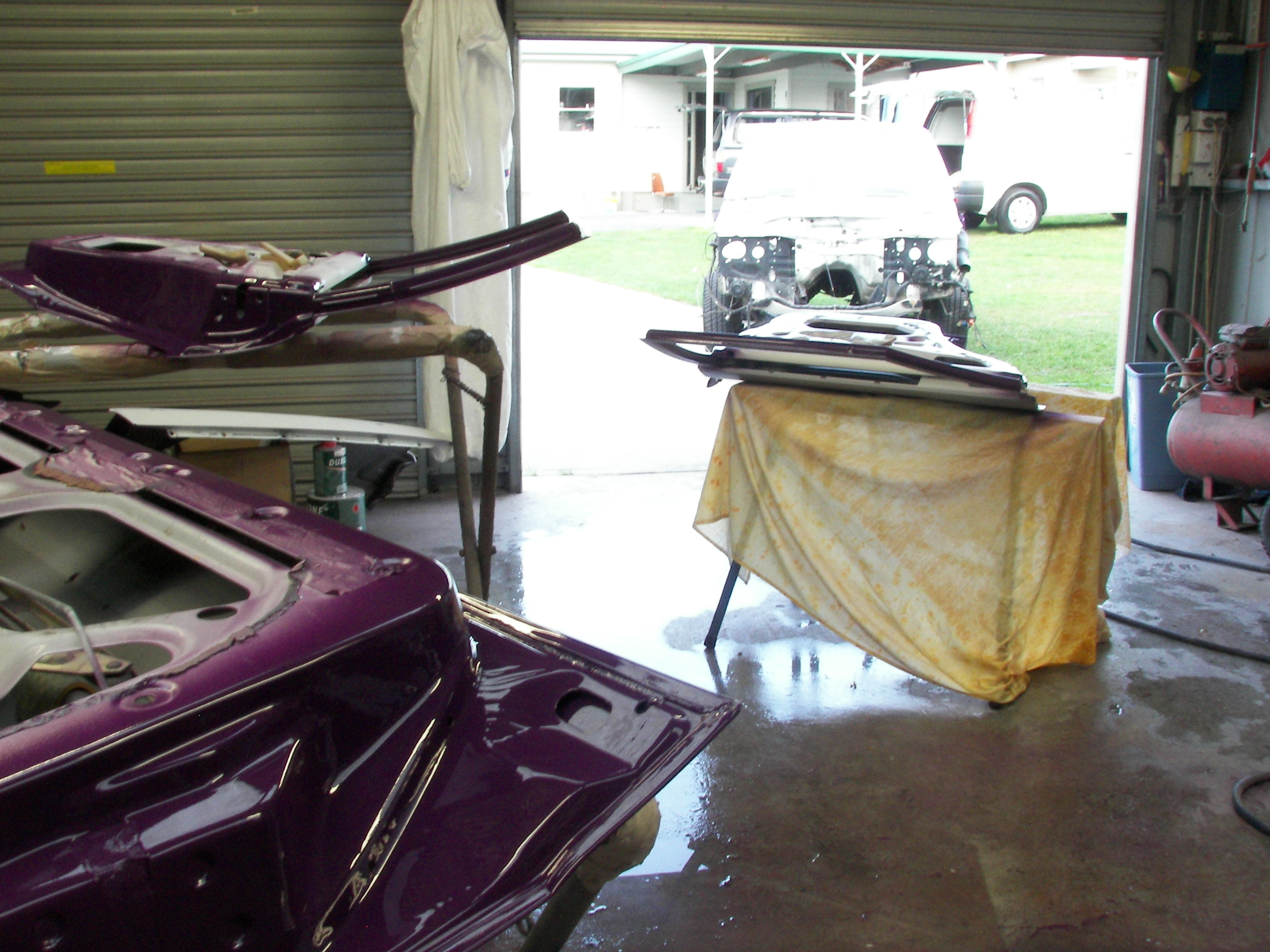

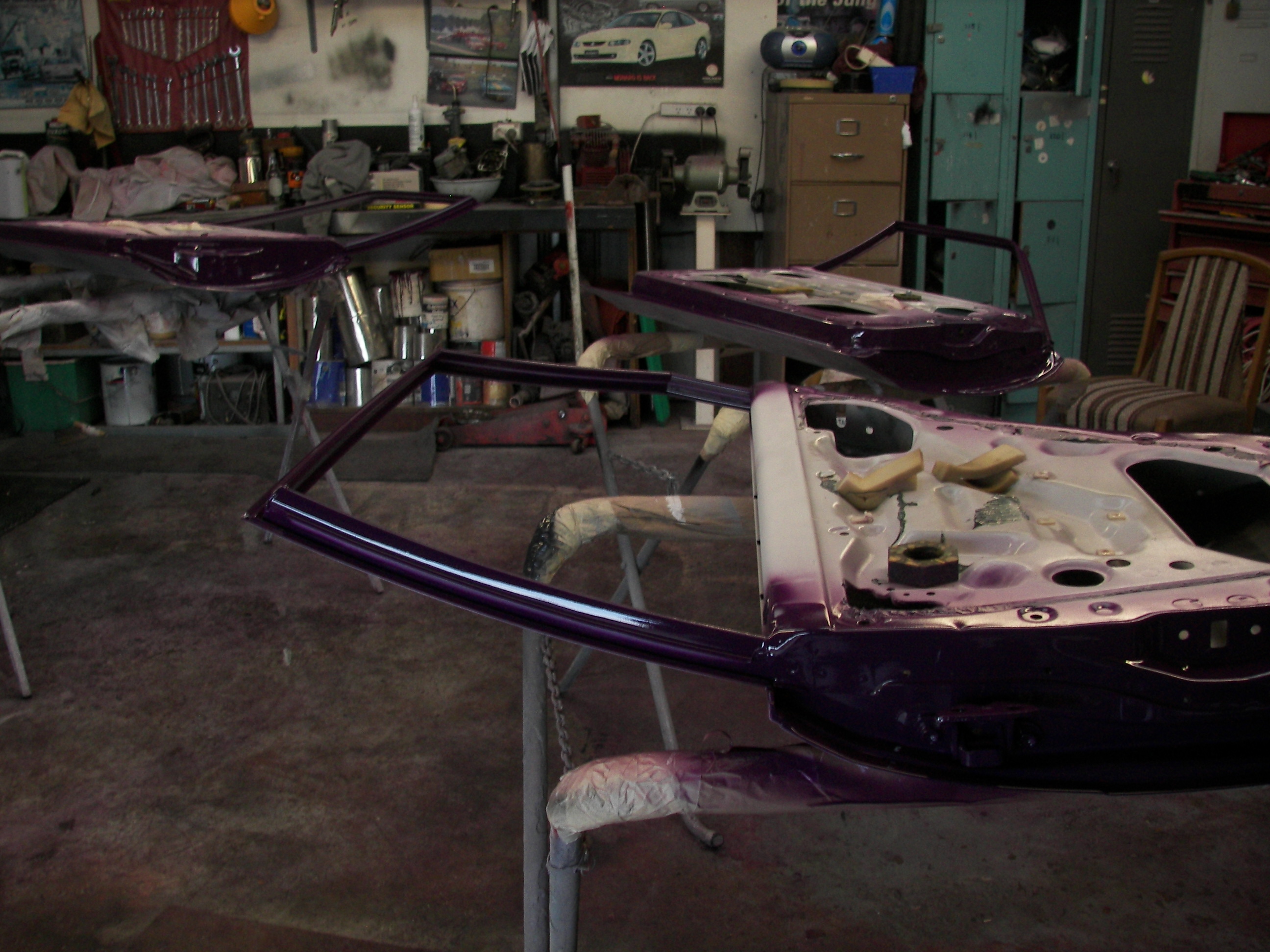

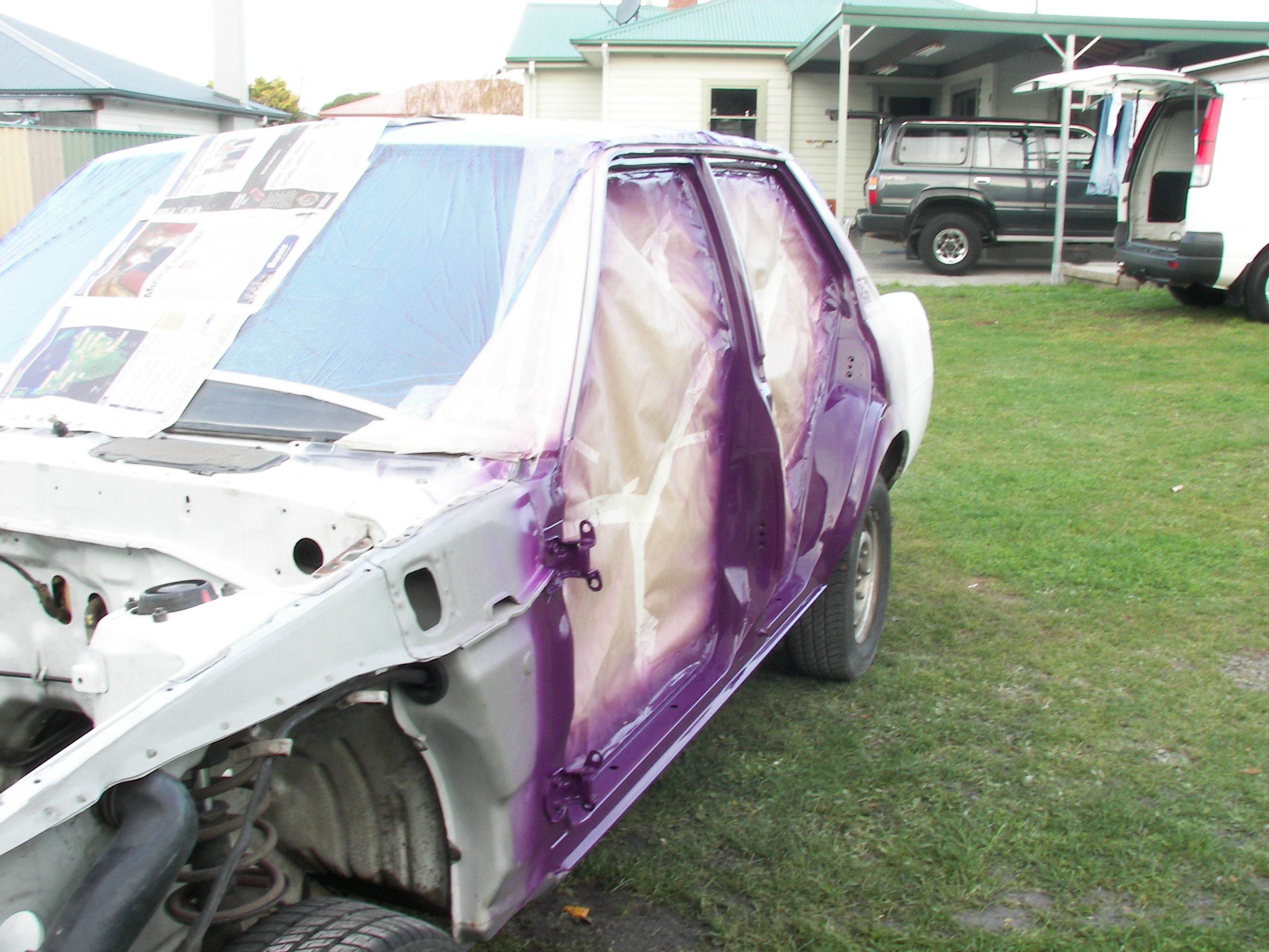

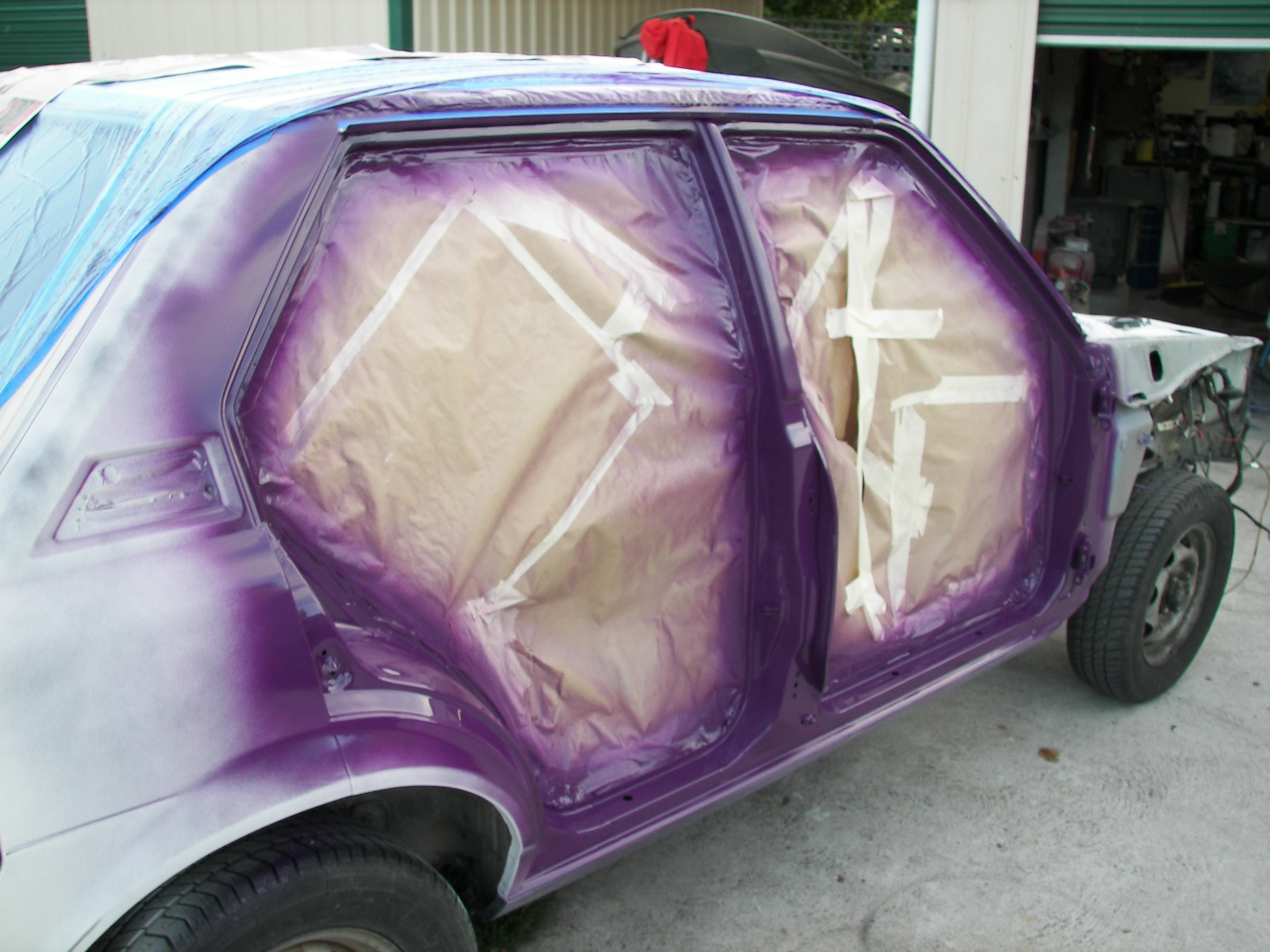

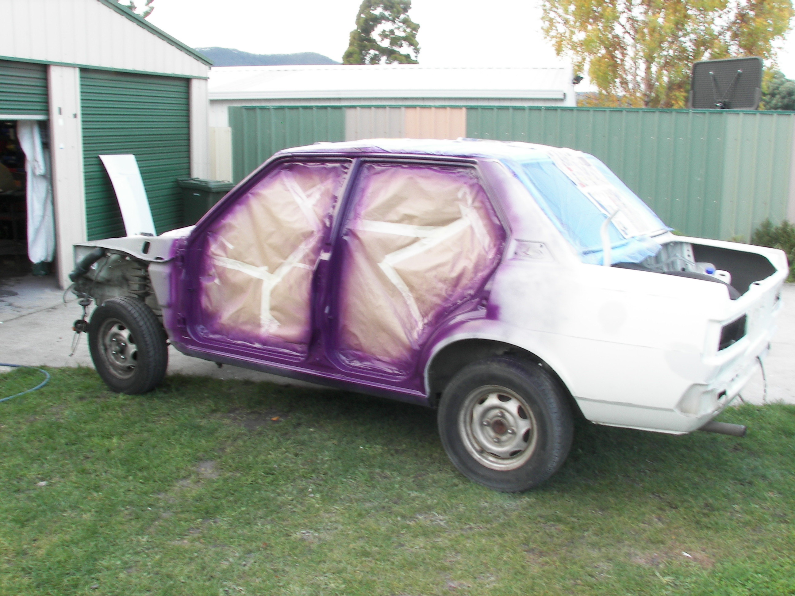

Went and got my paint mixed up the other day to the colour i wanted (matched off a model car ha) ready to lay it on the door jams and inside the doors before it goes into the oven for the paint on the body. To acheive a nice finish i made my mates shed into a makeshift oven, giving it a good sweep out then spraying water all over the floor to stop the dust from rising and got the wood heater cranking to get it pretty hot to bake the paint on. the result was perfect :wink:

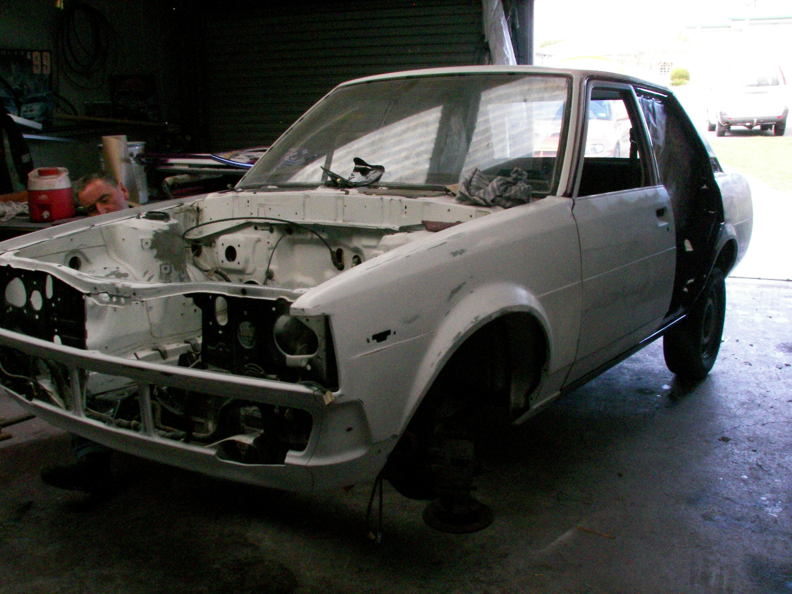

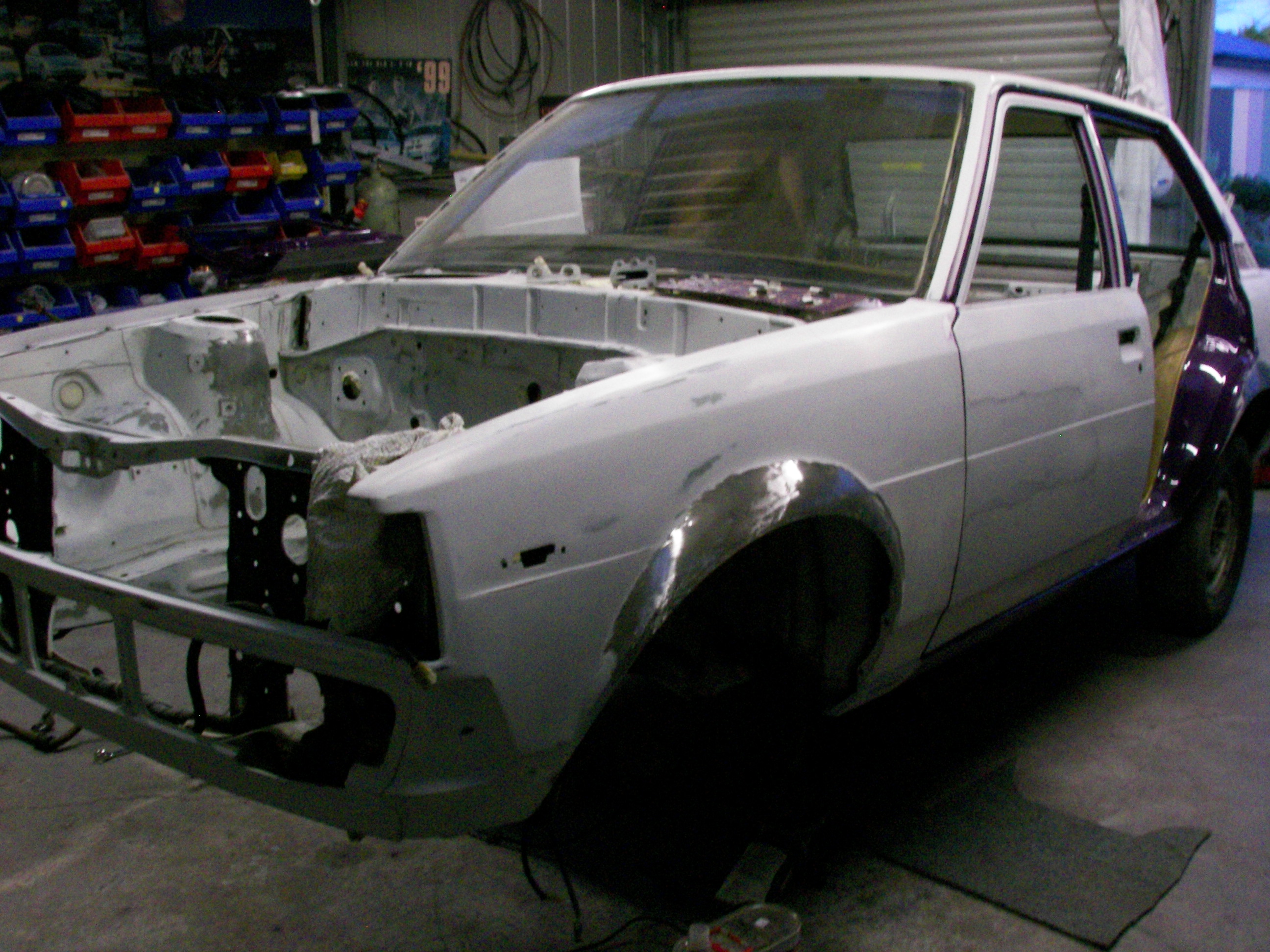

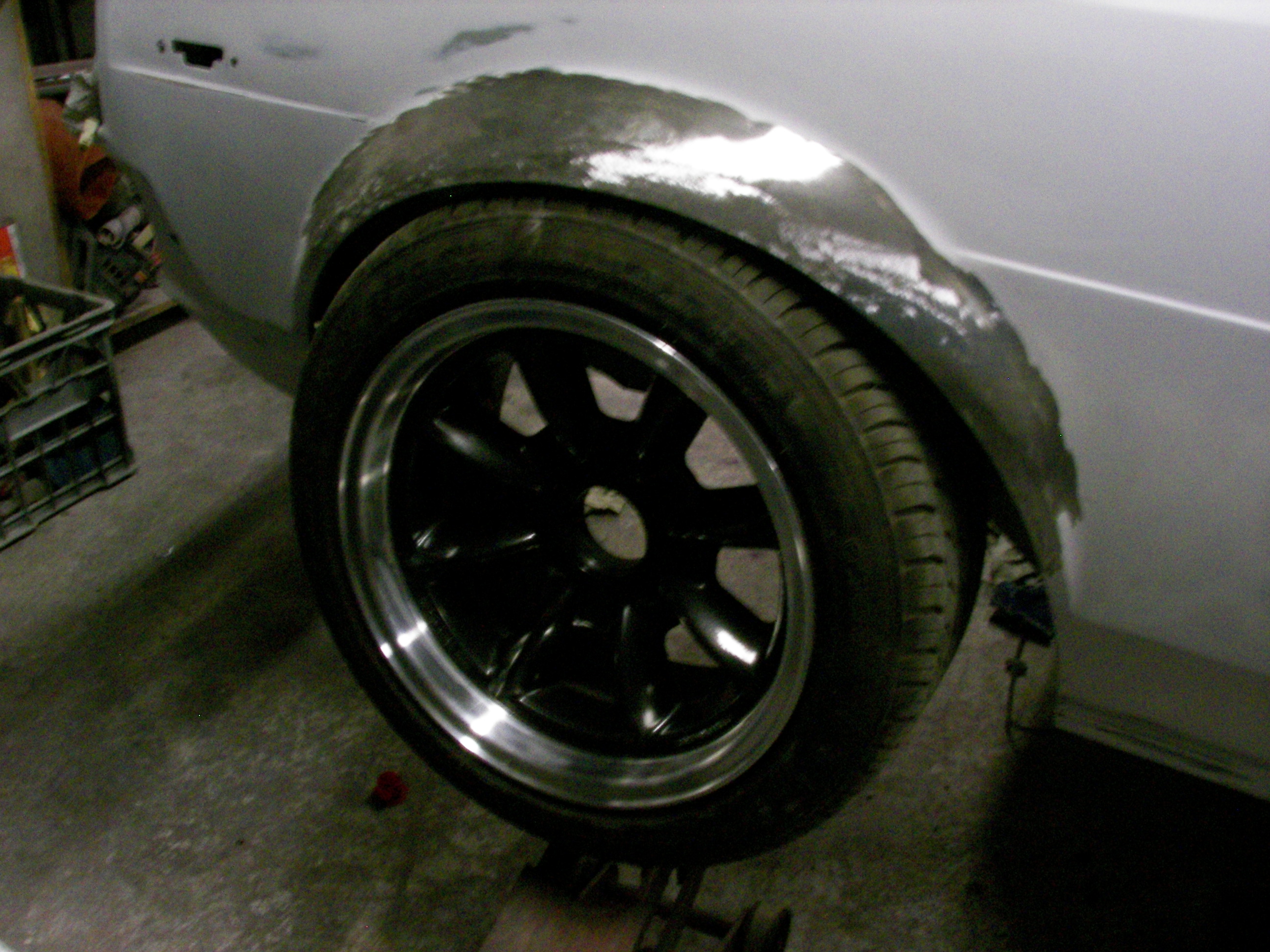

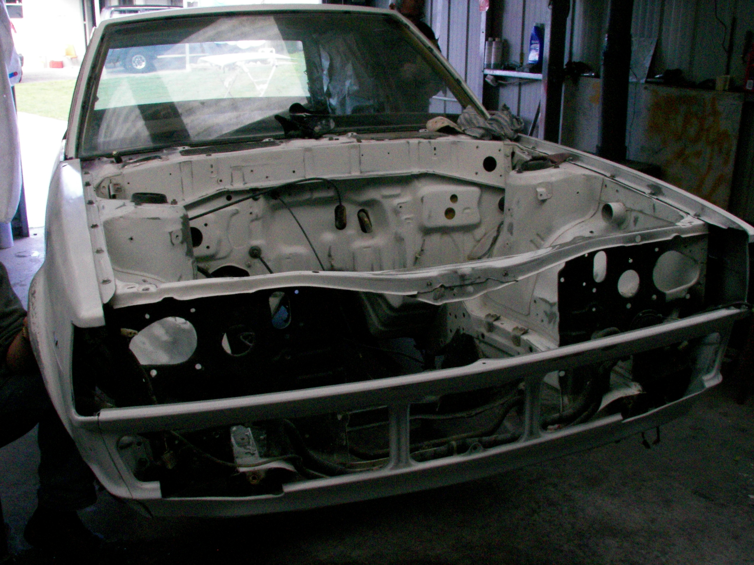

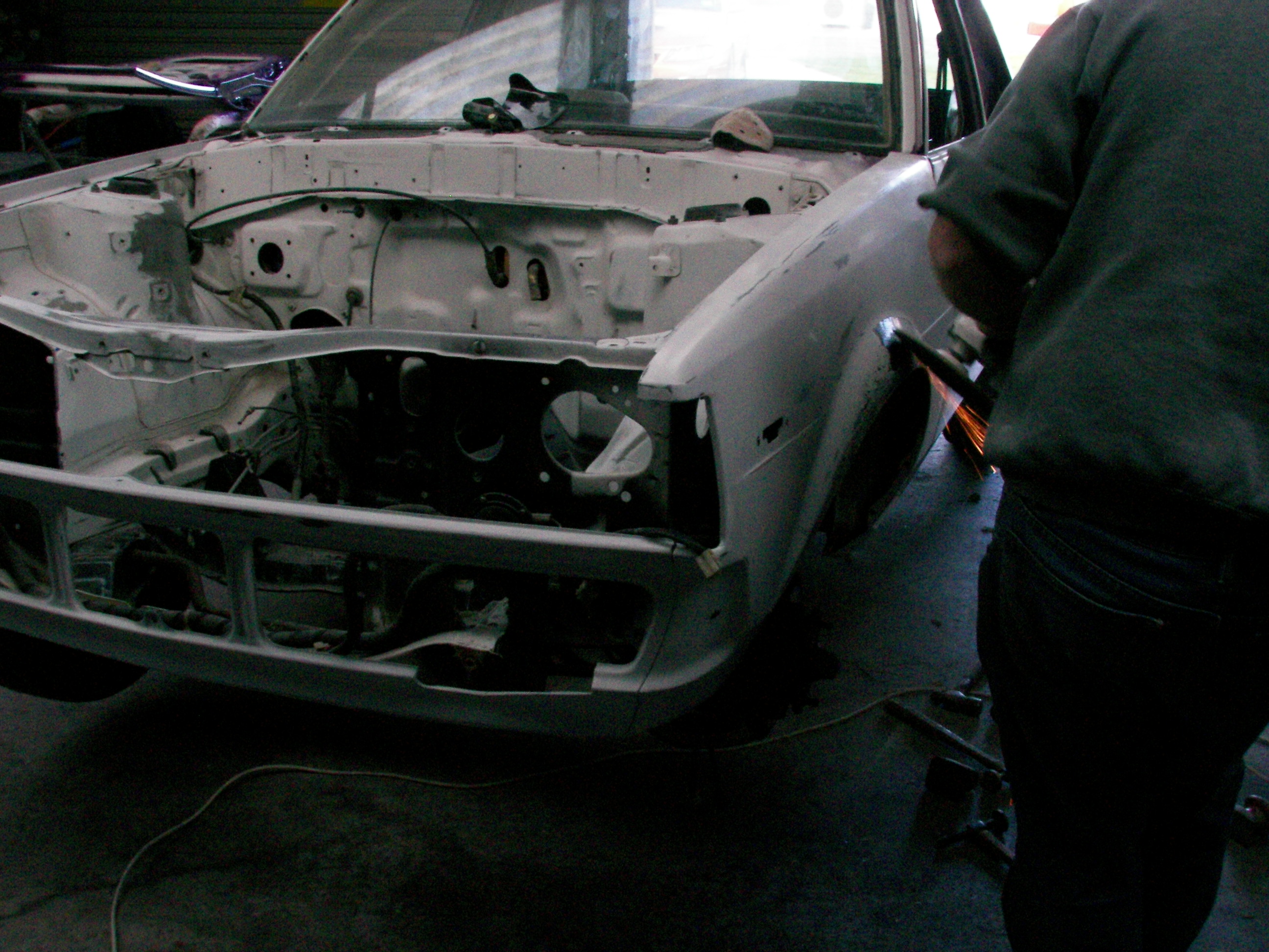

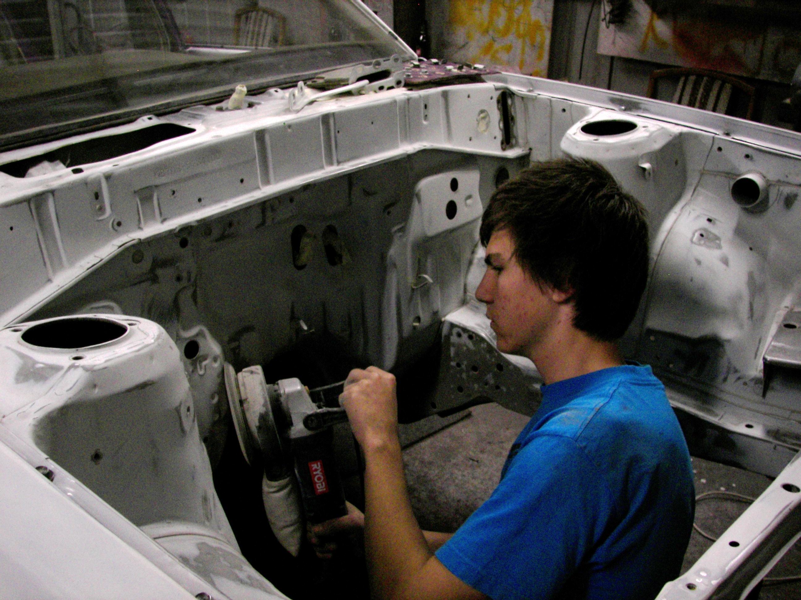

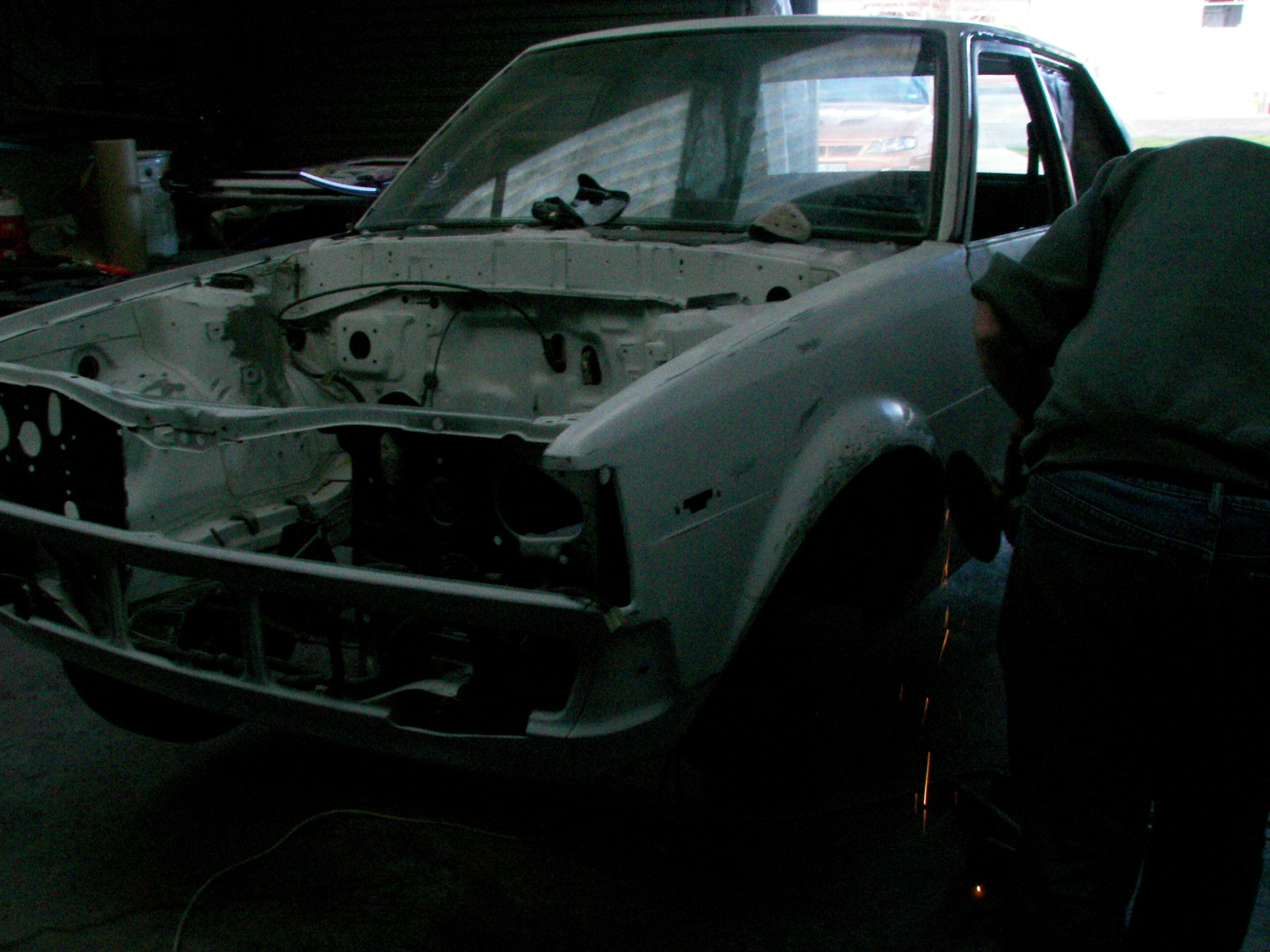

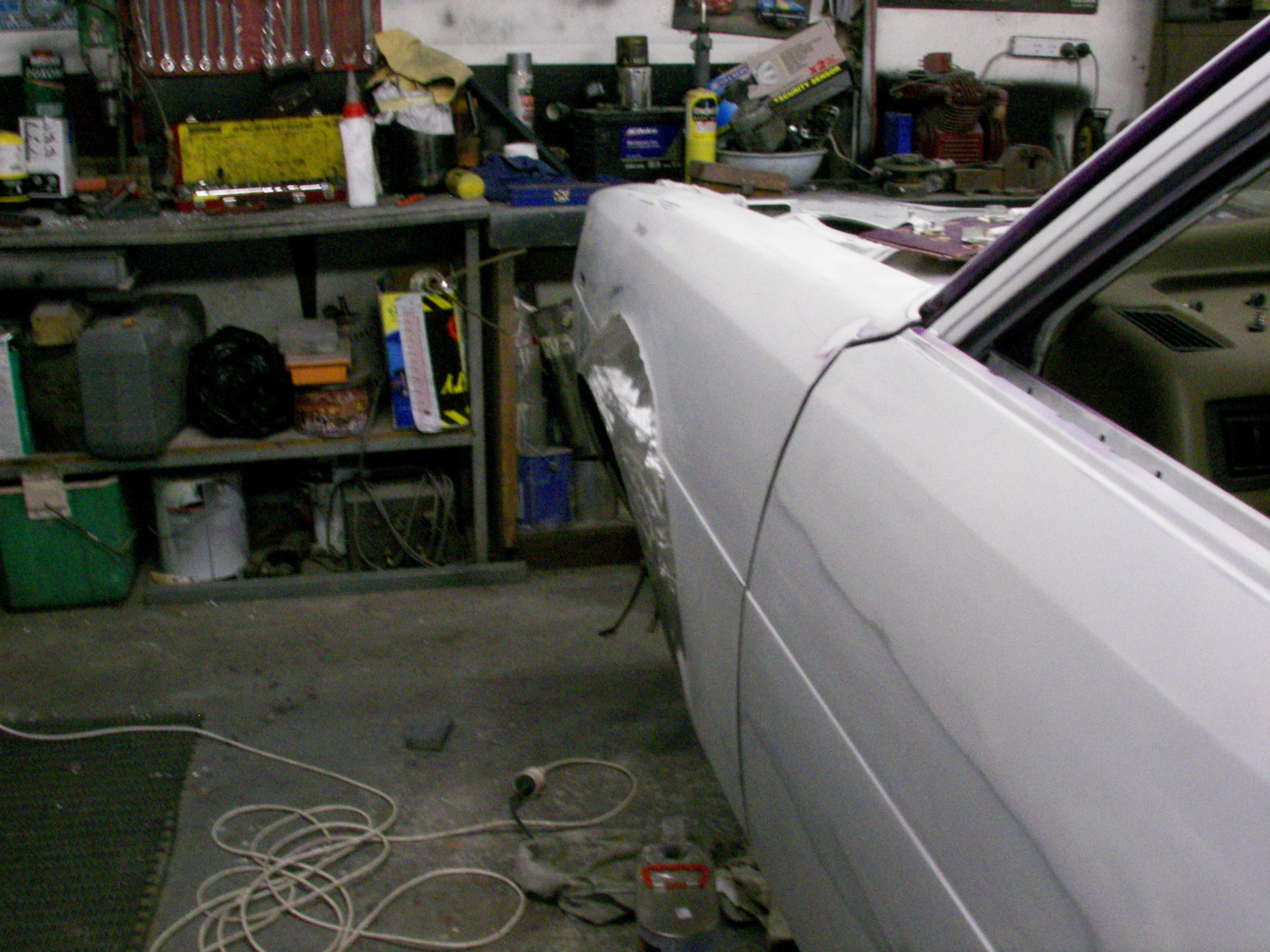

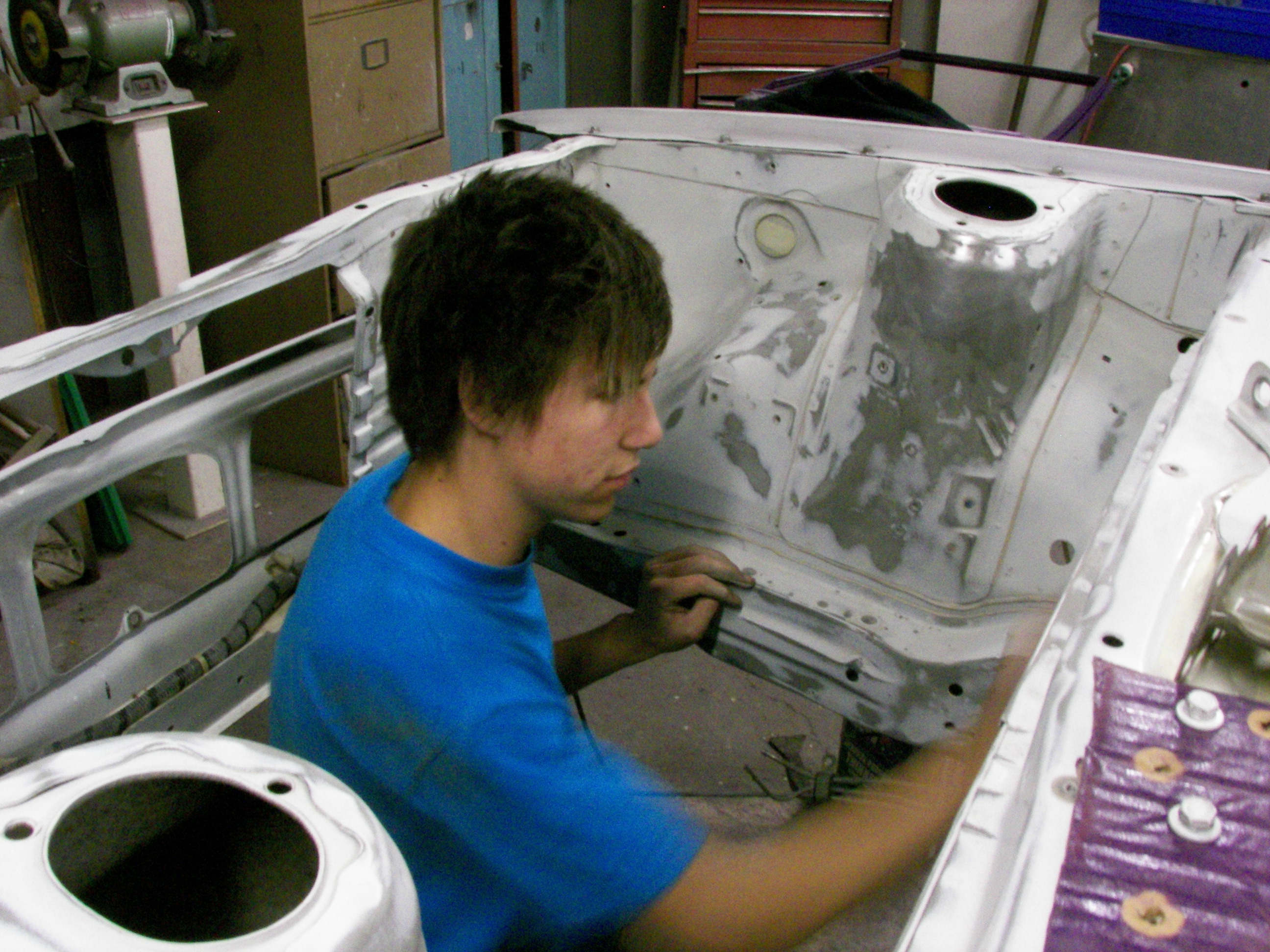

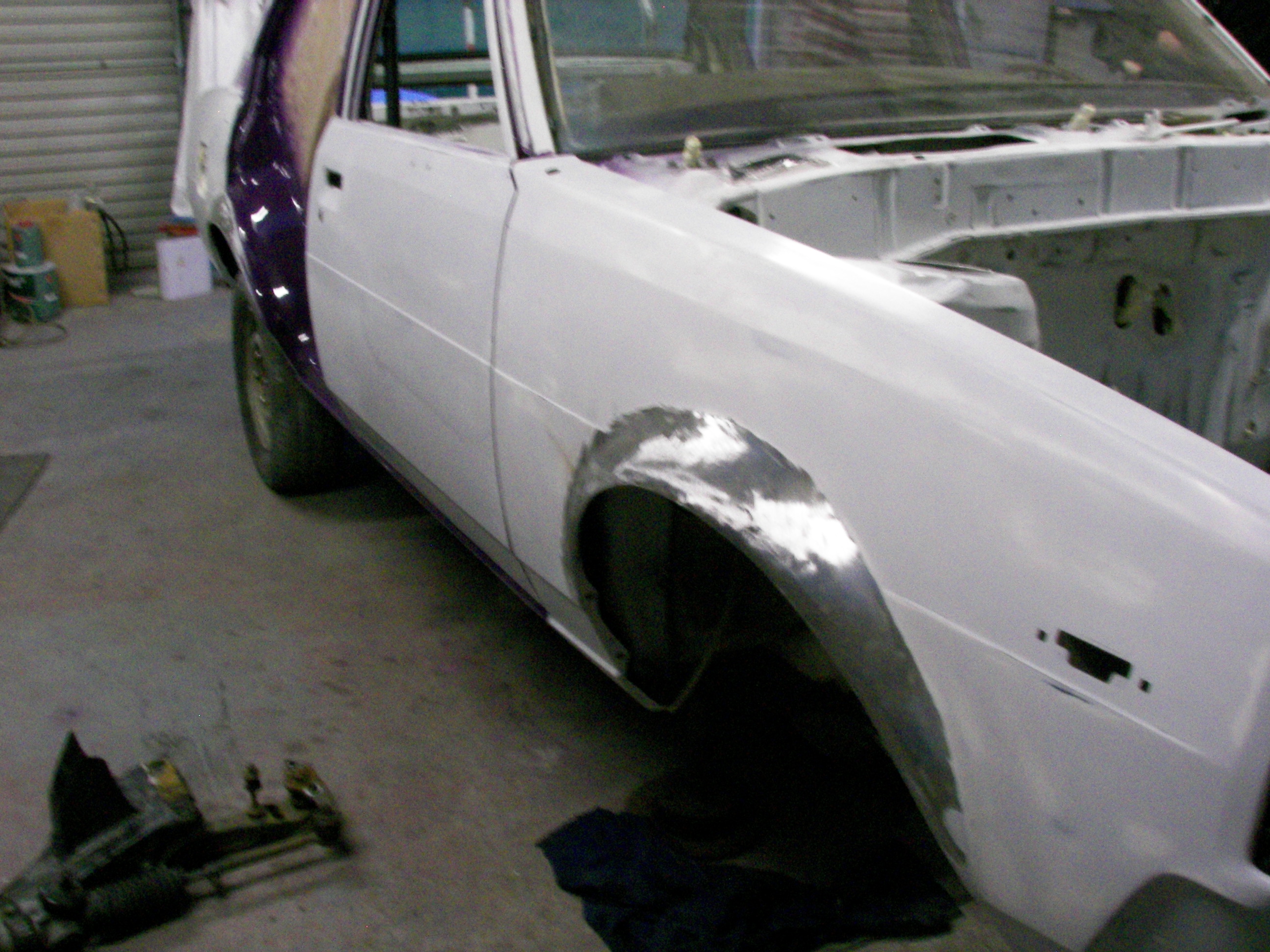

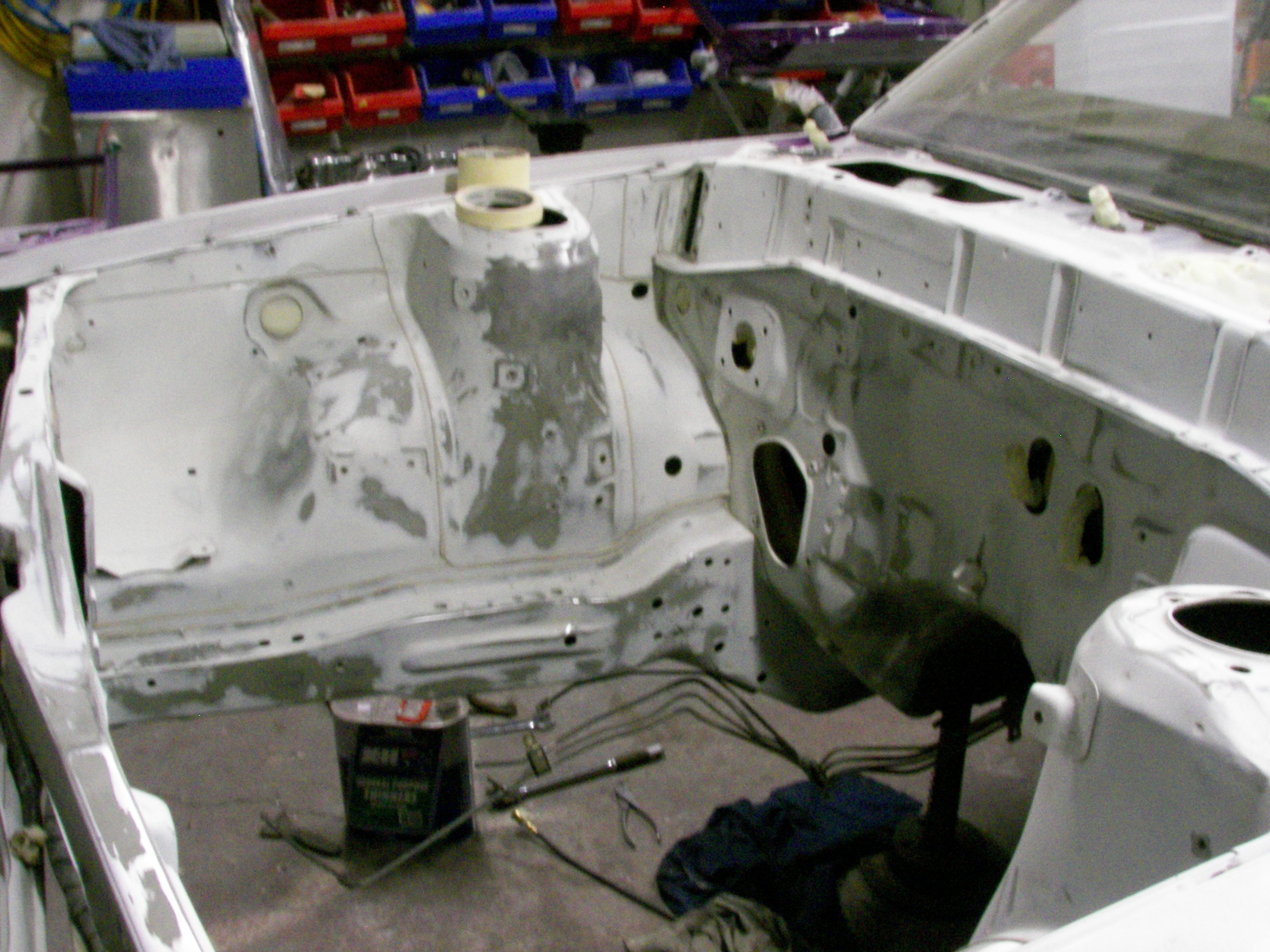

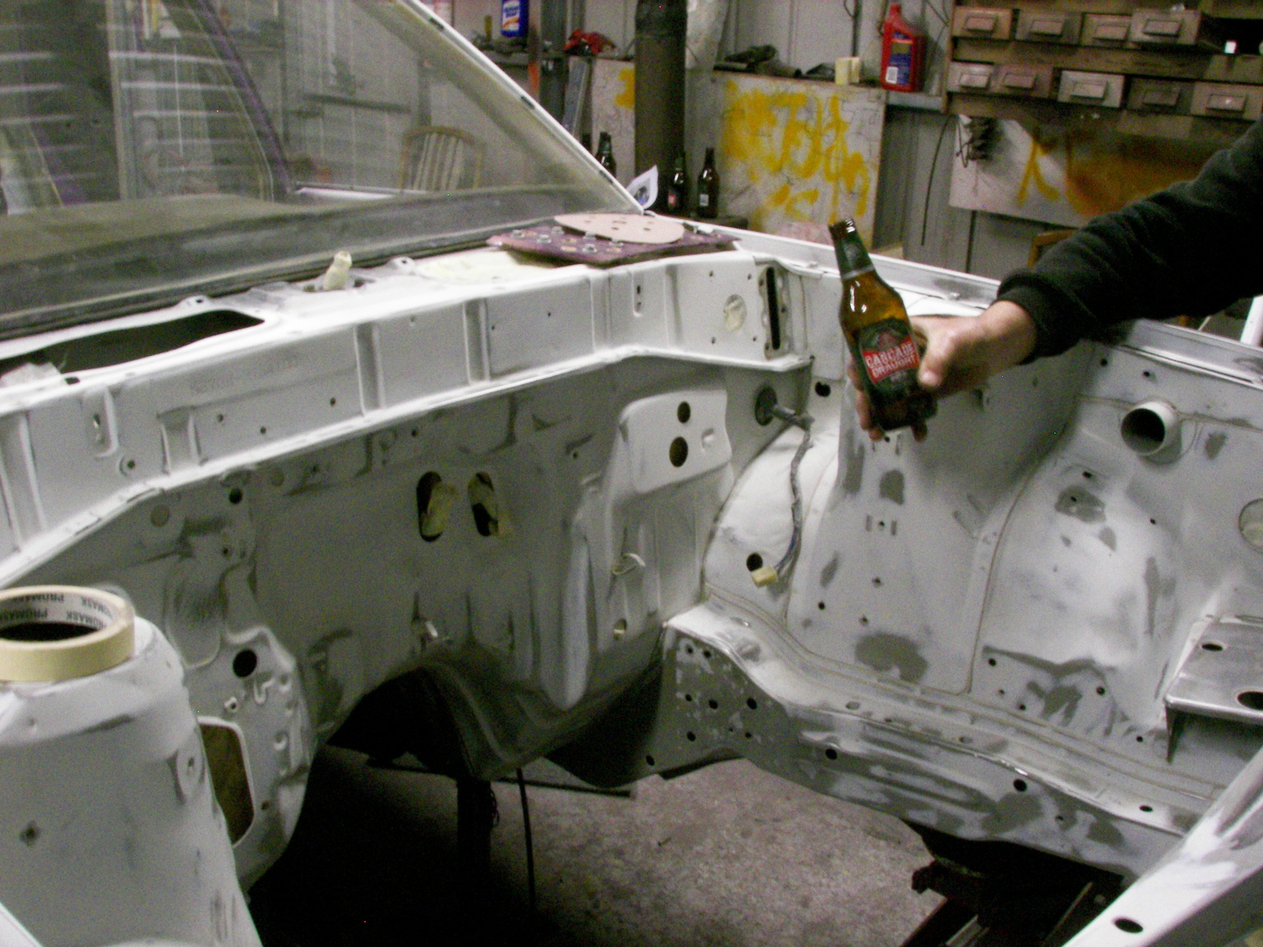

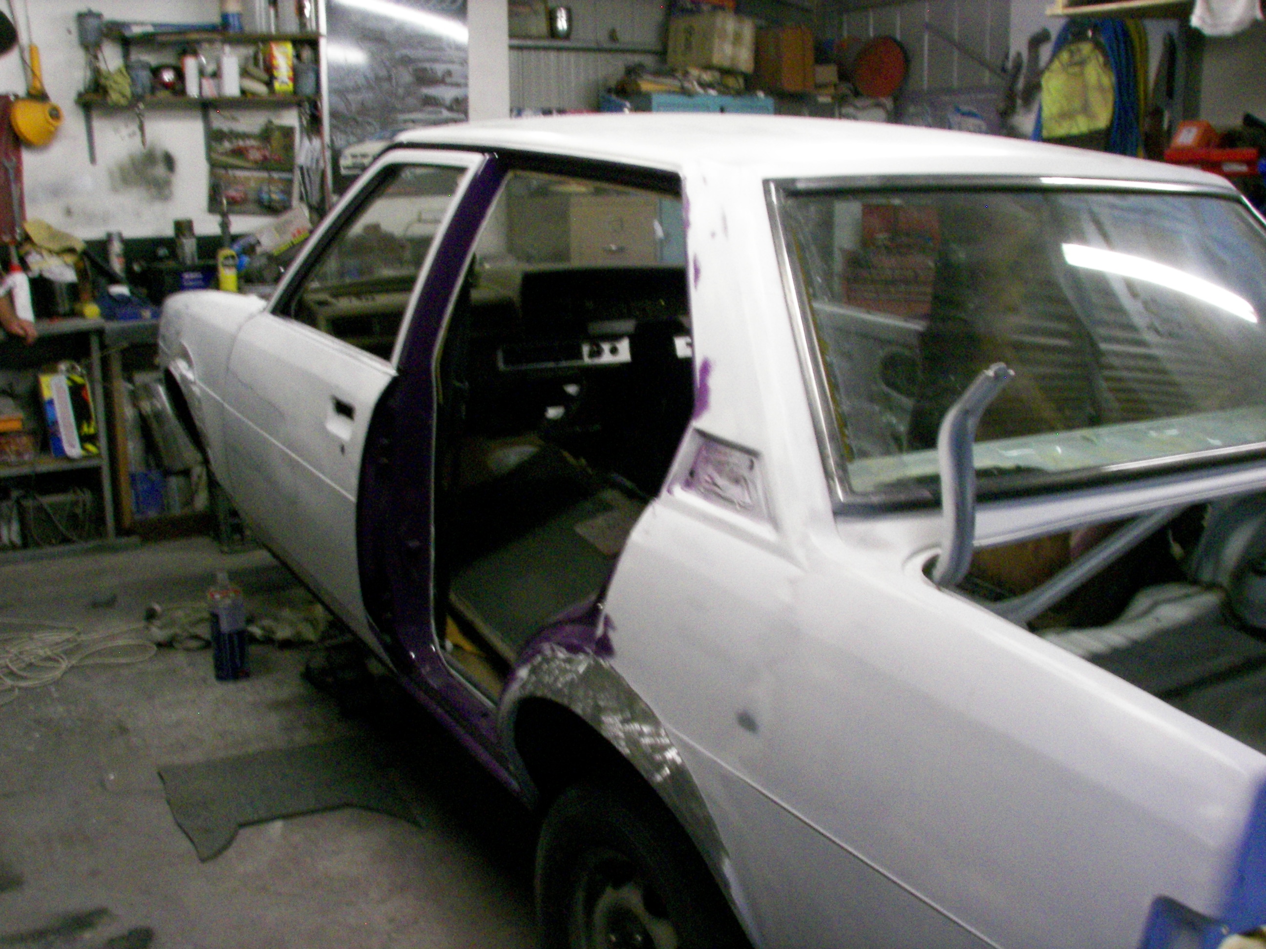

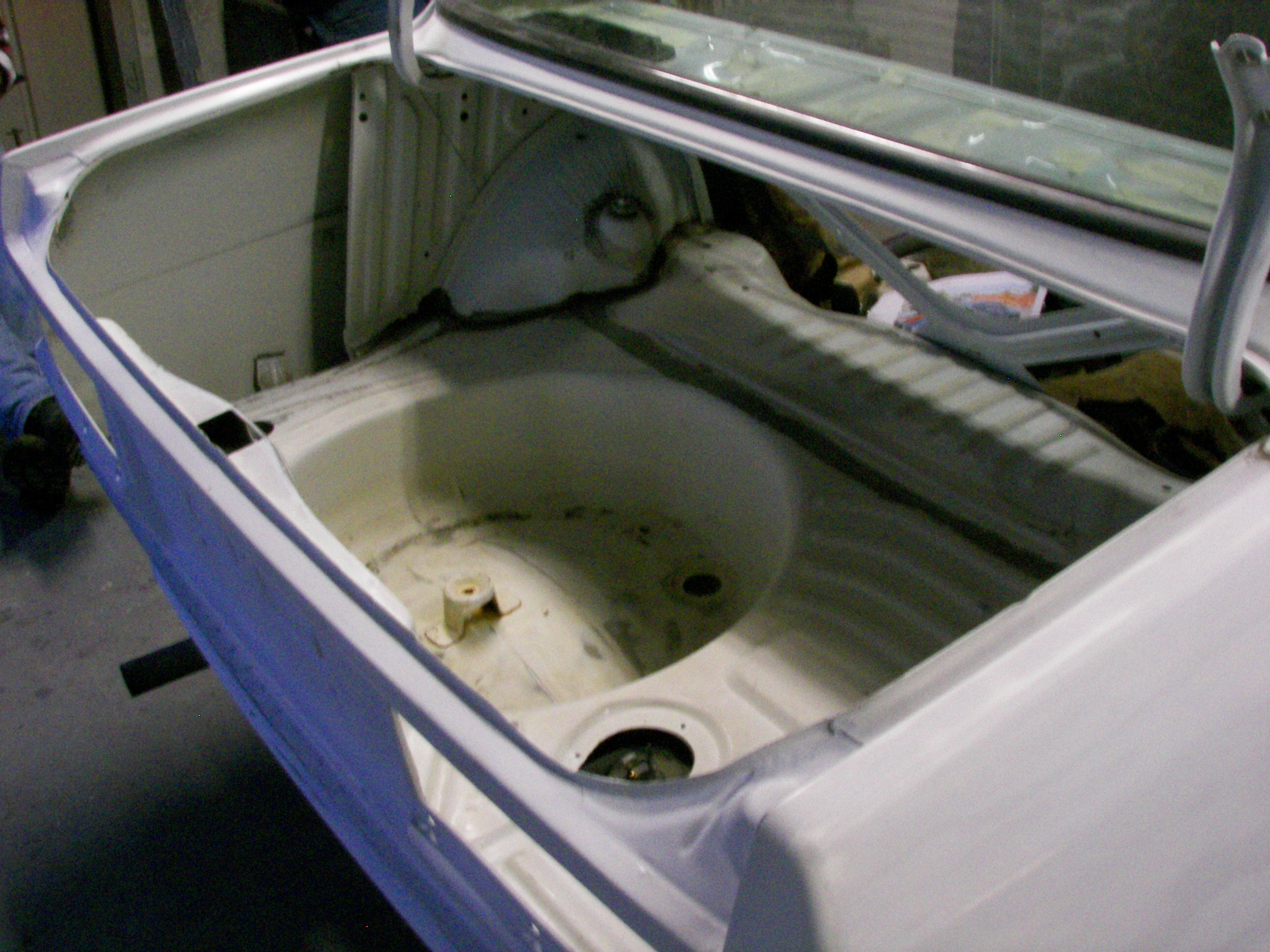

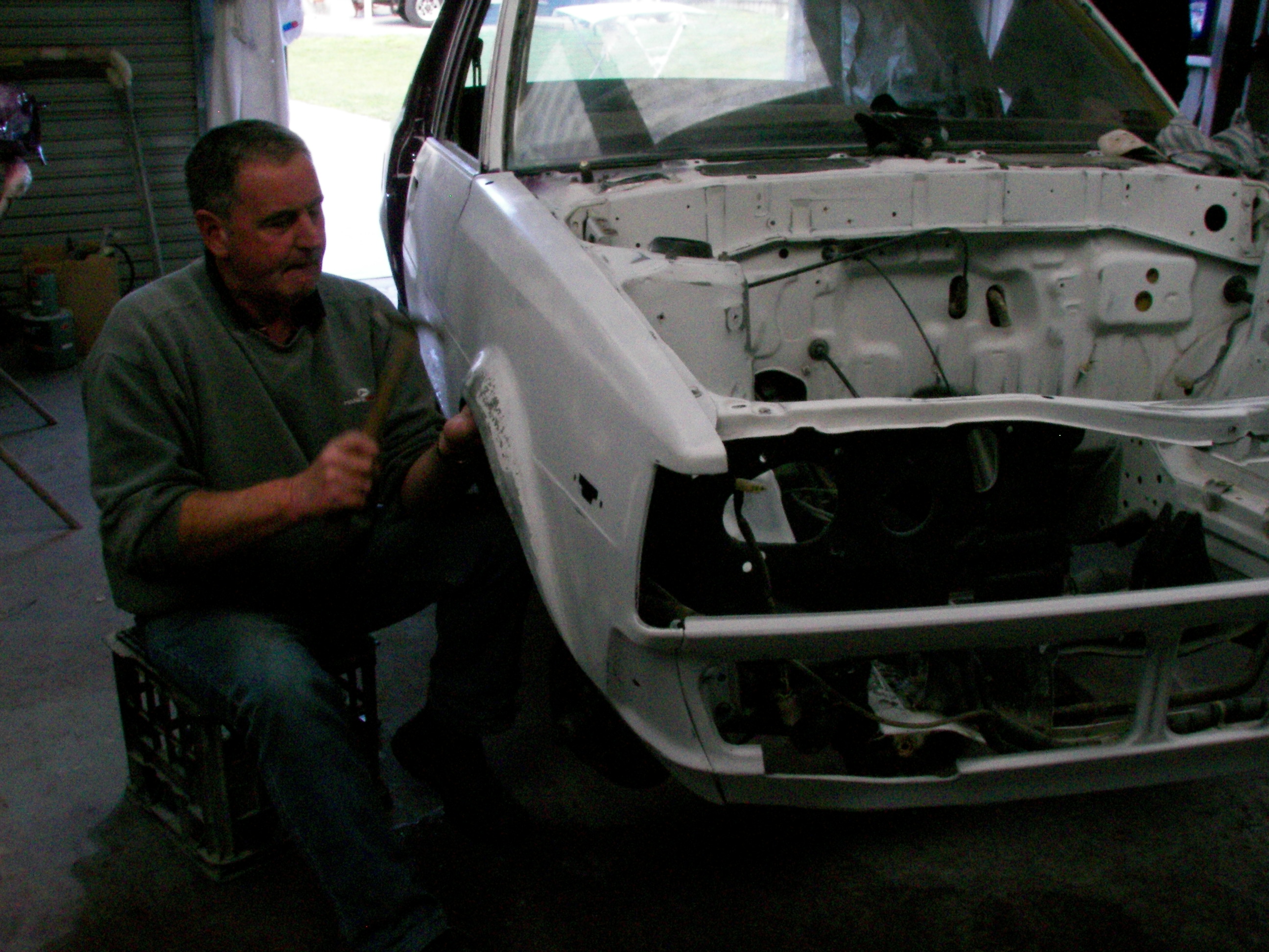

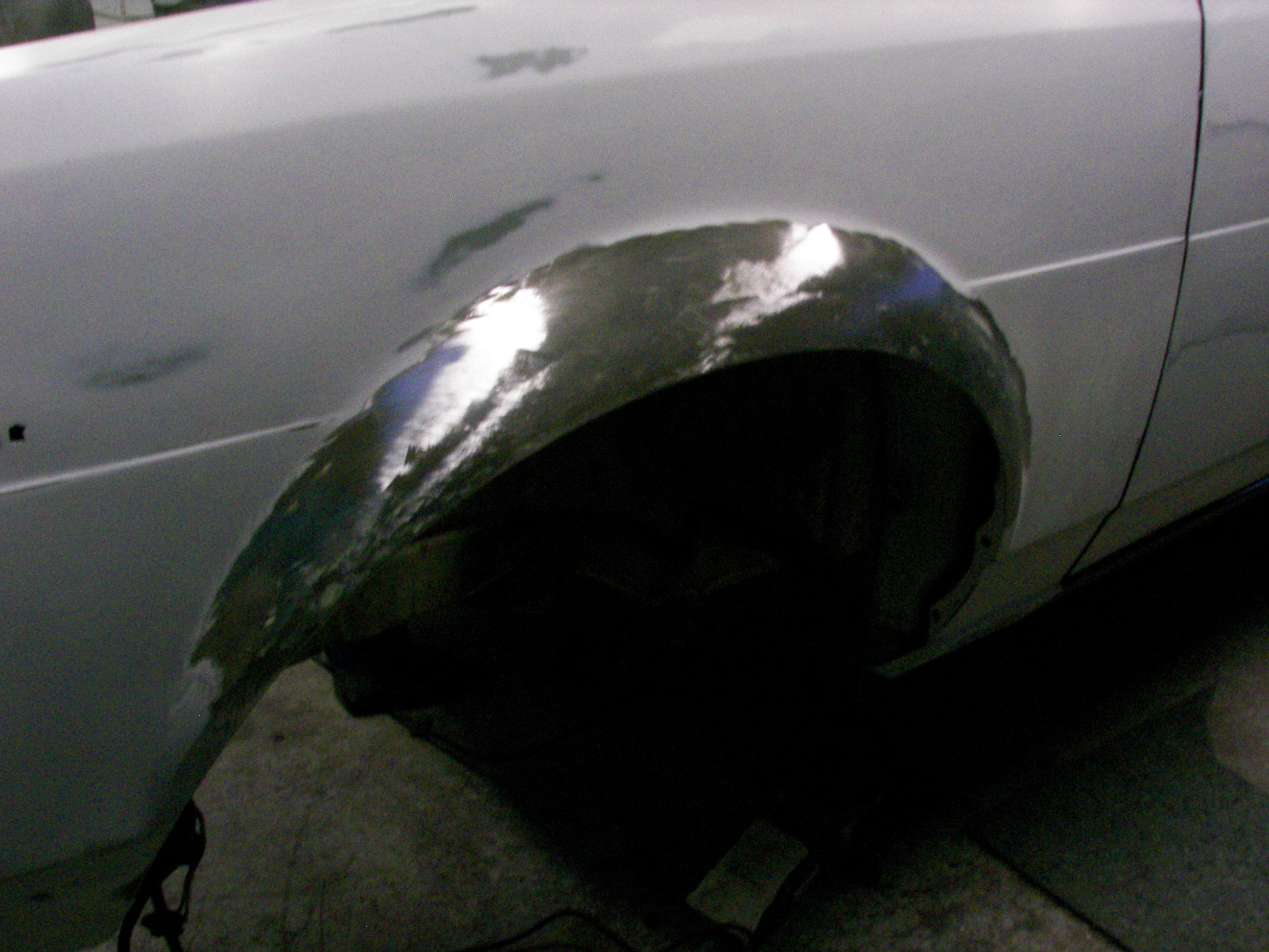

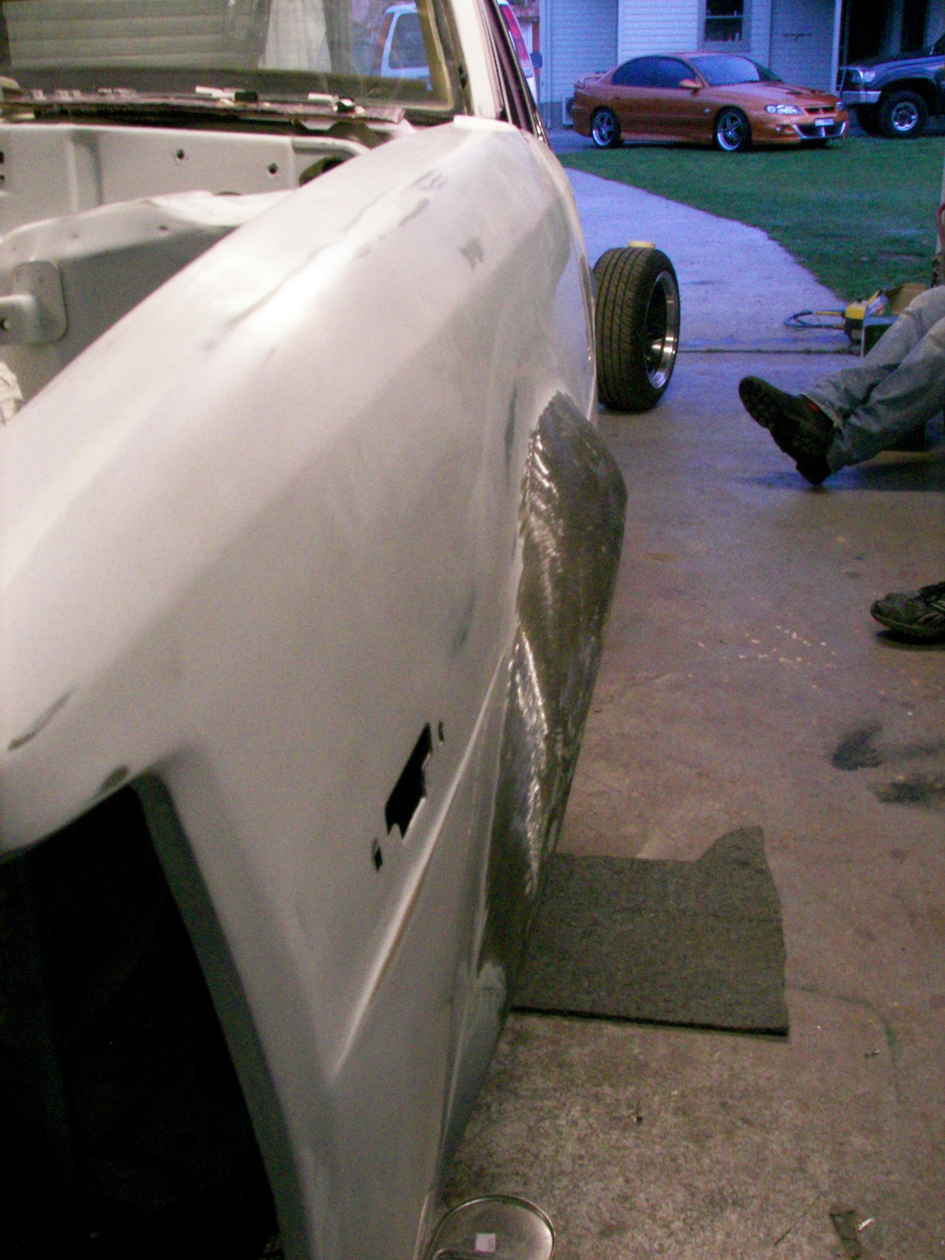

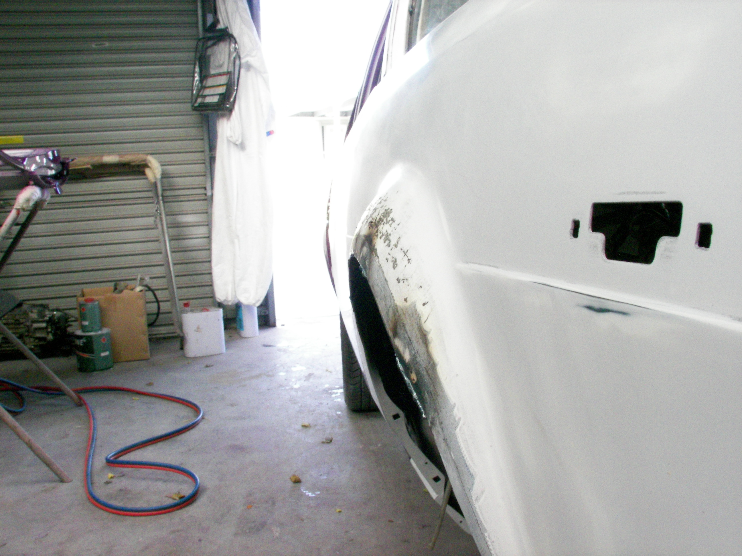

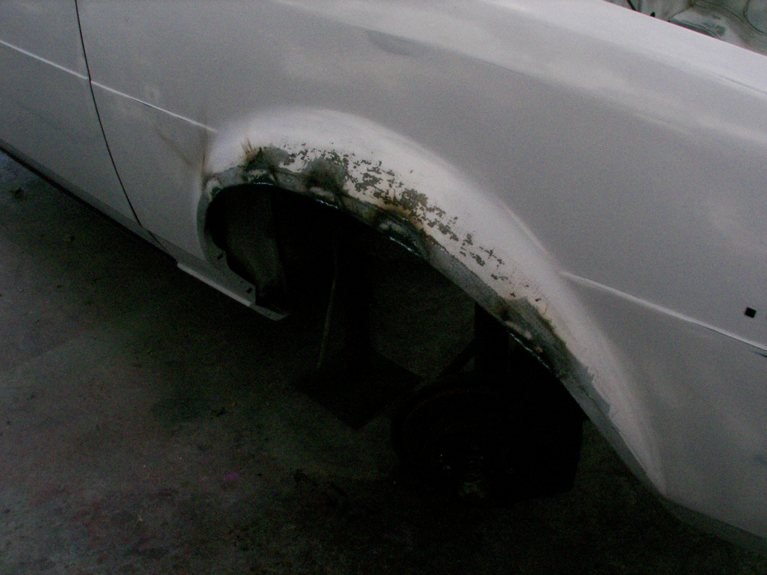

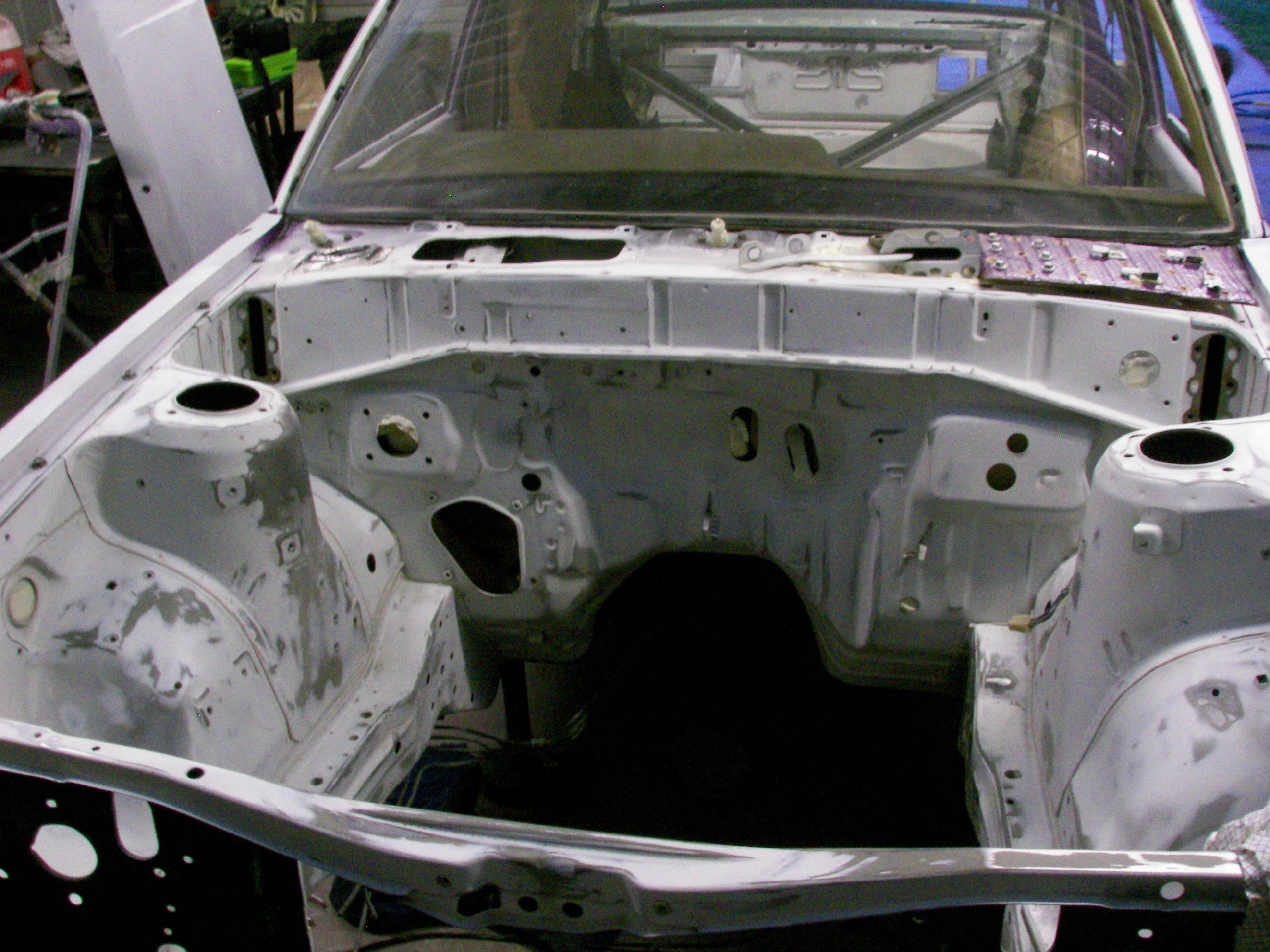

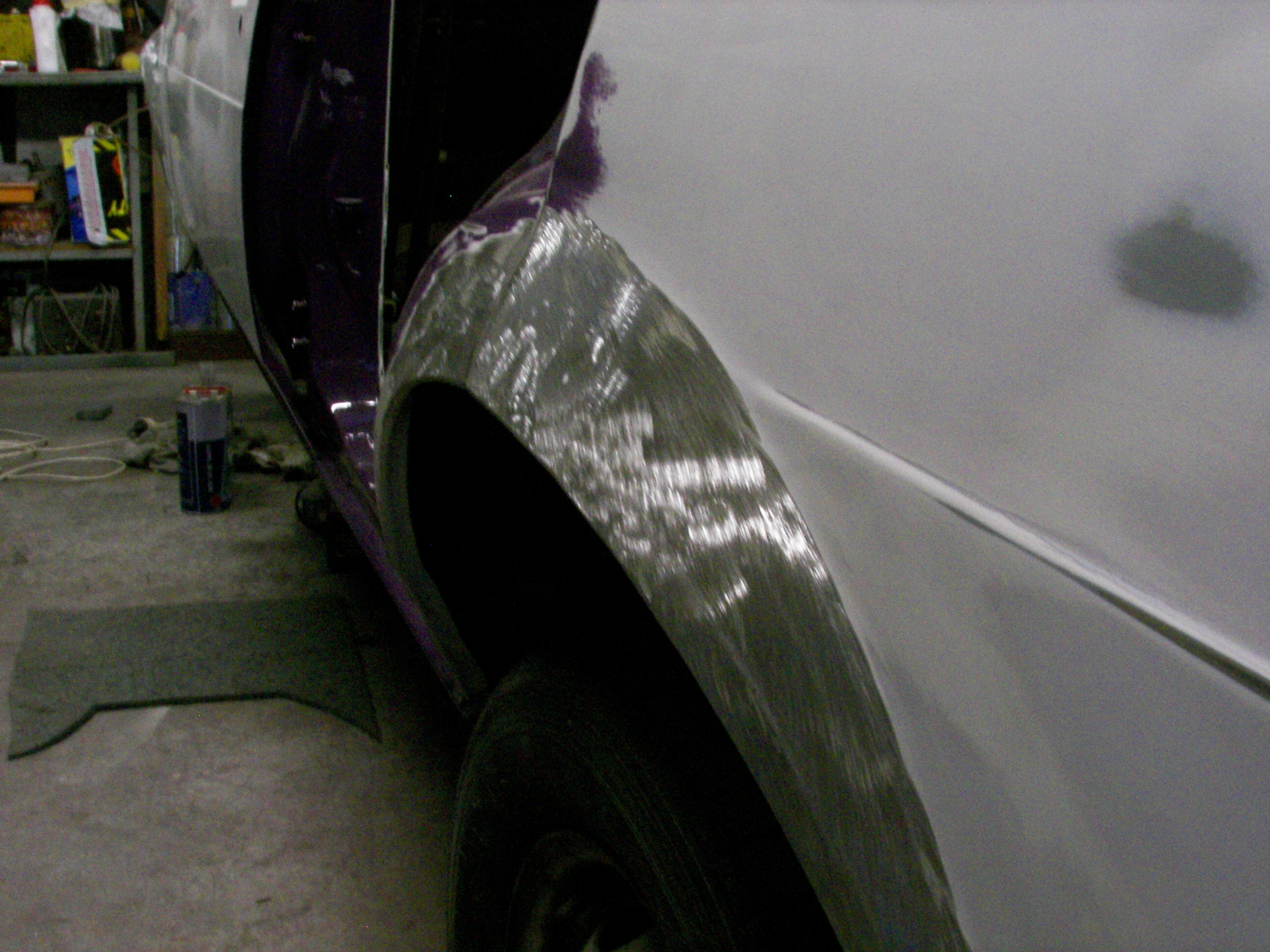

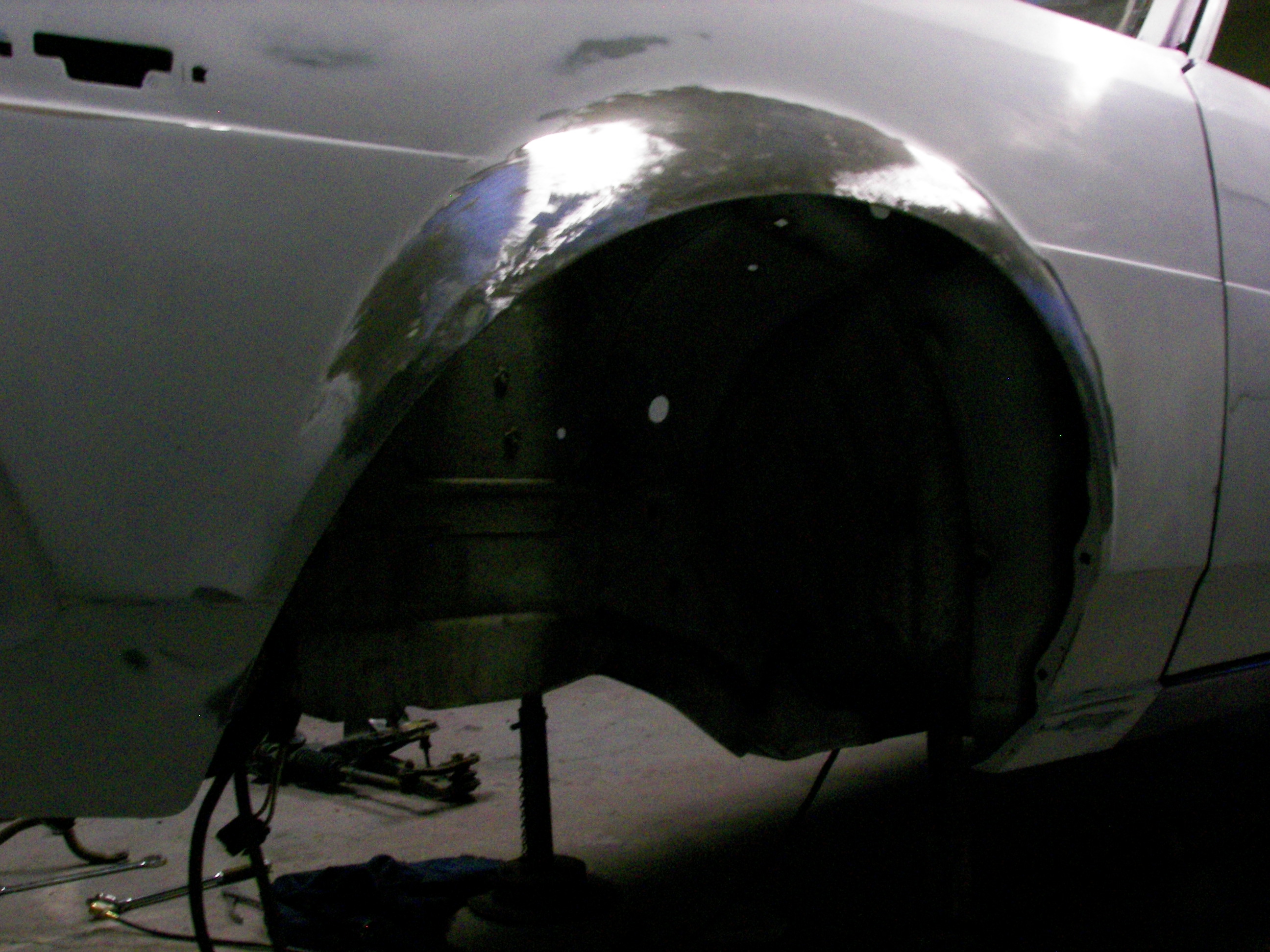

Dads mate who is a panel beater come around this weekend to flair the guards. All that has been done was the lip was folded up under the guard the the square edge has been folded out with the original guard shape and curved/shaped. They have now got a nice bubble on them :yes: the bits that have been welded in are where it was a bit shallow, so he filled it in with oxey welding and then ground around them ready for boging. engine bay is now also all sanded and ready for a coat of primer.

  On 5/17/2011 at 11:04 PM, dpb said:
looking good mate i wana do the same flaring with mine is it hard 2 do?
Thanks man, well it doesnt look that hard to do if you have the right tools but i wouldnt like to try it. The panel beater who did mine made it look easy, he only took about 2 hours to do all 4 guards. The rear ones you can't realy do much to because they are double panneled unless you cut a bit of the inner guard out, tap it to the shape you want then and reweld another bit back into it wich would take for ever, so i just got him to tap the square edge out, get rid of the line and put a nice curve on them instead of coming streight out. He tapped the back ones out to the same shape as the front ones but smaller because if you have a look the rear flair is smaller than the front ones to start with, but still looks sweet. The main thing is that you find someone who realy knows what they are doing with them other wise it could turn to shit real quick. :wink:
Its not really too hard, I did mine with a builders hammer and a block of wood. Turned out overrated, you just gotta take your time.

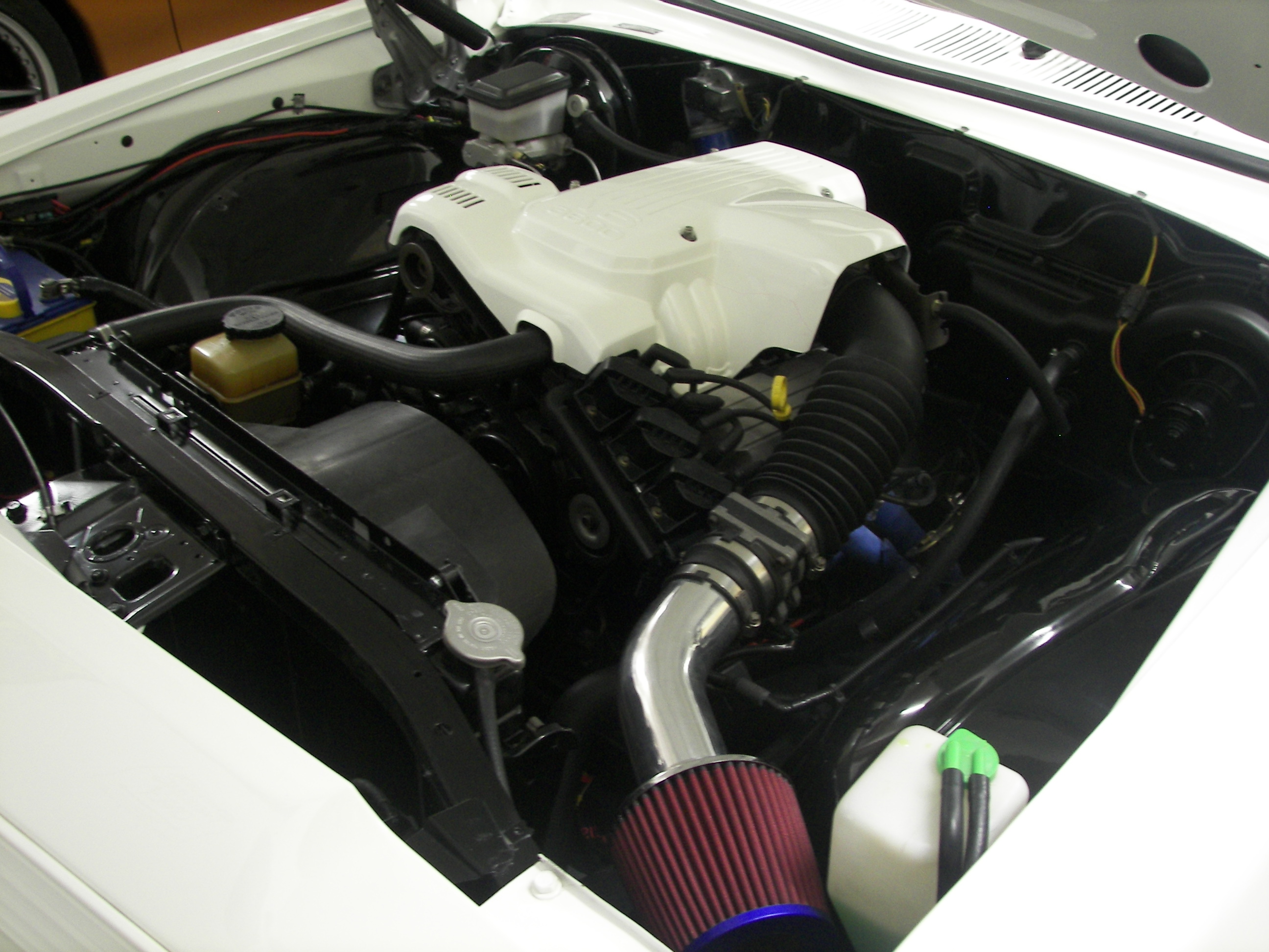

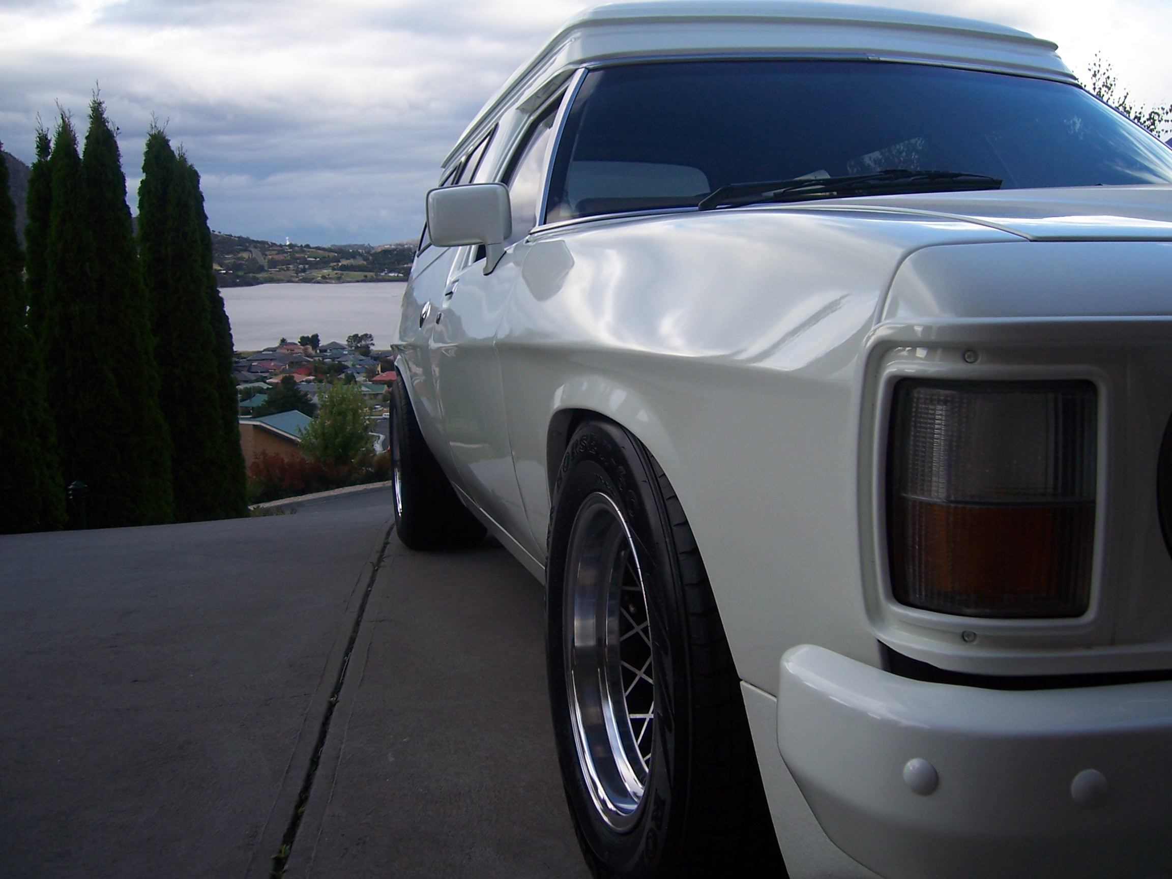

But for the hell of it ile show you what the old mans come up like, hopefuly mine will come up as good :yes:

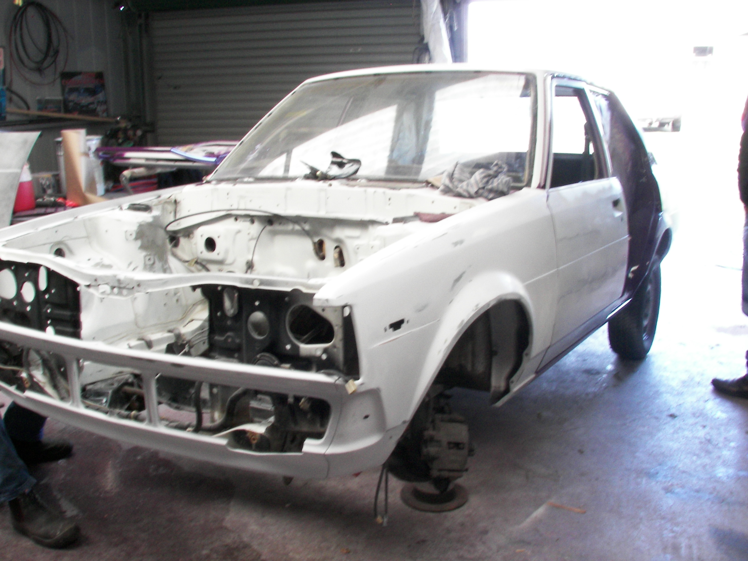

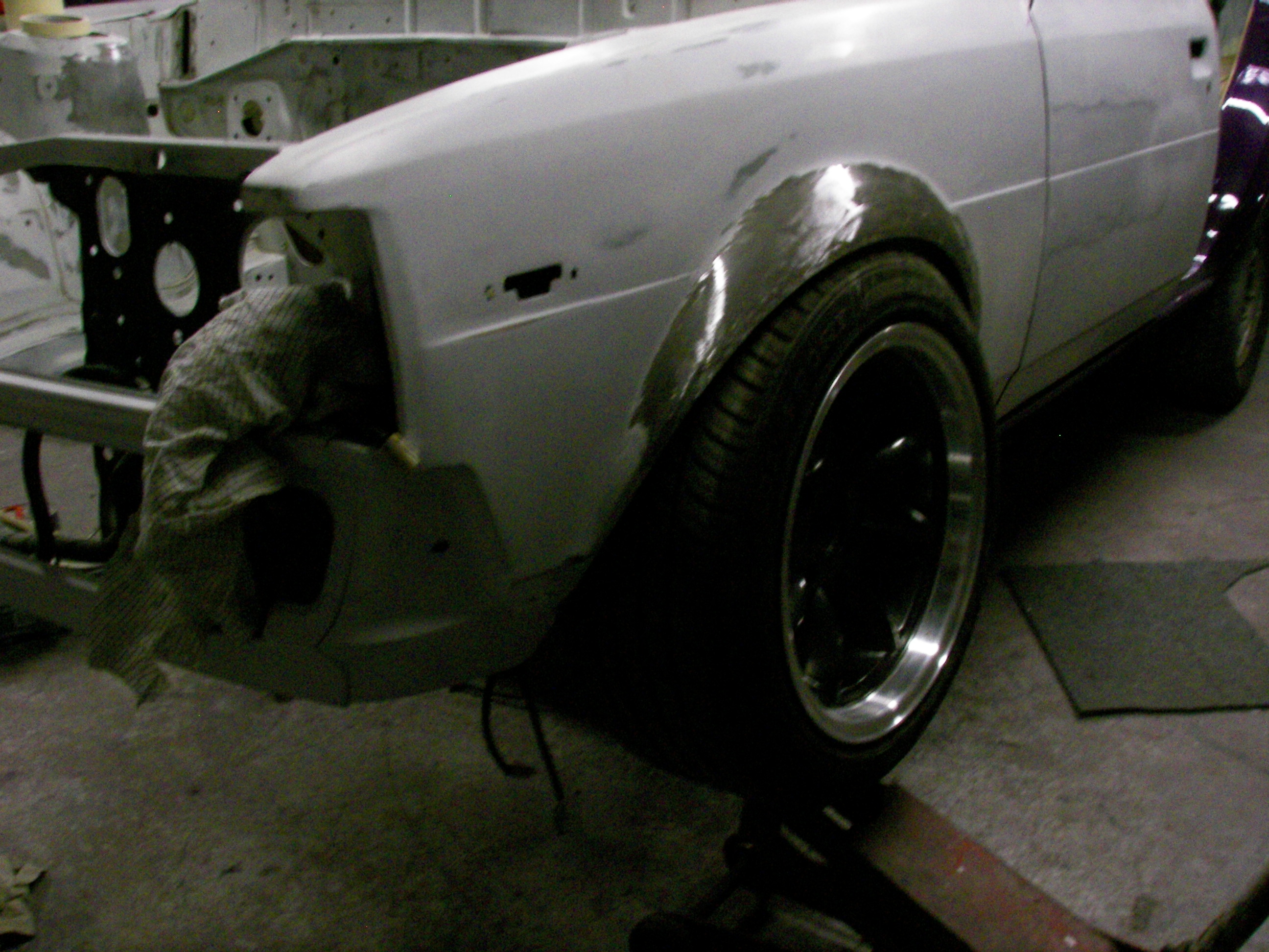

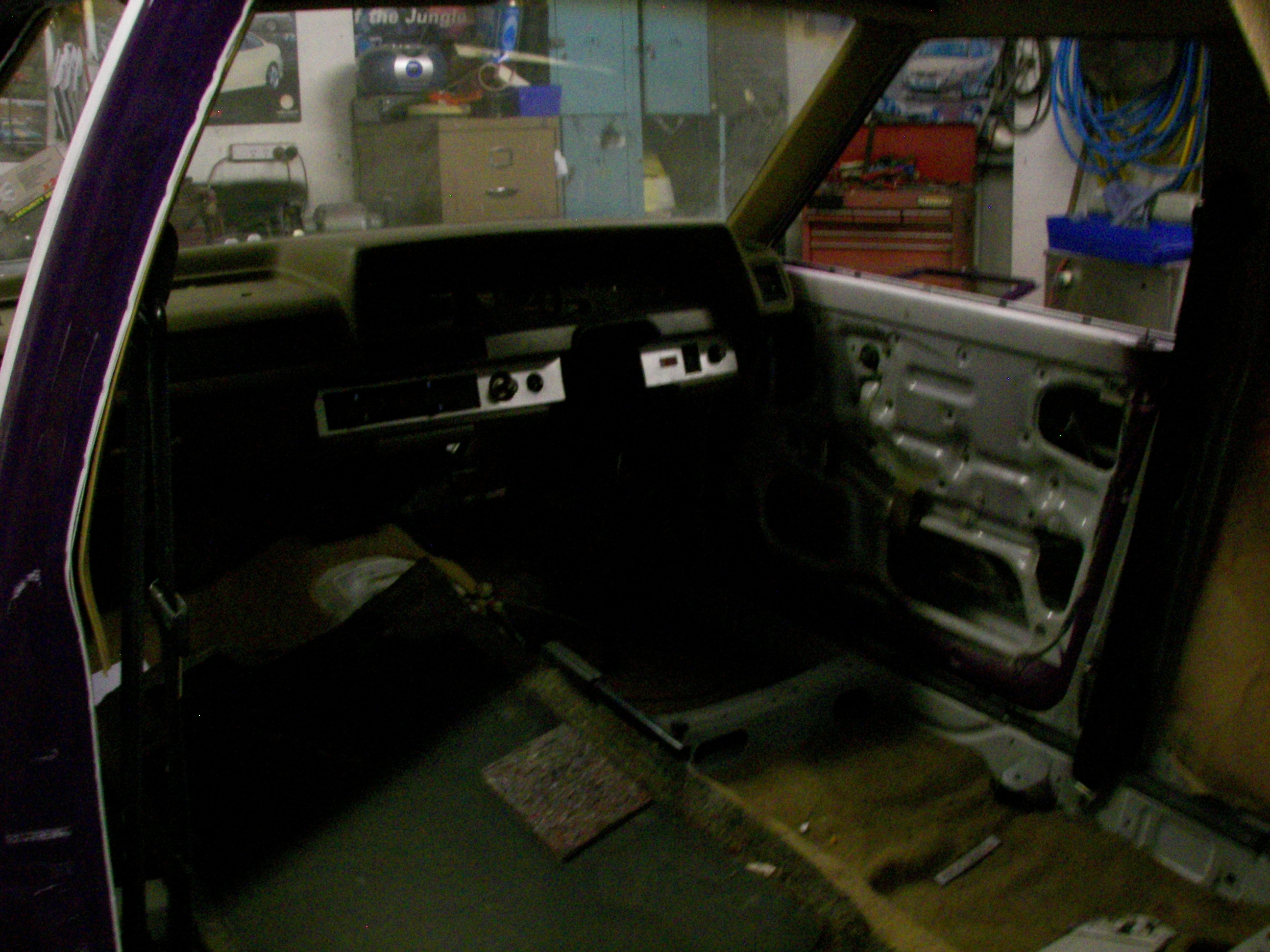

Went over to work on it today after school to give her a few finishing touches before she's painted and put a wheel under it to see what it would look like :yes:

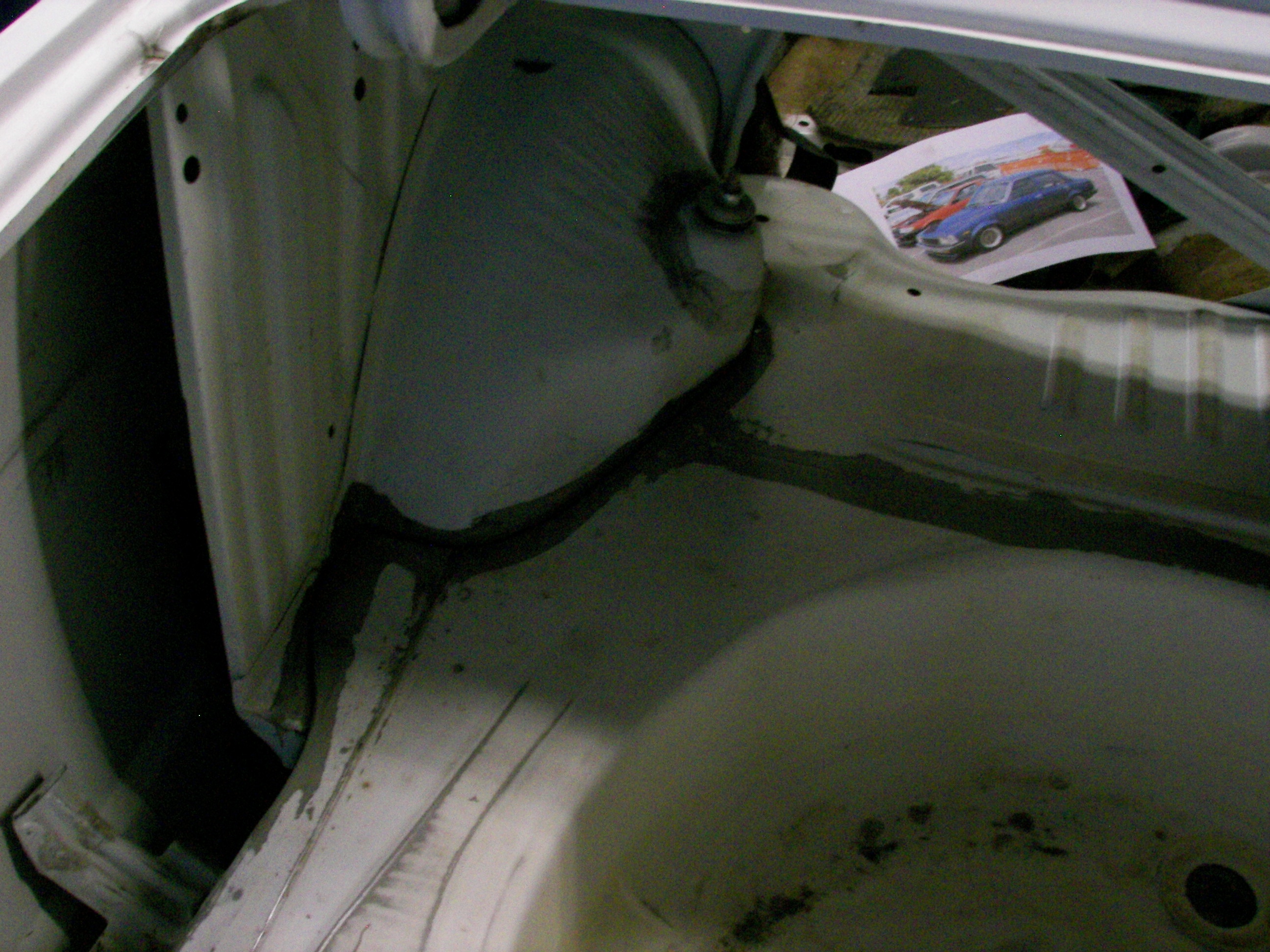

Got to work scraping of all the old crappy sealer that toyota have just slapped on :no2: ready to sand, reseal and paint, not that your going to see it because it will all be boxed in but why not do a propper job while its all apart :y:
