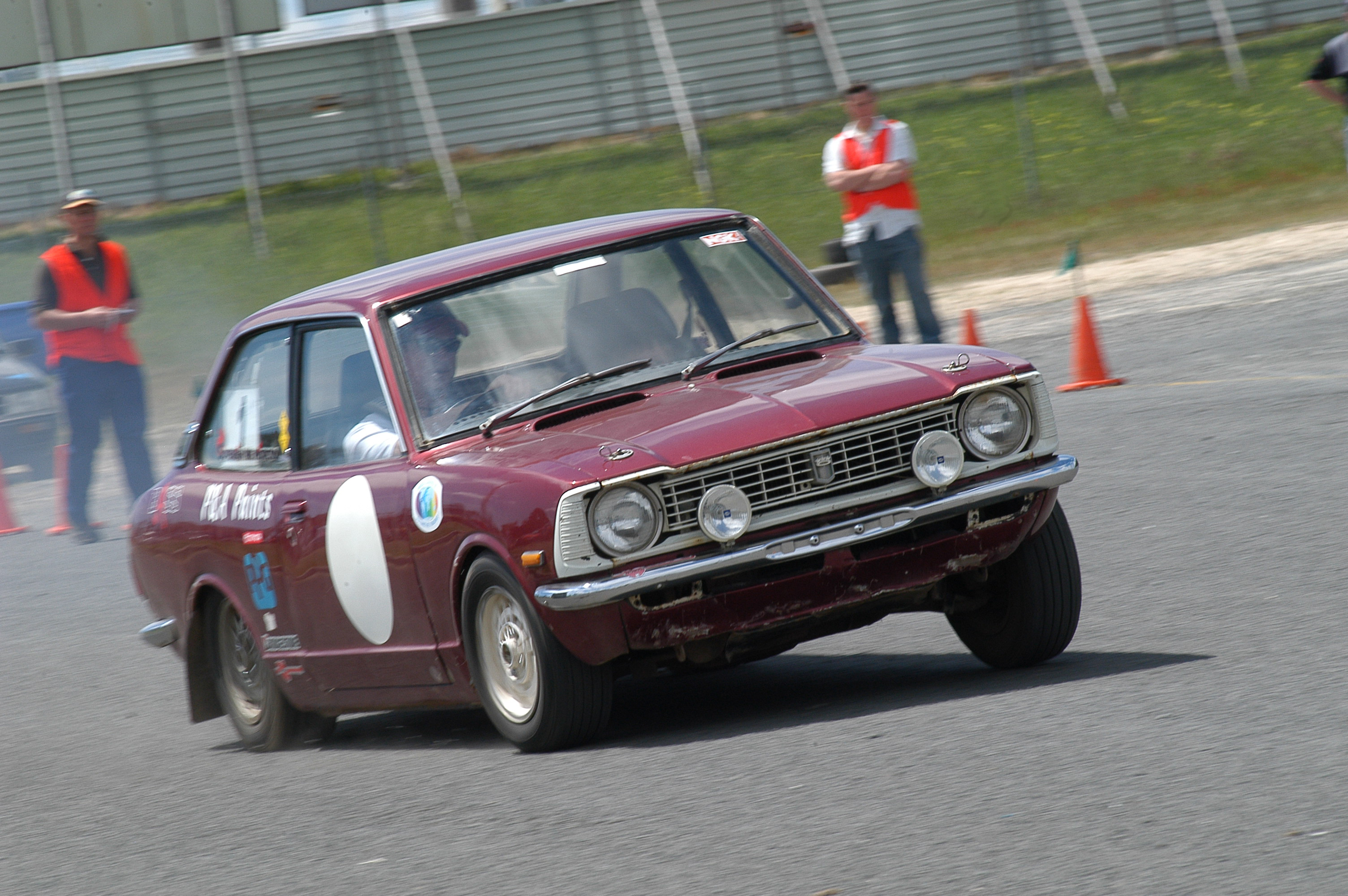

Take note of the inside front wheel, the outside front wheel and the amount of body roll to get an indication of the camber I was running.
