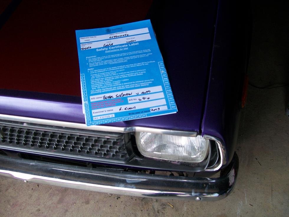

teza40 Posted February 28, 2013 Author Report Posted February 28, 2013 Well the ke38 finally went for a safety inspection today.....no go for rego at this stage.. Have found out, disc rotors are undersize,left seat belt frayed to badly,idler arm and pitman arm worn,rear gearbox mount needs replacing along with shackle bushes in leaf springs. Indicators not self cancelling out An oil leak somewhere (pretty sure from oil filter),speedo for some reason wasnt working also.... Along with needing to drill an tap a fitting into the inlet manifold for vaccuum to the auto kick down module/diaphram...they sure don't shift gears these traumatics (GMH trimatic) without it... So in all,not ready yet for the road..but considering none of those items got my attention due to time and dollar factor.....I'm happy that they are the only things stopping it from rego...they are after all mainly safety items... Cheers Teza Quote

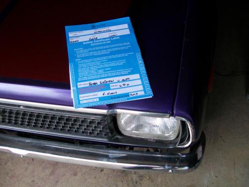

teza40 Posted March 11, 2013 Author Report Posted March 11, 2013 All things required to be replaced or fixed......DONE!... TA DA....passed safety inspection this morning :) Now waiting on the word that another trimatic is out of a car,then drive to Maryborough to pick it.....change auto`s...cross fingers tight...then go get new registration n plates... Cheers Terry Quote
