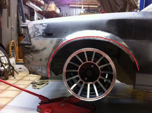

rian Posted October 5, 2011 Report Posted October 5, 2011 It looks weird, like a 4WD wheel arch or something? And maybe I'm wrong, but it doesn't look like it's going to help with the fitment issue as the tyre will still make contact with the original part of the fender. Unless you are trimming the original fender to position the new fender lip higher up on the panel? Quote
iwontarolla Posted October 5, 2011 Author Report Posted October 5, 2011 I'm pretty sure it would clear, its only a ruff one trying to get ideas on what to do. i kinda like it, but still unsure on it. any ideas? Quote
rian Posted October 5, 2011 Report Posted October 5, 2011 There's a few ideas here, some of the pictures don't work though. Quote
SLO-030 Posted October 5, 2011 Report Posted October 5, 2011 Cut the arch where it folds down along the red line. Pull the now seperated strip evenly out till it covers the wheel. Then weld it a filler section and beat smooth. Stock style whilst doing the job. Quote
iwontarolla Posted October 5, 2011 Author Report Posted October 5, 2011 that was going to be the next thing to do slo-030, but we where going to do it higher up but where you said to seems like a better spot to do it. i need tires before i do any more work on the guards i think. Quote

SLO-030 Posted October 8, 2011 Report Posted October 8, 2011 Try some ke30-55, xt130 corona or GH Sigma Lower control arms to get the top of the rim under the guard, 195's will be fine on an 8 inch rim also. Cheers, Crowie. Longer control arms wont tuck the top of the tyre in. It would work if the top pivot point was below the top of the tyre. But as the top pivot is a fair bit higher, all it will end up doing is pushing it further out. Quote
1JZ-Rolla Posted October 8, 2011 Report Posted October 8, 2011 SLO-030 is correct...... longer control arms will only make the situation worse, sure, you'll get more camber, but also widen your track :) Quote
