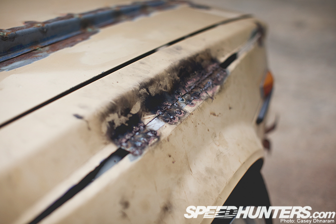

B.L.Z.BUB Posted February 3, 2012 Report Posted February 3, 2012 (edited) Man that took ages to find this article. EDIT: you could do the same where the guard flares out for more wideness. You don't need to cut the whole way Article Edited February 3, 2012 by B.L.Z.BUB Quote
Jono.C Posted February 3, 2012 Report Posted February 3, 2012 Fair few tassie guys are running cut and welded guards, lloyd included. Haven't got a photo but i can grab one next round if you want. Just basically cut along the top crease and pulled apart at the back with flat bar welded underneath and then filled. Can sorta see on this photo of lloyds Quote
iwontarolla Posted February 3, 2012 Author Report Posted February 3, 2012 thanks guys seen it done before but never seen actual pictures of the guard done like ryans. it seems like he has done his so that there is no gap in front of the door and that what i would go for if i did it this way. I'm not going to get much time this weekend to work on it so keep the ideas and thoughts coming. I'm thinking i should go get a old dodgy panel and cut that up before i cut mine up to much. cheers guys Quote

iwontarolla Posted February 13, 2012 Author Report Posted February 13, 2012 so i started guards tonight went pretty well i think. let the pictures tell the story, think it looks alot better then the other one i did. still alot to do but you guys will get the idea. tacked some fencing wire on after they where even all the way around then cut and filled this photo doesnt really show it that well but it is pretty much spot on wiht the right curves in it. ill do the hole guard how it is at the moment then weld it all together. Quote

philbey Posted March 12, 2012 Report Posted March 12, 2012 (edited) Holy smokes. That is huge flare. I dig it. Are you using a tig on the guards? You'll be better off if you do, MIG welds are generally much harder and will take a lot more finishing. Also, just continuously tack weld rather than run full welds, it will reduce heat distortion. Looking forward to seeing the end result, although you will need to run huge offset to fill the guards, or it will look dicky. And if you do a good job with that overflow bottle, wanna talk about making one for me? Another project I have on my list that I never get around to... Edited March 12, 2012 by philbey Quote
iwontarolla Posted March 26, 2012 Author Report Posted March 26, 2012 I would use the tig but cost heaps in gas, I'm just using a gasless mig i got for my car. I do the tack tack tack welding style weld about and inch then move to the other side of the guard never gets to hot. Then i just dolly work it a bit, i have done one so far. Been out of action for a bit going to work on it non stop to get guards done. Do have one issue of diff not being centered every thing seems straight but yea ding my head in. Yea I'm starting to do the over flow probably next week so if you have any ideas or any input would be good. If it turns out good defiantly consider making you one or any one else who wants one. I'm going to put a relay on the starter motor soon as i can't start the car any more. I'll get some pictures of the guard on the front. Also started making some mounts for my chrome bar, unsure if making them to strong is bad. I can stand on it so far and it doesn't bend. start of the mounts 5mm x 40mm flat bar hmmmmmm 7k any one? hopefully dad can't sell it thanks guys got to update this more often. Quote
