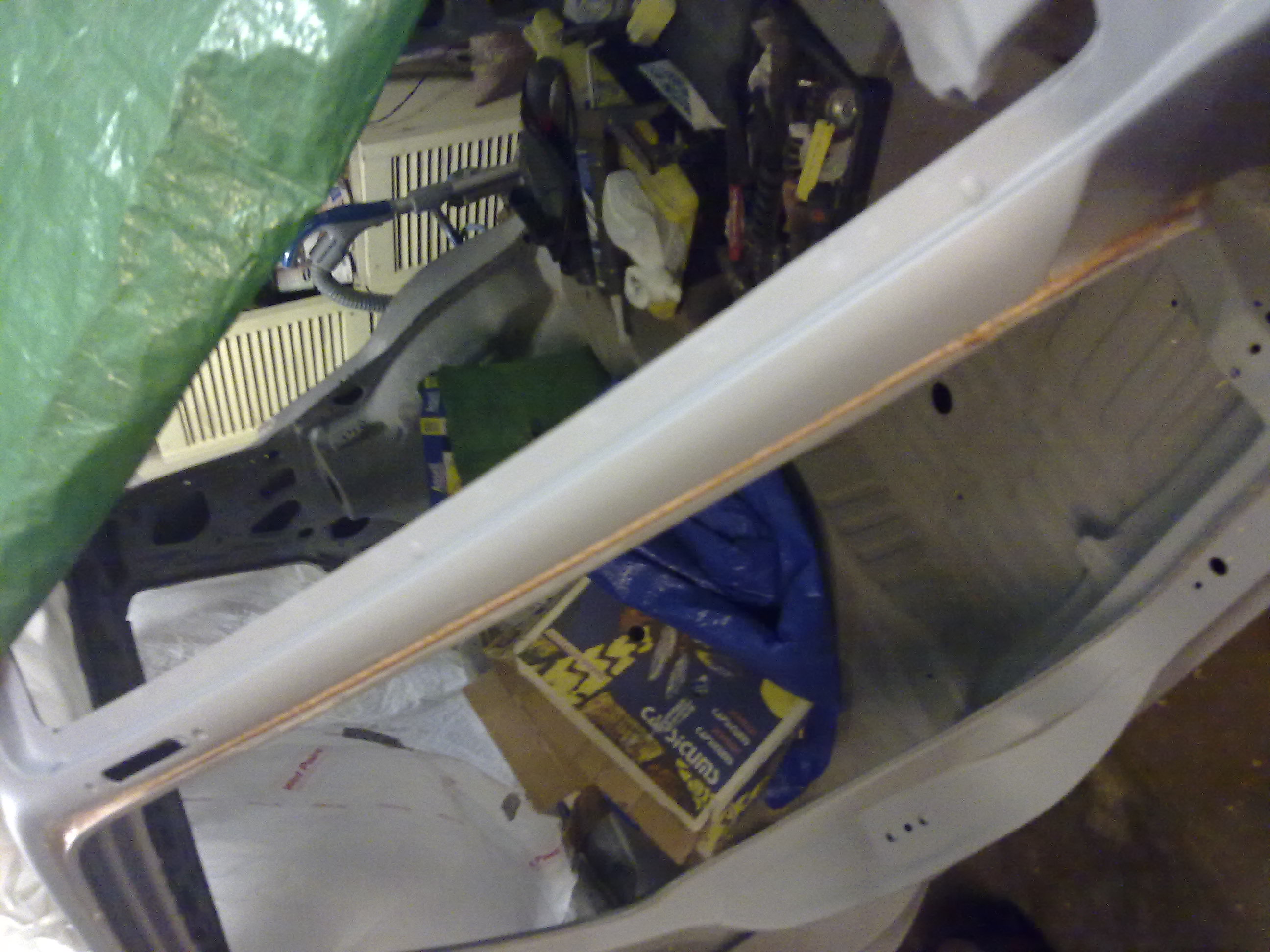

I've finally gotten off my arse & scuffed back the primer on the drivers side sills & taken to them with body filler. The plan is to just smooth them out, not fill in completely or my trim wont clip back on. :wink:

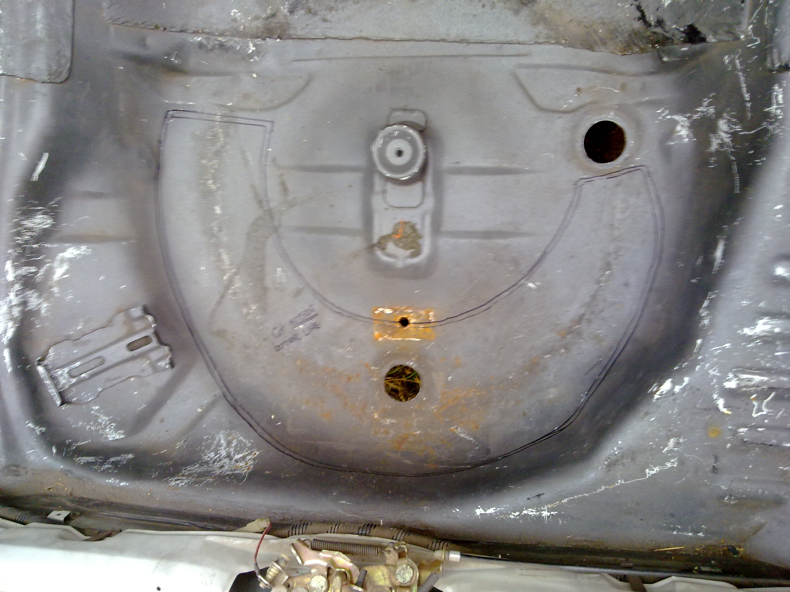

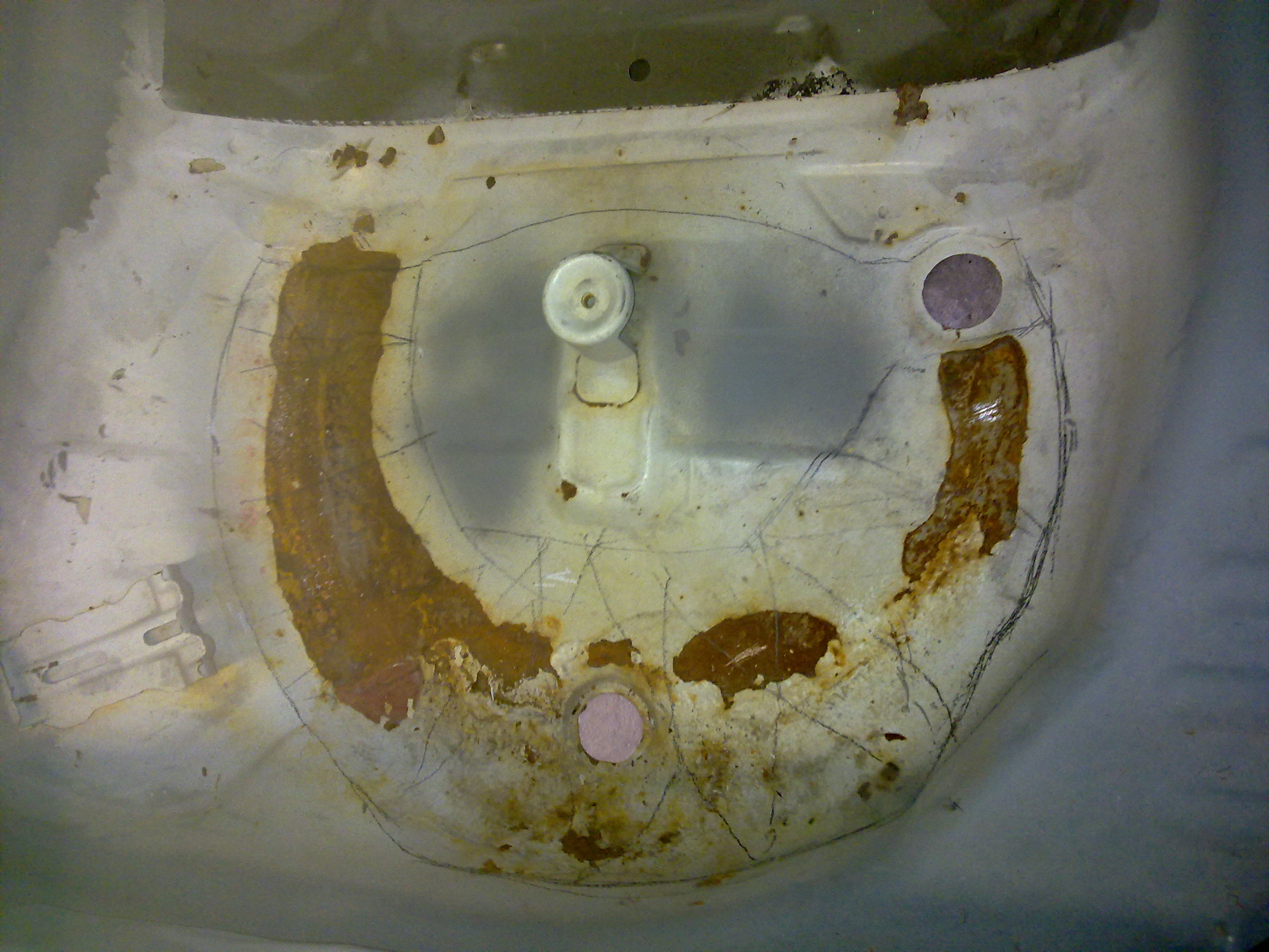

This afternoon I decided to bite the bullet & put my newly acquired welding skills into practice. The first step was to get a rough idea of how much metal had rusted beyond redemption.

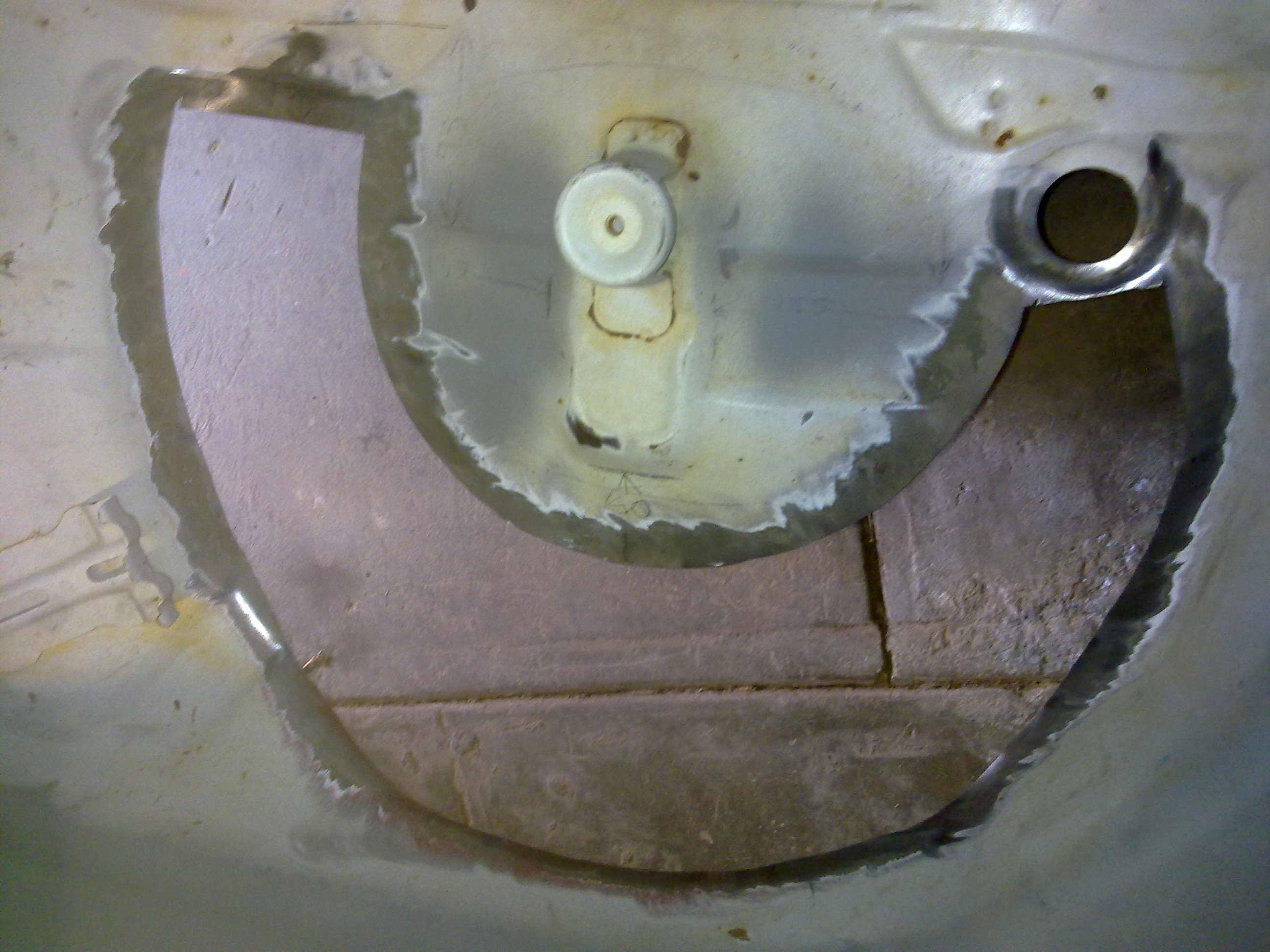

A little bit of 'exploration' grinding later.
After grinding, I noticed these two patches...It appears someone had beaten me to this at some stage of its life.

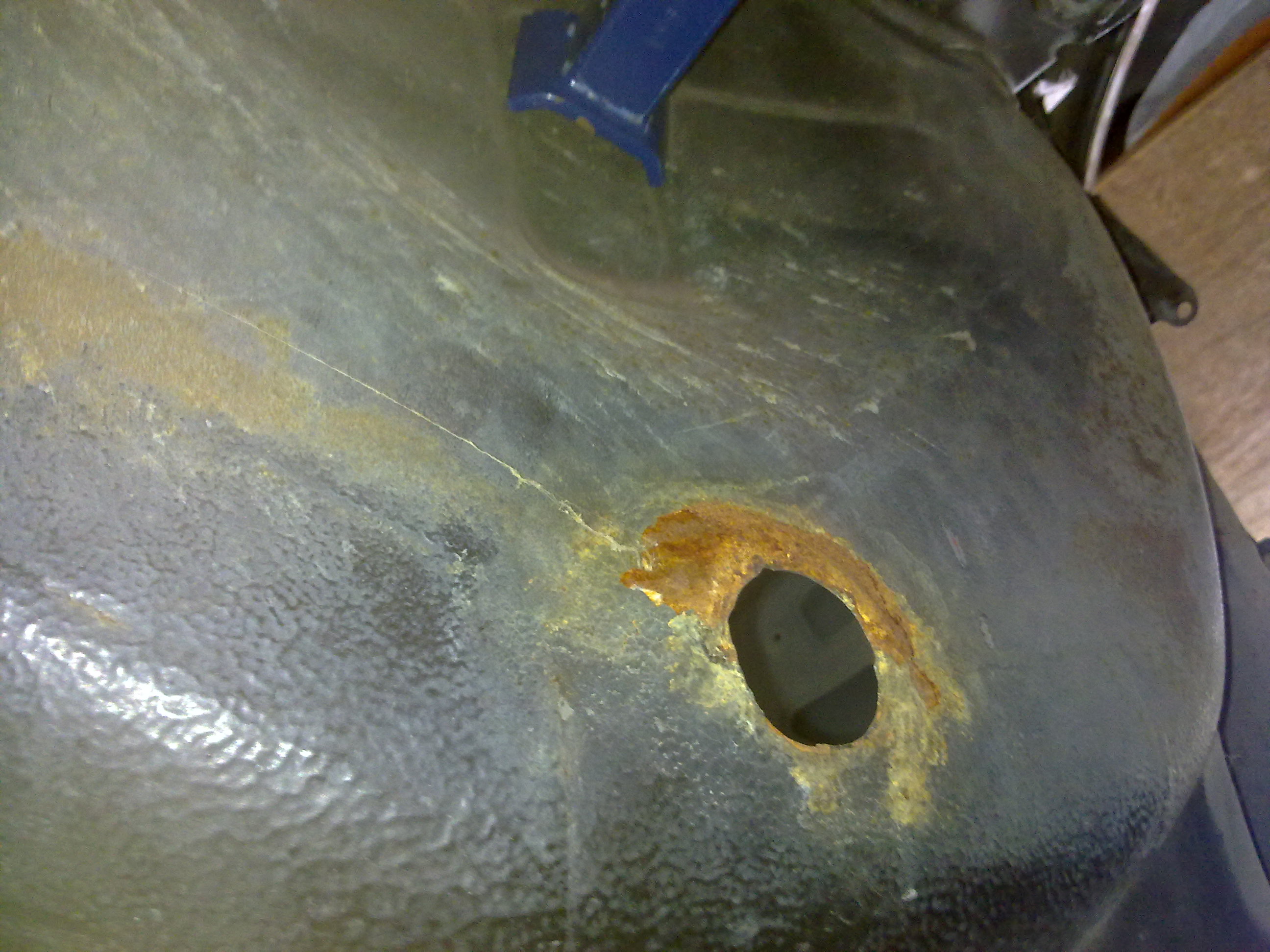

Underneath, rust bubbling around all over the place on the bottom.

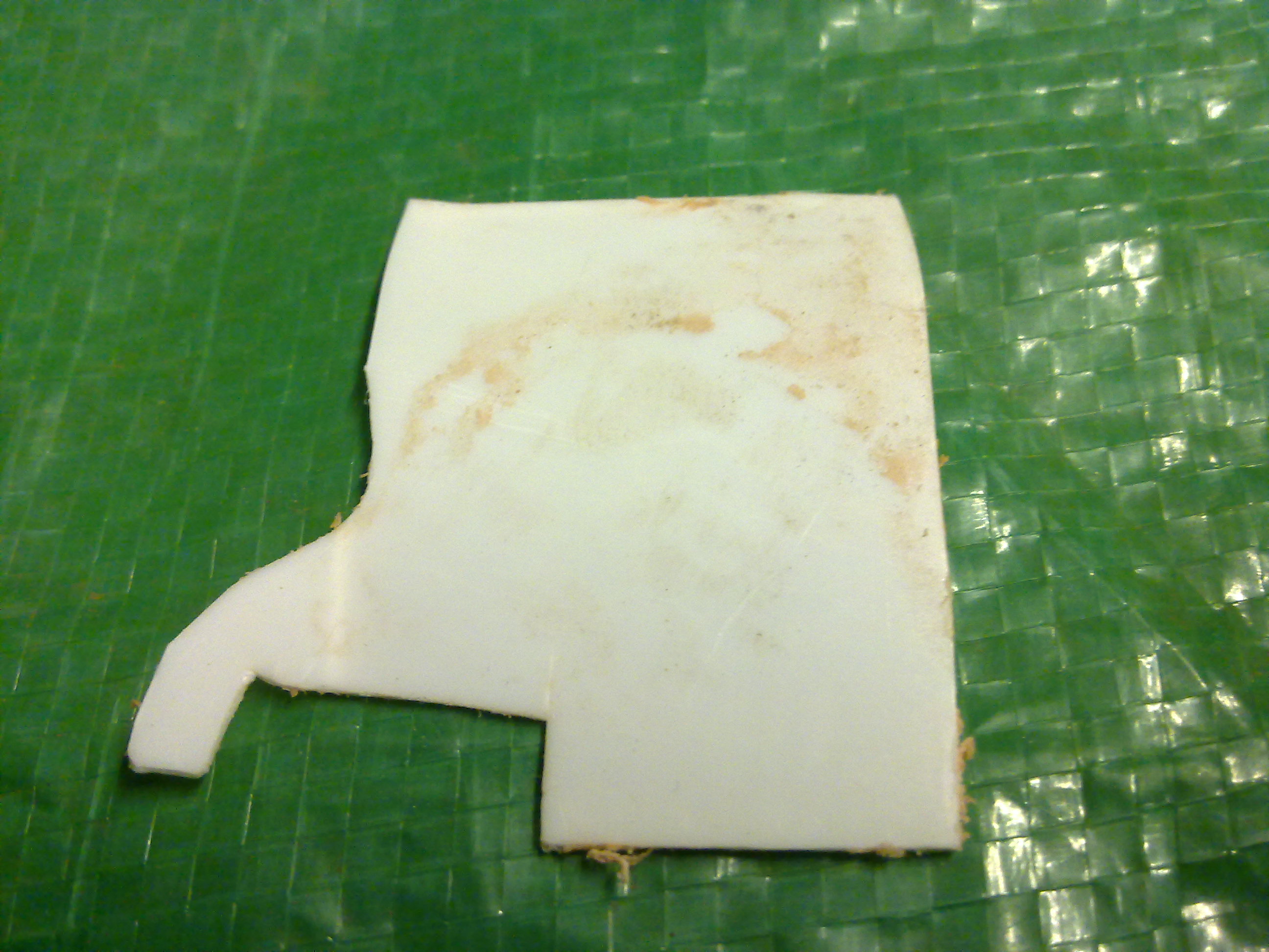

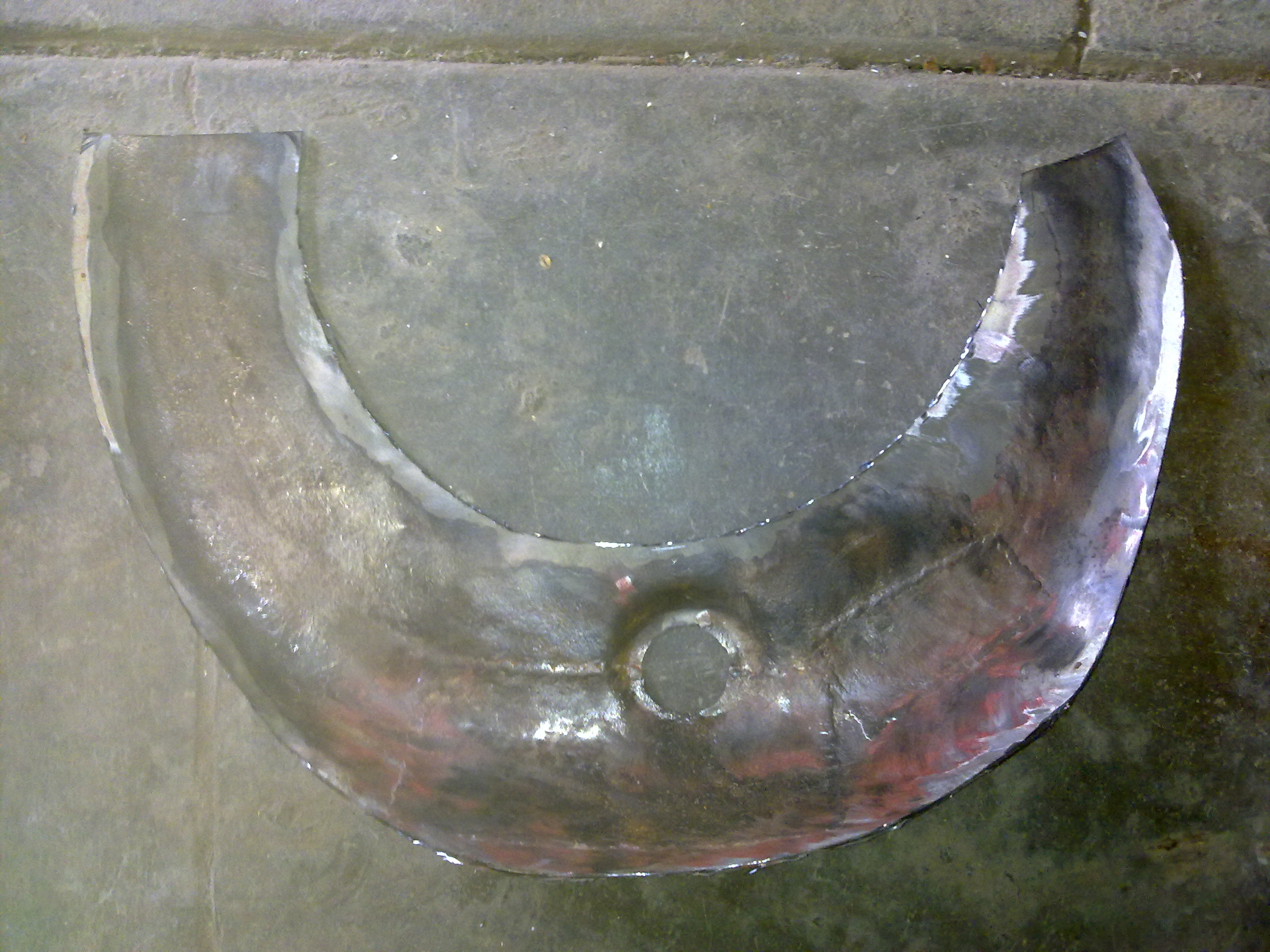

The guilty (rusty) party.
Edges cleaned up with a grinder, paint removed from weld areas & thorough wash with wax & grease remover.

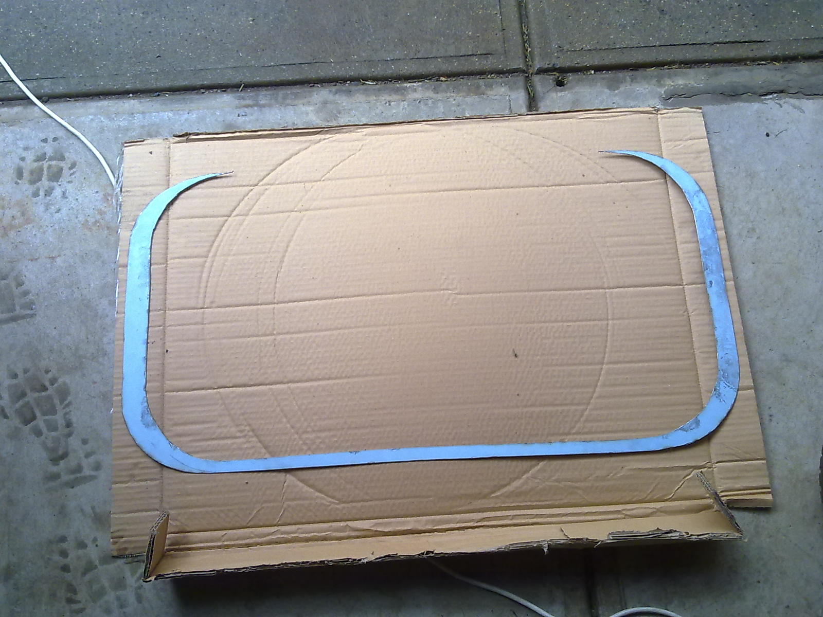

Then I took the piece I cut out to my other TC & traced the outline of the piece, adding 5mm all around to allow for trimming.

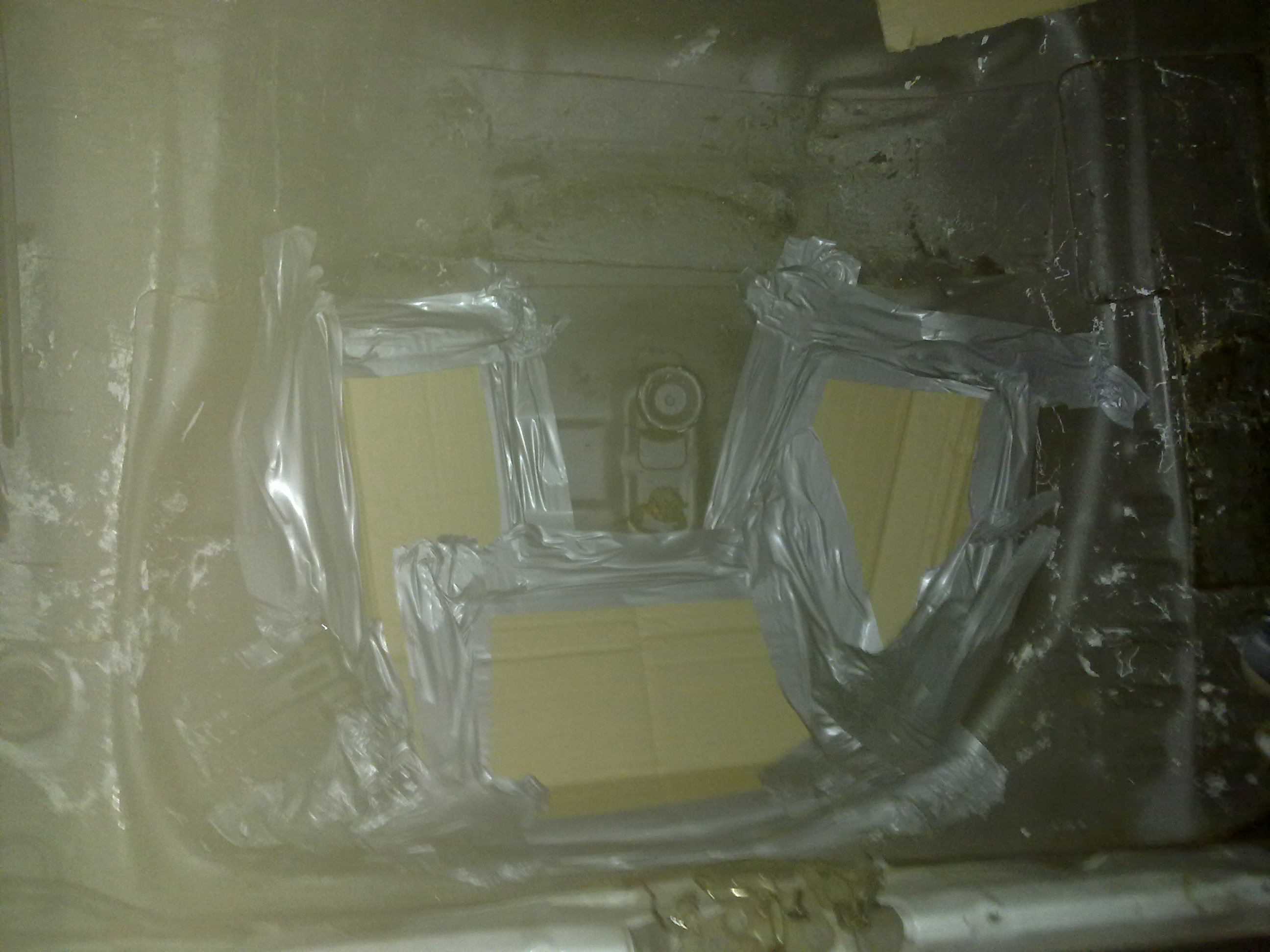

Oh bugger, now I have a big hole in my storage room...
Problem solved! This outta keep the bugs out.

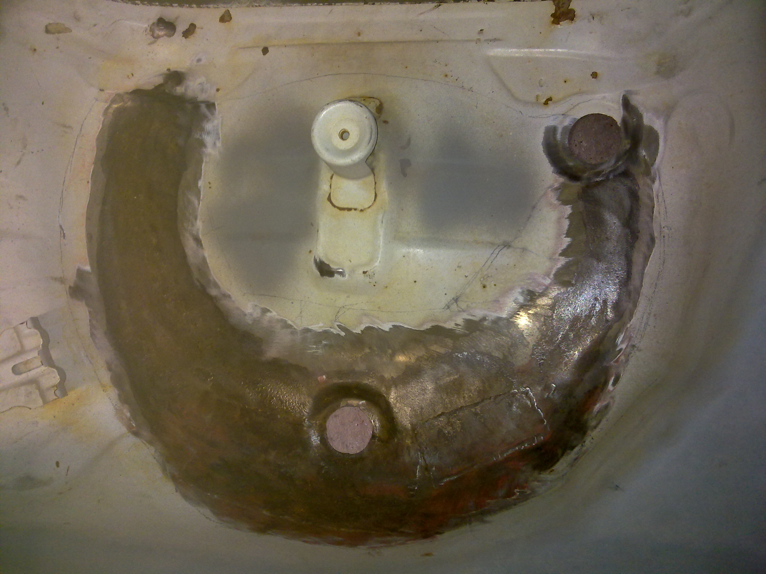

The next step was to go back to the build & test fit the new piece. It was a simple matter of placing it inside the wheel tub, line up & scribe a cut line. A few minutes work with a set of tin-snips (thankyou roofing component of my apprenticeship!) & this is how it sat. Literally... I think I got lucky & it fitted so nicely it just sat there for me.
I didnt trust it to stay there though, so it was braced with jackstands underneath, a welding magnet & a clamp until I could tack it into place.

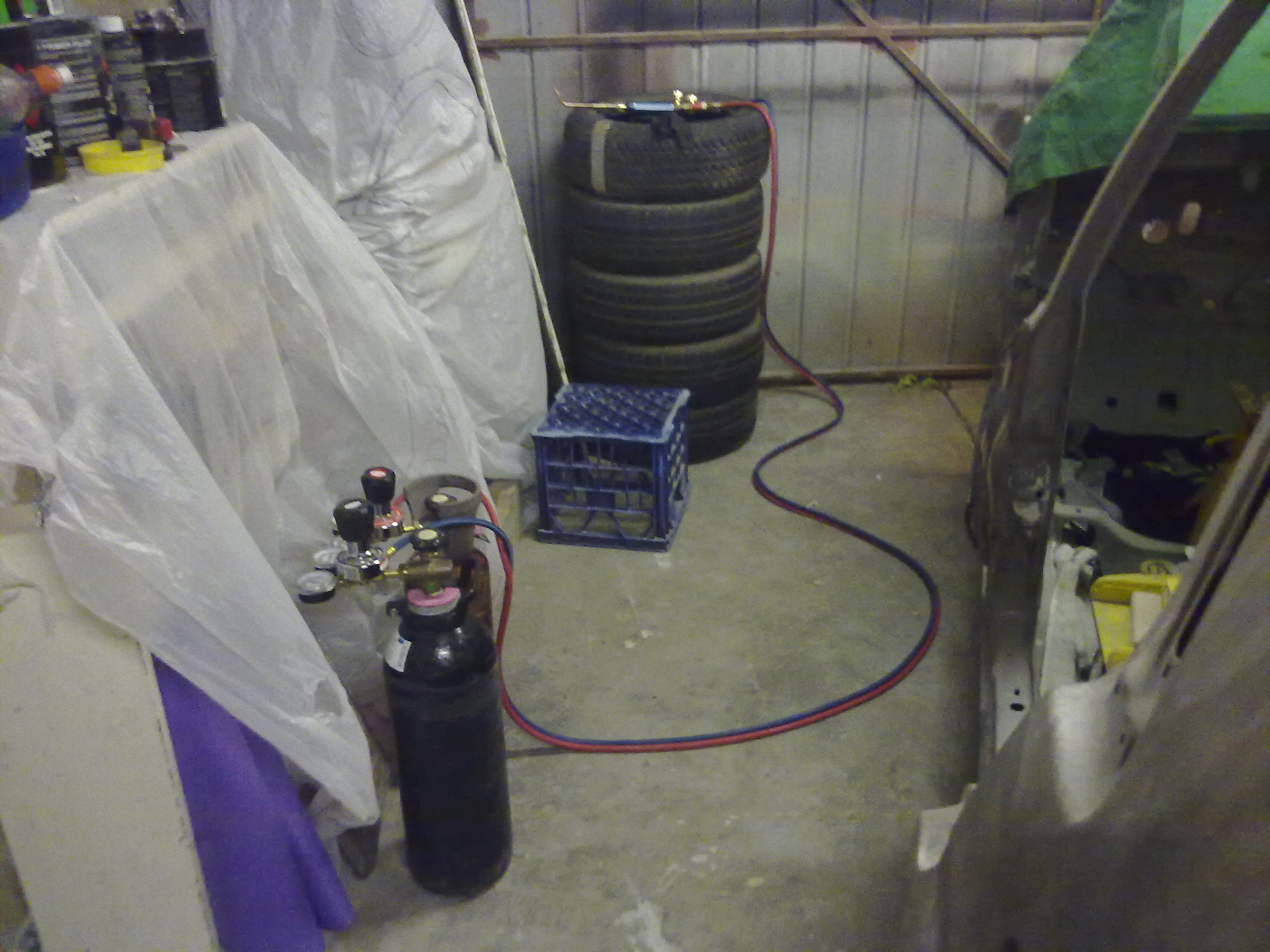

Yes, I'm using Oxygen/Acetylene, not a MIG welder. I like the oxy (cheap & does the job), what can I say? :yes:

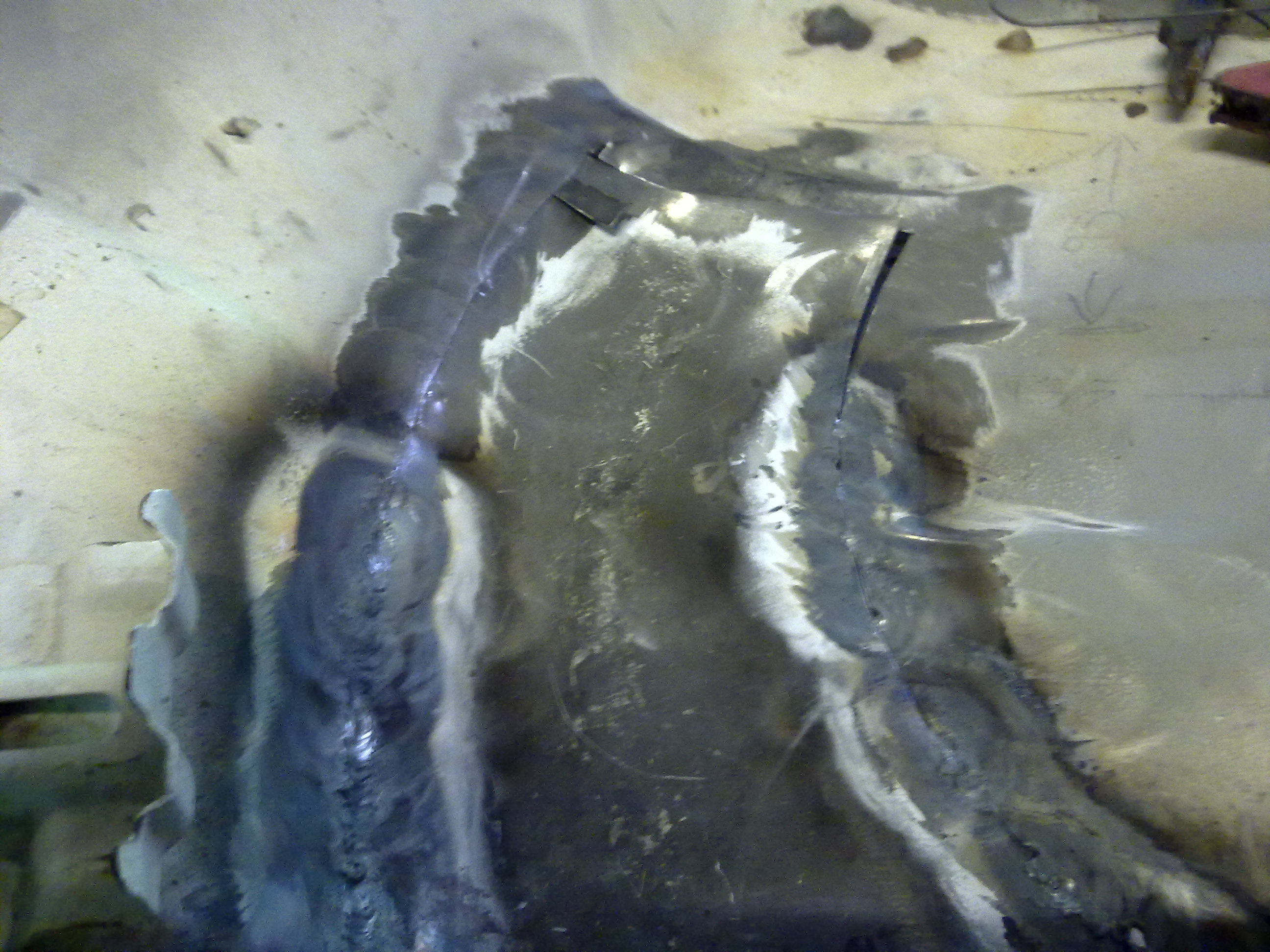

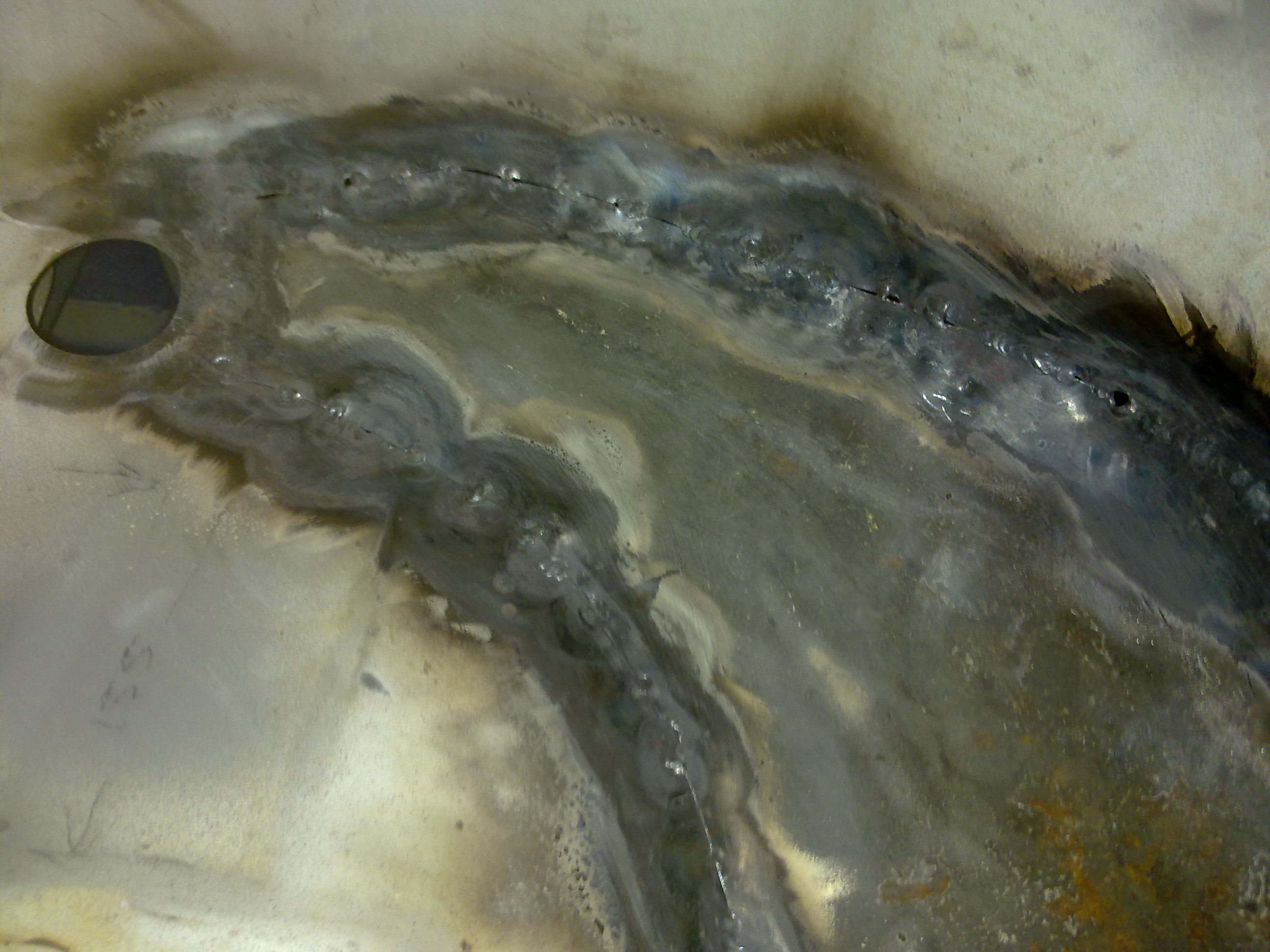

Managed to get some tacks laid down & some small bits welded properly. Couldnt go much further than this as things needed a little tweaking due to minor heat distortion & it was a bit late for hammer/dolly work!
Blew a few small holes at first, but these were easliy filled. 1.4mm filler rod FTW!

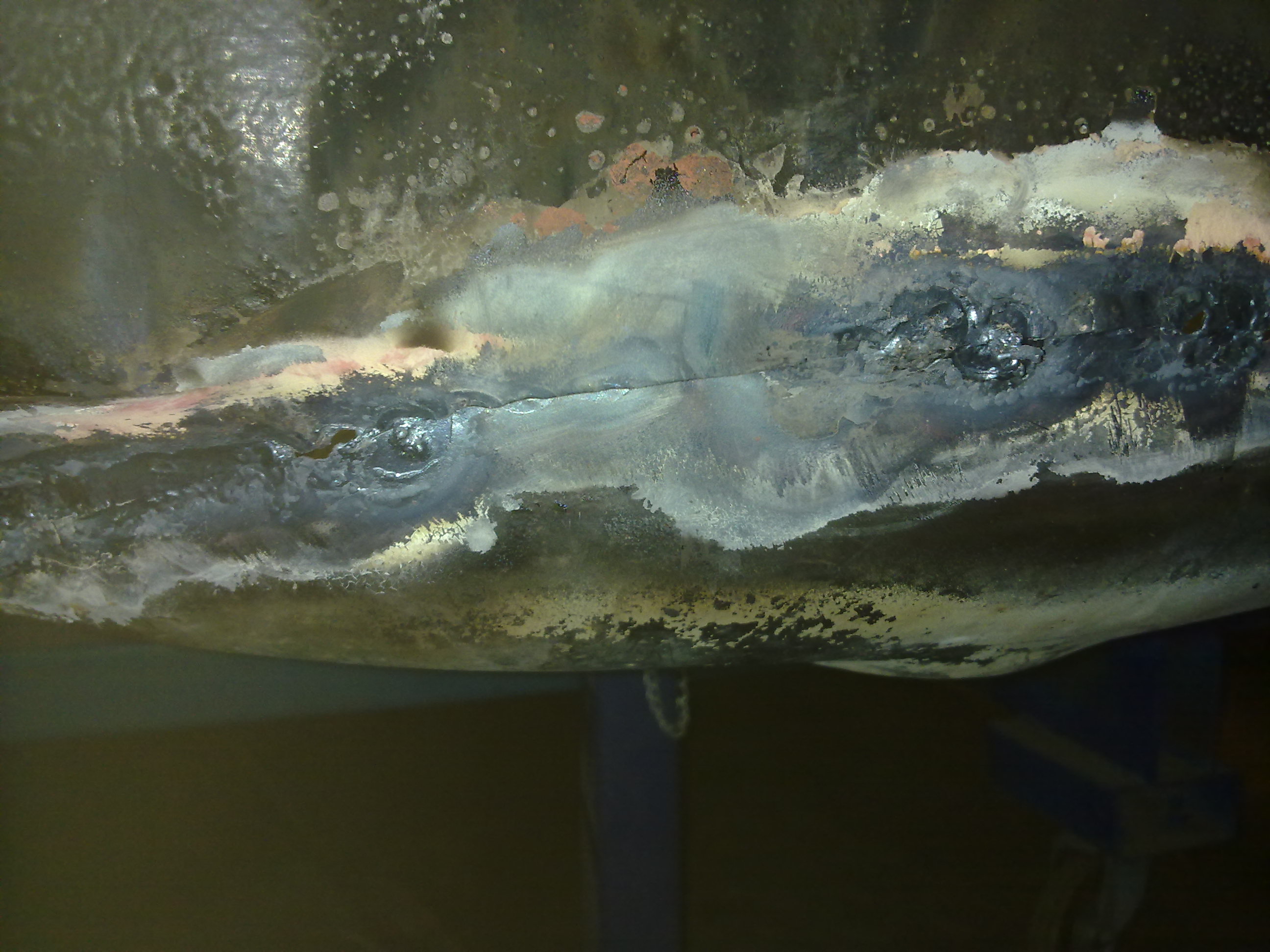

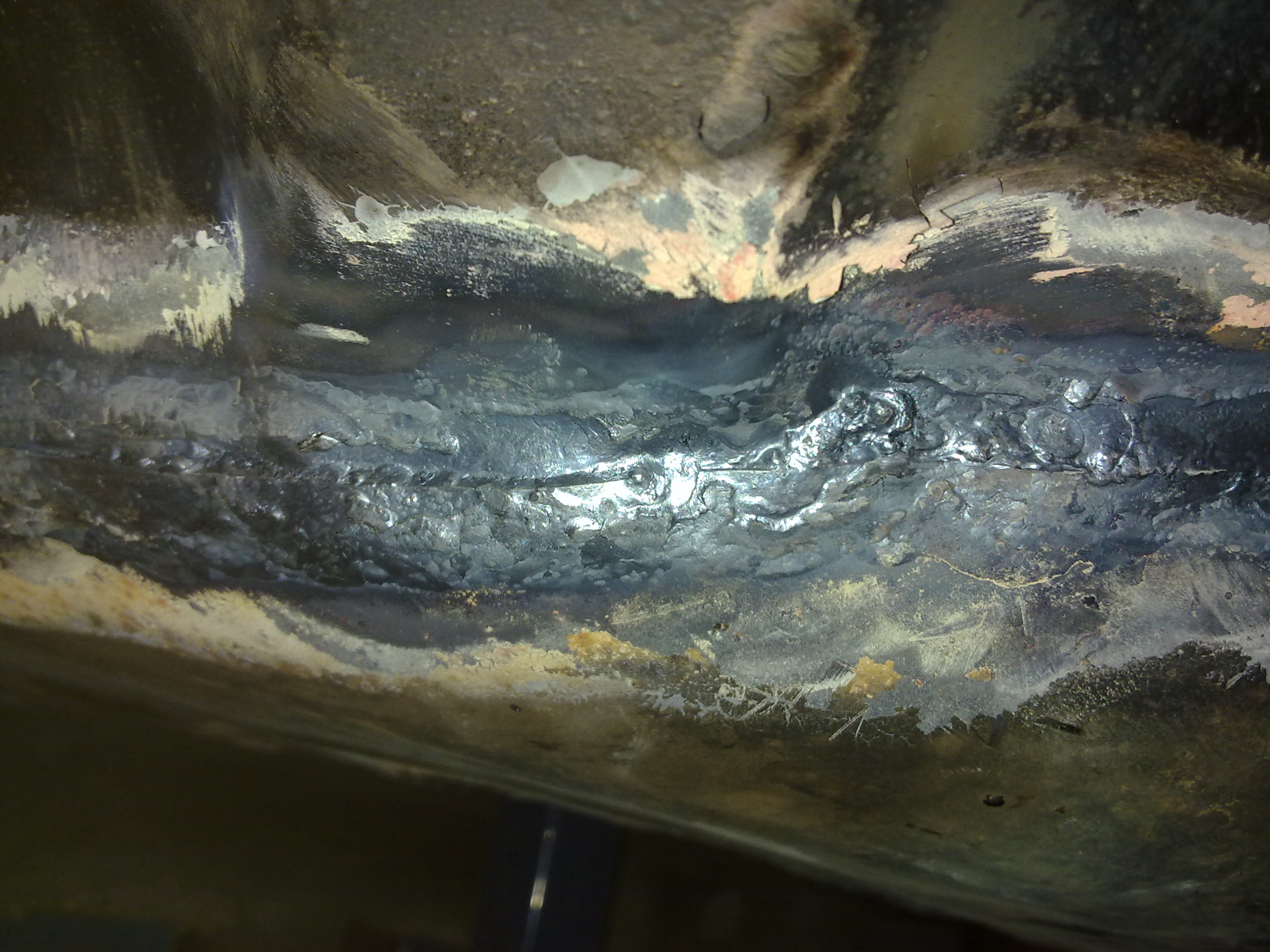

View from the outside, some areas of good penetration, some not so good. Will do a run around the outside later to make sure its all sound.

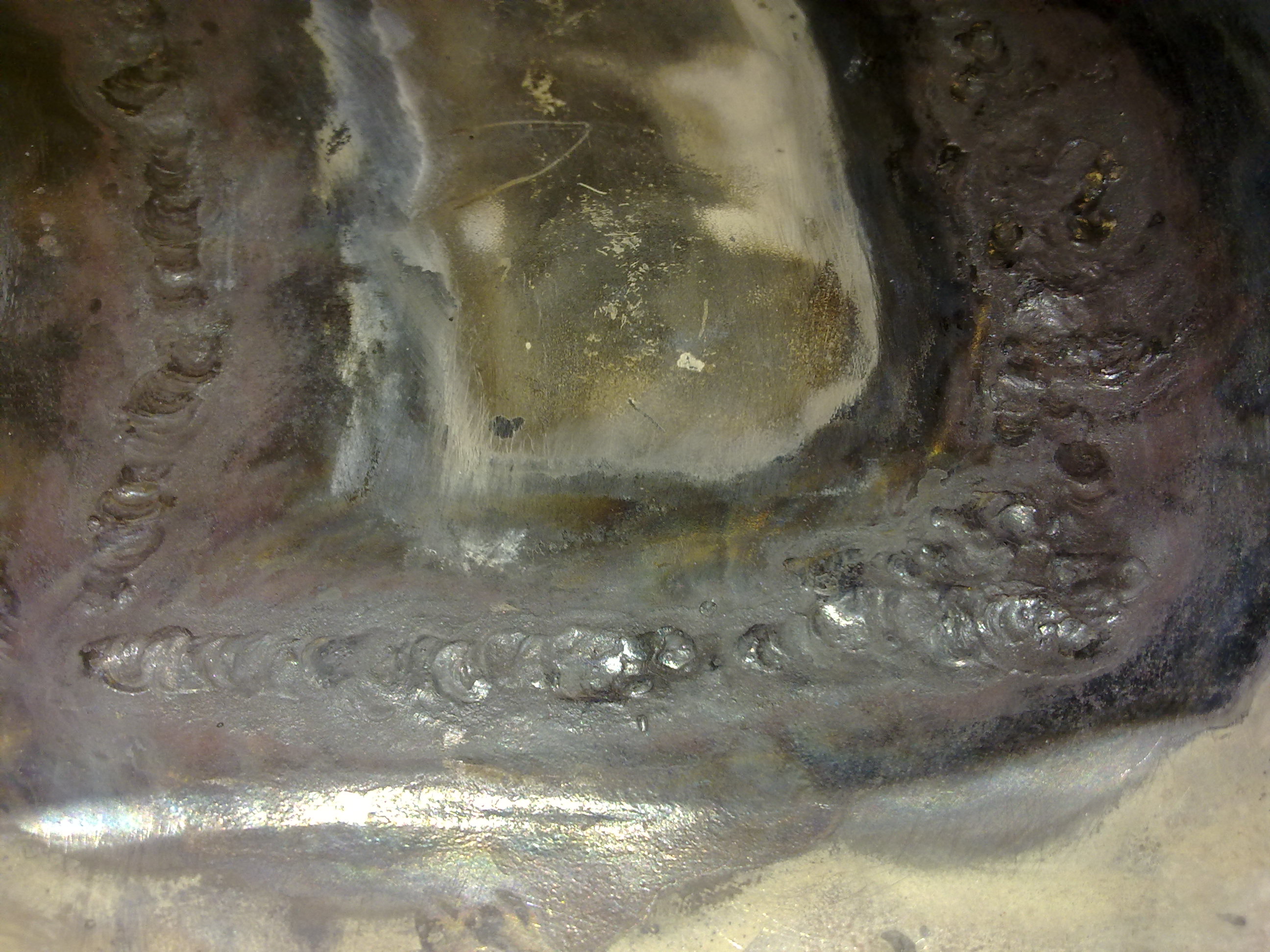

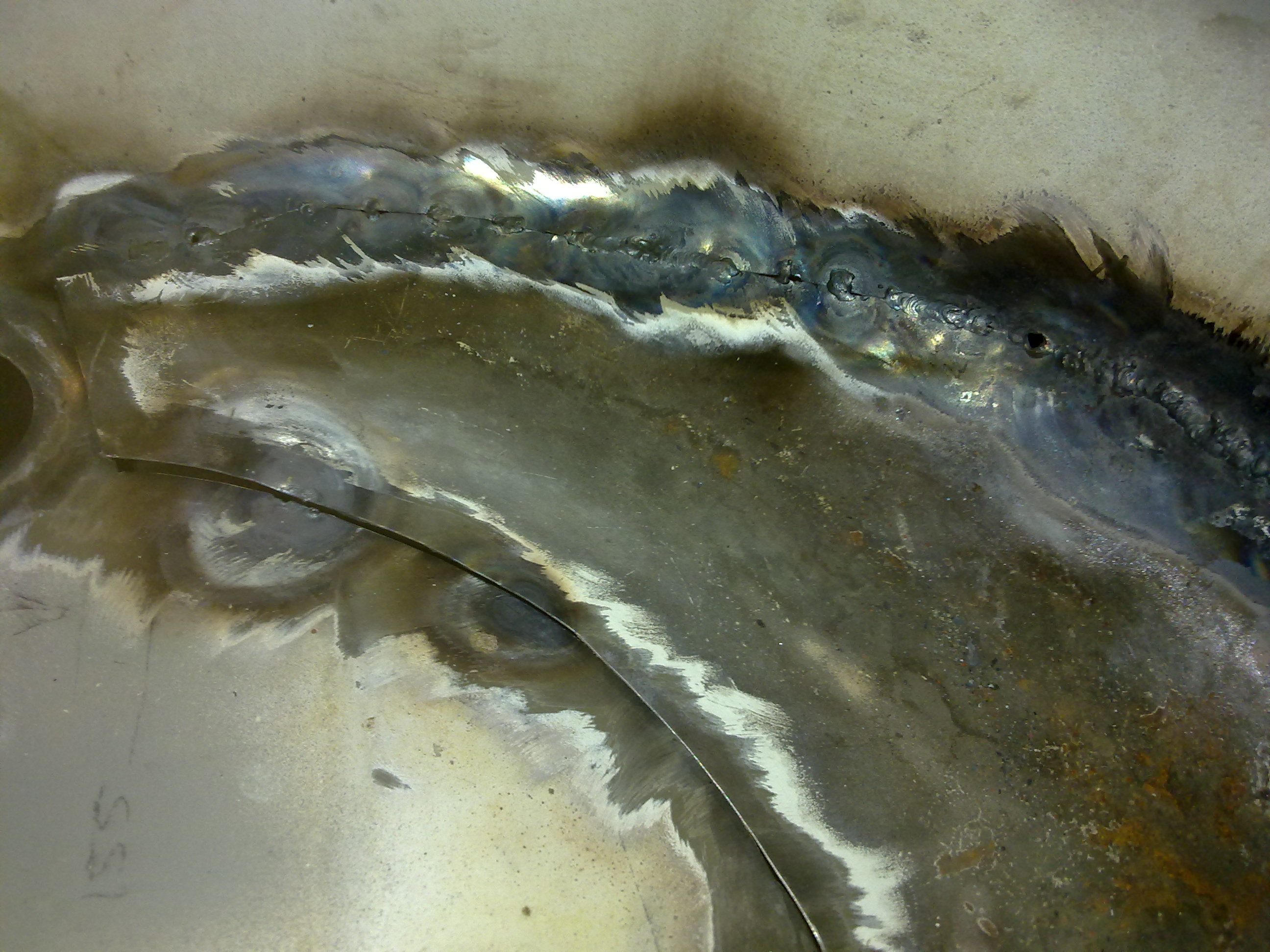

On the downside, I blew a few holes :bash: On the upside, I've become pretty darn good at filling them! :cool: Doesnt matter how long you've been welding, you still jump when the torch backfires on you :laff:
Its in! Well this side anywho.
Okay, so it aint MIG-neat, but its sound.

Not all the weld run looked like this, but a clean up with a grinder will help me find any dodgy spots. *fingers crossed there are none*

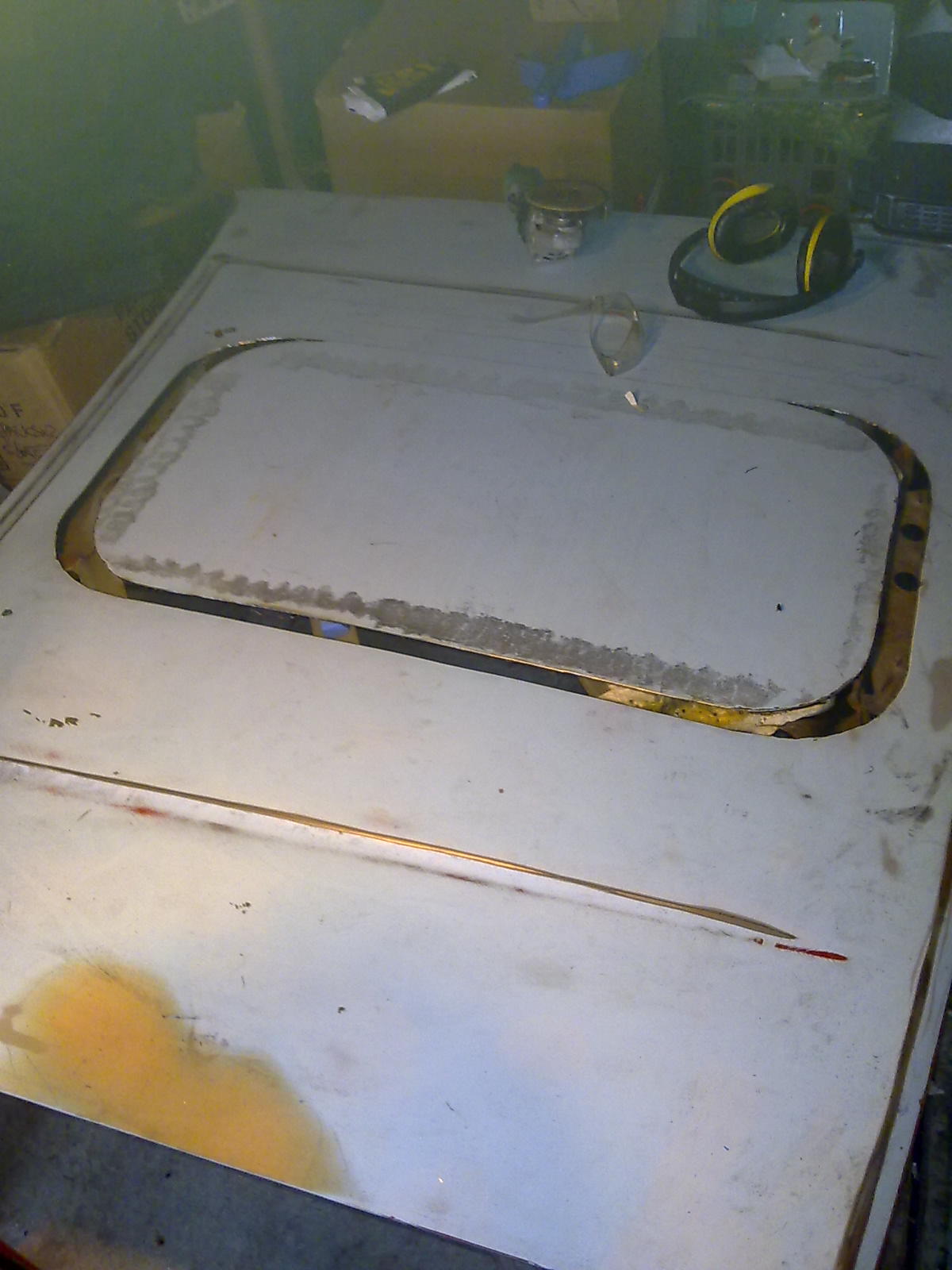

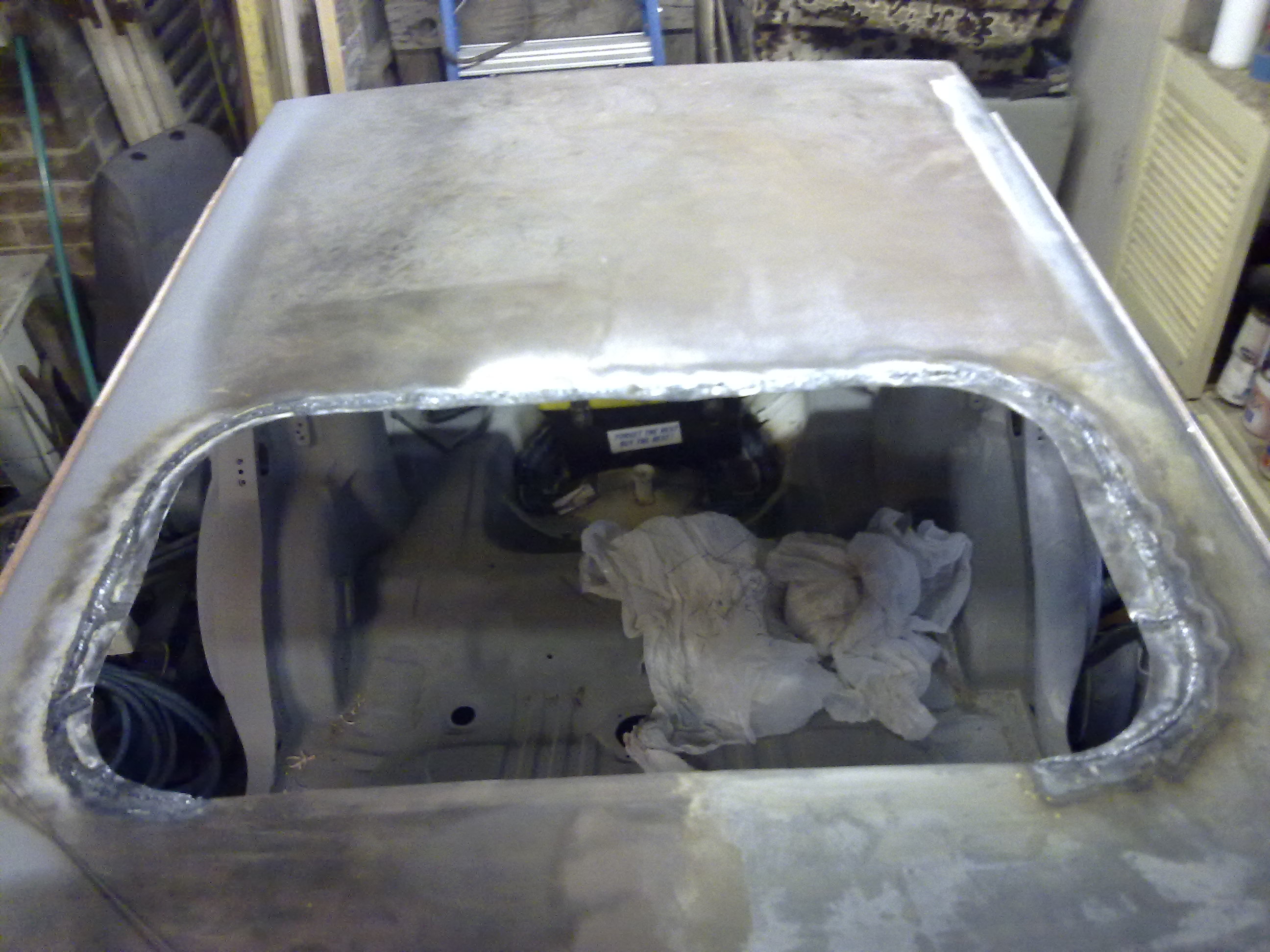

The sunroof infill piece is on for today!
Just done a run home to do some washing, thought I'd upload these progress shots now & the final results when I get back tonight. Got the sunroof fill piece ground & washed, same with the area surrounding the hole.

Started running some small weld sections.
It was at this point I ran out of acetylene. :bash: >| :bash: Public holiday, BOC not open...sooo close!! On the upside, once I get a fresh cylinder I'll be able to finish the sunroof & fix the broken hinge on the shed door. Bloody hard to open when the door only has one hinge, could do it with the arc welder but I so prefer the oxy over it I lack the motivation to dig it out of my shed.
Going to use today as an actual day off over this long, long weekend & try to get prepared for going back to work. :( I'm glad I don't do metalwork for a living, I take forever to do anything that a profesional would finish before lunch :P On the upside, I'm not paying labour costs!

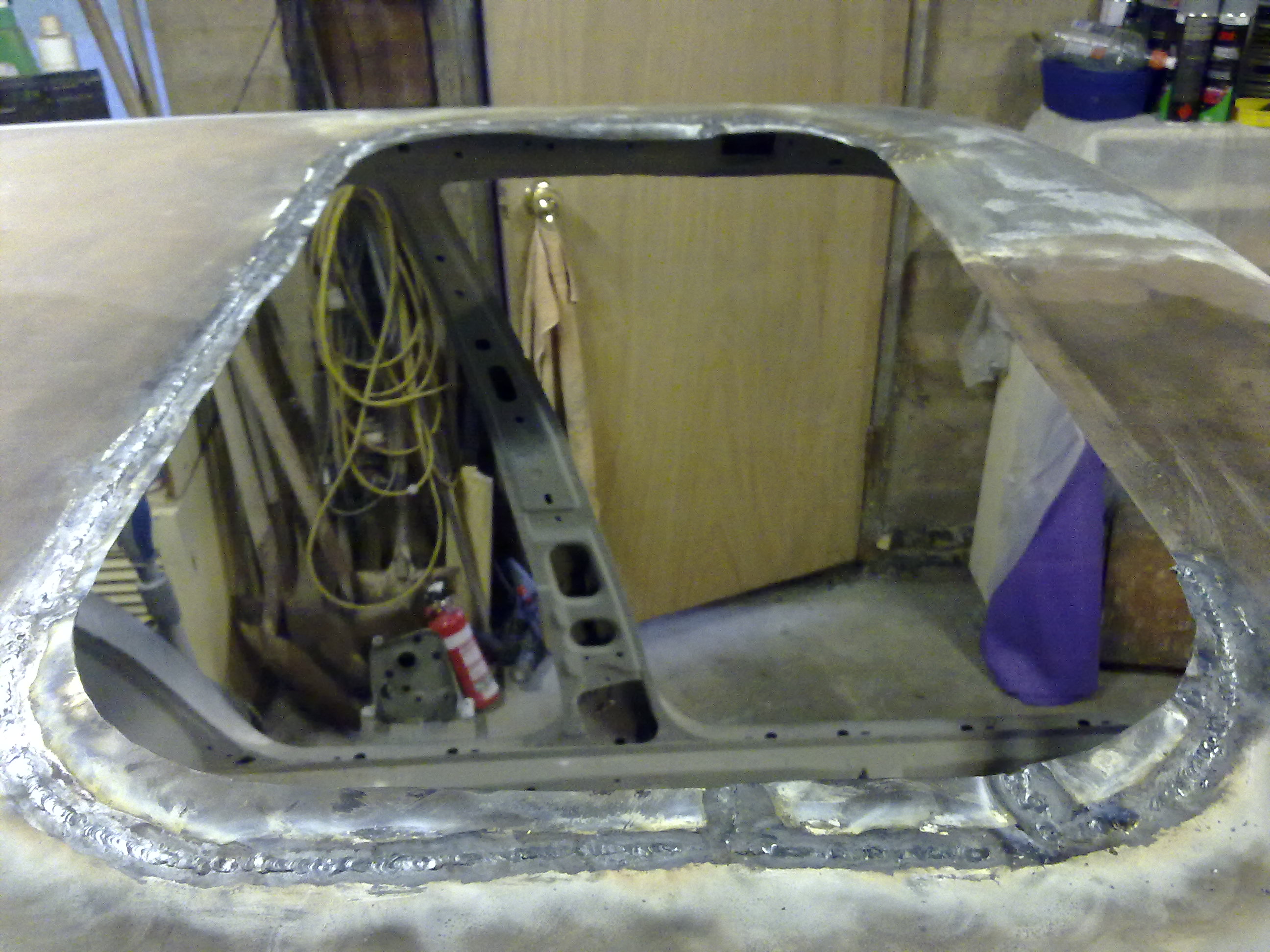

So much for being out of acetylene! It was bloody cold last night when I called it quits, so I went back today with a small brainwave. I left the cylinder out in the sun for about 10 minutes & I think I managed to eke enough gas pressure out of it to finsih of the job! WIN!
A bit of buckling/distortion to deal with but at least my sunroof will now fit! I even think my welding techniques getting better...maybe :laff:
Am so happy now that this lot of major works is done & dusted.
