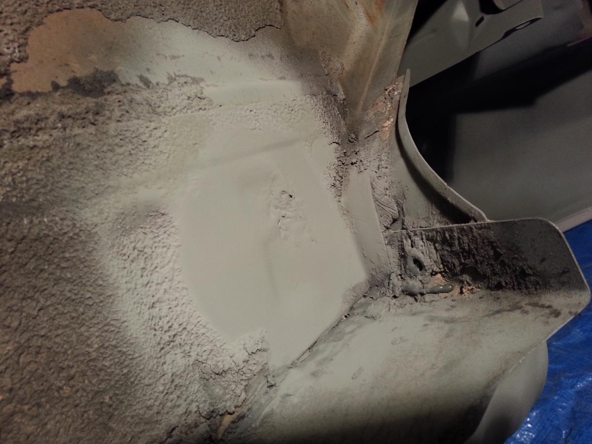

carbonboy Posted December 21, 2012 Author Report Posted December 21, 2012 Was about to start grinding underneath on the rear passenger side, when I noticed this. When removing sound deadener (several years ago!), I'd managed to put a chisel through the metal & had completely forgotten about it. Borrowed the oxygen/acetylene bottle from work & off I went. Grind back, rust-treat & hit with cold-gal primer. A little metal mend to fill the lumps & you'd never know. ;) Quote
