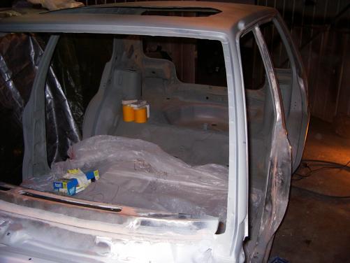

Went down to the shed for a reccy run, have been so focused on the friggin wheel well that now it's done, I was kinda lost as to where to go next :lol: ;)
Made a decision, roof & hatch area are up for a grind, rust convert, grind again, wash & prime now that that I've solved the compressor problem :D

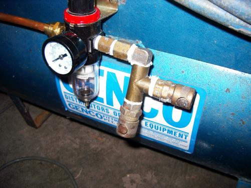

Tightened all the bolts/nuts/screws, changed the oil, cleaned the air filters, drained the water from the tank, buggered off the old line from tank setup (which was a few bits of air line, hose clamps & fittings - i.e dodgy) & knocked up my own. :yes: It now has a shutoff valve at the tank, copper hard line to an oil/water & air separator with another copper hard line to the regulator with built-in water/air separator. I also have another filter that plugs in after the regulator. Sounded much healthier when I fired her up & the lines had no leaks at maximum operating pressure (120psi) :dance:
The tank's rated to 150psi but seeing as she's an ol' girl I acquired as 'surplus' for free & does the job nicely as is, why thrash her? :no2:
New setup.
Decided to run a twin-line setup for $h1ts & giggles. don't really need it, but handy to have I guess :) The other filter plugs in here then the air line plugs into it.
I should've done this months ago! :yes: :laff:

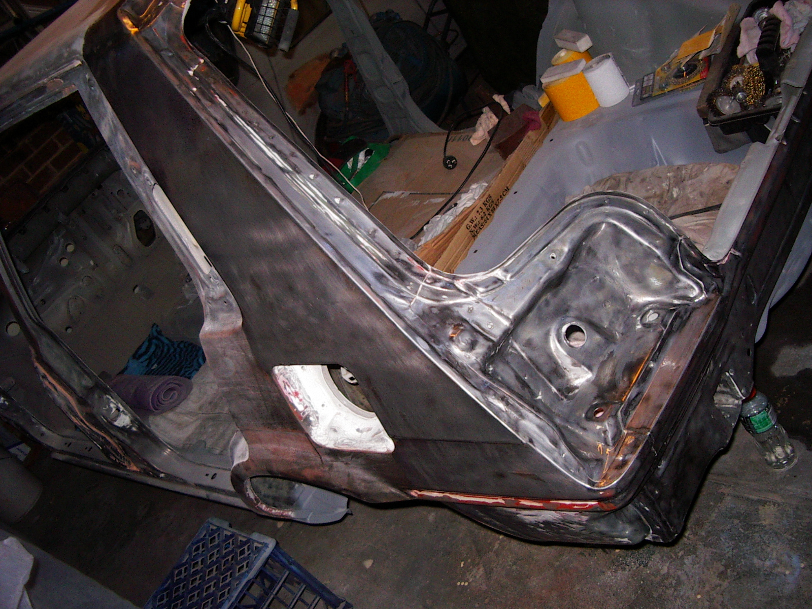

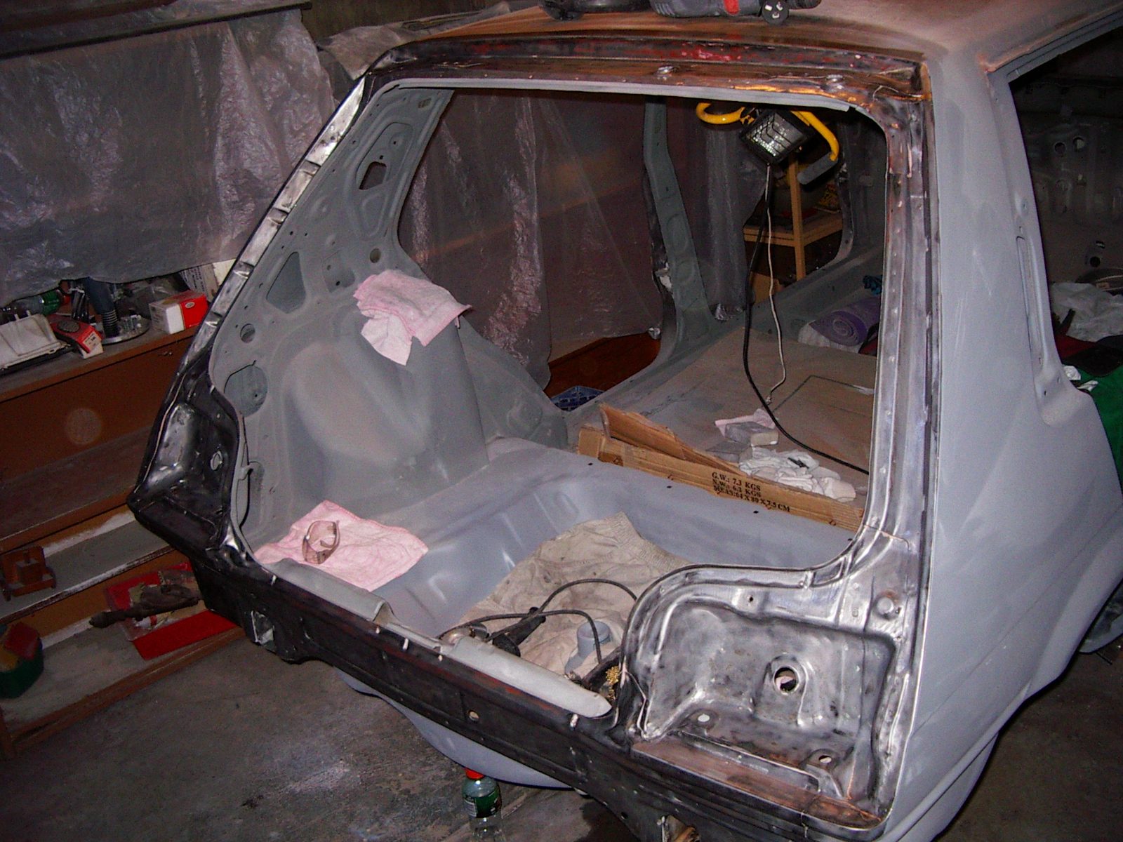

Brown, rusty ugliness... :(
Tail-light areas & passenger quarter panel.
Wire brush before & after :)
Rear end rust convertered, wire brushed & washed with w&gr :)

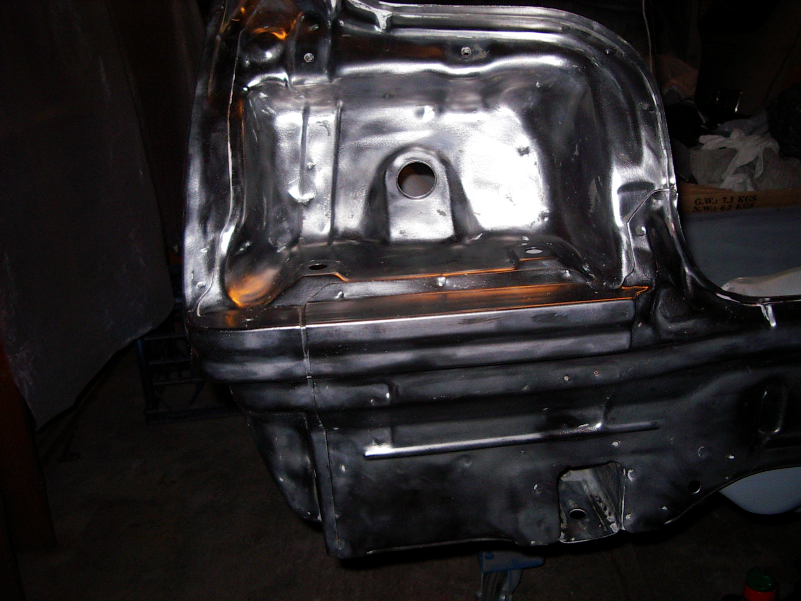

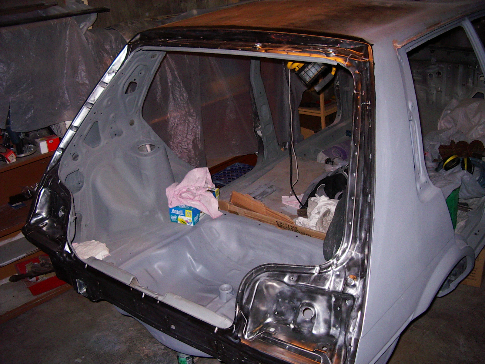

While I'm here I might as well... :lol:
Rust converter on...
We have shiny bits!!! :dance:
In some shots it will look like there's still rust there...I'm going with it being a trick of the light, believe me, there is NO rust there anymore :no2: :D
I may as well grind & wash this too, while I'm here & all...
First coat.
Still avoiding the roof :P

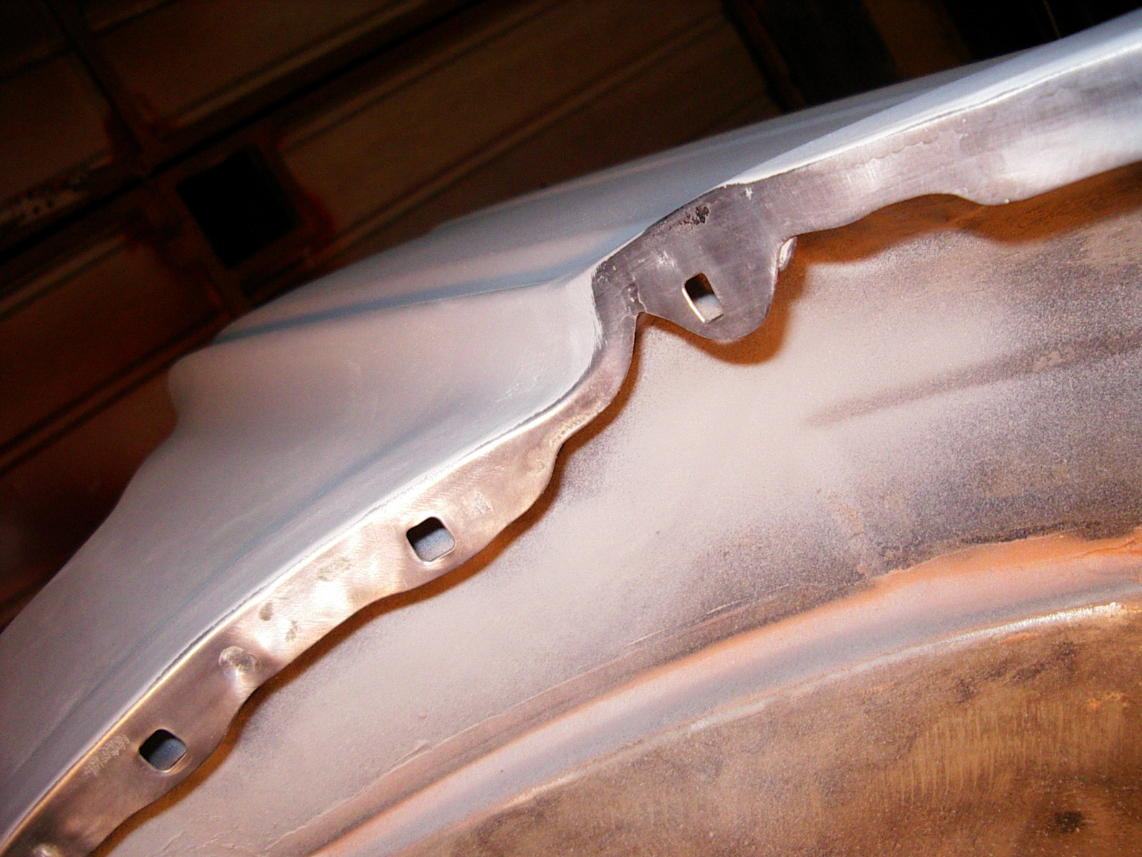

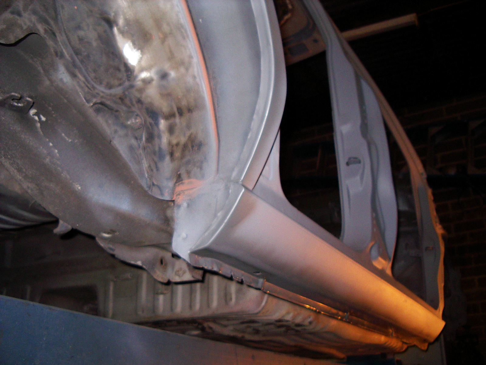

Got to work on the front drivers jack-up point where the spanner before me had bent the seam & pushed the bottom of the sill upwards :( It's jacking a car up, it's not rocket science FFS!
No access from above to push it back down & wanting to avoid putting a screw into the dent to pull it out (leaving a hole to fill...I think I've filled enough holes in this car :lol: ) I got creative :yes: An 8mm drill bit, some welding rod & an old extension bar, insert drill bit, pull on extension bar (read: lift body off ground) & feel metal pull down. Bend wire & extract drill bit. :)
Repeat several times... I can't get the vertical section (with the notches) to move back down, but it's better than what it was I guess. I realise bogging it will make it look better but will end in FAIL the second I put a jack on it :blinks: Thinking MetalMend as it's a damn sight tougher than regular bog, then some carbon plate either glued or screwed (or both) over the top after topcoat to take the load... Suggestions? Yes it's technically underneath the car, but I don't have sideskirts to hide it :P

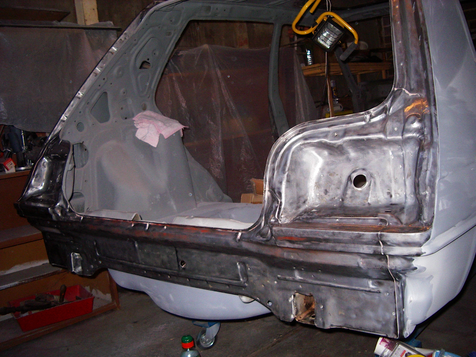

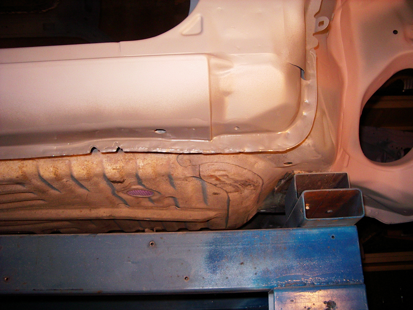

A quick strip & rust converter hit. The primer that was on it was simply overspray :lol:
Ya know how AE82's are notorious for rust at the rear of the wheelarches? :yes: This little black bit was all that I had...on this side :laff:
After another hit with the wire brushes & a wash, we have primer.
