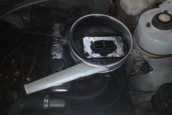

Andy43 Posted February 21, 2011 Report Posted February 21, 2011 Weber, cam and quiet exhaust. & a 5speed! The Weber looks enough like the stock carb, the cam doesn't want to be more than 270deg, and if you keep the exhaust quiet no-one will notice it. Best way to fail... matt black, or more than one colour, chopped springs, wide wheels, no bumpers, 2" exhaust and cannon, no air filter for wild induction noise... and drive it like you stole it! :laff: Altezza is on the Money. I like to add First up Google this book and get it. Four-Stroke Performance Tuning by A. Grahame Bell ISBN 978 1 84425 314 2 Read it every night. Mod the stuff they cannot see. Shave and port the head, ensure you port match to inlet manfold. (Check the head type and ensure you use the high comp head and you have flat top pistons ) Mild Cam. Get the flywheel lightened. Replace the thermostat with a tridon tt240-160, this gave us 2 hp on the dyno. Thermo fan it. Bigger pulley for the alternator ???? Commodore ones fit, Dyno stayed the same but the theory is good. Recurve Dissy On our last dyno trip we also picked up a few horses by throwing the performance aircleaner one in the bin, and modifying a stock one, We cut the sides out of it and blocked the hot air intake. Don't lower the car, and make sure the exhaust looks stock, Plan to do the lowering and extractors later, Same goes for window tint. The k series engines are a great motor to play with. You wont make mega HP, but there a great learning ground, And simple to work on, unless your alternatior dies. Andy Quote
